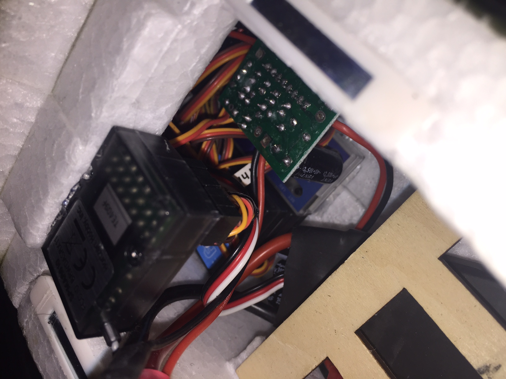

        Gman, I just put an A3-L in mine today and I stacked the sequencer and led on top of each other and put the gyro directly on the wing over the CG between wing haves with the 3m tape it comes with and some low temp hot glue. I tried it tonight and it made a big improvement for the wind and definitely helps with take offs and landings. I attached a photo if you can see thru all the mess lol. I am not sure if you can put it on its side though? but that would def help fitting issues. I thought of putting on wooden battery tray but with my freewing sound system it wasn't an option for me but may work for you since you have more space there.

          Hey, way cool Adker!  I'm wondering if I couldn't get away with putting the A3L right where you have your receiver as well, definitely food for thought.  Amazing how there are so many solutions to the same question, thank God for the forum!!!  Thanks again!
