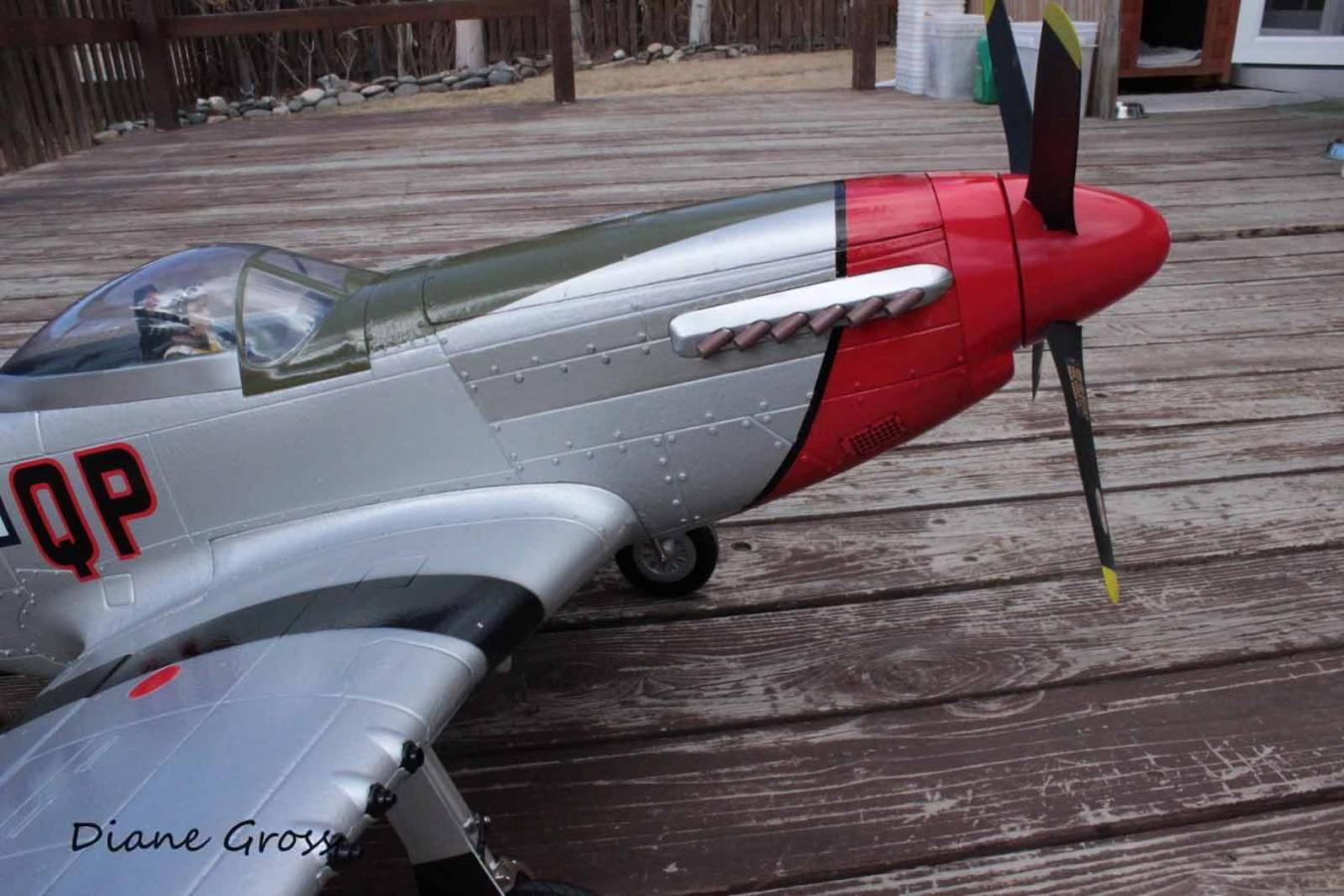

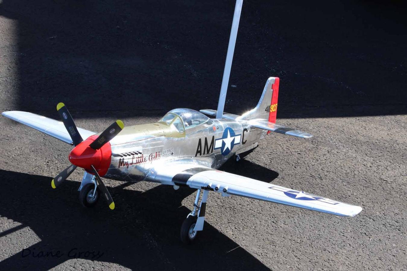

    My Little Gal I was one of the last Iron Ass Freewing P-51's as Motion was clearing them out, the price was good and I bought one. She was a pretty little plane and I used her for the first 'riveting' job I'd ever done, turned out great.
    Click image for larger version  Name:	IMG_6980.JPG Views:	1 Size:	150.8 KB ID:	154194
    Click image for larger version  Name:	IMG_7003.JPG Views:	1 Size:	156.3 KB ID:	154195Click image for larger version  Name:	IMG_7009.JPG Views:	1 Size:	127.5 KB ID:	154196
    But, unfortunately, she augured in after a perfect maiden, had a faulty landing gear sequencer the autopsy showed.

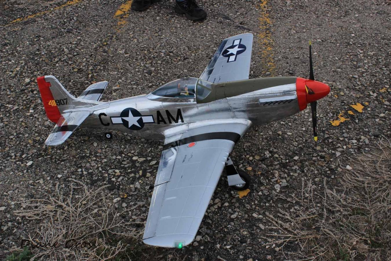

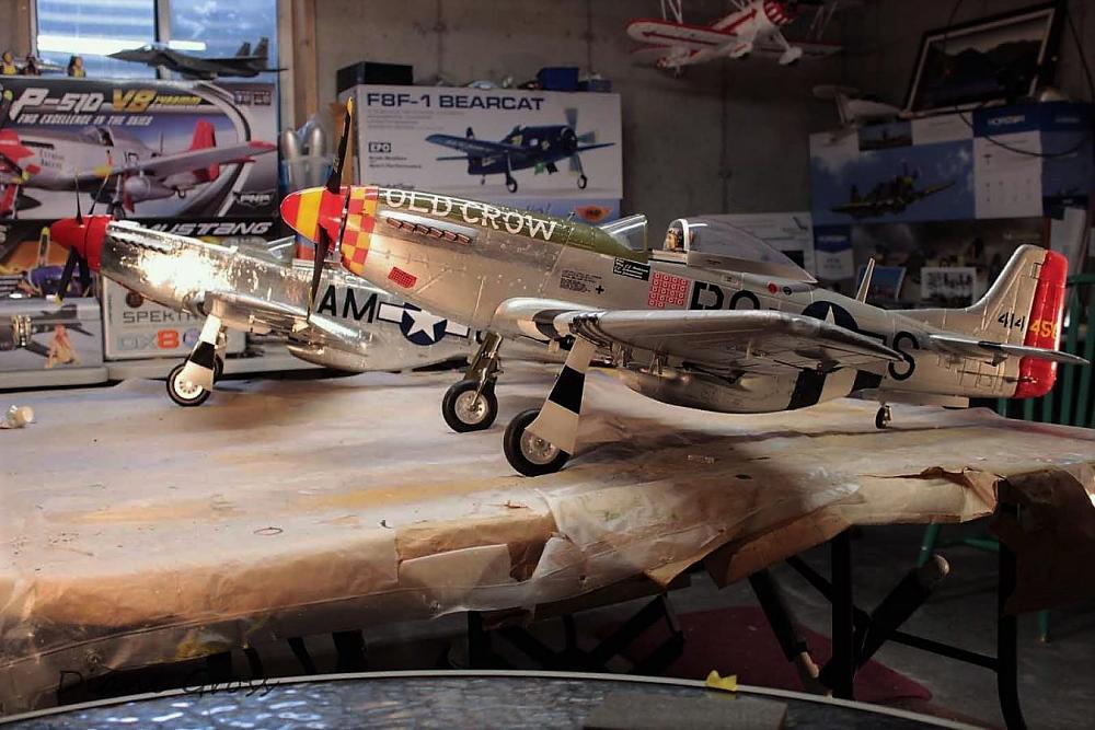

    She had a lot of fans! I took her to Nefi and had Captain Mike Maiden her for me as, with all the work I had in her, it was and remains the only airplane I own that I didn't personally maiden.
    The doo doo hit the fan one day and she just went straight into the ground, almost like her sister did. I was so disgusted that I brought the pieces home and put them in a parts box and there she sat for over a year.
    In the meantime, I robbed pieces like a retract off her for Old Crow, gear doors, that sort of thing and somewhere along the line I've misplaced the hatch cover, but its here somewhere.

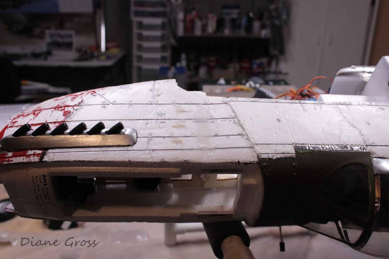

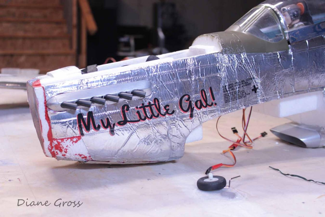

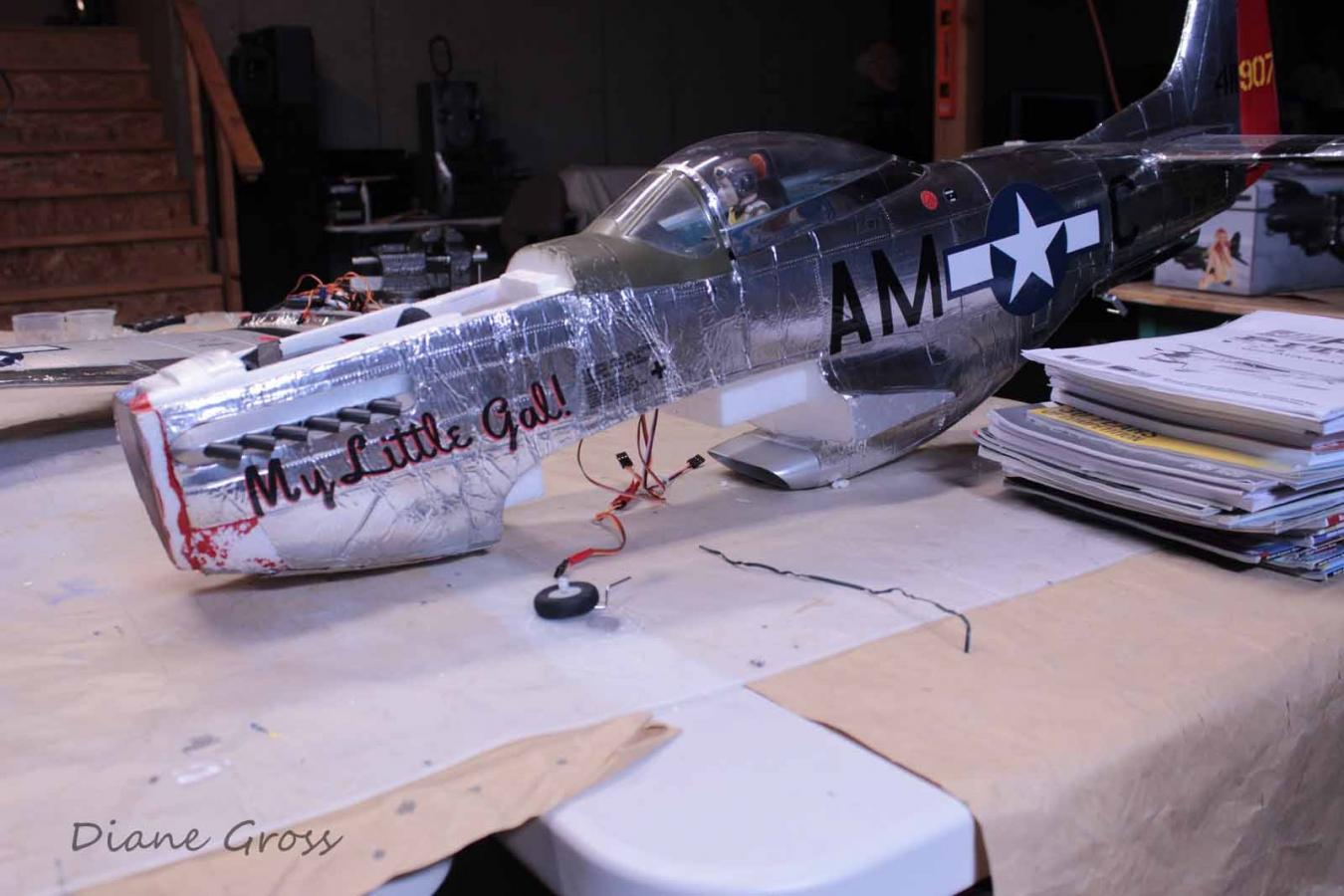

    First thing, remove the Flite Metal from the cockpit forward as the rest was in fine shape:

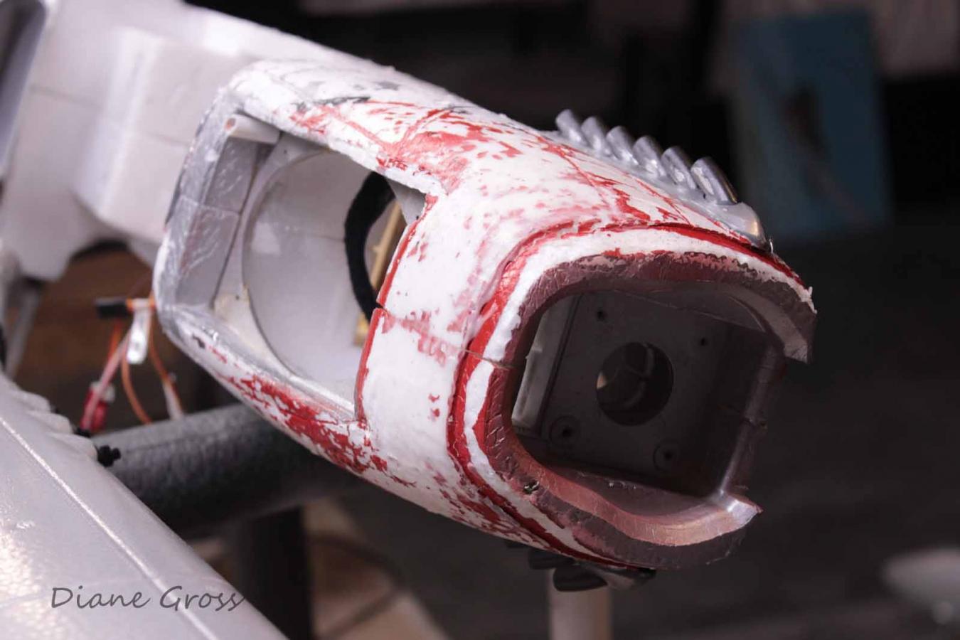

    Click image for larger version  Name:	IMG_4046.JPG Views:	1 Size:	117.2 KB ID:	154199Click image for larger version  Name:	IMG_4047.JPG Views:	1 Size:	128.7 KB ID:	154200Click image for larger version  Name:	IMG_4048.JPG Views:	1 Size:	97.6 KB ID:	154201Click image for larger version  Name:	IMG_4053.JPG Views:	1 Size:	80.5 KB ID:	154202

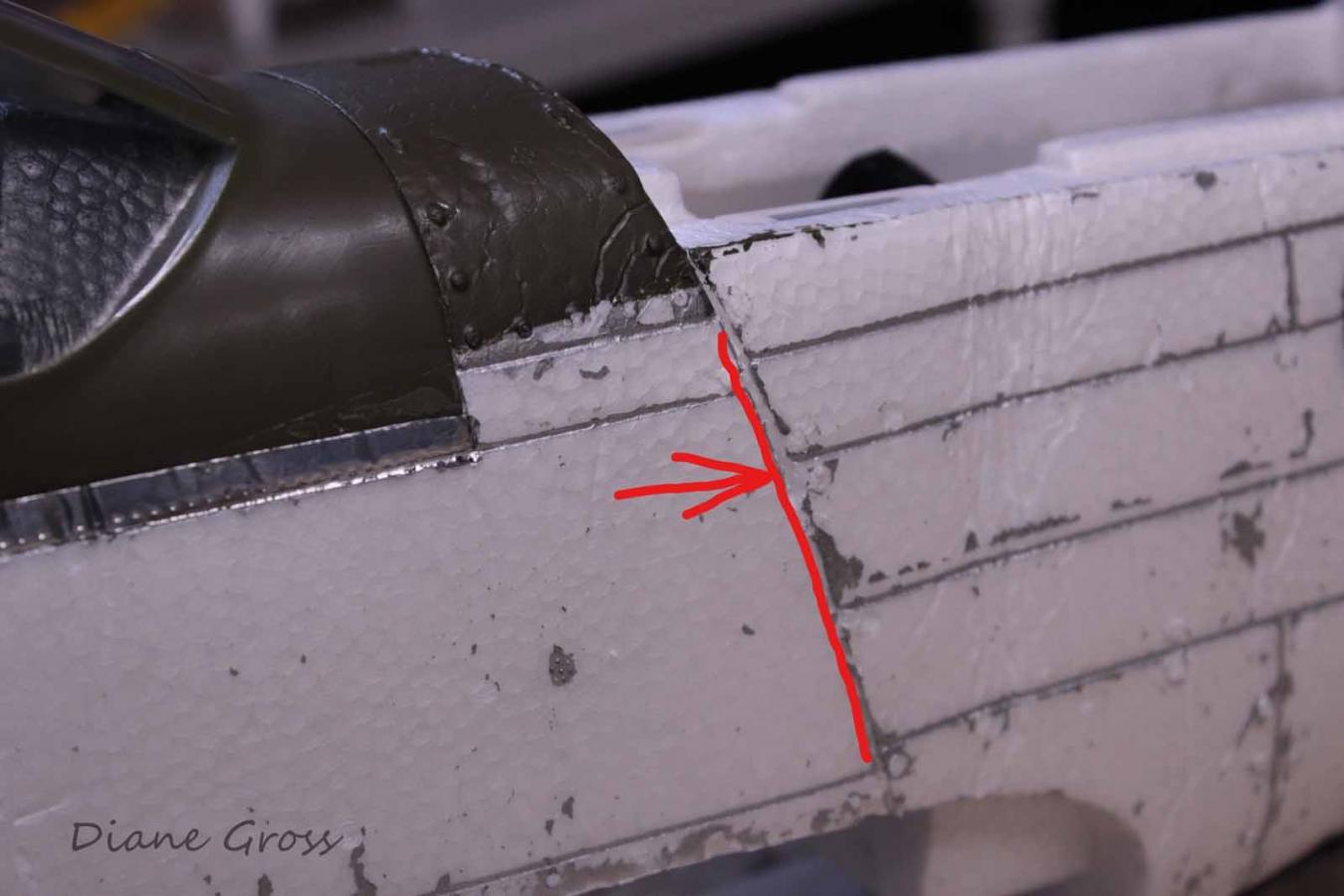

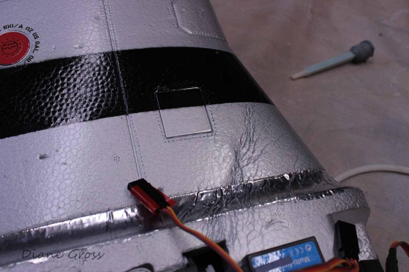

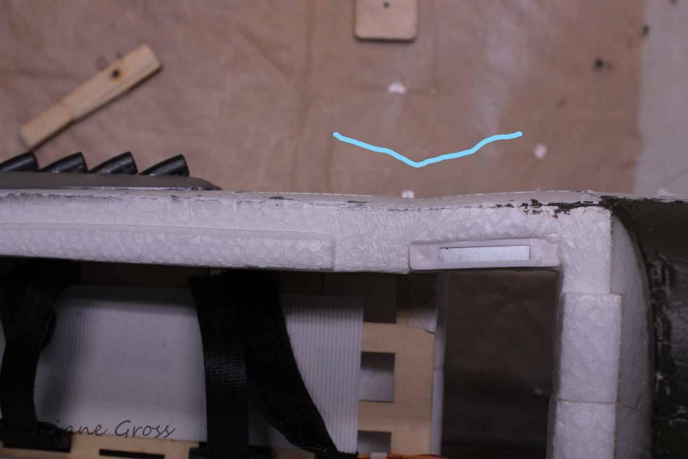

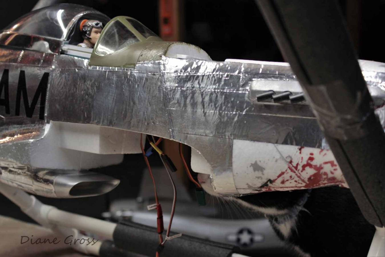

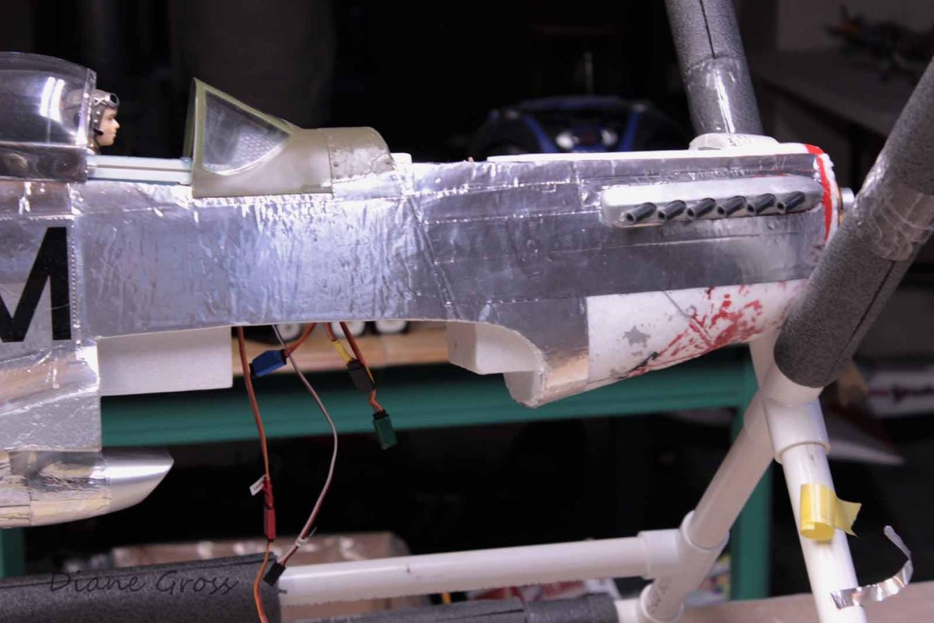

    Once the Flite Metal was off, I noticed a crack on the starboard side Click image for larger version  Name:	IMG_4054_LI.jpg Views:	1 Size:	85.2 KB ID:	154203
    Causing the nose to dimple in a bit
    Click image for larger version  Name:	IMG_4056_LI.jpg Views:	1 Size:	73.7 KB ID:	154204

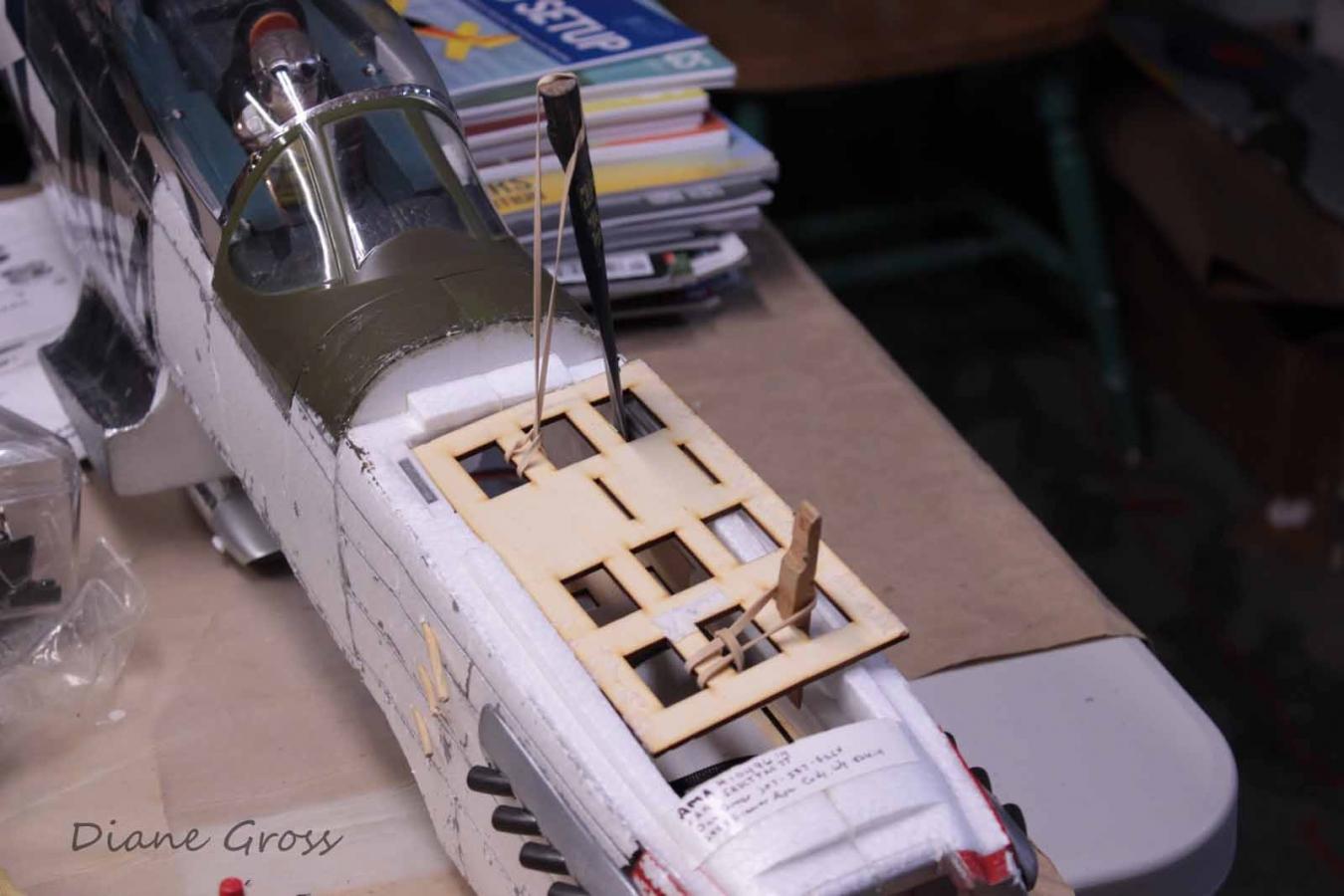

    So, the plan was to open the crack up slightly to get glue into it, then push from the inside to straightened the dimple out, then run three skewer sticks into the fuse to hold it in place.
    Afterwards, I added a balsa 'plate' to the inside of the fuse where the dimple was, using 5 minute Epoxy and two screws to hold it in place. As I couldn't get to the screw heads, I ran them all the way in and covered them with Epoxy and just pushed them into the foam to act as anchors.

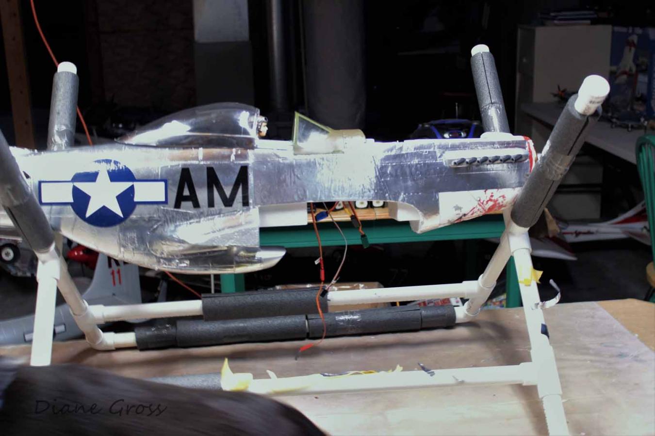

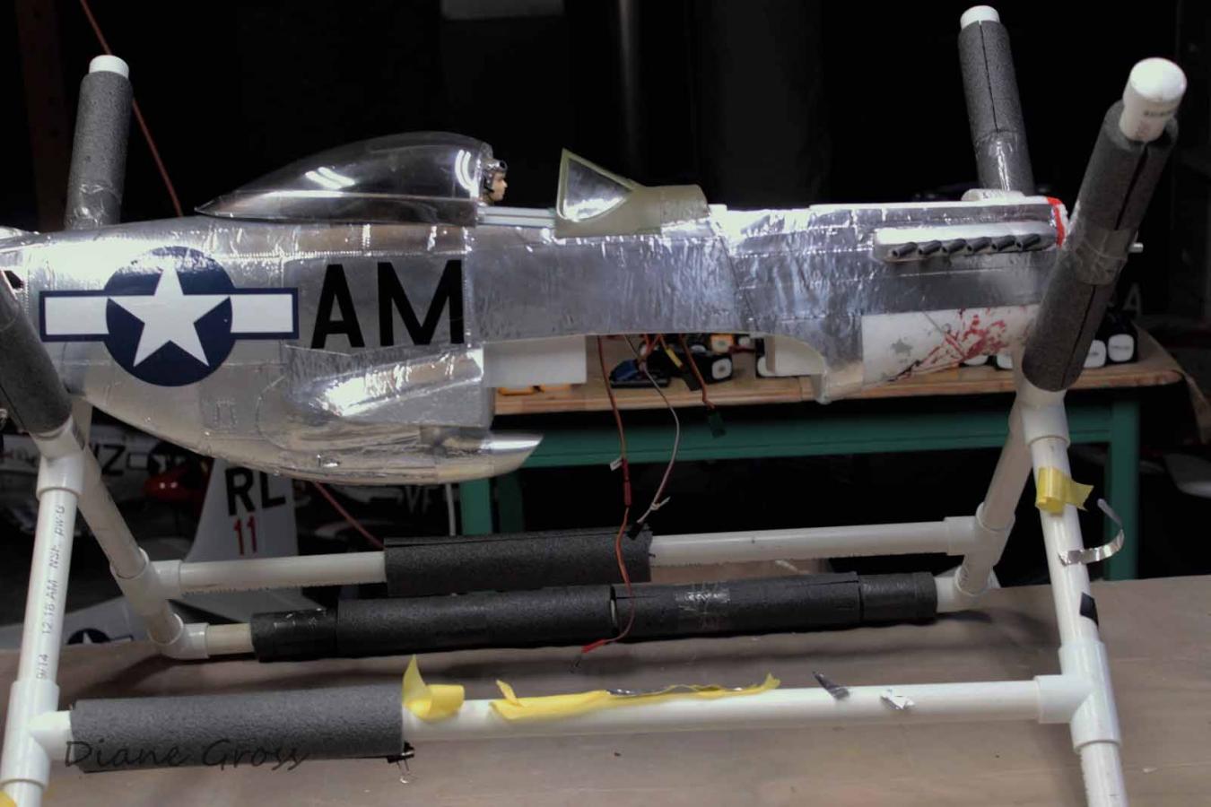

    Lastly, I MacGivered up a rig to hold it in place to let everything dry up. It makes me think of resetting a broken bone. Click image for larger version  Name:	IMG_4058.JPG Views:	1 Size:	93.9 KB ID:	154205Click image for larger version  Name:	IMG_4059.JPG Views:	1 Size:	99.4 KB ID:	154206Click image for larger version  Name:	IMG_4060.JPG Views:	1 Size:	133.7 KB ID:	154207
    So far so good. I'll let it set for a few days and will probably get to more near the end of the week. My plan is to trim the skewers down to match the surface, then, if all looks good, fill in all the wrinkles with Foam Filler, sand and then recover it with Flite Metal, which I still have enough left over to do. Then make a list of what I need and search it out.

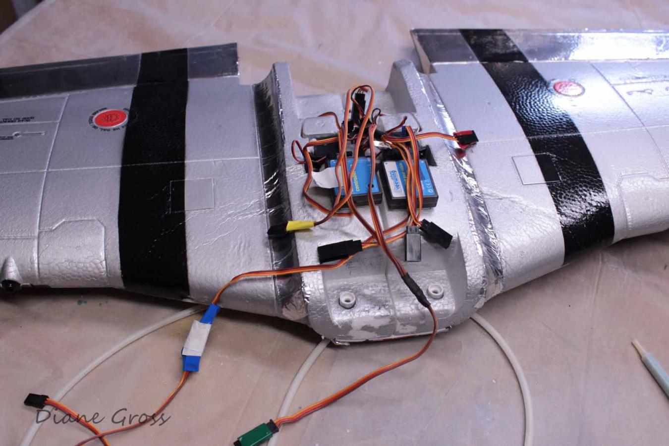

      I plane to run a 10 channel Lemon receiver with a brand spanking new A3L utilizing the capacitor that comes with it. She'll be running a 4280 580 kv (stock) motor and stock ESC.

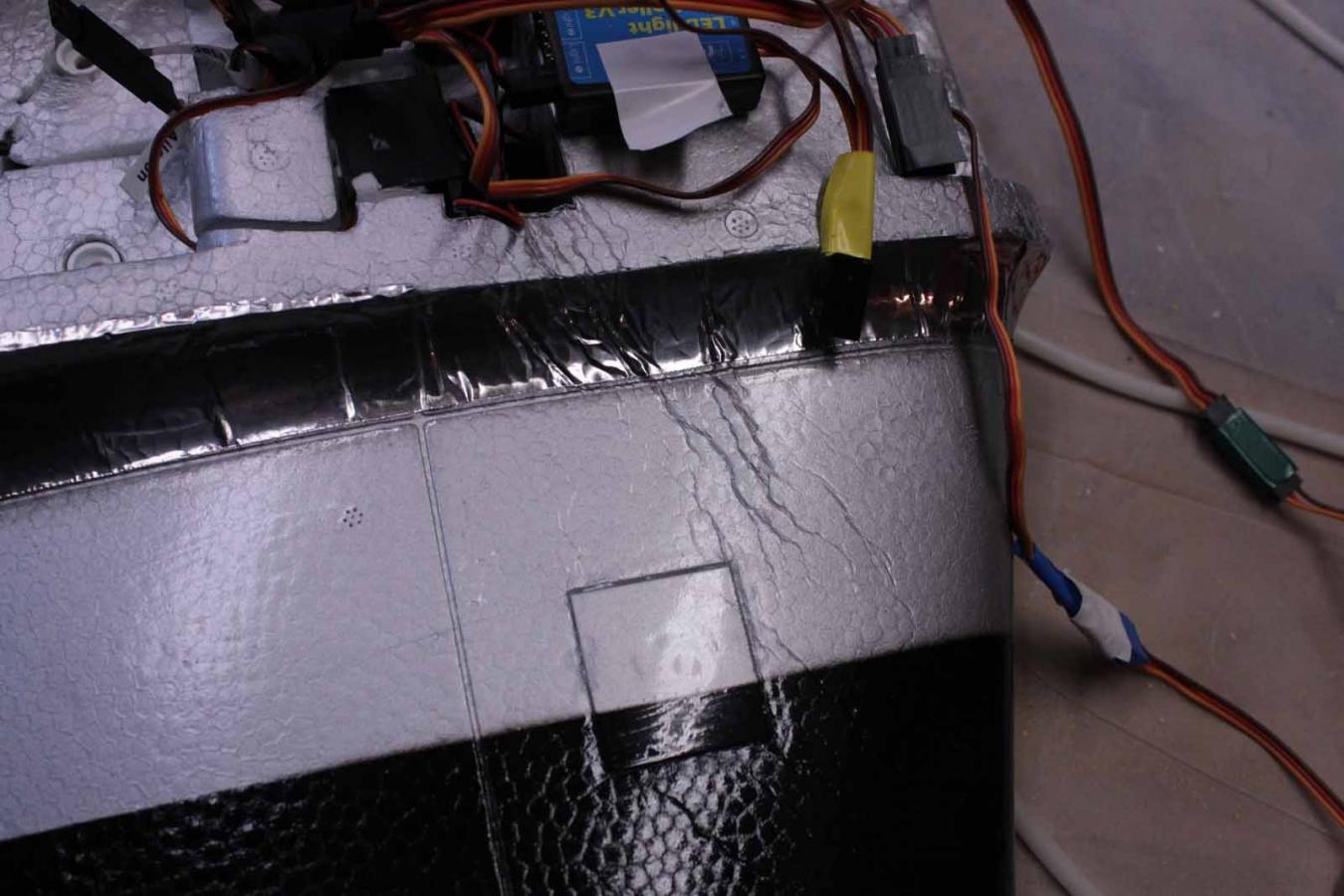

      Here's the wing:

      the only thing I have to replace on the wing is one landing gear light and reinstall the retract, have the retract itself installed, complete with original metal brace plate and a strut al ready to go onto it.

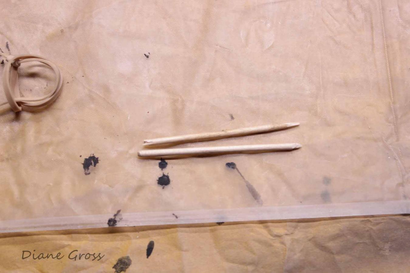

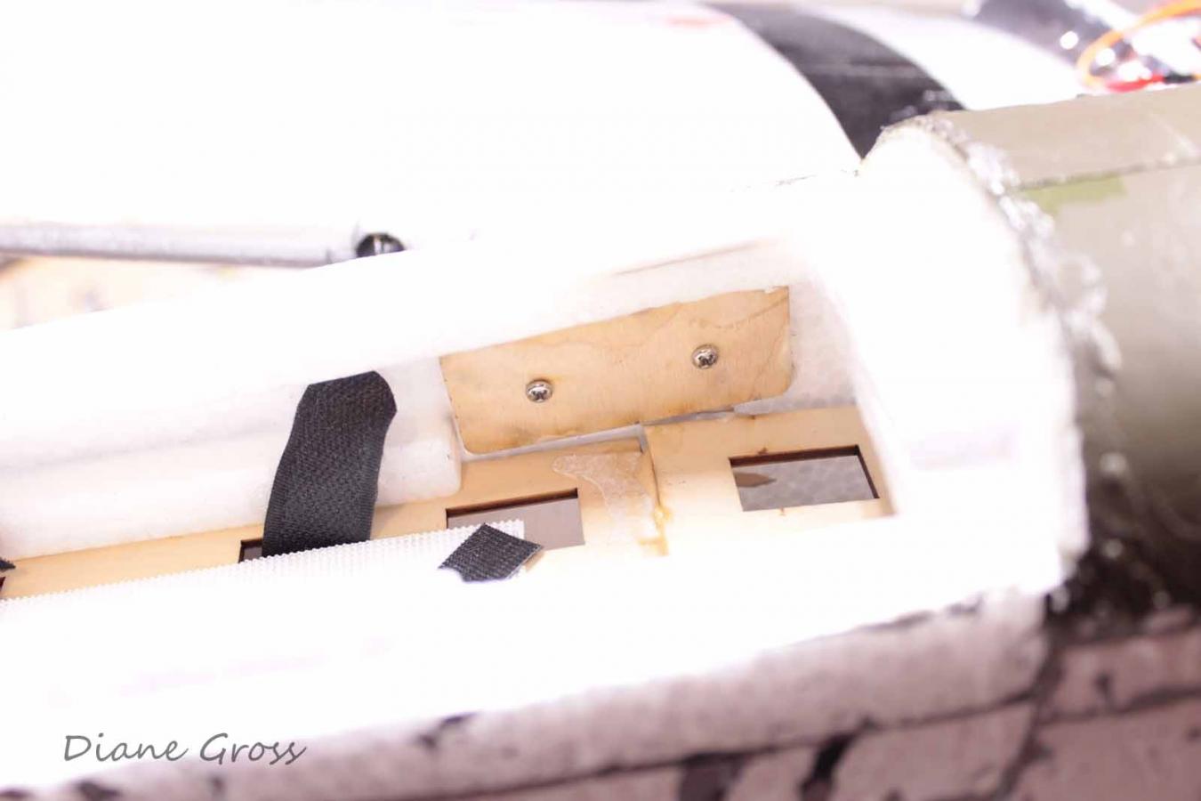

        The pins locked the nose back on and now it very rigid. The excess pin length sticking out I just trimmed off with an Exacto saw and filled in what was left of the indentation with Beacon Hill foam filler. Slowly working my way around the nose and filling it in. Also added a piece to the back of the battery bay to extend it for the receiver and the A3L, it should tidy it up a bit. I didn't have a spare nose cone so I rummaged through the old parts and found Old Crow's original nose cone. a bit of stripping and sanding then a coat of red paint and good as new. So far so good...

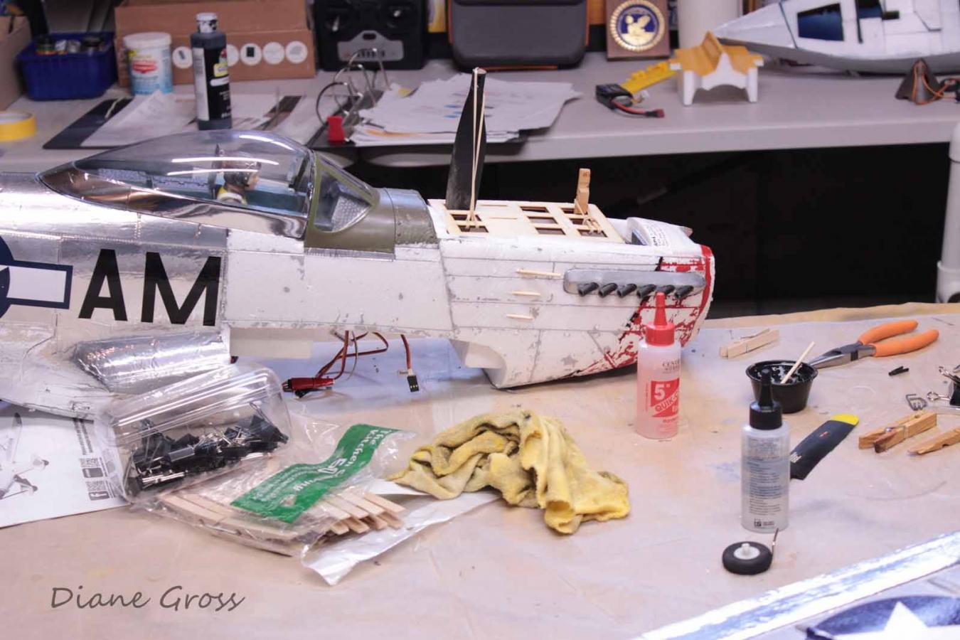

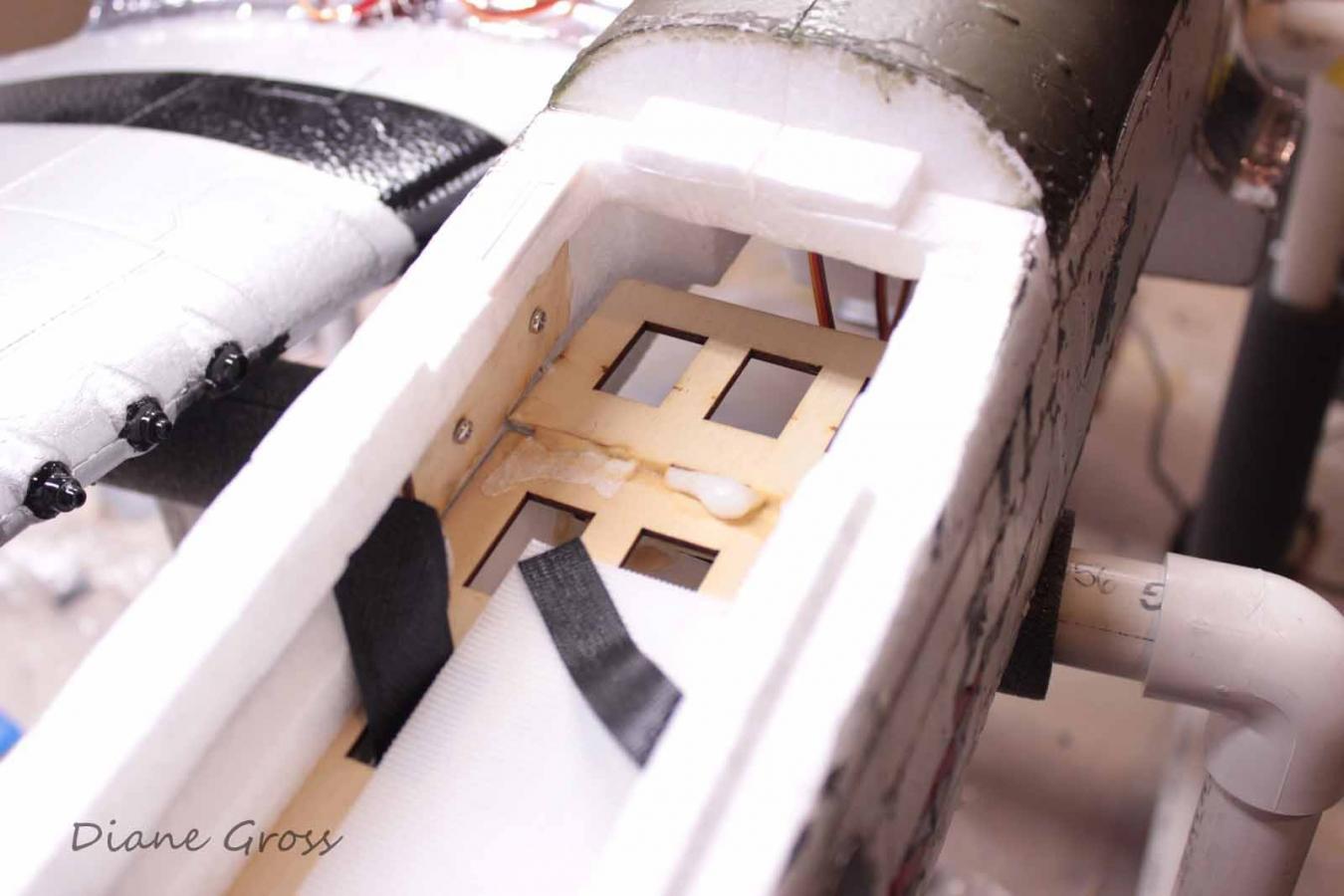

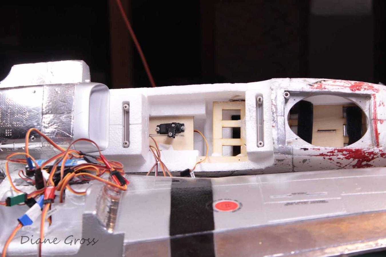

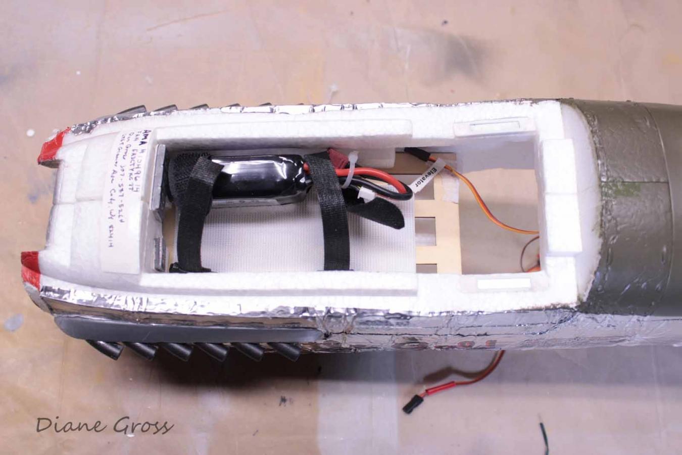

            This one shows the plate I put behind the bend in the foam as well as the extra decking for the receiver and the gyro... Still have to trim the Gorilla Glue back, but its in place
            Click image for larger version  Name:	IMG_4061.JPG Views:	1 Size:	89.5 KB ID:	154922
            Click image for larger version  Name:	IMG_4062.JPG Views:	1 Size:	61.2 KB ID:	154923

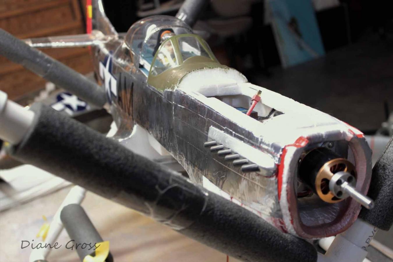

            The fuselage, showing the trimmed pins and the first layer of filler to help hide the small bend left in the foam
            Click image for larger version  Name:	IMG_4063.JPG Views:	1 Size:	99.8 KB ID:	154924
            The nose being slowly layered with Foam Filler
            Click image for larger version  Name:	IMG_4064.JPG Views:	1 Size:	93.0 KB ID:	154925

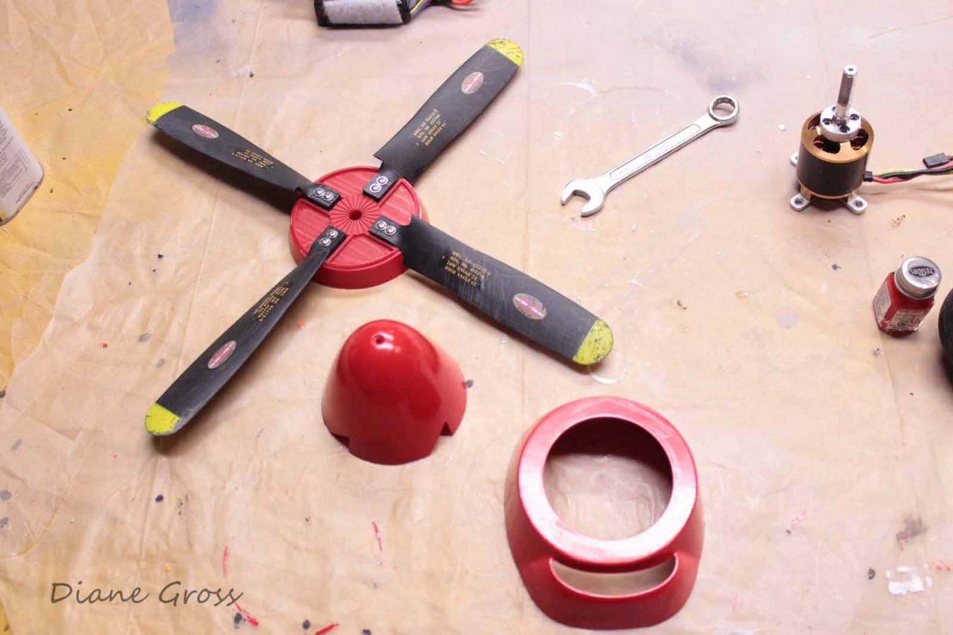

            The prop and spinner repainted. It's the original set of prop blades, still in good shape, amazing I didn't break one!!
            Click image for larger version  Name:	IMG_4065.JPG Views:	1 Size:	99.6 KB ID:	154926
            Still have some cleaning and painting to do on the blades.
            Looking into the fuselage from the bottom, showing the extra decking...and the maze of wires that is part of the Freewing P-51 experience. Good news is that all systems are working and as of now, the gear is complete and installed. A little cosmetic work on the wings to eliminate the wrinkles and they are good to go. Still looking through the pile to find the battery hatch and I could have sworn I had a spare 650 kv. If not, I'll either go with the 580 kv or order one in, haven't decided (In other words, haven't figured out how to convince the wife)
            Click image for larger version  Name:	IMG_4066.JPG Views:	1 Size:	105.6 KB ID:	154927

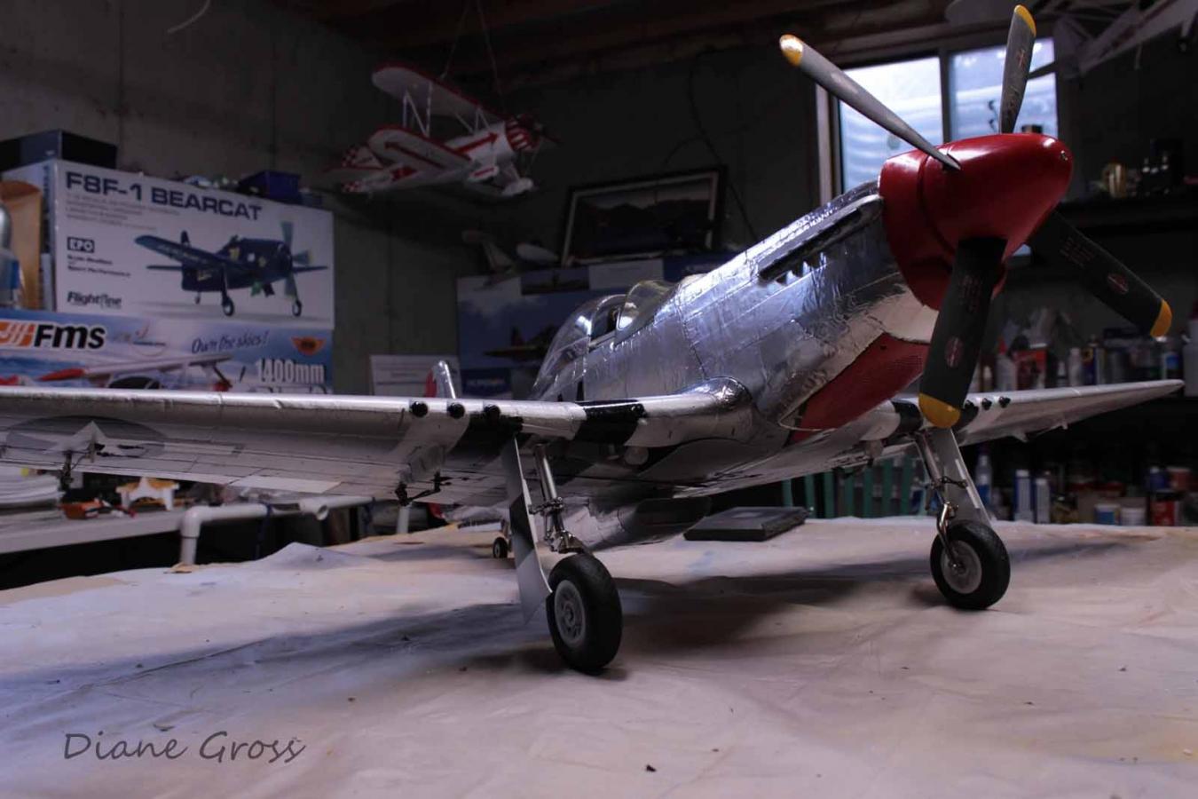

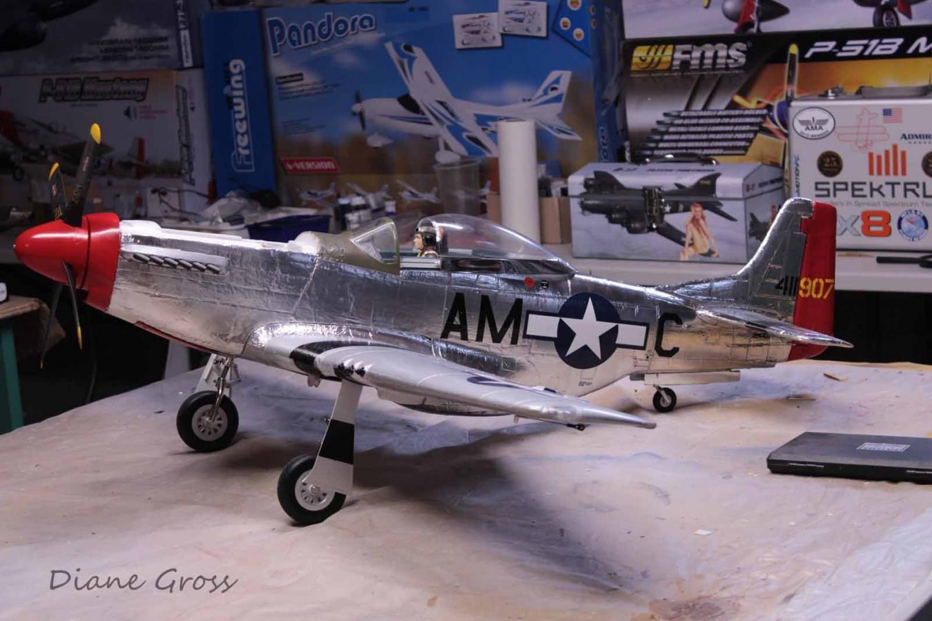

                              Sand and fill day, the first of many. I bound the receiver and did the wiring to the gyro all its ready for installation. Revisited some of the Flite Metal videos for a refresher, she's drying right now and should be about ready for another go at sanding.
                                • 7383
                                Well, no flying because its..
                                Click image for larger version  Name:	IMG_4067.JPG Views:	1 Size:	97.1 KB ID:	156192

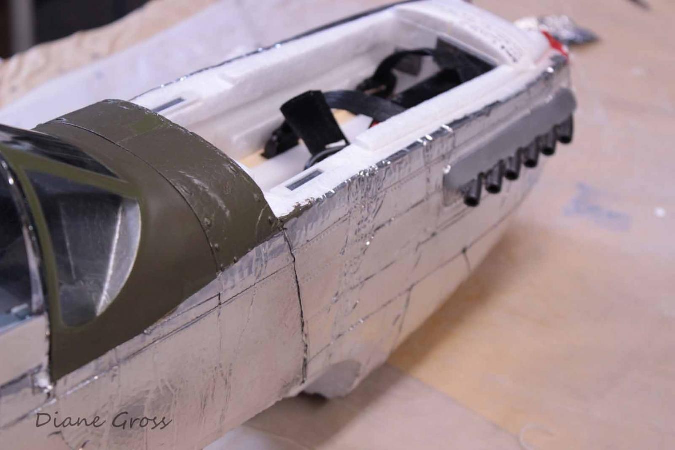

                                Here in Wyoming, so I started reapplying the Flite Metal, it doesn't photograph great, probably due the artificial lighting and the dullness of the basement, anyway, in real life he looks pretty good, once the rivets are on and the Flite Metal polished (Wenol)
                                She should look great....
                                Click image for larger version  Name:	IMG_4068.JPG Views:	1 Size:	110.3 KB ID:	156193Click image for larger version  Name:	IMG_4070.JPG Views:	1 Size:	108.8 KB ID:	156194Click image for larger version  Name:	IMG_4071.JPG Views:	1 Size:	101.6 KB ID:	156195Click image for larger version  Name:	IMG_4073.JPG Views:	1 Size:	107.8 KB ID:	156196Click image for larger version  Name:	IMG_4075.JPG Views:	1 Size:	107.1 KB ID:	156197
                                Not bad for a bird that lawn darted and was a right off for a year and a half.
                                  #17
                                  Man the years roll by faster and faster
                                    • 7383
                                    #18

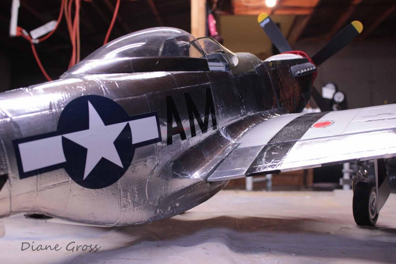

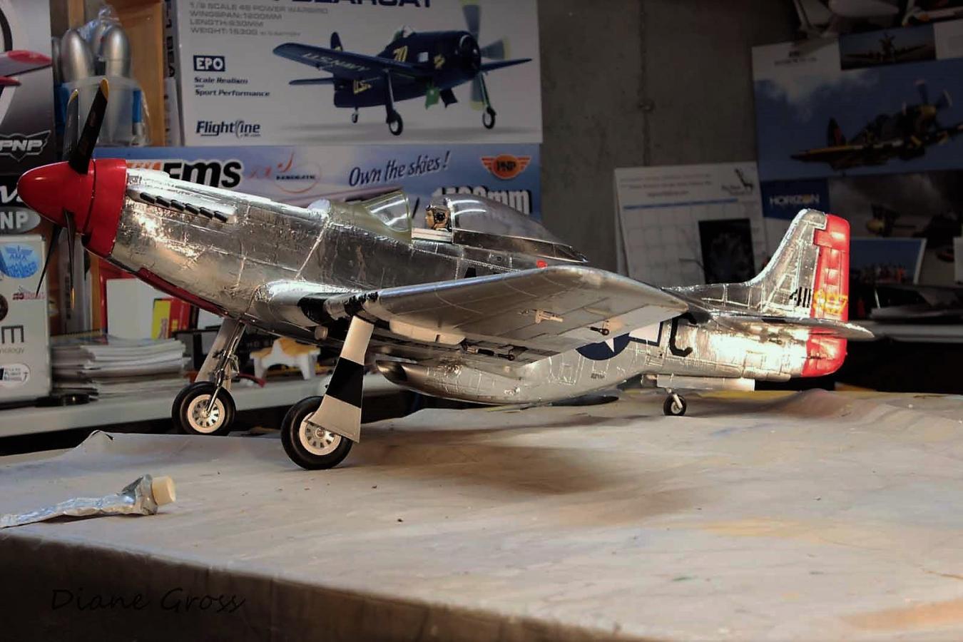

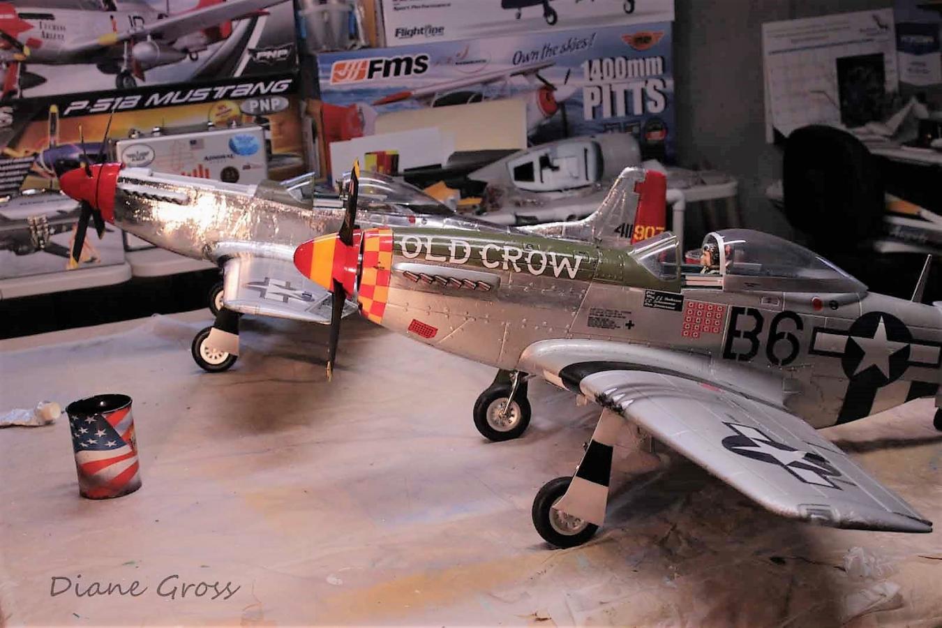

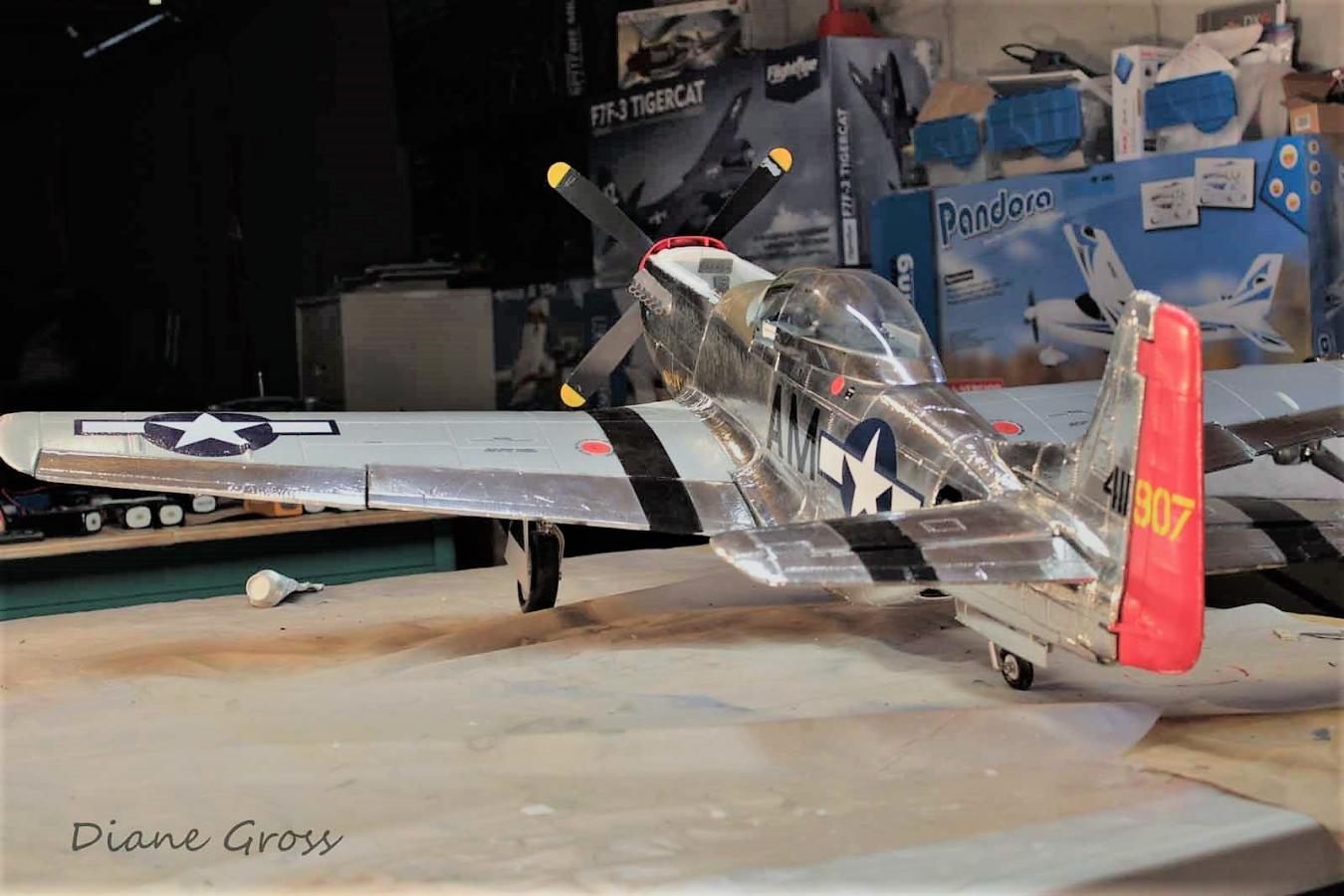

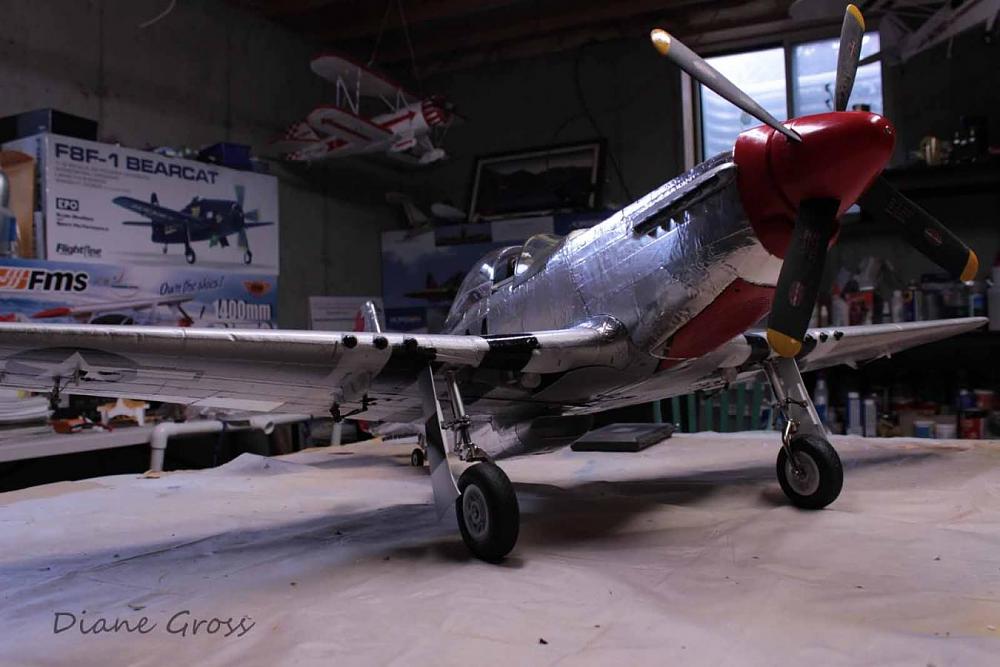

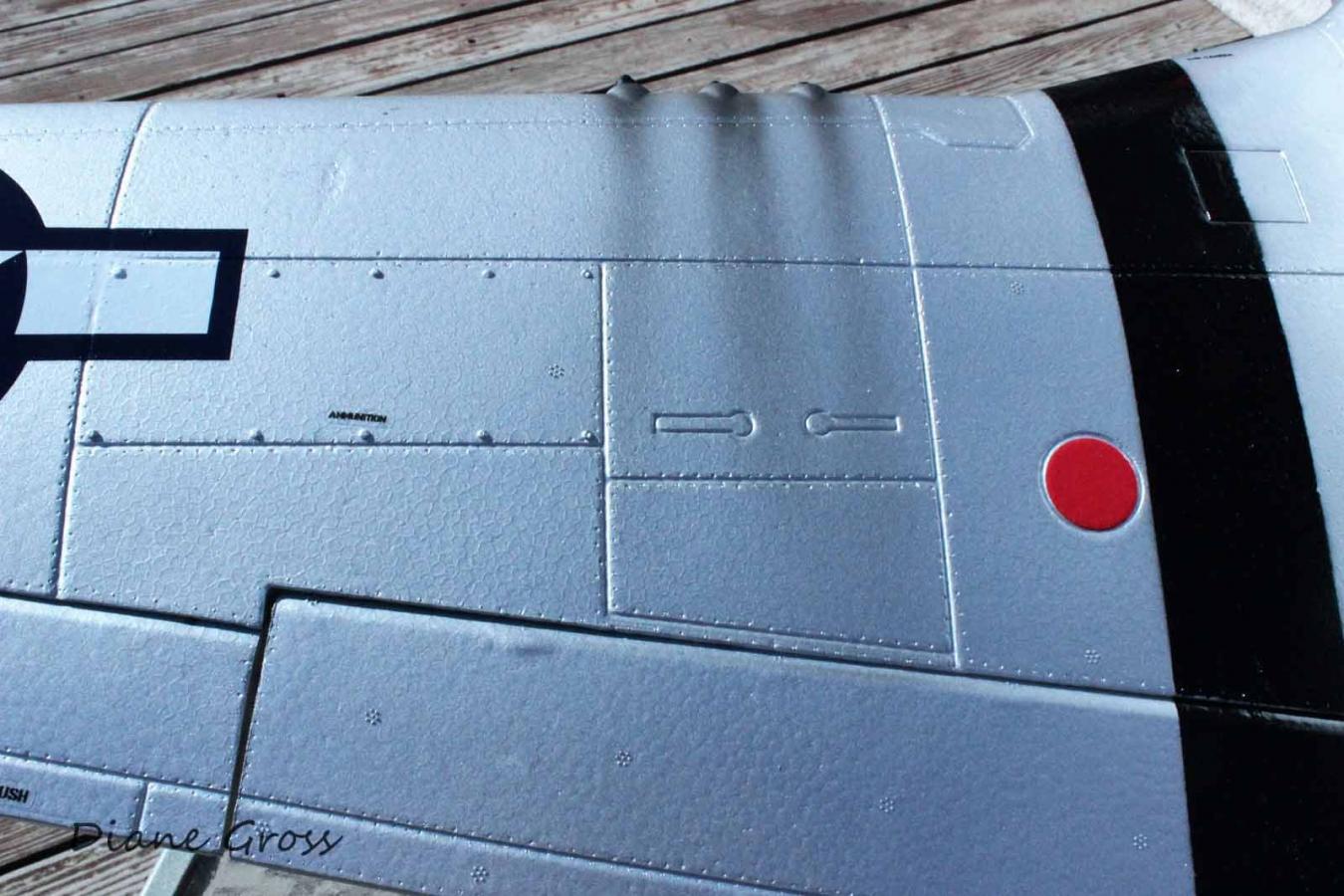

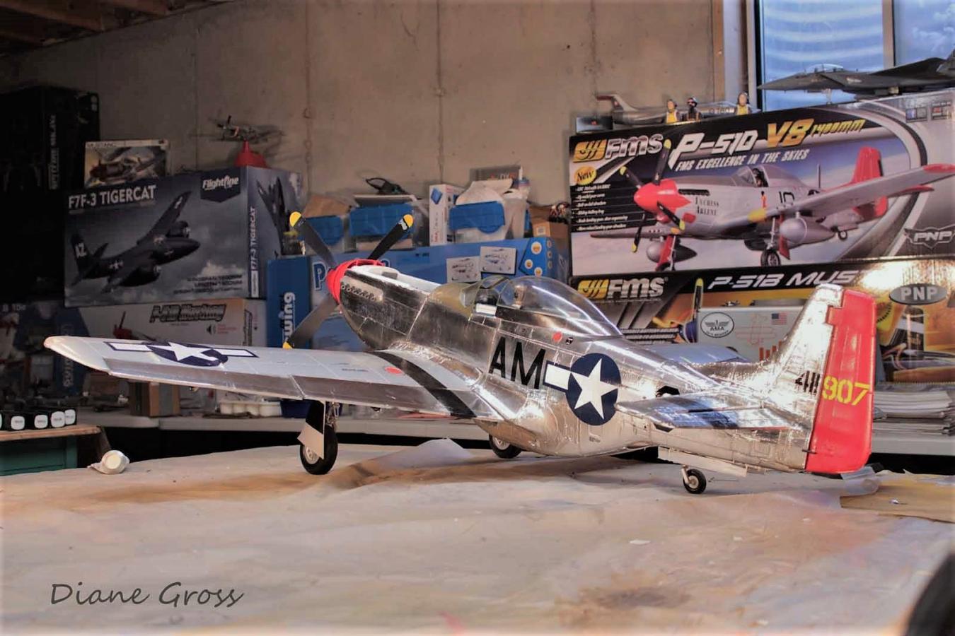

                                    Got that right RM, I had to look up the year she augured in, shortly after Nefi 2017. But here she is, minus her battery hatch, which I guess I'll have to break down and buy. It's like seeing a Ghost!!
                                    Anyway, you'll notice that the forward hatch is stock Iron Ass, that's from MLG I as well as the front wing joiner as well as assorted screws. This time, I plan to put the red nose aka Iron Ass in her as I figured she's a tribute to Iron Ass and My Little Gal I as well as herself...
                                    Click image for larger version  Name:	IMG_4077.JPG Views:	1 Size:	129.9 KB ID:	156224Click image for larger version  Name:	IMG_4078.JPG Views:	1 Size:	97.5 KB ID:	156225Click image for larger version  Name:	IMG_4079.JPG Views:	1 Size:	112.6 KB ID:	156226Click image for larger version  Name:	IMG_4080.JPG Views:	1 Size:	101.6 KB ID:	156227Click image for larger version  Name:	IMG_4081.JPG Views:	1 Size:	106.0 KB ID:	156228
                                    Still have rivet work to do as well as the wrinkles in the wing, but, compared to the work already done, it's minor. The great news is that all systems work, she has her original 4250 580 kv motor and stock ESC and everything purrs!!

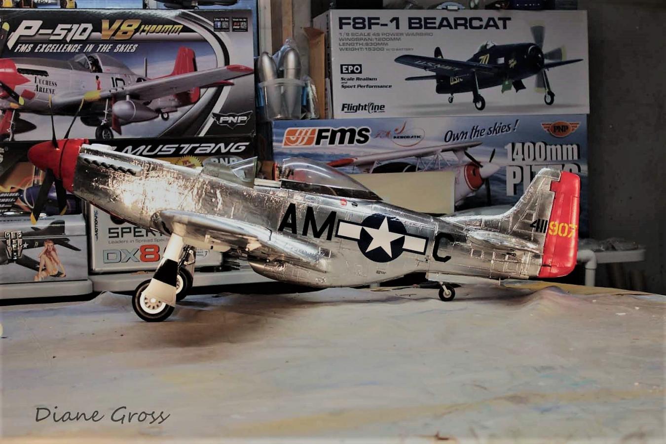

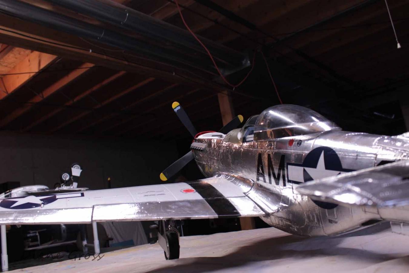

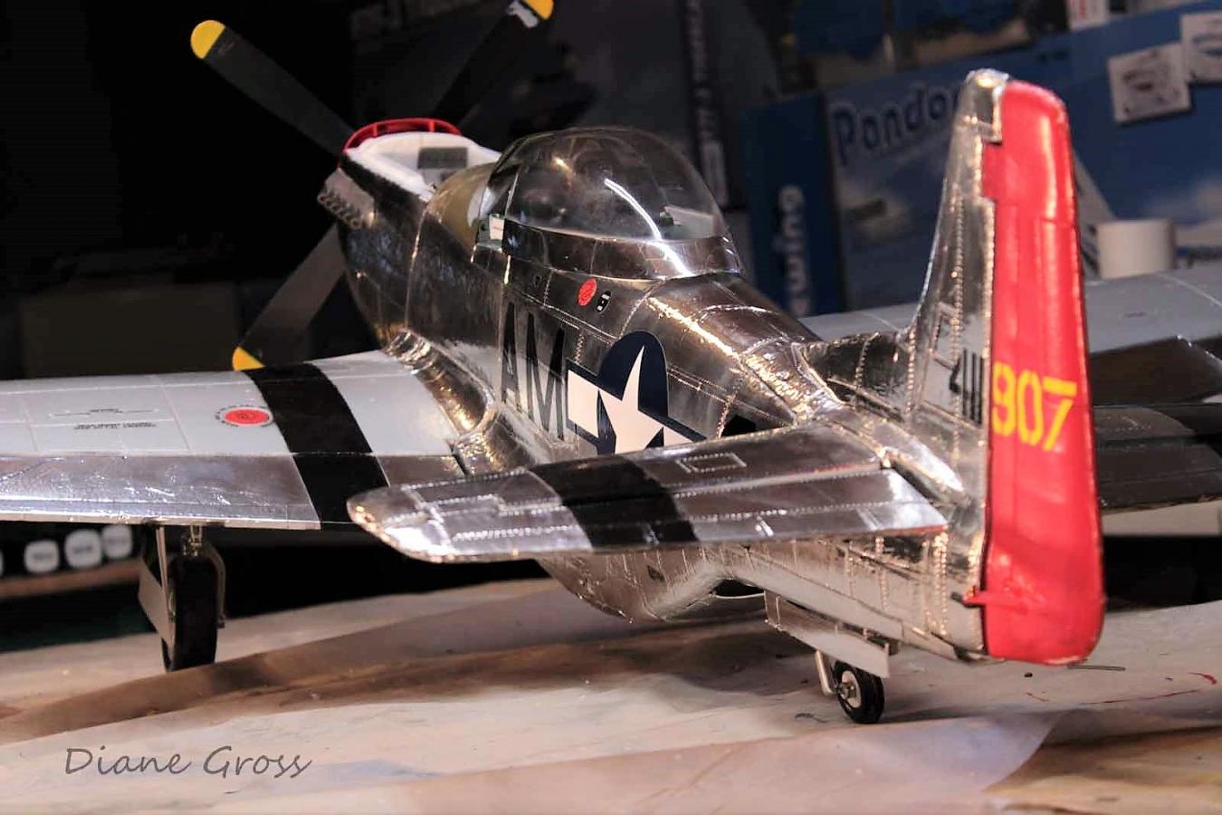

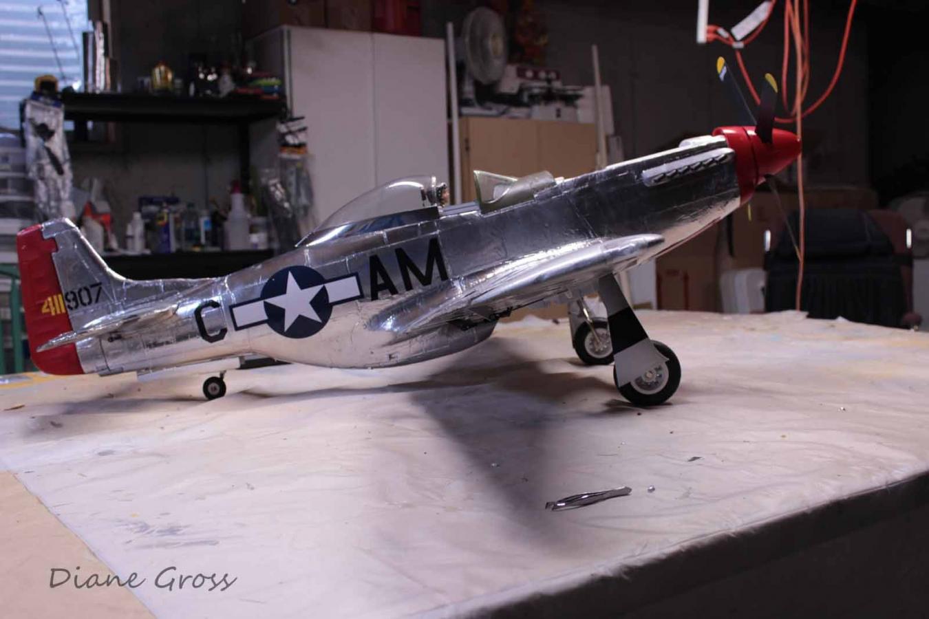

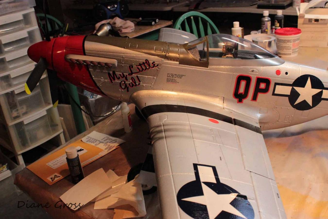

                                      Had some Euroglanz left over from the old DC-3 polishing days, very similar to Wenol, better IMHO, so
                                      I had to get some better pics...
ID:	156245Click image for larger version
ID:	156246Click image for larger version
ID:	156247Click image for larger version
ID:	156248Click image for larger version
ID:	156249Click image for larger version
ID:	156250Click image for larger version
                                      Now THAT"S better!!
                                      • deadbug
                                        "Y'all watch this...."
                                        • Jul 2018
                                        • 99
                                        • San Antonio, TX
                                        #20
                                        Wow. She's looking fantastic—...nice work Gman! I was wondering if all that Flite Metal work was worth it, but in that last picture it has the look of newly manufactured aluminum.
