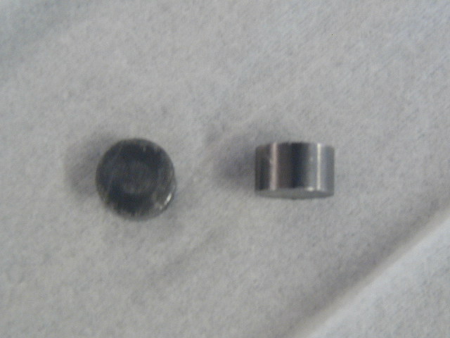

                    Using a Admiral 3000mAh 4s battery installed in the battery compartment I went to balance my 1400mm FMS Corsair.  I have a Great Planes C.G.machine so setting the rulers at 110mm I set the plane on the machine.  It was so nose heavy it wouldn't even stay on the machine.  So while trying to transfer some weight to the rear of the fuselage, I managed to break my motor mounts and have to buy a new fuse and cowling now.
                    Anyway, this is what I found in the front of the fuse.  These 2 very heavy weights.  If these are in the new fuse, I'm going to take them out and try balancing the plane that way.  Just thought I'd throw this in and show the folks that have tried to assist me in this process.  Thanks to all.
                    bagger

                      Hey Bagger!
                      That's pretty much what I found when I originally went to balance mine. What I found was I initially had the GO machine set out to far on the wing. The wing tapers in and that will cause the 110mm setting to be off. So I found setting the pads just where the wing starts to straighten out from the fuse it will stay on the cg machine but still was nose heavy. I then added the 1 ounce of weight like I previously told you which I don't like to do but it fixed the problem. Now that you found those weights I going to look at mine and see if there. Thanks for the info and let you know what I find. Good luck on yours and good flying!

                              I am not going to use the big honkin' weights that were in the front of my other Corsair. Going to see if I can get it balanced without them. They are at least 2 ozs. together so I figure that will make it not so nose heavy. I won't glue the cowling in place in case I have to use them. Will try everything else first.

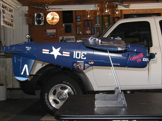

                                Here's where I balanced my Corsair.  A little nose heavy.  Only thing in the nose are the battery and the EMC.  The 2 weights I found in the nose are in the compartment where the vertical stabilizer slips into the slot.  If I added 1/2 oz more, plane would be level.  I'll give it a shot and see how it flies.  Thanks for the help guys.
                                bagger

                                  Hey Bagger!
                                  That's how mine looks when it sits on the GP balancer everyone says warbirds should be slightly nose heavy so you should be good. Mine flies fine. And I did look for those weights behind the cowl,but I didn't find any. Mystery! Anyway good luck and good flying.

                                        RE: c.g. balancing 1400mm corsair
                                        Hello bagger,
                                        Very interesting about finding weights inside the cowl and removing/relocating to the tail. The bird appears in your pic of post #16 to be in proper balance config with the CG set(as you said) at the 110 factory recommendation. That weight relocation I have to believe is gonna have to help keep it from being nose tipsy during taxi. Please give a follow up on how it flies with this configuration. As I had mentioned back in my post #4 to ya, my CG was at the RCgroups recommended 95. You have sparked my interest as to whether or not the real CG is 110 and these hidden weights has been some trickery. If your flight proves positive I will tear the cowl off mine to find those weights and relocate them as you did in order to make it better on ground handling. Can't wait to hear how it goes!!!
