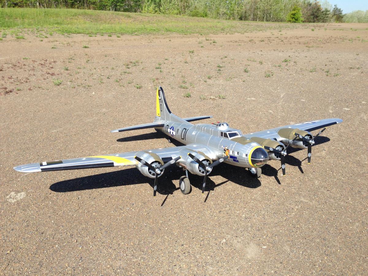

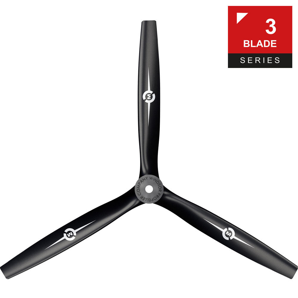

    I’ve been using MAS 9 x 7 x 3 blades on mine.
      9x7 - 3-Blade Propellers for Model R/C Airplanes   3 blade model airplane propellers specially developed for the most demanding hobby professionals. Great performance and scale look both for electric motors and glow engines. Carefully crafted from Glass Fiber Reinforced Composite. Available in sizes 5" to 18".   Prop
    Available in left and right.
    Those fit on ParkZone Stinson collets and spinners.
    The motor shafts were trimmed shorter to fit.

      Thank you for the advice I checked into those and they were a little too big I dont have room for anything bigger then a 7.5 diameter prop and that's so close to the fuselage that it's not funny but I did order a set of master airscrew 7x4 3 bladed props and will post on how they work out I tried finding 7x6x3 but they didnt have both cw and ccw blades and that's why I went to the 7x4x3 they had so wish me luck!

        Careful, That isn't a freewing B-17 in the picture. That is the much bigger Sonic Modells. Props are different.
