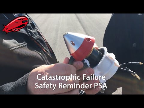

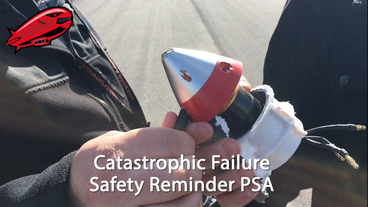

    One day at the air field we were trying to get the Flightline Spitfire to fly correctly and its just been giving us grief. We are just about ready to give up on this plane, because it just won't fly correctly. Its crashed several times without us knowing why. On faster passes down the run way, it has just went into spiral of death. This plane has not been the best second hand purchase. In the video, was a bad day of flying and we wanted to see this plane fly. We already crashed several planes that day. So when it did not want to take off properly, we tried to hand lunch it. Before the hand lunch we did do a thrust check.

    Why were there lead weights in the front of the plane? You said "for counter balance". Well, counter balance of what? Where were they exactly? Who put them there? After they were put there, was the whole assembly balanced? It may not have been pilot error, but it may have been owner error. Nobody I know would do a "thrust test" on the ground while standing over the engine or prop. We always stand behind the plane and ensure that nobody is in line with the rotational axis of the prop. Holding the plane like that to do a "thrust test" wasn't the best idea. Just curious how much RC experience do you guys have???

                So a couple things stick out in my mind here.
                First, he says the plane has crashed multiple times. I wonder how many blade strikes that prop had gone through before exploding.
                Second, that is NOT the spinner that comes stock on the Spitfire. That's the spinner from the silver P-38. The Spitty has a faded yellow spinner with a 4-blade prop.
                So I think one of two things happened. Either one or more prop strikes stressed a blade and/or the hub, or the spinner/blades couldn't handle the power of the stock Spitty motor. Definitely not a "plane issue" as stated in the video.
                I think the PSA here is "What not to do at the flying field."

                    I just watched the video. Why would anyone hold a plane by a wing tip and then have someone run-up the motor? I also noticed that the guy with the transmitter elected to stand quite a distance away from the guy holding the plane. Did he know something about the plane and was wondering if anything would happen when he advanced the throttle?
                    I can just see it: Transmitter guy says: "You hold on to the plane by the wingtip and stand waaaaay over there......, so if the plane explodes, I won't get hurt!!"
                    Then the plane holder guy says" "Duuuhh, yeah....., O K."
                    If so, "with friends like that...........," well, we all know how that old saying ends.
                    I agree with xviper when he said: "Holding the plane like that to do a "thrust test" wasn't the best idea. Just curious how much RC experience do you guys have???"
                    Their actions were certainly more than very foolish and no thought at all was given to safety.

                                Please, check any second hand planes very thoroughly and do the same after a crash so something like this does not happen. Second hand planes are often a great deal but they need to be inspected. He said he crashed it multiple times. Again, planes need to be inspected for loose motors, motor mounts, bent prop shafts, or weakened or cracked prop blades or spinners after a crash. When a single weak blade breaks on a 3 or 4 blade setup, you instantly have a massively out of balance situation which will cause a blow up like this. A bent motor shaft or loose motor mount will cause an imbalance leading to the same blow up. He is NOT using the stock spinner and prop so I wonder if they changed it after a crash or the original owner did this. I suspect the aftermarket spinner and prop were not balanced before installation. An unbalanced spinner and prop will cause a blow out like this. It is also possible they used a thread locker such as Loctite on the plastic spinner, prop, or motor mount. Thread lockers like Loctite eat plastic causing cracking and weakness. This will also cause what they saw. Unfortunately, when it blows up, he appears to think it was caused by the counter weight. The weight is not the reason the front blew up. I cannot see how it could be ingested by the motor based on its position. It isn't installed within the motor cavity. The weight is only exposed AFTER the blow up but it is not the cause.
                                Videos like this can help show people what not to do. The vast majority of "what not to do" was not covered in the video (I.E. don't throttle up a plane when you are staring into the prop or are anywhere near the prop, make sure your aftermarket spinner and prop are balanced, don't use loctite on plastic, thoroughly check a plane after a crash before flying it again, etc). Safety first. I hope everyone, including magergamer can learn from this. again, please, check any second hand planes very thoroughly and do the same after a crash so something like this does not happen.
