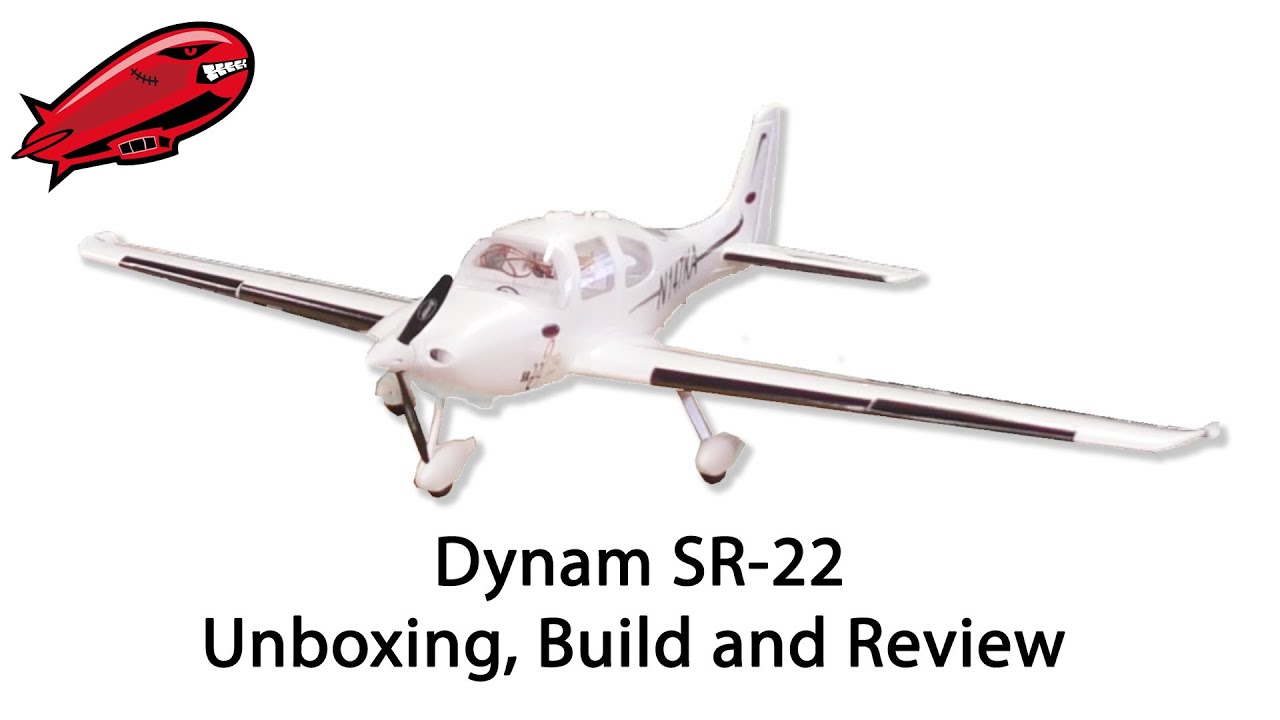

    Coming in at $109 can this plane compete with the E-Flite Cirrus?
    Not likely but check out the video and make your own decisions.
