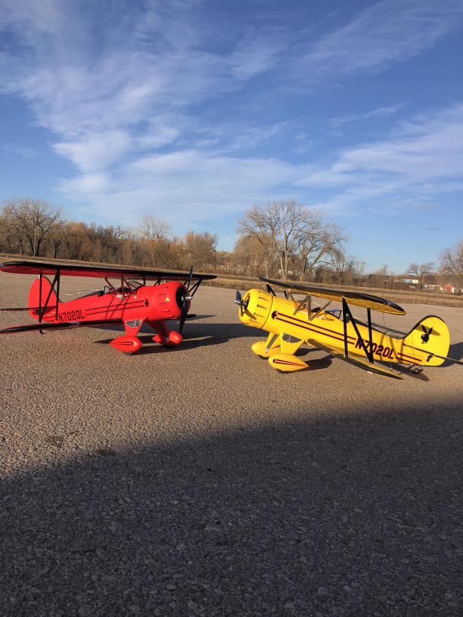

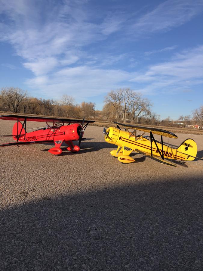

                                Appalling Quality Control is an understatement Not only all the above but add these to the list I have two a yellow and the red Waco. The wheel axles were smaller than the hole for the axle had to make bushing for both, both the ESC's were hook up wrong both ran the props the wrong rotation the wing tip strope light are incorrectly installed (green left red right had to switch these on both planes. When checking the elev. foam hinge they broke off replaced with pinned hinges on both planes and I could go on and on, Warped wing halfs warped rudder and vertical fin, warped horizontal fin and elev halfs on both planes I spent almost 25 hrs of assembly and repair on these two low quality Dynum Wacos once done the look good and the flight careristics are good at best.

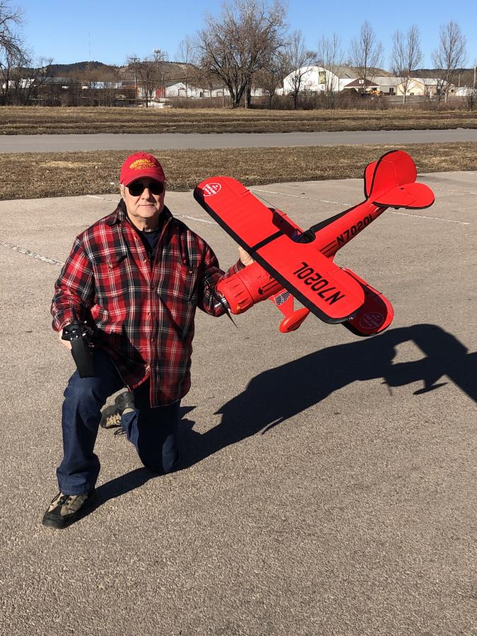

                                    We went out and flew these today with a very good friend of mine. Great flying birds put they took a lot of changes before they were ready. Hate the soft foam and poor quality put they fly nice, very scale
