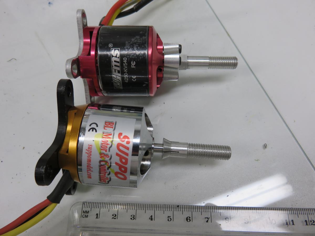

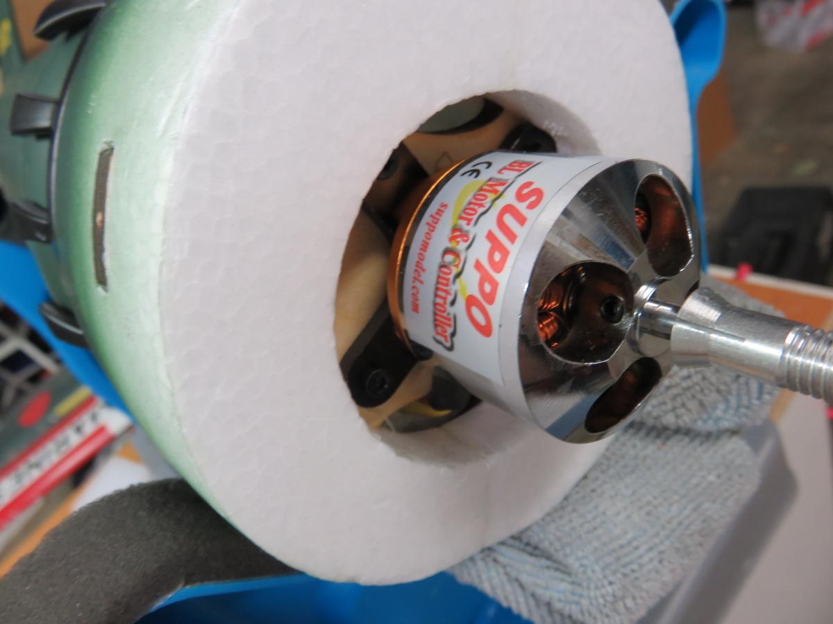

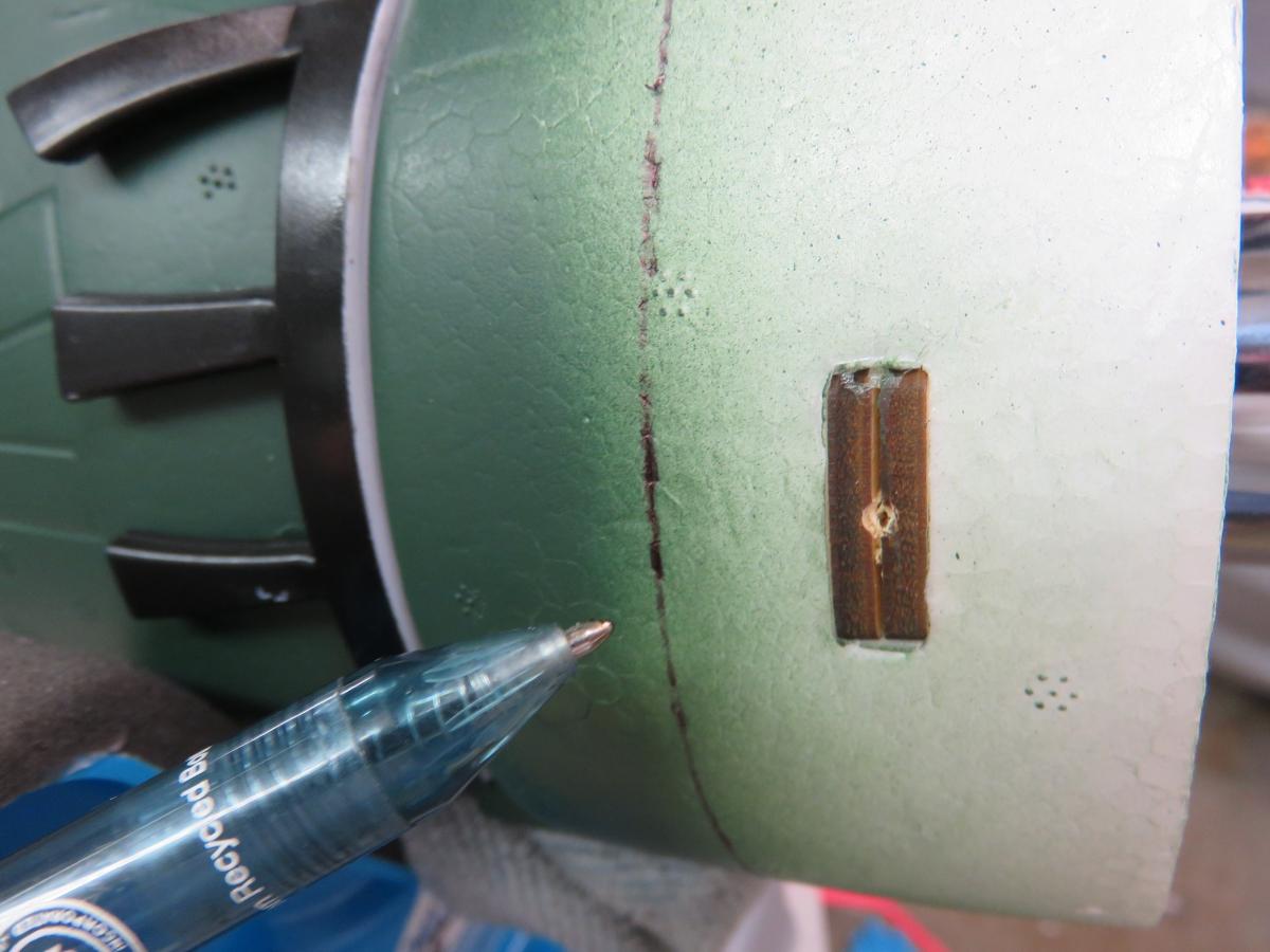

ID:	267313 I agree that it is a really nice plane. I did the same as you buying the kit from Richard. I changed the motor on mine. I had to cut the firewall out and reposition it to fit. Gobs of power now and gets 8 to 10 minutes flight time on a 3300 4S battery. Prop is a three blade MAS. I removed one of the two weights in the nose and added a sound system. I plan on adding a bomb drop, but need to upgrade the receiver as I ran out of channels. Just wish the landing gear were stronger. A great platform like the real one. No bad habits and a pleasure to fly. Click image for larger version
