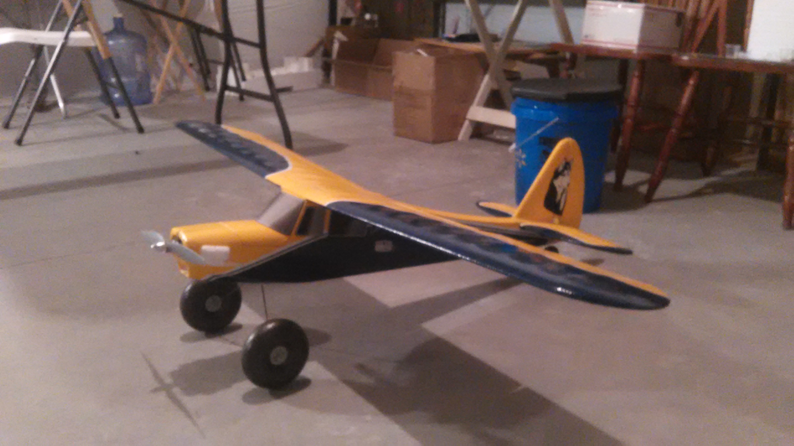

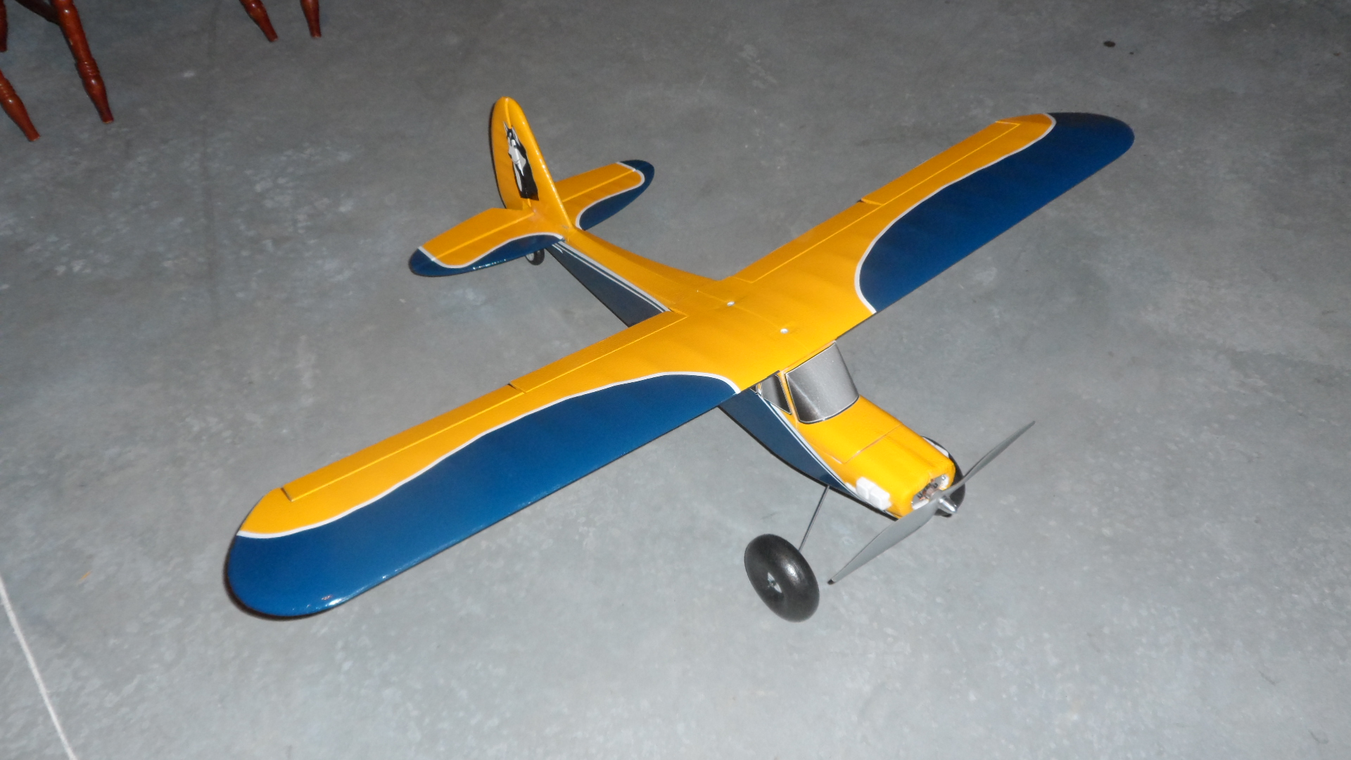

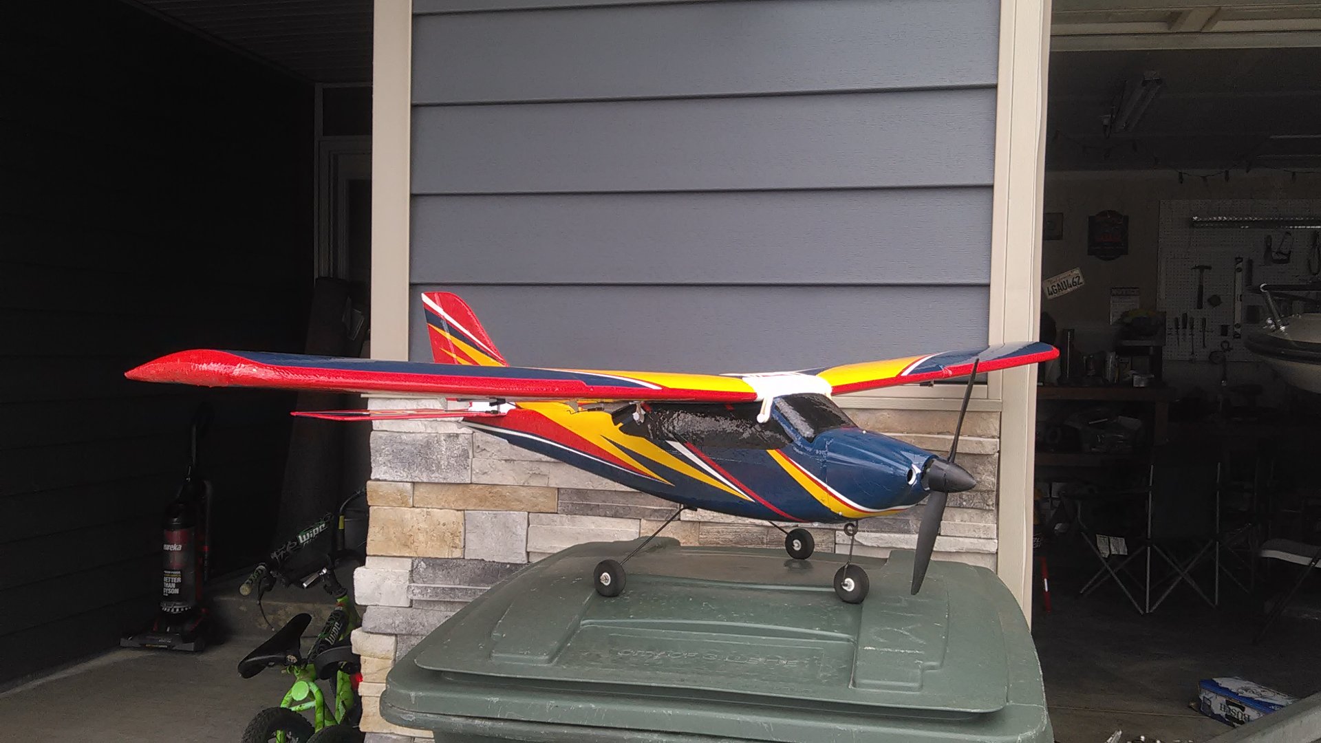

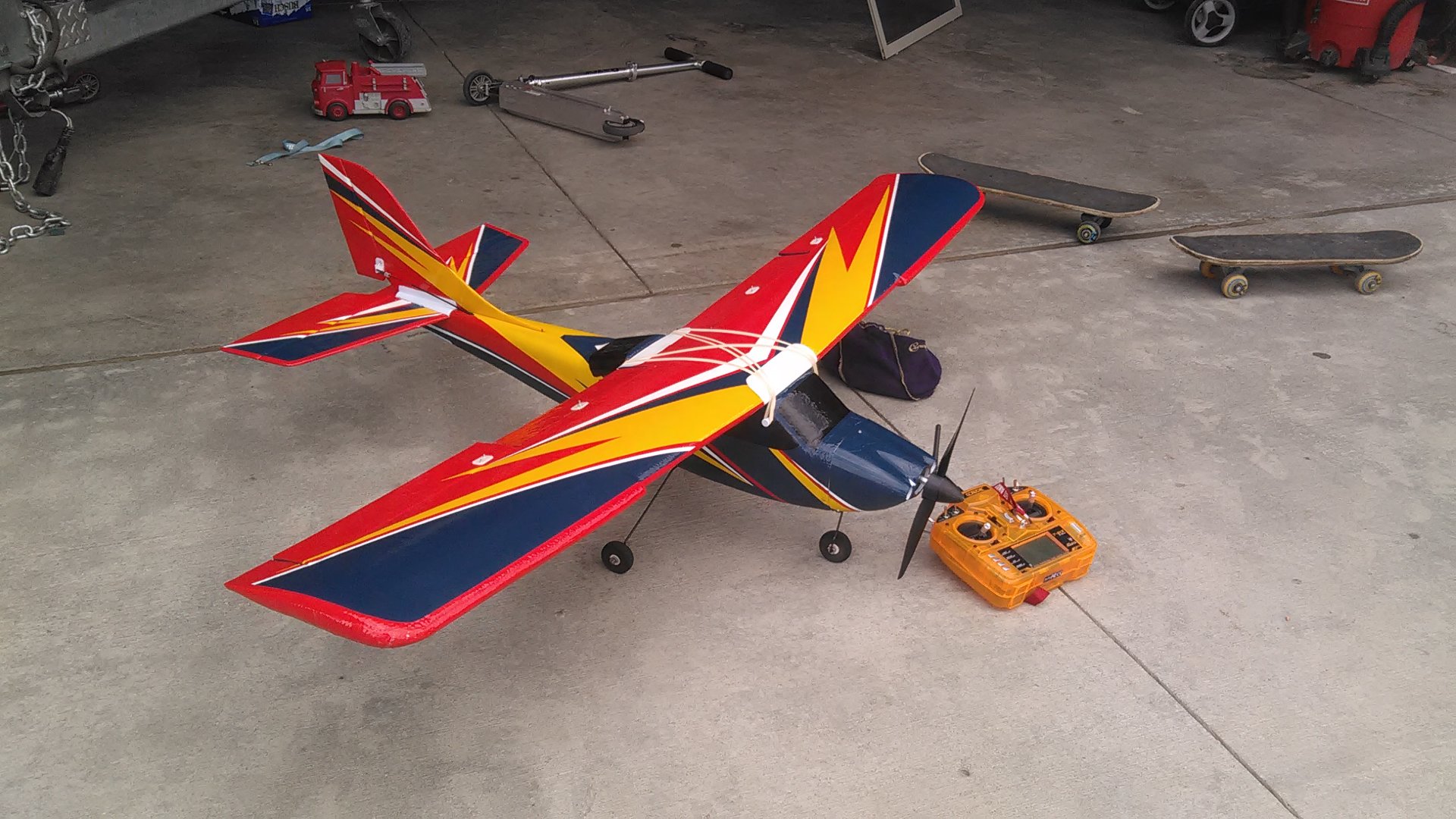

    I have been using iron on plastic covering for my foam planes. It makes them super strong and doesn't add that much weight.
    A Multiplex Fun Cub
    E-flite apprentice.

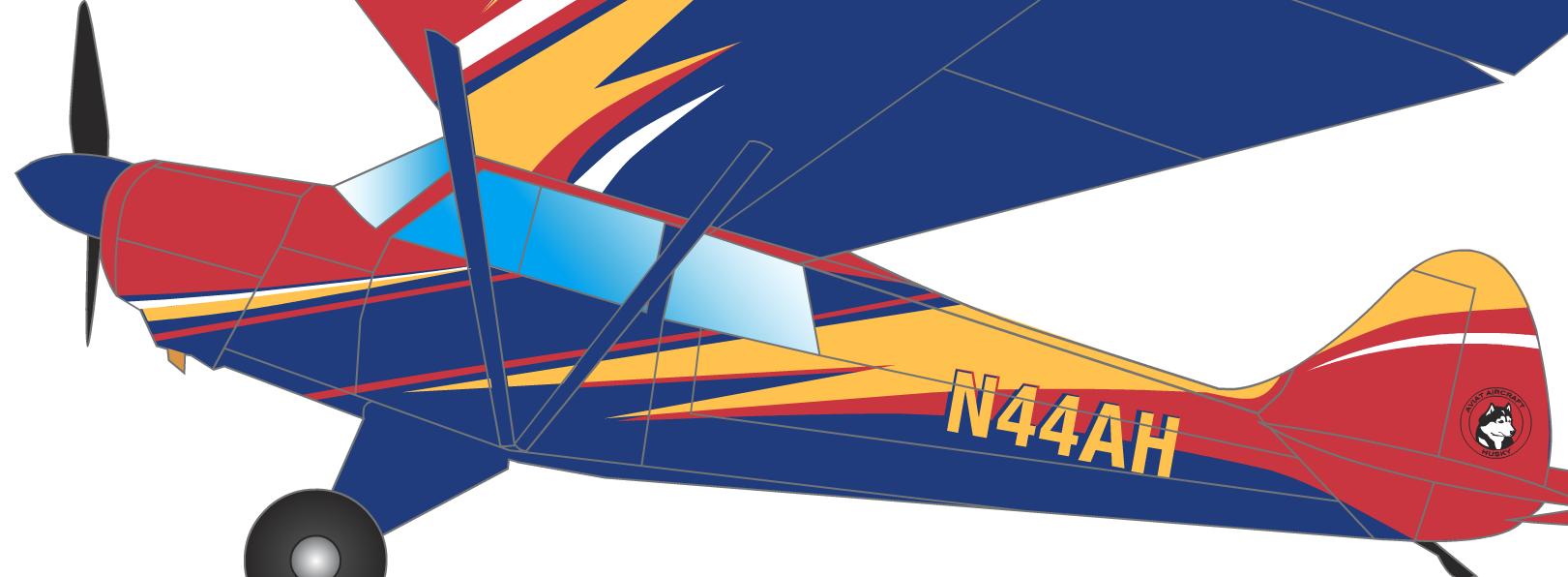

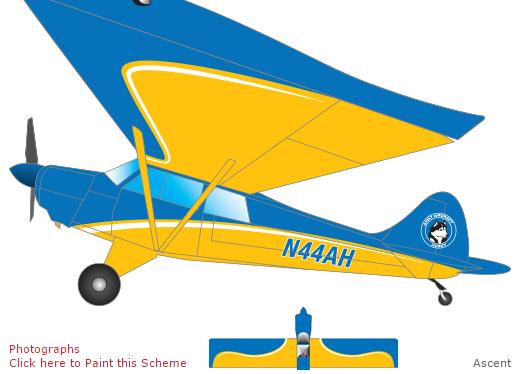

    Razor paint scheme
    Both paint schemes are taken from husky aircraft paint schemes
