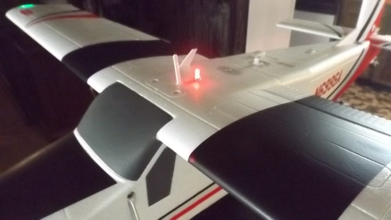

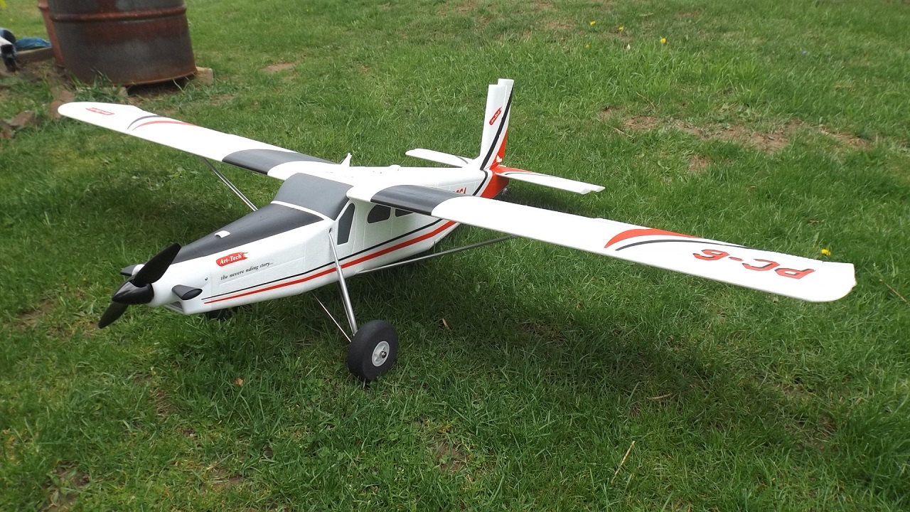

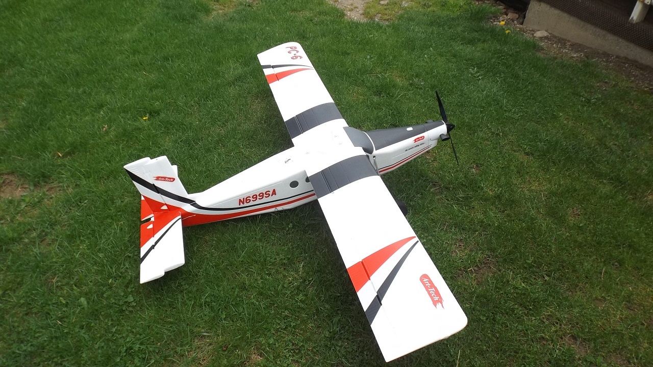

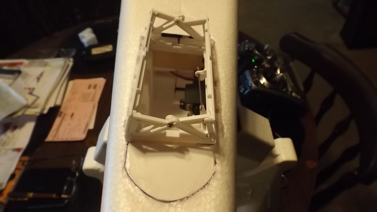

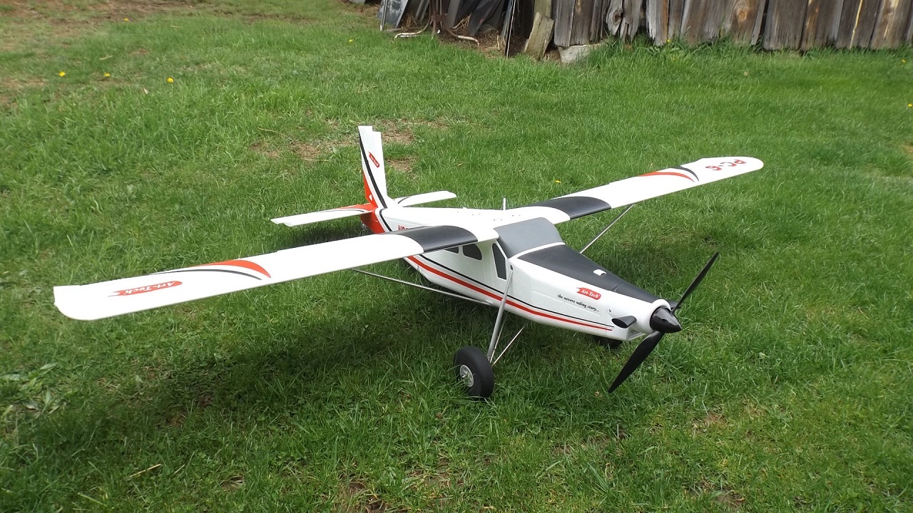

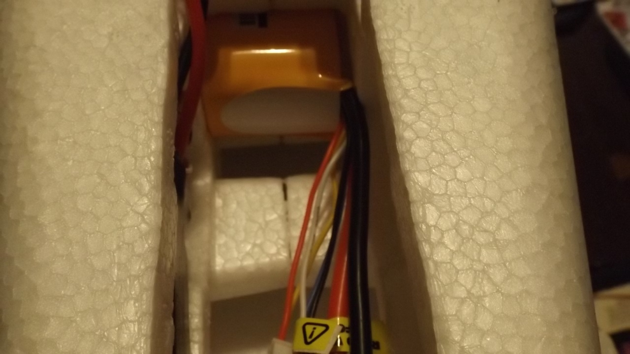

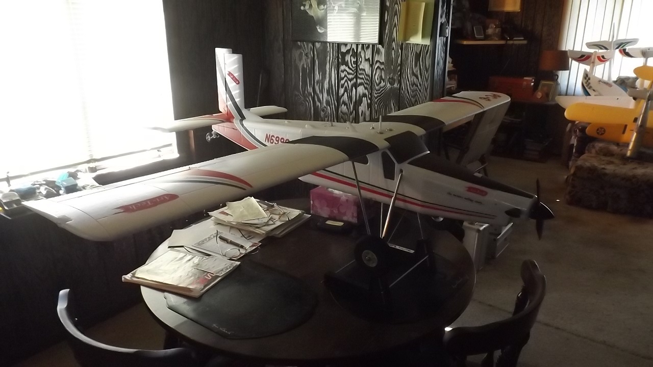

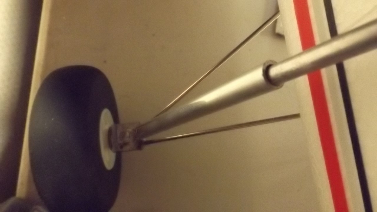

    I finished up the 1700mm w/s HK Pilatus Porter PC-6 & it's ready for maiden. I modified the entire LG & got rid of the plastic crap & made spring-loaded aluminum telescoping LG & changed to 4" tires for our grass field. With a compact Zippy 4S 4000mah batt., the CG was spot on. I removed the flip-open drop bay hatch & replaced it with a dropbay from a Flyzone Sensei. I added a red nav light on the top center of the wing as the scale planes had optionally. Looking forward to getting this one in the air. Here's a couple pics....

    Great job, you really made it your own by all the improvements, especially like the gear mod!! Look forward to a video of the maiden to see that gear in action.
