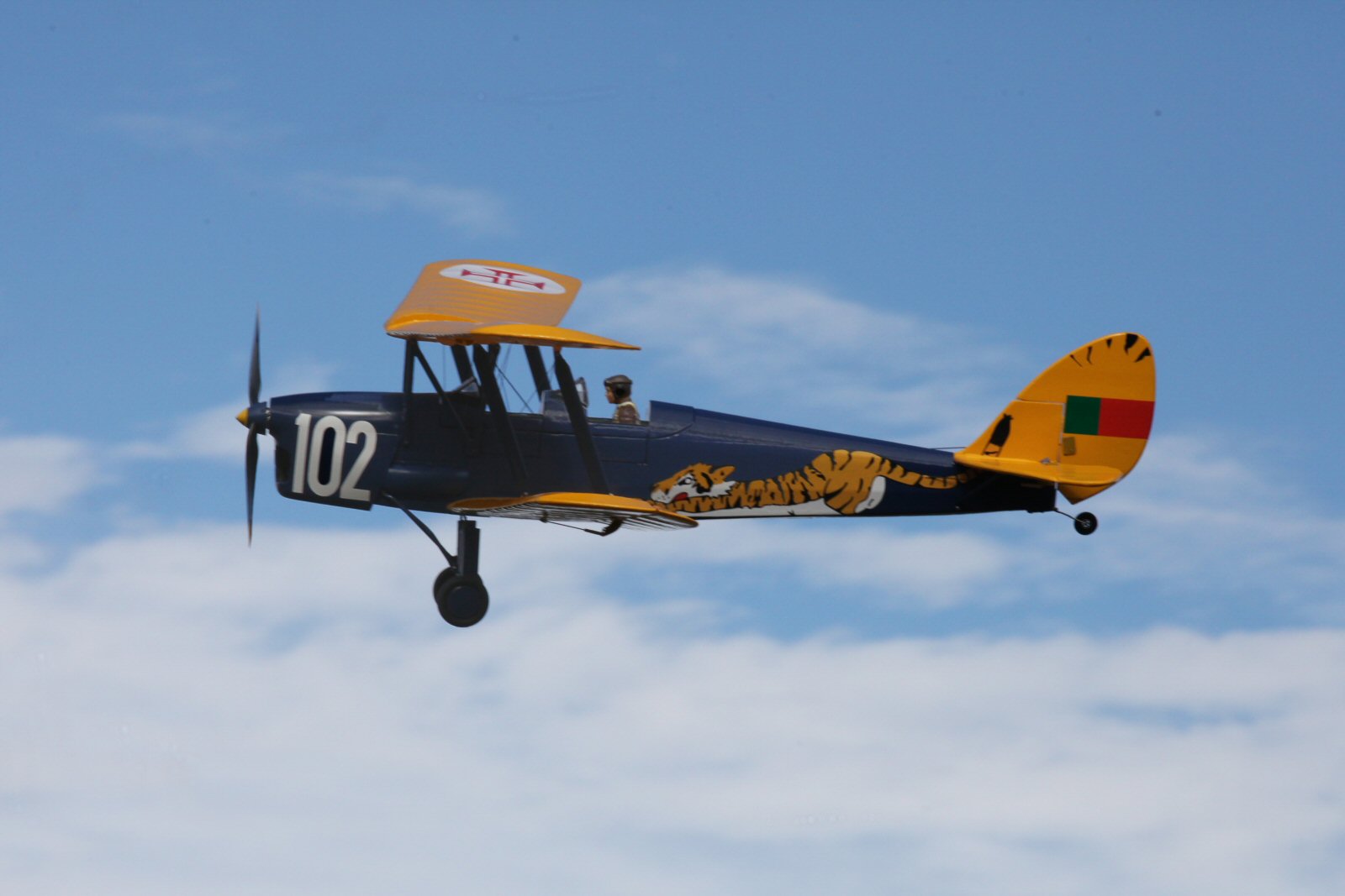

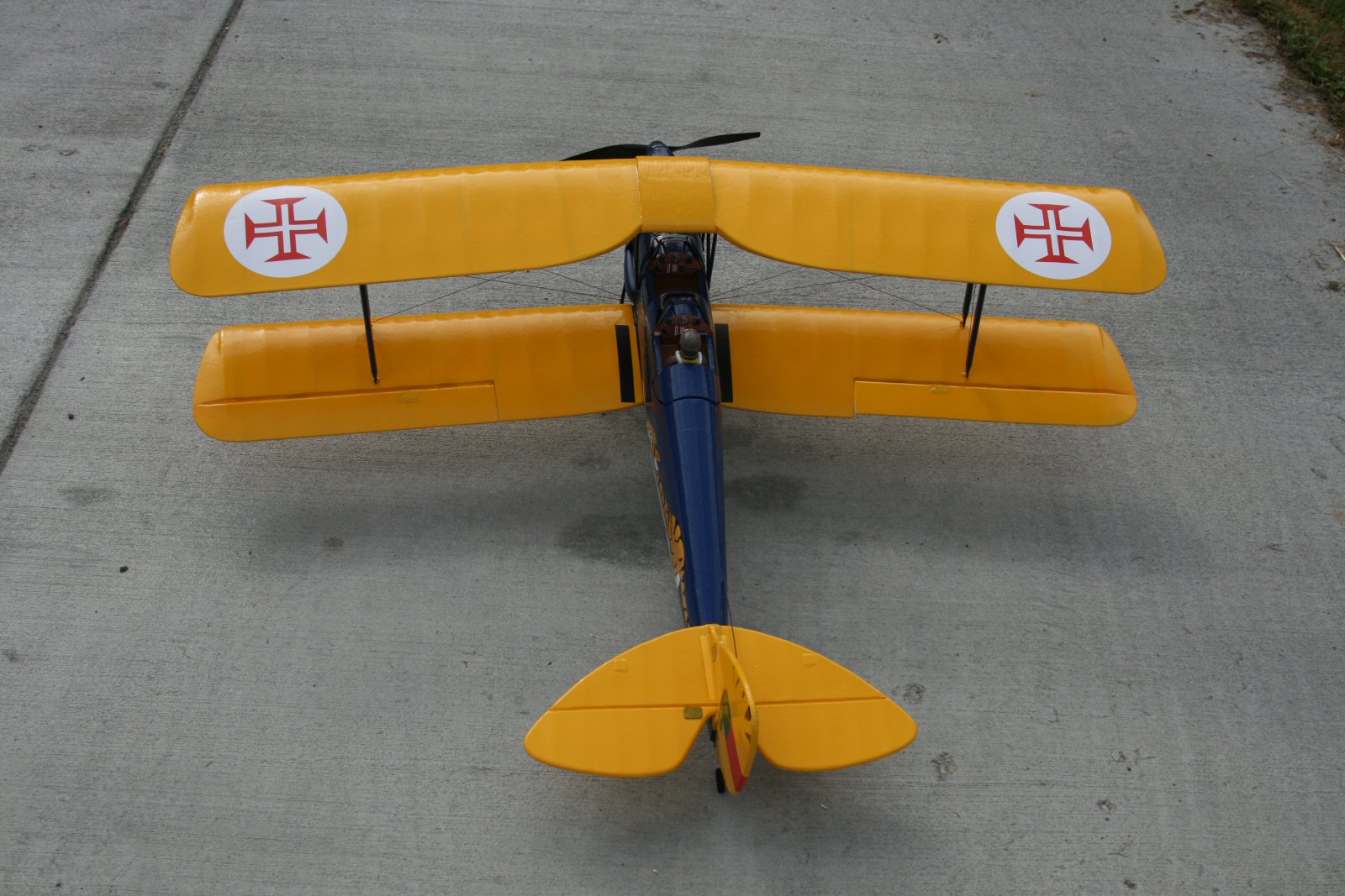

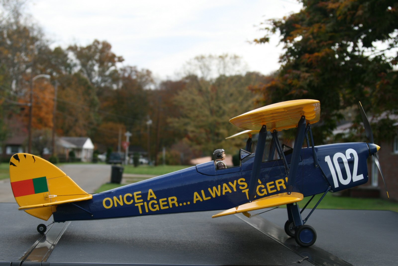

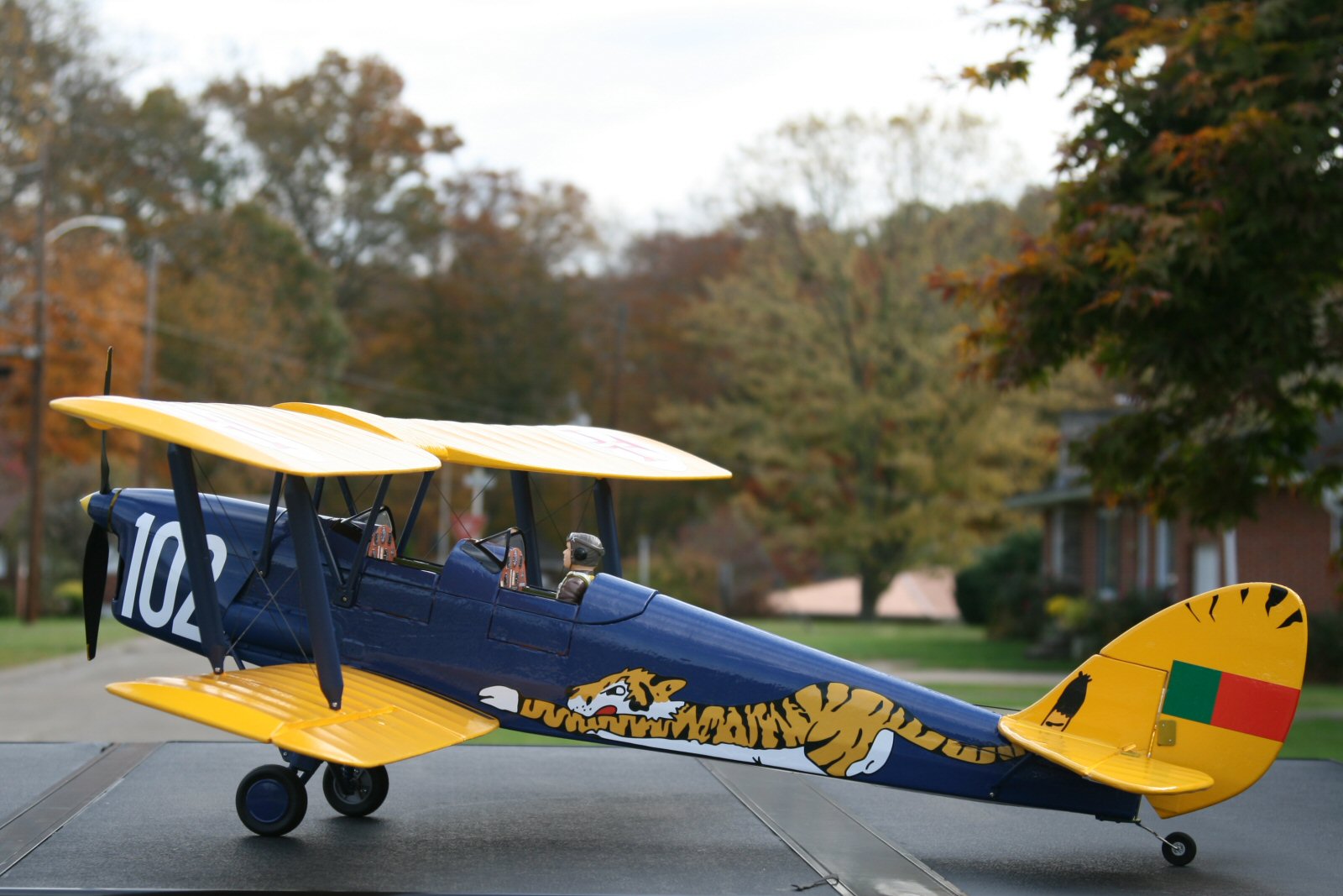

    Putting the finishing touches on my Tiger Moth.  I wrapped it with Oracal vinyl and lettered it as a plane displayed by the Portuguese Air Force at the 1996 NATO Tiger Meet.

    She's a beauty, very different scheme then the usual. Did you do the graphics?

      Thanks.  It is a replica of a plane the Portuguese Air Force displayed at the 1996 NATO Tiger Meet.  The decals are from Callie Graphics.  She does great work at very affordable prices.

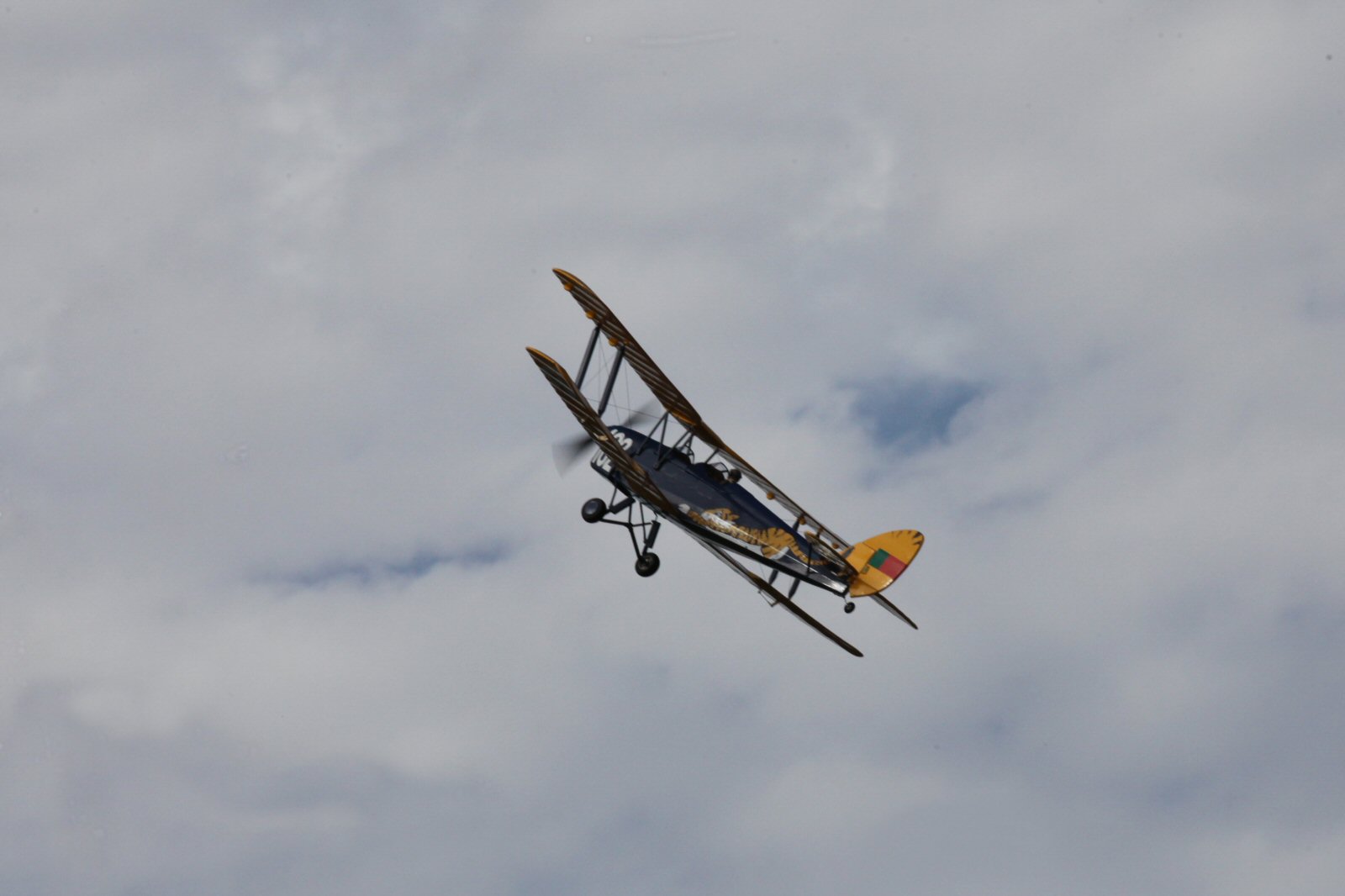

                  Those are beautiful flying shots WV!!
