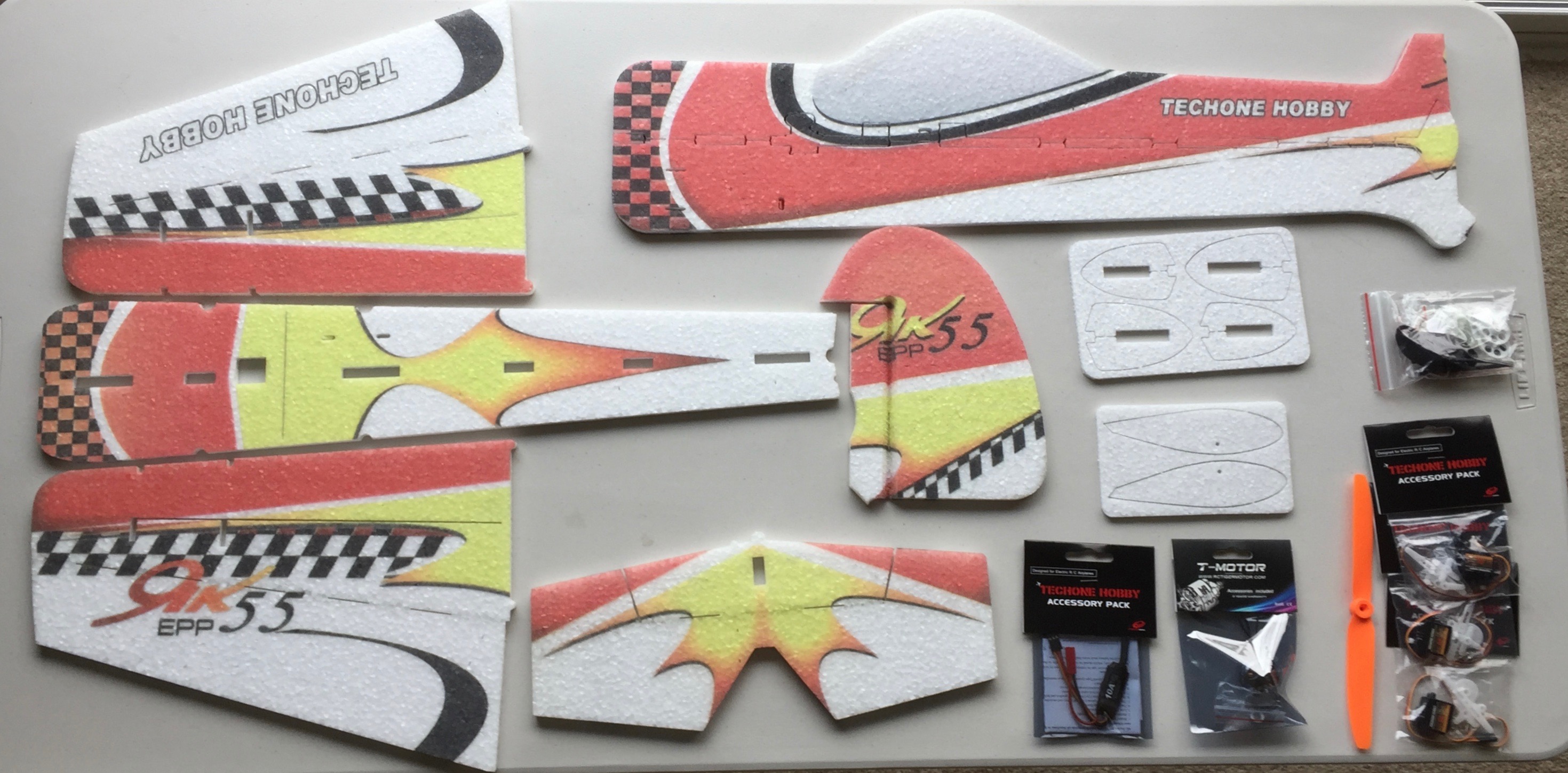

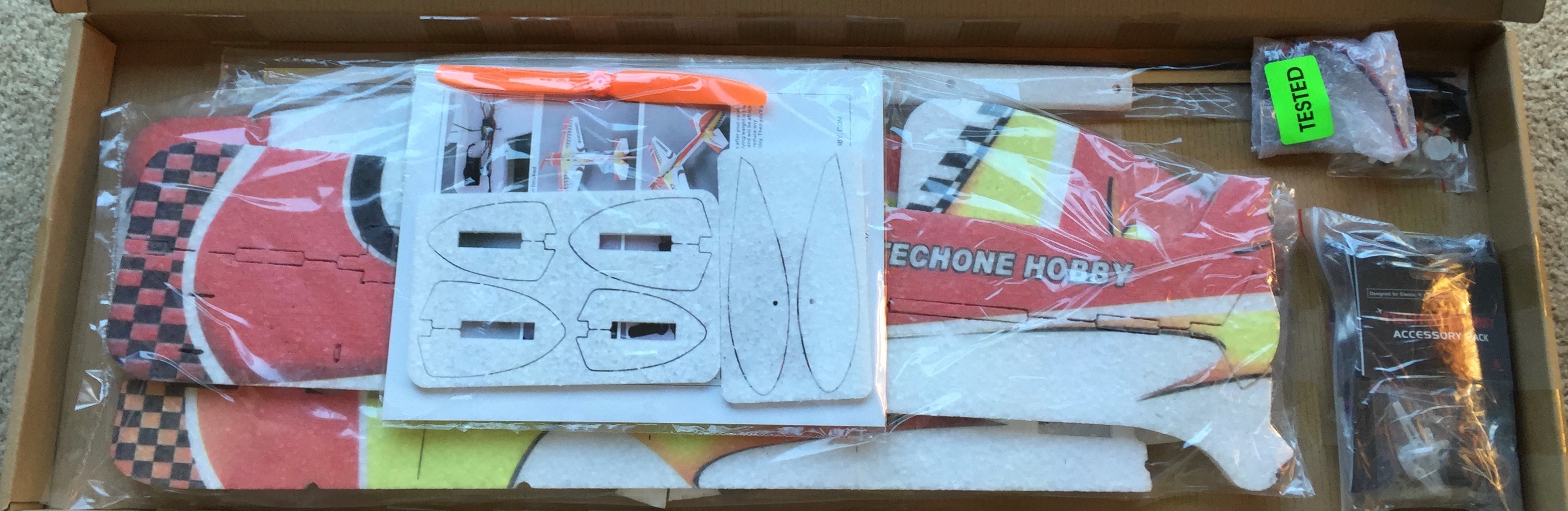

I have the TechOne Yak 55, and this is a profile model made from EPP foam. Mine the PNP version and although it is a very complete kit. It includes the motor, ESC, and the servos, it does have to be assembled and some glue is required. I will include pictures here to show the model, both in the box and during the assembly. A nice 12 page illustrated instruction manual is also included. The instruction manual can be found on the Motion RC website at the link below.
http://www.motionrc.com/content/manuals/techone1/Yak55.pdf
The model arrived packed in a double box with everything taped in place to prevent damage during shipping and handling. The degree of tape holding things in place would make it very difficult for anything to get damaged. Having checked all the parts for damage its time to begin the assembly. I used three different types of glue during the assembly and I will cover each one and where I used it as I explain the assembly process. The model is supplied pre colored, so no painting is required.
