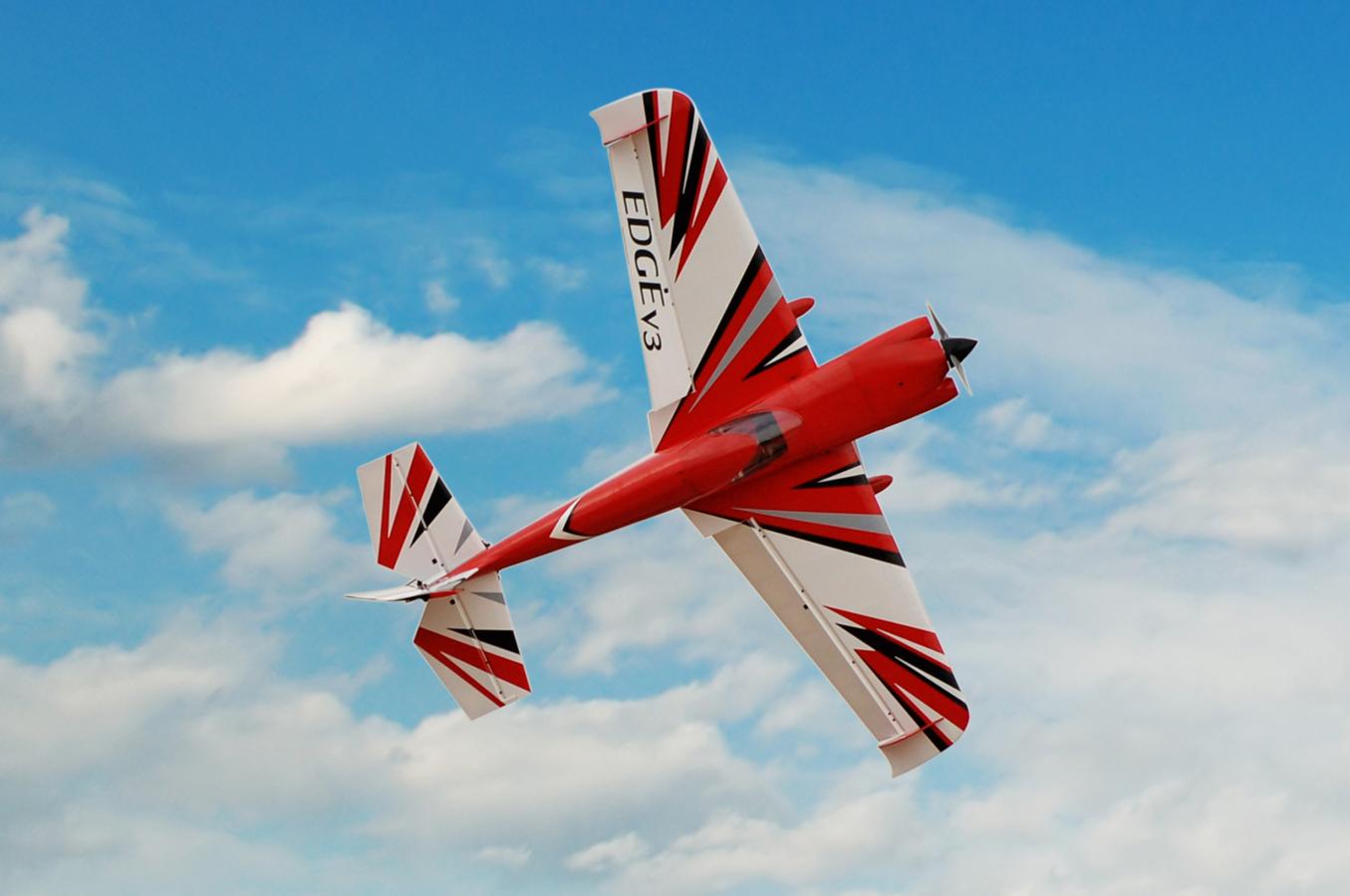

    Product page: https://www.motionrc.com/products/bl...-v3-2000mm-arf
    The Zivko Edge 540 manufactured by Zivko Aeronautics is a highly aerobatic aircraft. Capable of a 420 degree per second roll rate and a 3,700 foot per minute climb rate, it has been flown to victory on the international Unlimited aerobatics circuit several times since the mid-1990s. A tandem-seat version is sold as the Edge 540T.
    The Zivko Edge 540 is the most common aircraft used in the Red Bull Air Race World Series.
    Our model is scaled to approximately 1:3.7 and attention has been given to providing a realistic appearance with outstanding flight characteristics. The model was designed for electric power but can also be flown using a matched pair of internal combustion engines of about 30-35cc displacement.
    Features:
    • High level of prefabrication right out of the box
    • Lightweight, strong, and fully sheeted laser cut balsa and plywood construction
    • Covered in high quality Oracover
    • Recessed hinges on all control surfaces
    • Large easy access fuel tank/battery/servo access hatches with sprung loaded latches
    • Painted and detailed cockpit, pilot and interior included
    • Fiberglass twinned control horns with ball link connector
    • Pull-Pull control system on the rudder for precision control and authority
    • comprehensive control and fitting accessories included
    • Two-piece, plug-in wings simplify transportation and assembly.
    • Fiberglass cowl and landing gear covers/pants
    • Mounts for both electric and gas power options included
    • Fully illustrated instruction manual included and also available for download (see tab above)
    Includes:
    • Black Horse Edge 540 V3 2000mm (78.74") Wingspan - ARF
    Requires (Electric):Requires (Gas):
    • Engine: 30 - 35cc 2-stroke, NGH GT35R recommended or 38-42cc 4-stroke, NGH GT38 recommended
    • Gas Propeller: 18x10-20x8
    Click image for larger version  Name:	edge updated.jpg Views:	1 Size:	73.0 KB ID:	194497
    Can anyone comment on their experience with this plane using the 10S setup?
