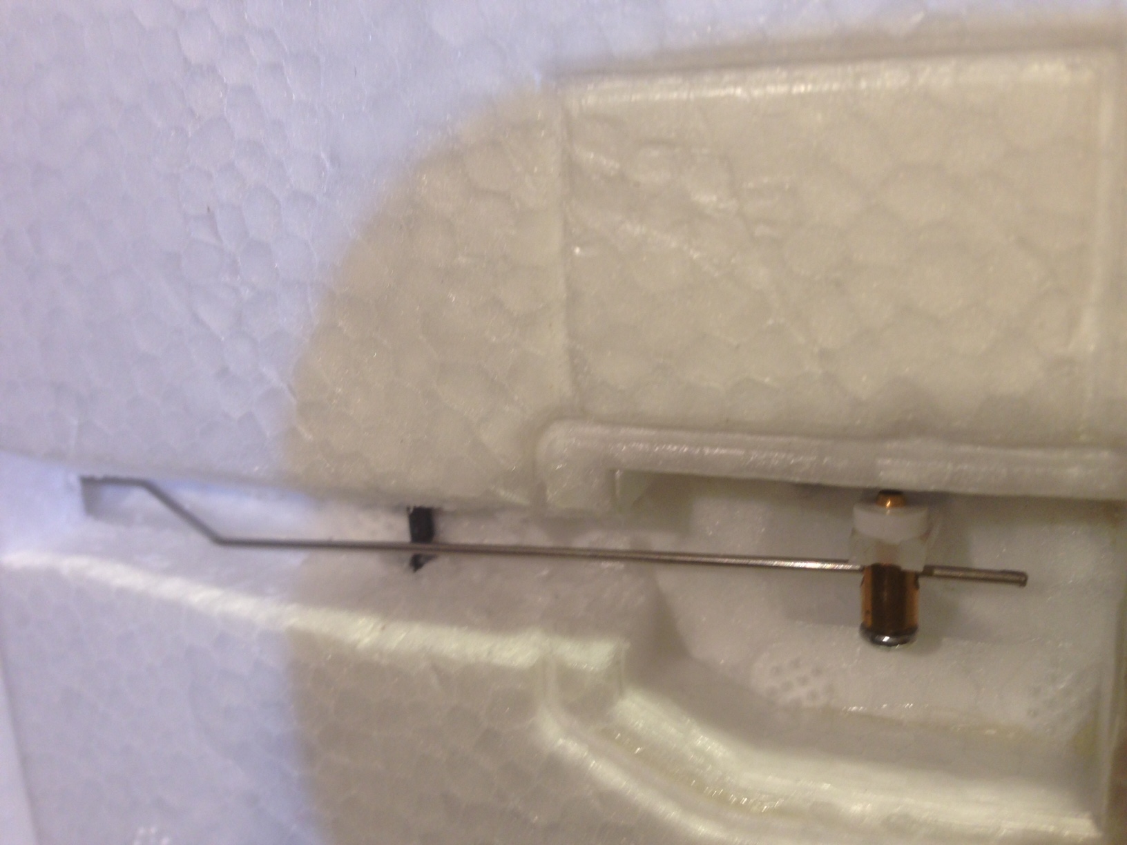

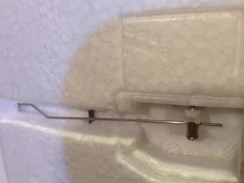

                    This harkens back to what Adam just said about "easy to access" components.
                    I'm about to do a little modding of the control rods for the AIL. At 4s speeds, those rods bend and what aileron simply can't combat the wind resistance and AIL authority is very minimal till the plane slows down. I'm going to open it up and see if it's possible to glue a small CF rod along the existing metal rod to stiffen it up along the middle section. If not, then I'll see about externalizing the rod, adding a control horn on the surface of the AIL and adding a longer servo horn. I like the way it's hidden right now but having poor AIL authority at speed just won't do. The ELE and RUDD rods are inside a plastic sheath and bending is not a problem.
                    • #11
                      Took off the servo cover today and cut a small trench where the rod runs. The picture below shows what it looks like inside. The 2 bends in the wire is what causes it to not actuate the AIL effectively when at speed. The rod twists instead of pushing directly on the horn. I took out the bends and glued (FoamTac and foamsafe CA) a small diameter CF rod along the wire. Then I shoved heat shrink tubing over all of it and shrunk it down. It makes a fairly solid connection now. Let's see how it performs next time out.

                        It really is a shame you have to go to so much trouble to fix what should be a simple, easy to rectify issue. Hope it works well for you man...

                          I really can't blame Flyzone for this. It was my decision to go 4s. On stock 3s, the plane is more than adequate. With every model I've "hopped up", something else seems to give. That's the joys of this hobby. ;)
                          • #14
                            Well...yes and no. I'll give you that you're pushing it harder than intended, but you still shouldn't have to go to those lengths just to get to the hardware/linkage. Don't get me wrong, I'm not bashing Flyzone so much as I'm trying to constructively criticize them...I figure they won't get with the program and update their way of doing things unless we are honest about them. I'm a fan of Tower Hobbies and I want them to succeed as well as all of the companies...gives guys like us more options, and Flyzone is the brand of theirs that focuses on the best selling part of the RC Airplane market - the PNP/BNF Foamies. The competition is just too good and I'm afraid that if they don't get with it...they make put themselves in real trouble. For instance...at the LHS I work at we sell 40 or 50 planes in that category from Horizon for every 1 we sell from flyzone (no joke)...they are getting smashed sales wise.

                              The bent rods are intended to help limit water traveling up the push-rods.
                              Its an old RC seaplane trick.

                                    Interesting. I guess at one time, it was considered a bad thing for water to get into the servo area. I've seen modern day servos actually work underwater. I look at MotionRC's seaplane page and all their seaplanes, with the exception of the Flyzone ones, have their servo rods, arms and horns externalized for easy access (adjustment, maintenance, replacement).
                                    I've never really ranked Flyzone very high in the desirability category but this Seawind was just nice enough in many other ways to get my money. I've always wanted my old Dynam Seawind to have the features this one has (larger size, flaps, retracts). I was also interested in their Beaver but after reading the manual and seeing how complicated the linkages were (for water rudder and wing control surfaces) and the multiple attachment points for the floats, I opted against it.

                                      How does that work, surface tension?

                                        It still is a bad thing. That is why most high end servo OEMs offer water-proof servos. Then there is the issue with the ESC and RX.
