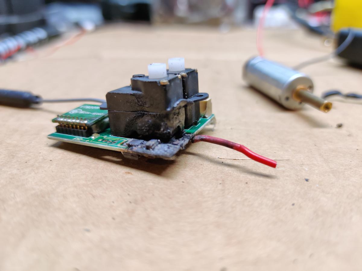

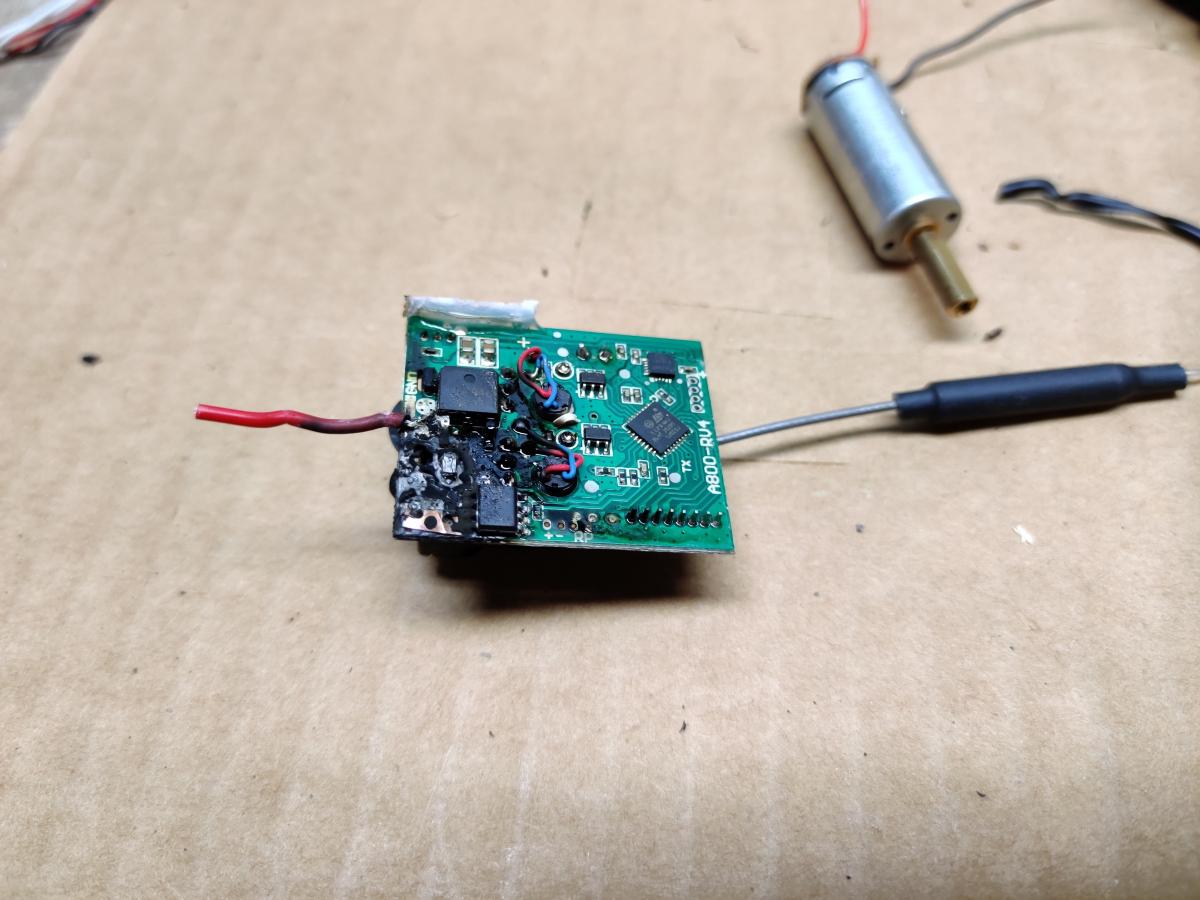

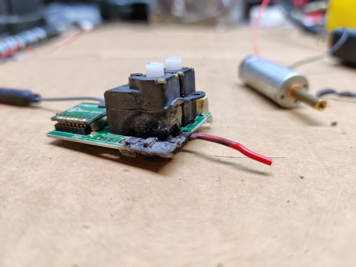

                I too had a board that shorted out. It was only my second flight. I was playing with some thermals and floating in the wind when I saw a nice "jet stream" behind the plane. At first I thought it was the atmosphere, then I realized it shouldn't have a trail behind it at 30 feet up. It was right then that it fell out of the sky. My board seems to have burned out right at the motor connector. Which, of course, singed much of the plane around it. I'm not sure if it was the soldering on the board or the motor that caused the issue, so I replaced both along with the aileron to board wire. Just installed the replacements and everything seems to work fine. Thank you to James for the tip on getting the Tx to bind up. Haven't had it up in the air yet. We'll see how tomorrow goes.
                It's very unfortunate that these products are so poorly made. I had a WL Toys micro helicopter with a main board that failed early on too, but it just stopped powering up instead of starting on fire. I believe WL Toys and XK are the same company.
                Other than that, it is indeed a great and fun plane to fly when it is working properly. Though it could use a more powerful motor. Not bad for the price.
