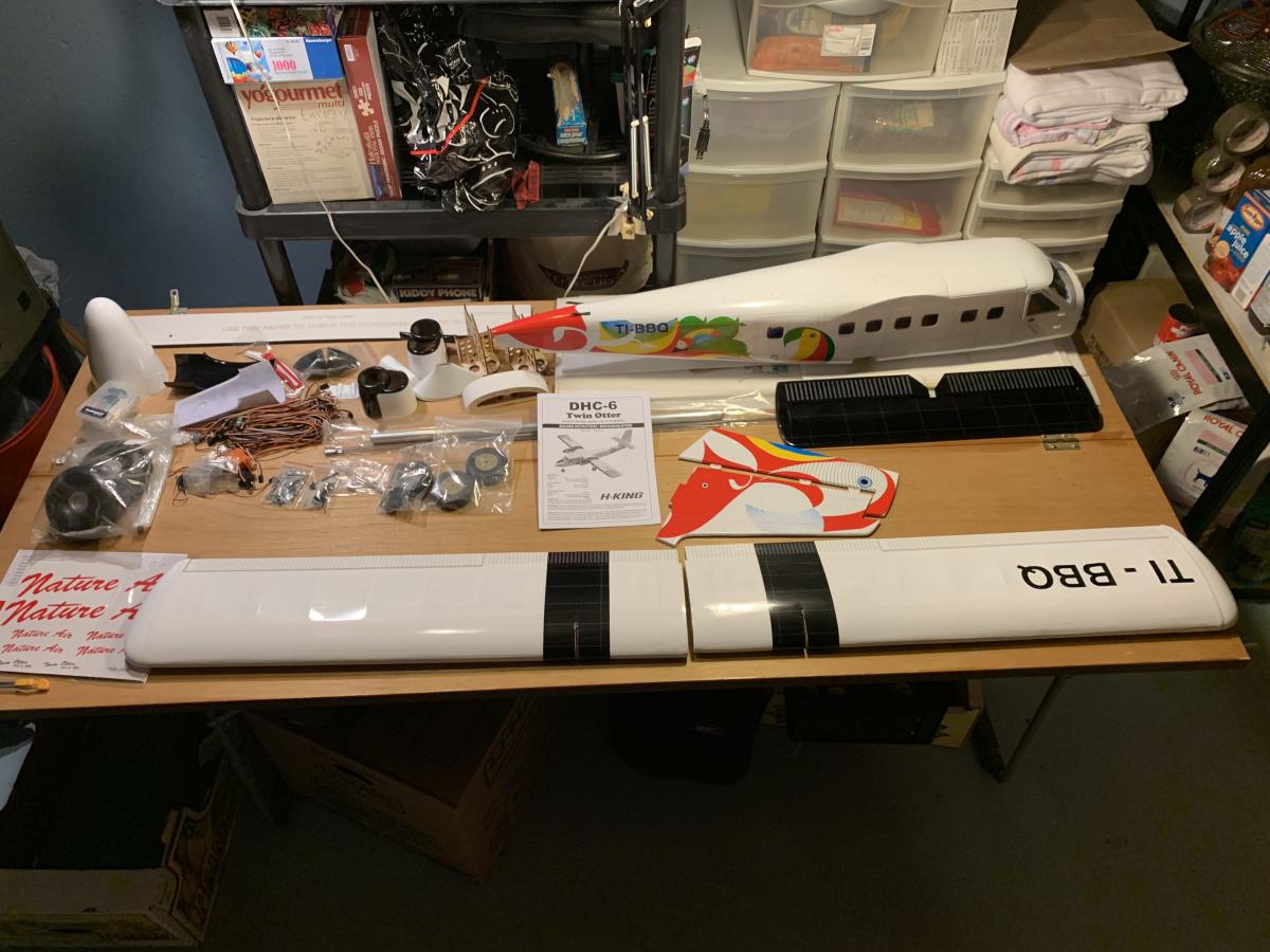

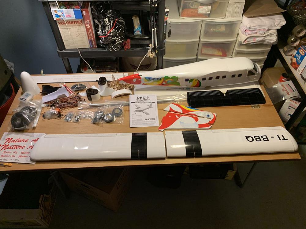

            Got it a short time ago and have it unpacked and on the table. I had everything on hand to build it except for the power system. That's coming soon. I'm going to use the same drive system as in the HobbyKing Grumman Albatross (motors, ESCs, 3-blade counter rotating props), but no reversing ESCs (no water flying, so not needed). That system has proven to work very well in the Albatross, so I figure since it's got wheels, it should be plenty powerful to make it work. The Albatross has no problem skidding on its belly to get off even thick grass. If it turns out sluggish, I can always kick it up a notch. I also have a set of the big, soft Tundra tires that I'll try and use the bigger main stock tire for the nose wheel. I have no place yet to store it, so it'll be a leisurely build while I try to thin the heard down a bit. I generally don't like building balsa ARFs, but this one was just too good (and cheap) to pass up. With all the discounts, it was under $190.00.
            The design and execution of many of the features of this model is very reminiscent of the Hanger 9 model. For those who were familiar with that one, it was quite expensive. The next few weeks (or months) will be quite entertaining. Hope to finish it before winter and get to fly it a couple times before the snow flies.

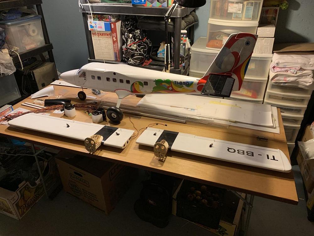

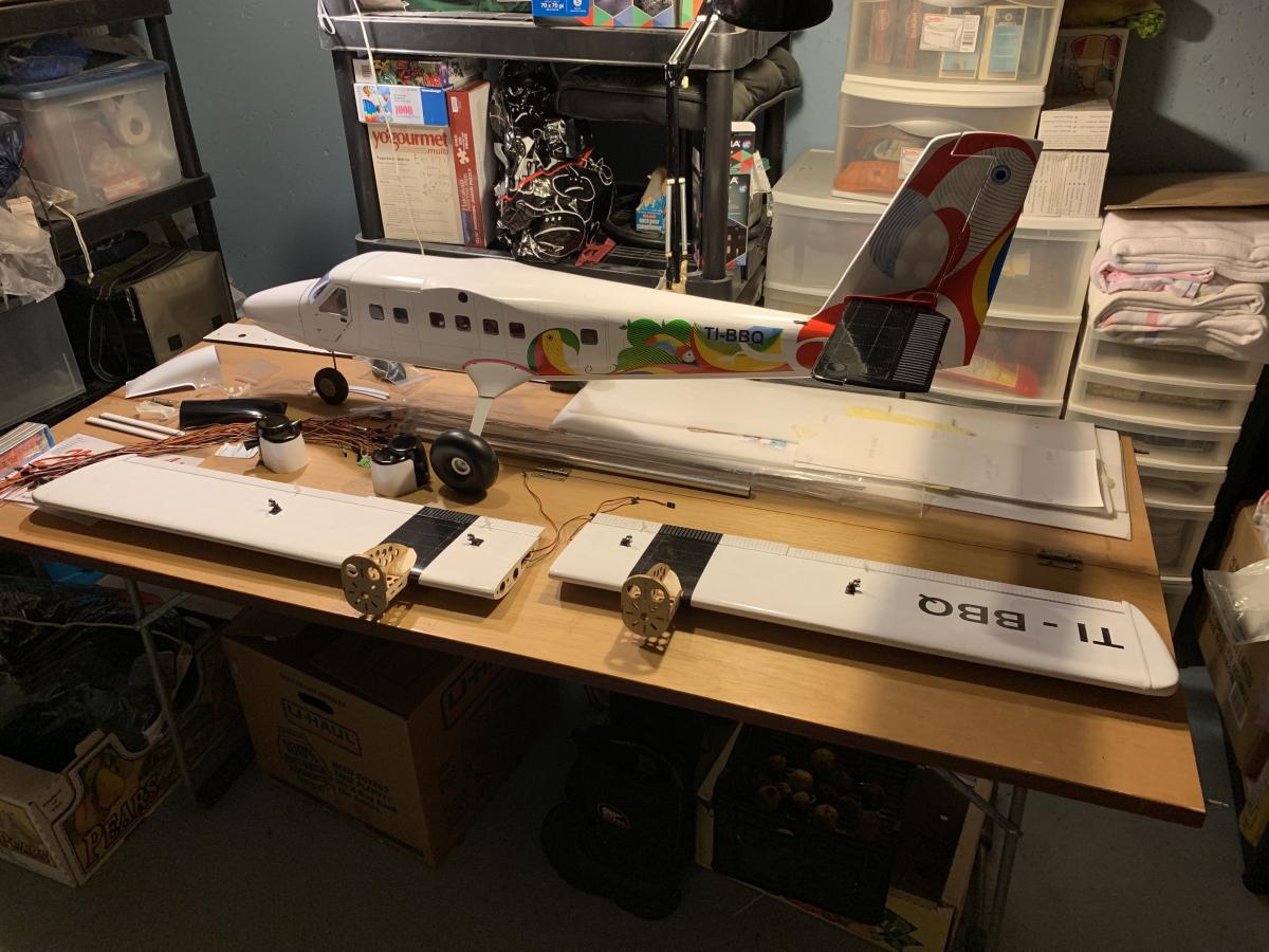

                  This what I've done so far. Still waiting on my motors/ESCs but there's still a few things that need doing while I wait for those. It's been so windy lately, that I've had more time to tinker with planes and this one just keeps calling out to me, "Do me, do me!"
                  I've used the Tundra soft tires for the mains and one of the stock mains for the nose. In stock configuration, the plane has a bit of a nose up attitude. With this selection of tires, it has a slight nose down attitude, which I've seen on the real TO. I guess you could say I'm making a tropical sand operations Otter.

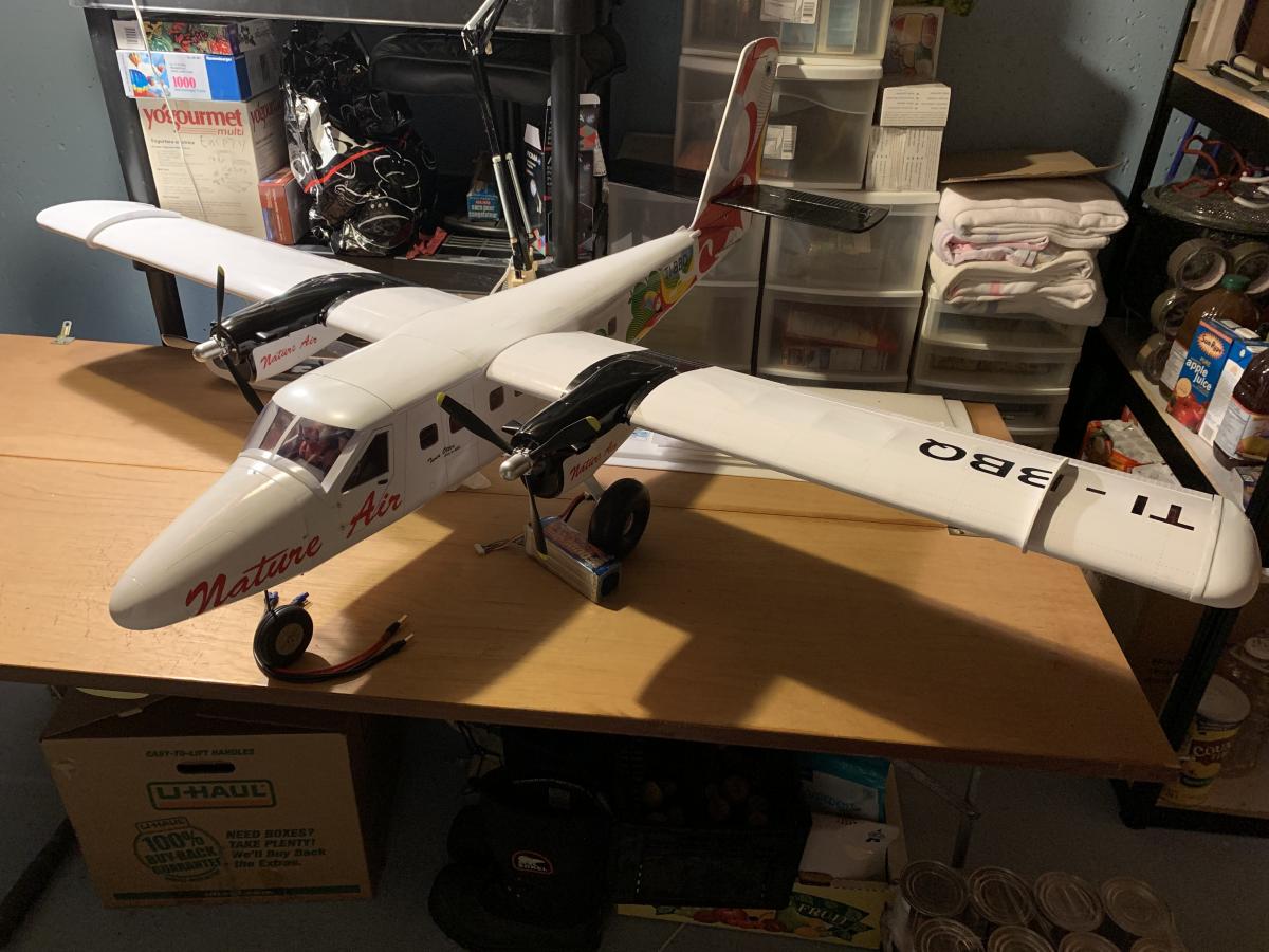

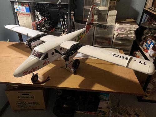

                    Almost done. Just have wing struts and cockpit steps to install, then do all the control surface throws.
