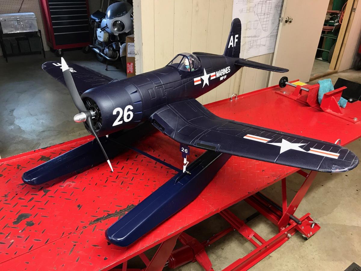

            The retracts on my Dynam Corsair were inconsistent also. Here's my solution.

              Maj. "Pappy" Boyington would be proud
