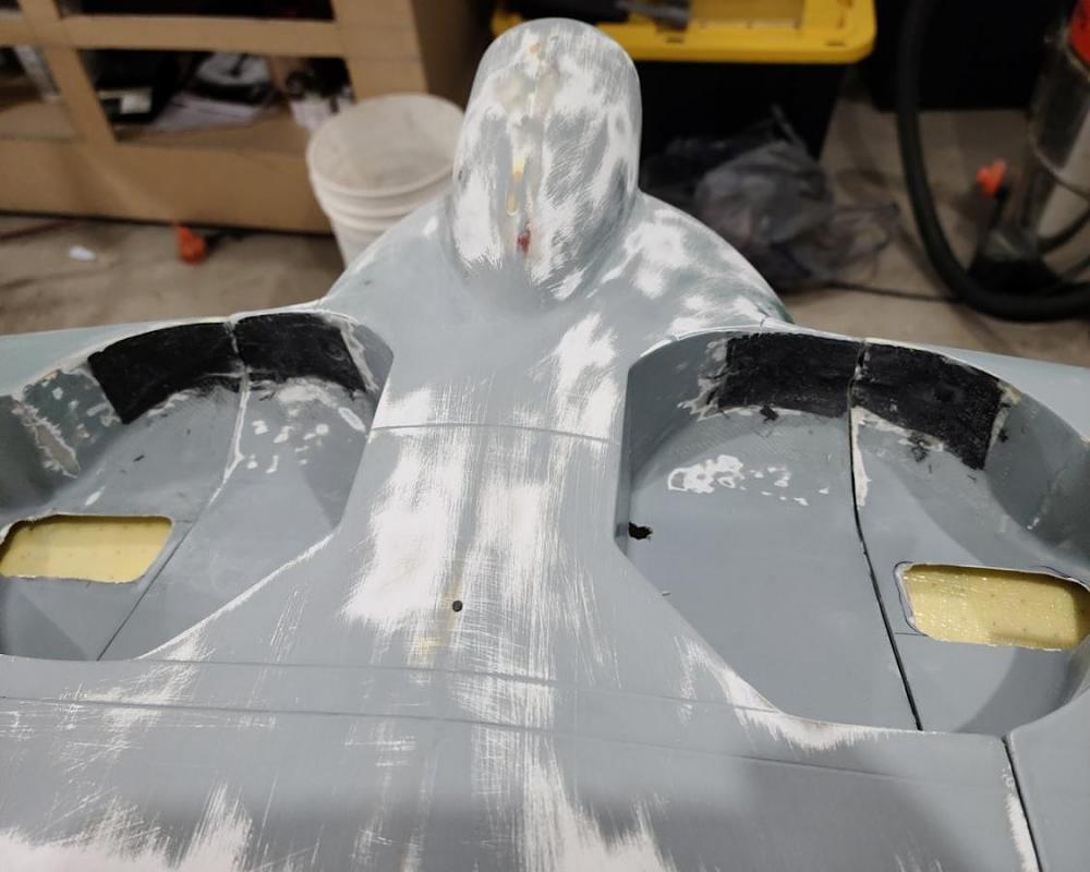

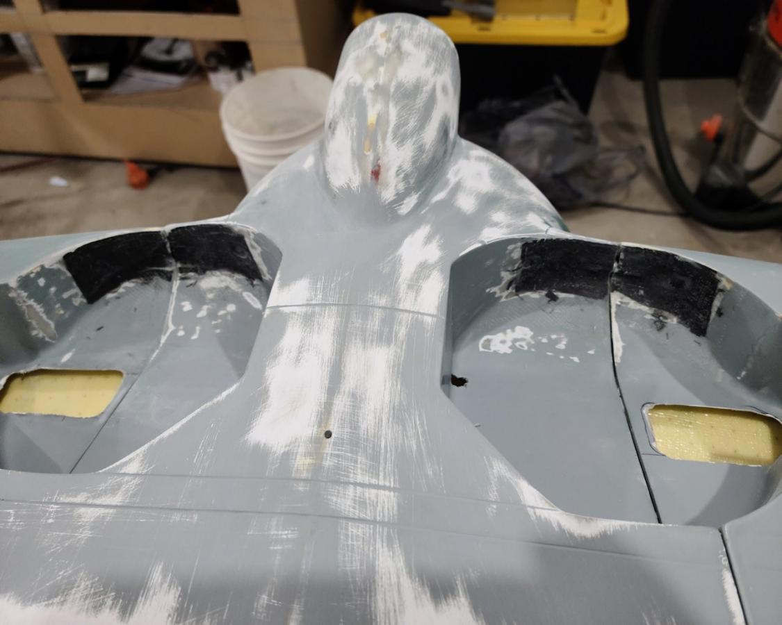

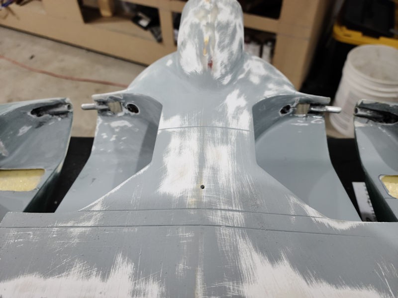

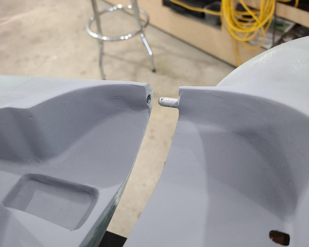

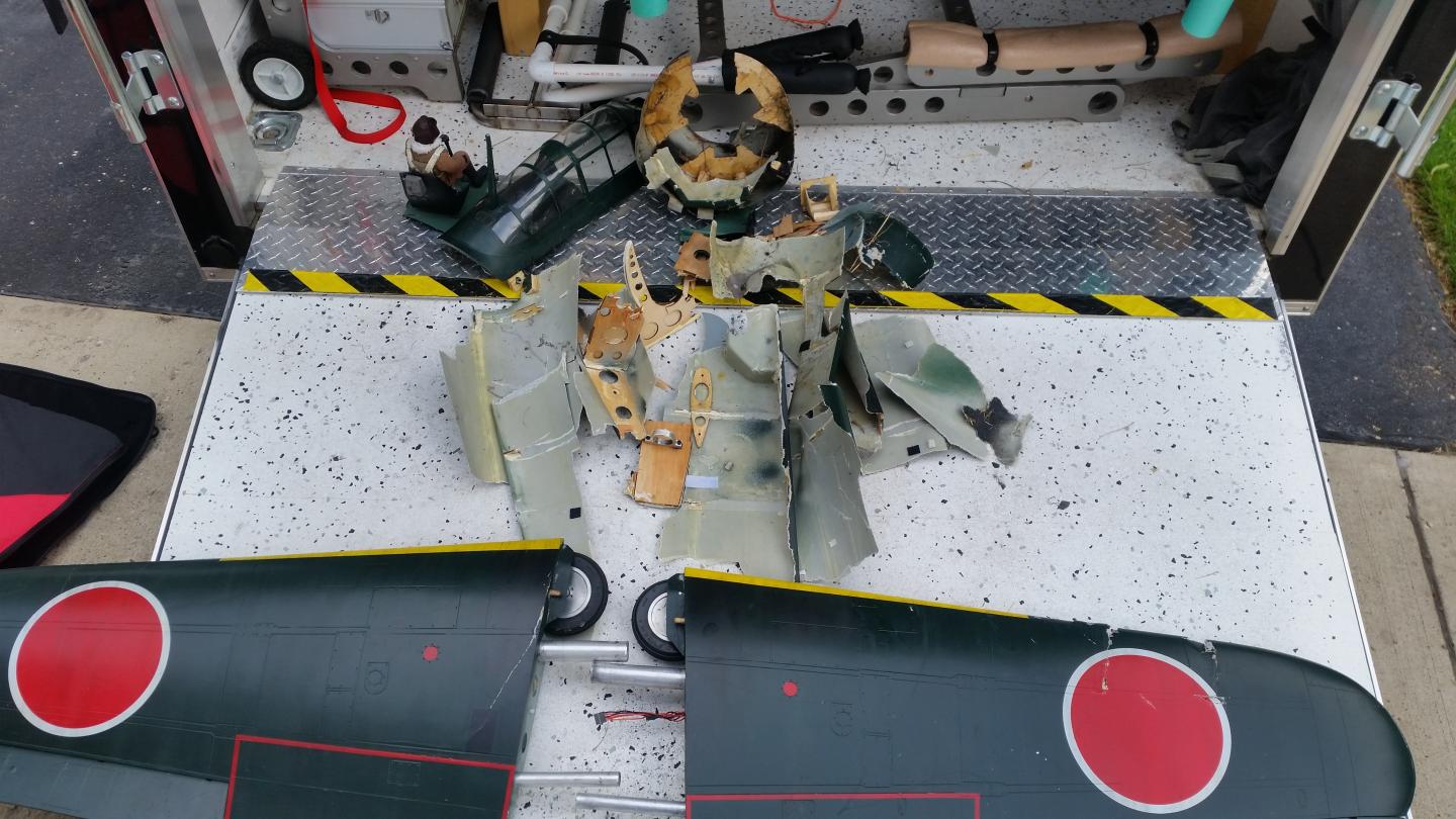

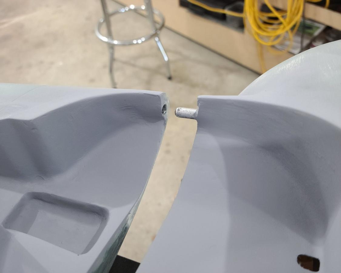

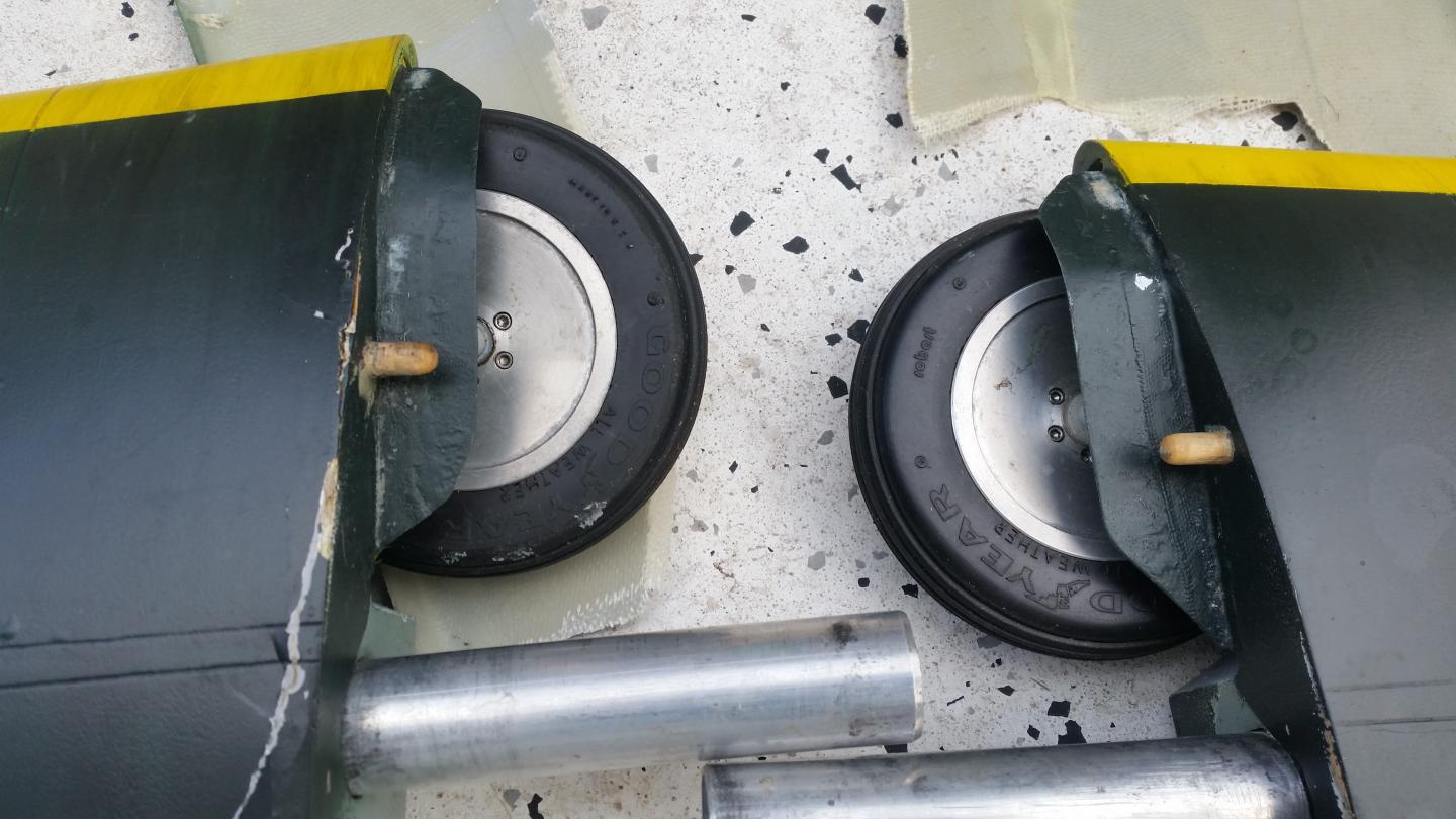

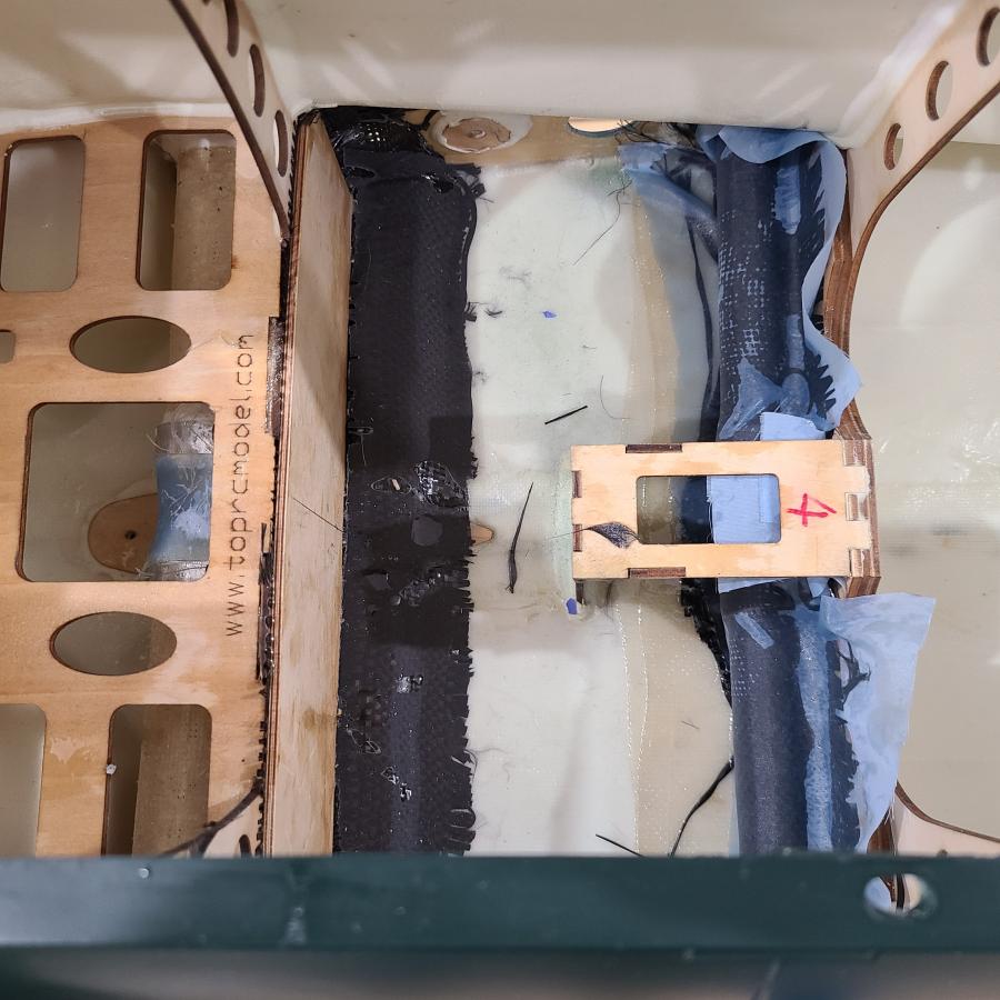

I experienced 2 major structural failures with my Zero. First problem was a leading edge flutter at the root of the both wings right in front of the wheel wells, I recovered from this and made a modification to minimize the problem. The second failure was that the wings folded during flight.
