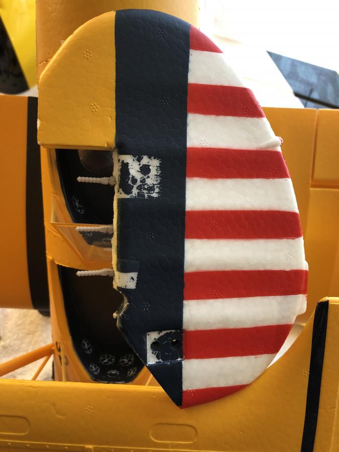

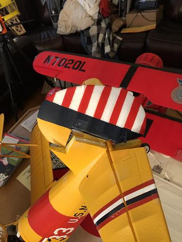

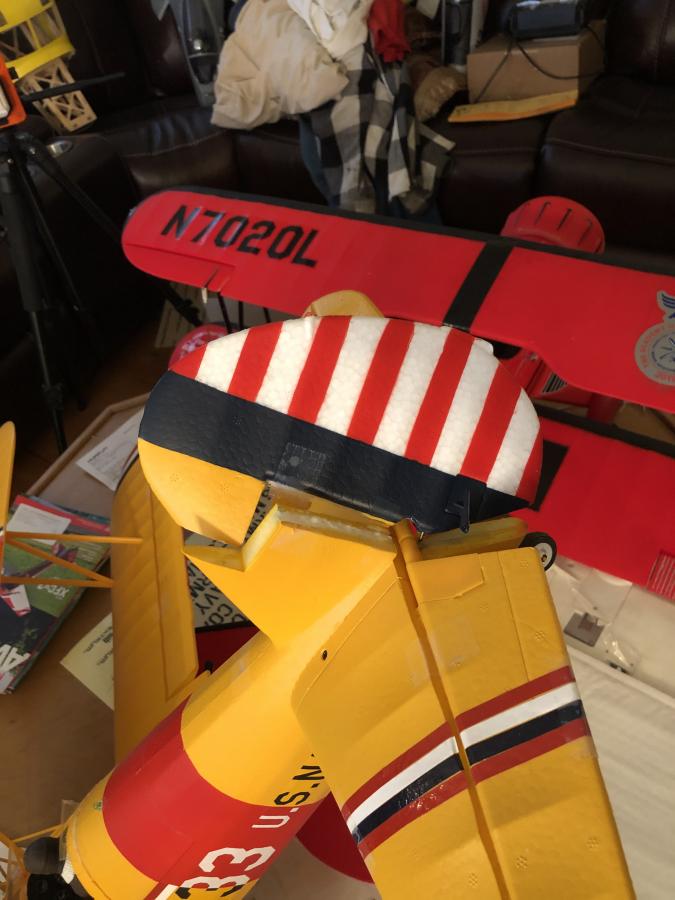

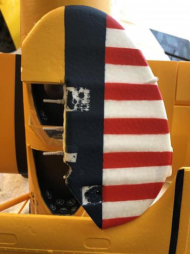

                  The lousy tape hinges came loose on my PT-17 rudder so I replaced the tape with Hinge Point hinges

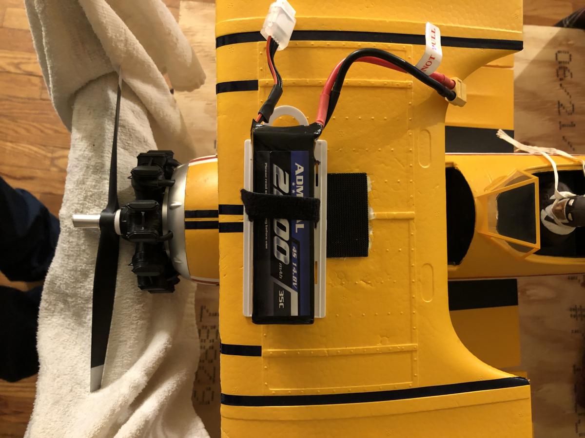

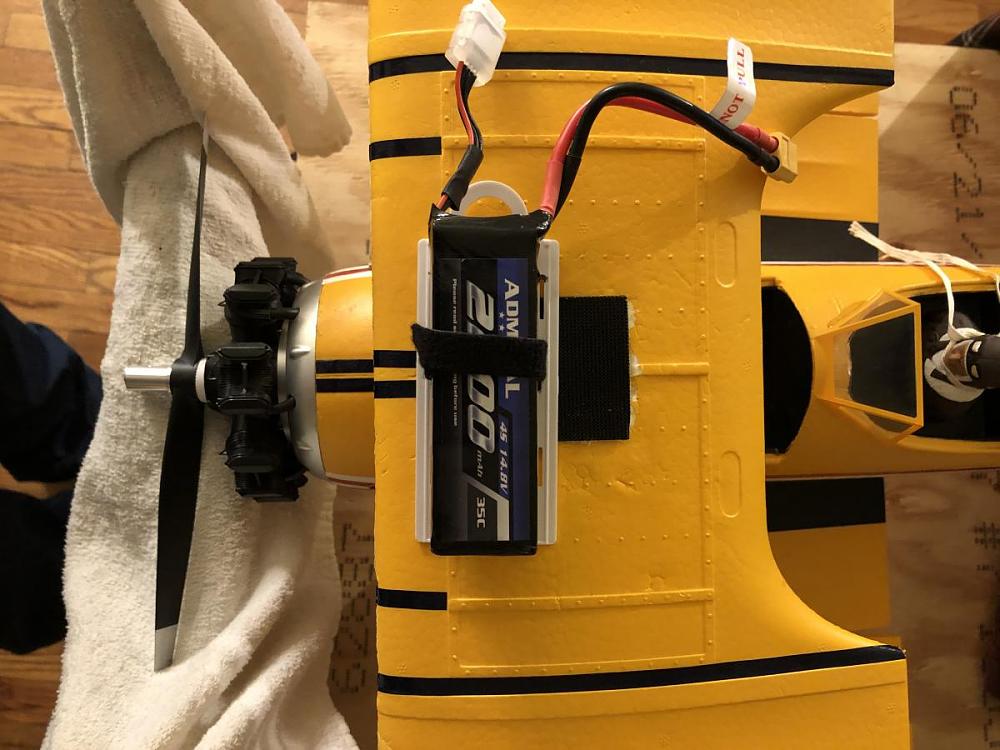

                                  Aros, what battery were you using? Some have made a 5/8" foam platform for the battery to sit on when strapped to the battery tray permitting it to sit farther forward into the opening near the motor mount to deal with tail heavy flight. I do what you did and mechanically adjusted the clevis to dial in a few clicks of down elevator
                                  • Wild Man
                                    • 526
                                    • Rapid City, S.D.
                                    #18
                                    Here is where I have my Admiral 4 cell 2200 35c battery on the tray NO OTHER WEIGHT When I check the CG I start where recom. Then I fly the plane and adjust for sraight and level flight upright then put it in a 45 degree inverted climb just above 1/2 throttle into the wind and leave controls at neutral if it noses for the ground ( nose heavy) I move the battery back ( rearward CG) if it climbs inverted (tail heavy) I move the battery forward until it stays in the 45 degree climb with neutral controls
                                    Click image for larger version  Name:	CG.jpg Views:	0 Size:	116.4 KB ID:	240948
