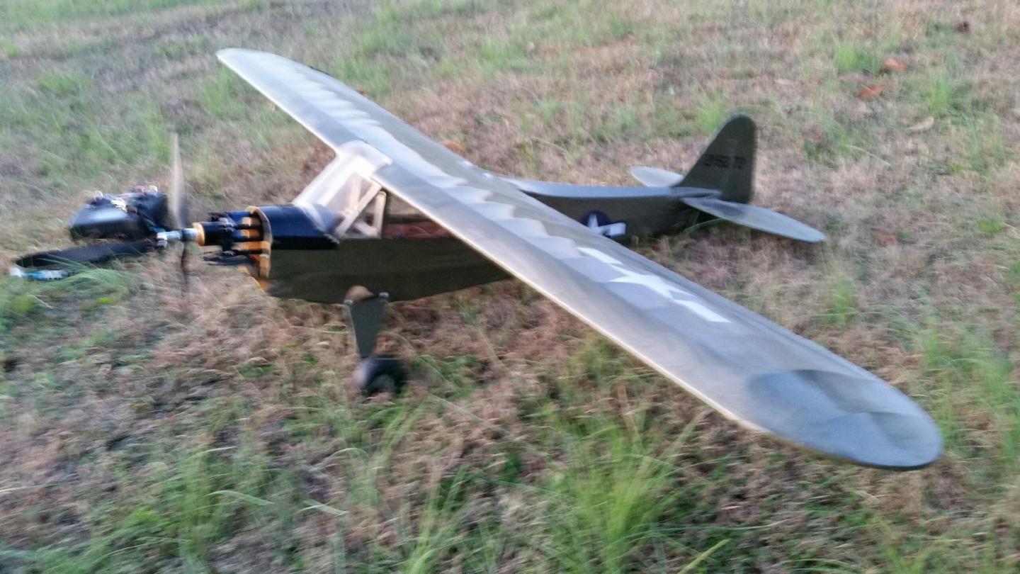

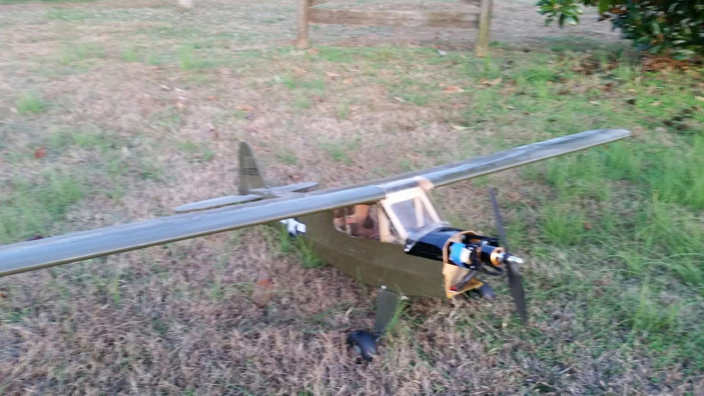

    Well I was looking around my shop and decided to work on my GP Cub that I've had for about 10 years. I put an outrunner motor from my sport motor upgrade that I got for my Tcat that wasn't being used and a ESC from my broken Bcat. Took it outside today and ran it up and down the road in front of my house I gave about half throttle and it took to the sky, just did some test hops. I was impressed with the power on this motor. I still have to put the cowl on it after I get it painted.

    did they do a OD version? mine still has the original yellow fabric on it. I just put a turnagy 3548-900 turning a 11x7.5 on it. the old power system was not conducive to slowing it down for scale fly by's (could not pull the nose up and hold it w/o power cause it was nose heavy).

            I probably get the fabric covering from Balsa USA since the monokote on it now is looking pretty rough. Going to put a few flights on it before I recover it, should make for a nice winter project. I am running a 4000 4s battery and the motor is a 880kv.
