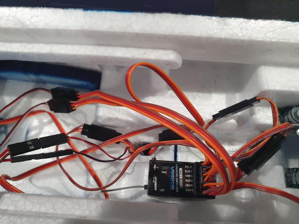

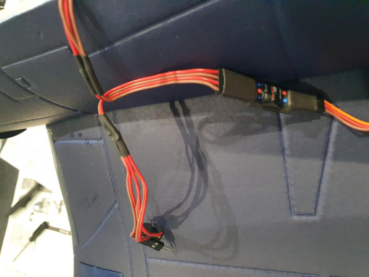

New to all this fin building dyhnam f4u corsair bound the transmitter everything working except can't get the undercarriage to go down or up see pictures all rudder flaps work but not undercarriage thanks in advance
What's wrong
Here's a test you can do - unplug the gear wire and the rudder wire from the receiver. Then plug the gear wire into the rudder position, and move the rudder stock all the way to one side, then the other to see if that activates the gear.
This is only a test.
If the gear works, then it means that the gear channel on the receiver isn't working.
If the gear still does not work, check the rest of the wiring that goes to the gear. You probably have a Y-connector and its possible that its plugged in backwards.
(Don't forget to plug the wires into the right places after you finish the test.)Marc flies FW & FL: AL37, MiG-29, T45,F4, A4, A10, F104 70 and 90, P38, Dauntless SBD, Corsair, B17, B24, B26 & P61, Lipp.P19, ME262, Komets, Vampire, SeaVixen, FMS Tigercat, FOX Glider & Radian XL.
