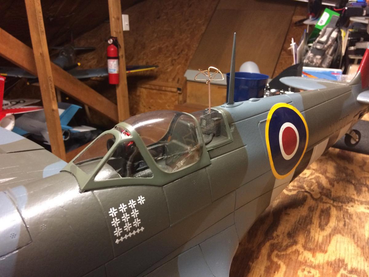

              As Alpha said use a 2 bladed prop, I use a 12x12 APC on mine. I use a 6s 3700 Zippy Compact for speed but be aware the wing flexes at high speeds on this, and slow before doing a pylon turn at speed. For sport flying I use the same battery but in 5s. If I was buying batteries today I'd get the 3500 Hobby Star. We have them set up for FPV combat here.
              J&W, this is for the 1200 FL Spit...
