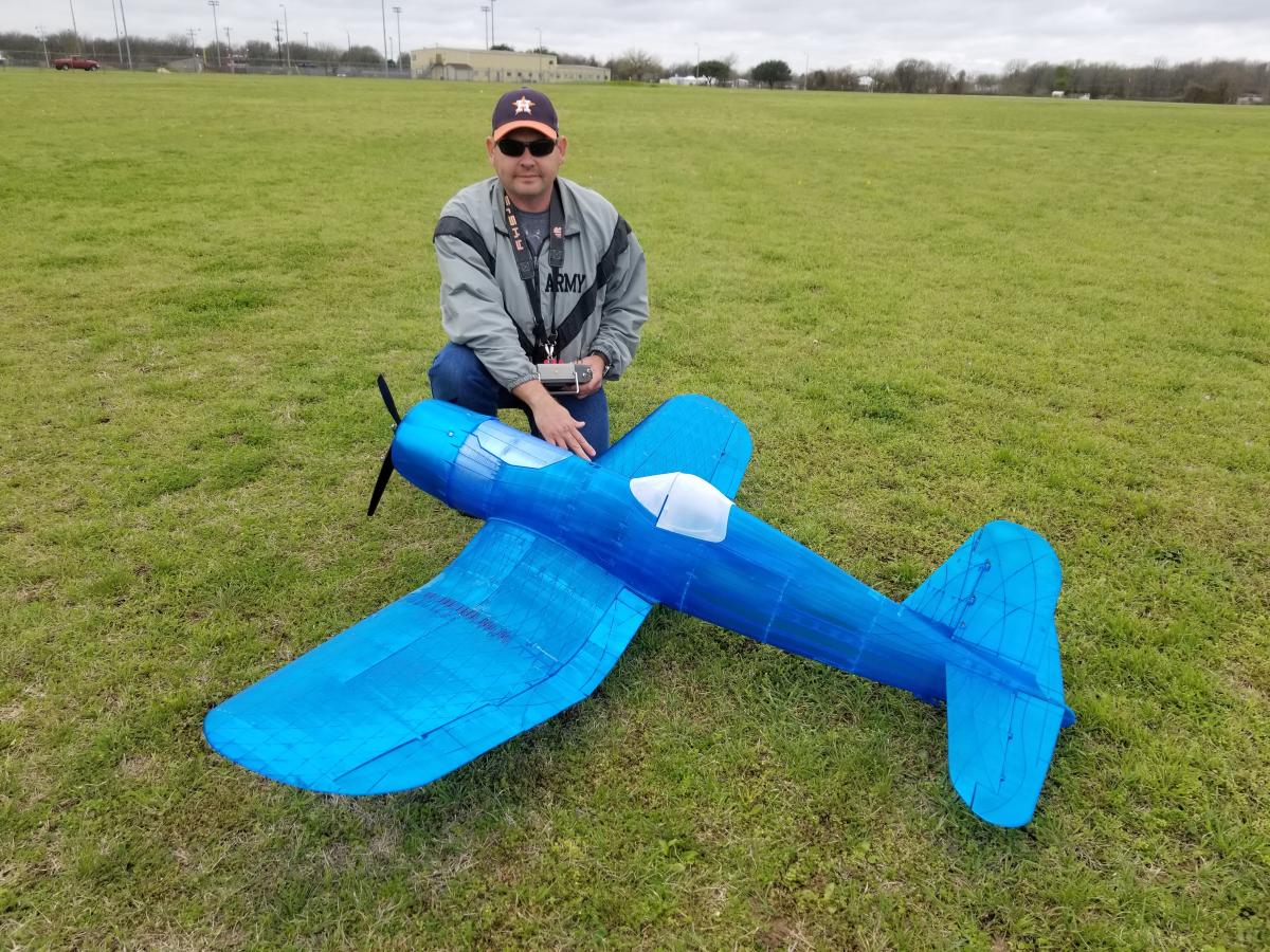

    Just finished this and attempted to maiden this past weekend. This is a petg print, I had an elevator issue i fixed today so she is 100% ready now. Hopefully we get the weather to fly her this weekend. Click image for larger version
    RM, I have these files, too, but like all things "hobby" there are only some many hours in my day. Did you incorporate the 'folding wings'? And did you add the P&W 2800? I plan on printing the P&W to add to my Flightline F-4u. Looking forward to your 'check flight' debrief. Best, Steve
      Yes I got the folding wings, but didn't print the P&W. I think I might do it after the test flight though if everything goes well. Click image for larger version

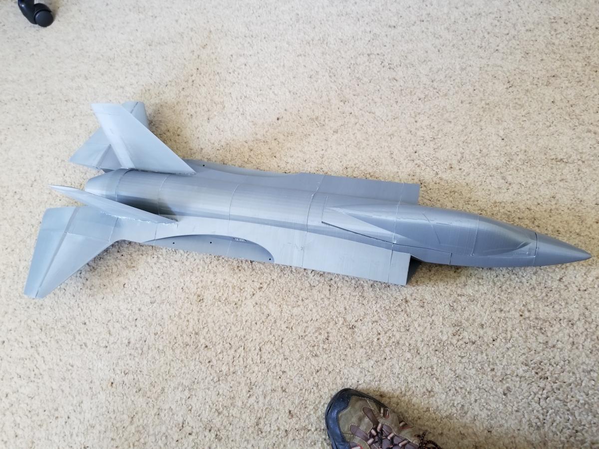

        Thanks guys, it's a blast. I'm working on a small F35 now. Have everything but the wings printed.
          Your Corsair is a major accomplishment for a 3DP plane! What size is your F-35?
            Small, 64mm fan. Just have wings to do... but ran out of filament lol. So a new roll is in route. Also awaiting parts from Motion. Servos and esc. Gonna fly on 4s. Click image for larger version
              She has wings now. Yay...
                Complete.
                  It looks quick just sitting there. When is the maiden? I assume there are wing spars in there somewhere?
                    rifleman_btx Nice Bro!!! Just too cool!! So happy you are enjoying your printer! What fun! Jerry
                      Hey thanks, but no I dont have a spar, as much as I would have liked to have a 6mm tube. Hopefully its light enough it won't be needed. I'm hoping this weekend to fly it; the fan is expected Friday.

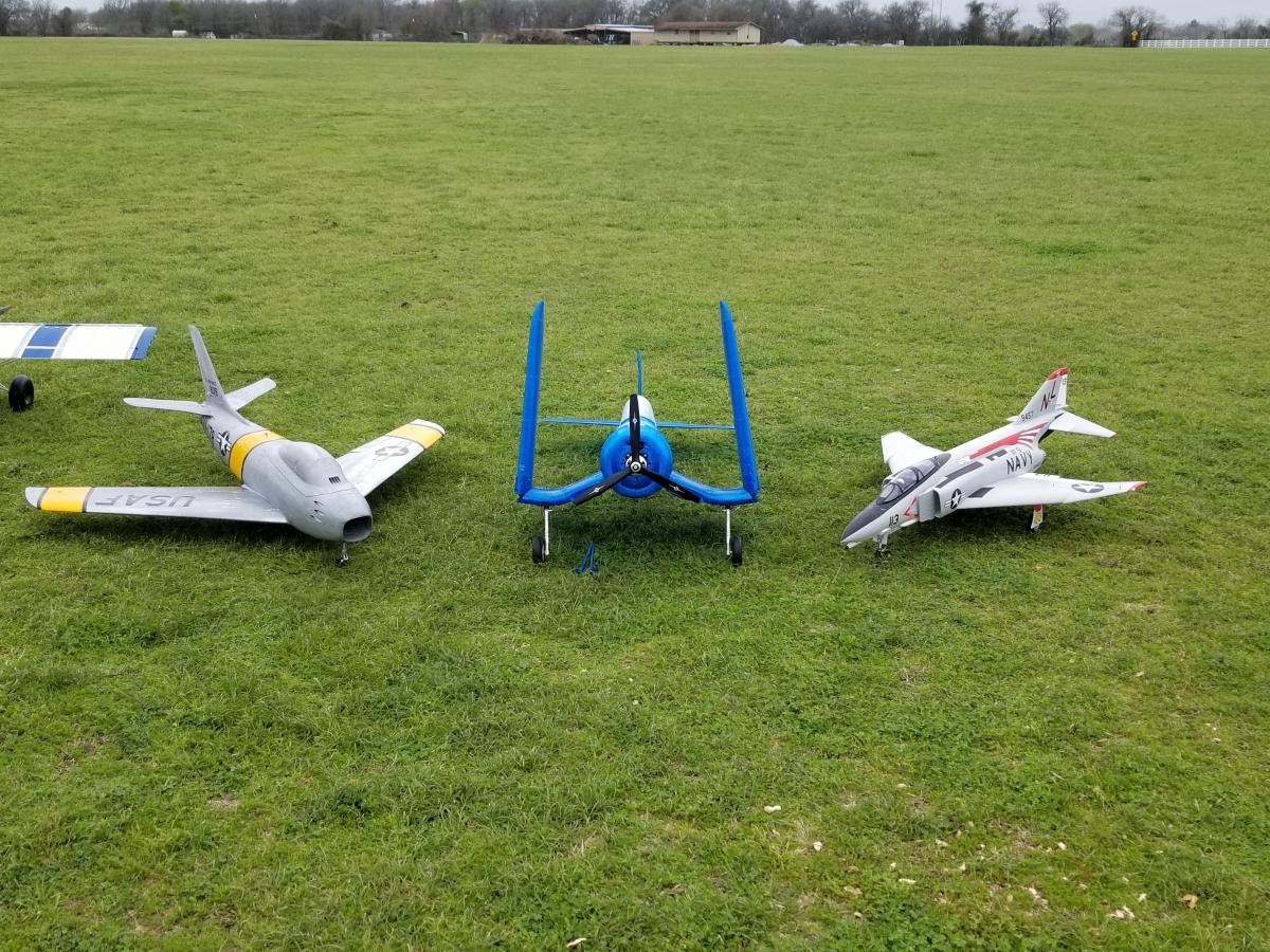

                        Wind looks right for a test flight of both planes tomorrow morning!

                              Did the maiden today, she was smooth and fast, wings are bolted in but I think I might glue them in though. Second flight was great too. Was very exciting. Like many edf hand launches you have to give it a good toss. Anyway all in all extremely happy. Still didn't get to fly the corsair.:disappointed: it rained all morning and it's a pain to put together and take down. Hopefully next weekend.
                              here's the website for the "F35" if anyone wants a go at it

                                As for the corsair it is totally in petg. I had to reinforce the tail under the horizontal stabilizer with a carbon fiber plate. That helped stiffen it up nicely, and honestly was my biggest concern with the flexibility. I also printed the f86 wing in petg and it was nice all around. I did have a problem though, the gear broke though it on a poor landing when the battery died and I couldn't get them retracted soon enough. It was esun petg and it seemed stiffer than the brand I used for the corsair. Looking forward to seeing what happens with this corsair now.
