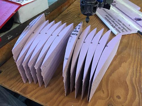

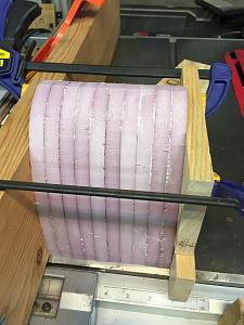

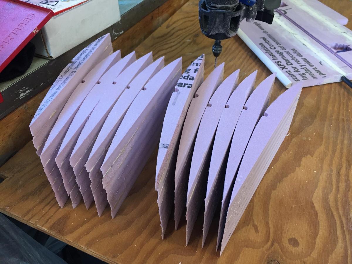

    Each one of those airfoil pieces(12) are made up of six individual pieces.
    There are two outer wing panels worth of top wing foils(6 per panel).
    Those top wing foils go to the outer wing panels of which the port is shown to the right.

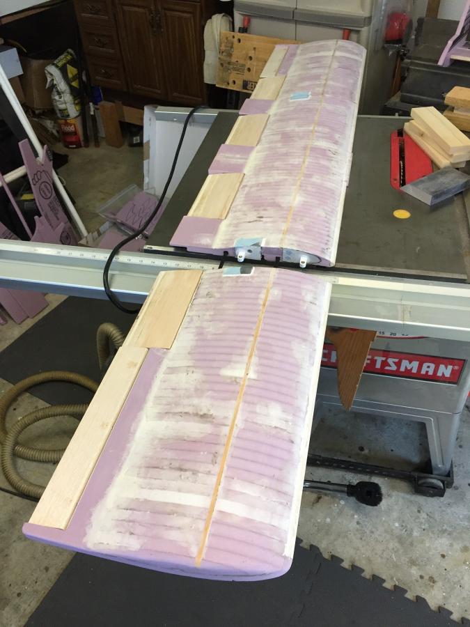

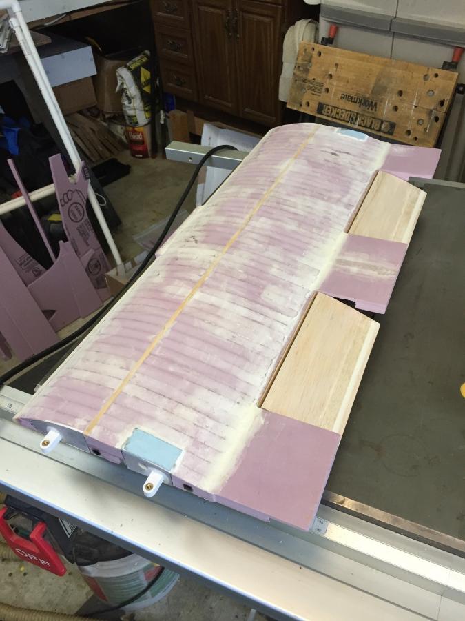

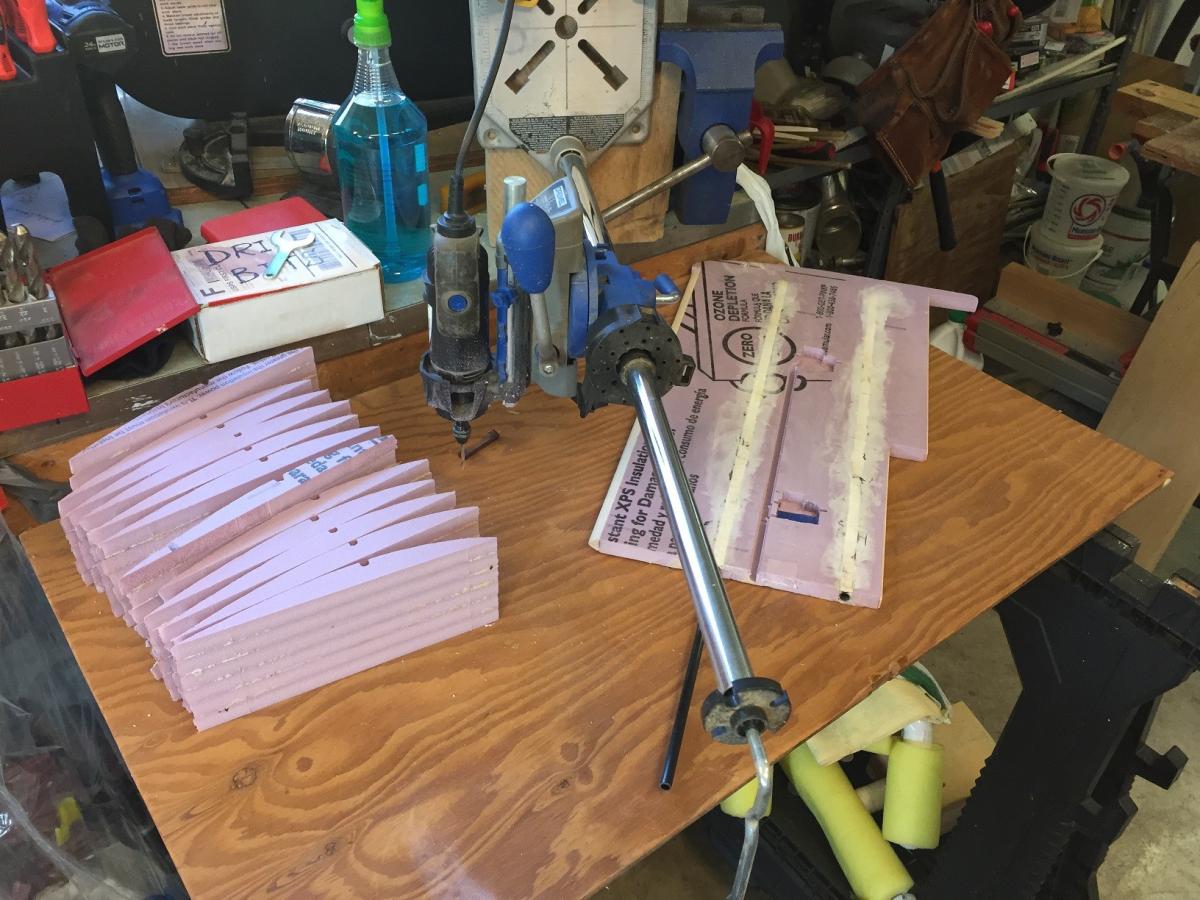

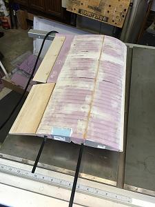

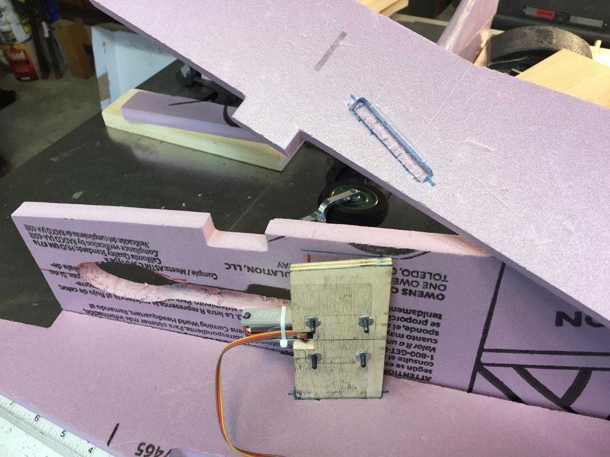

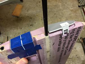

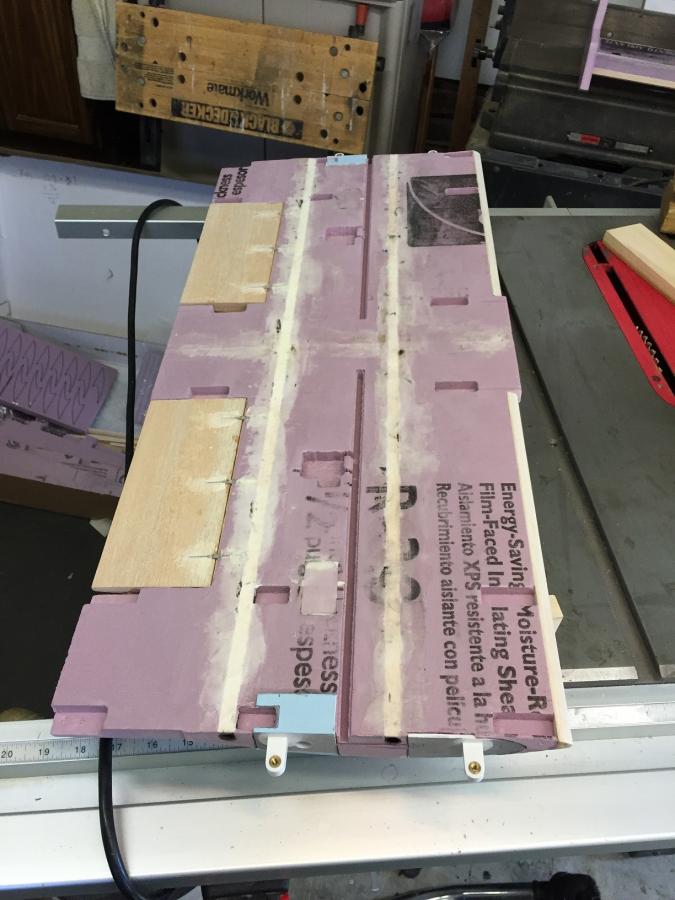

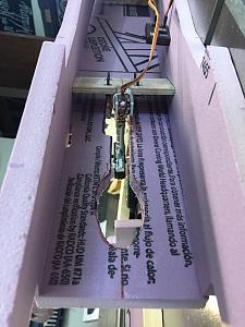

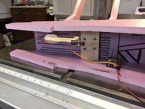

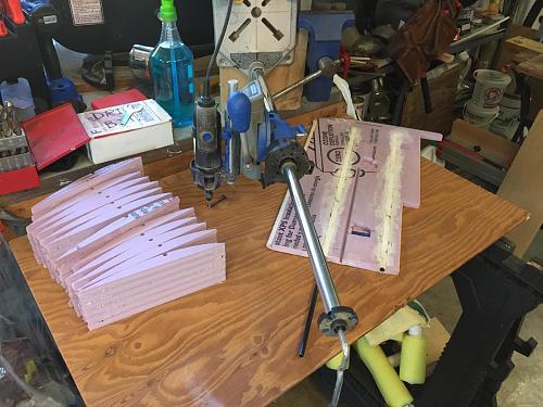

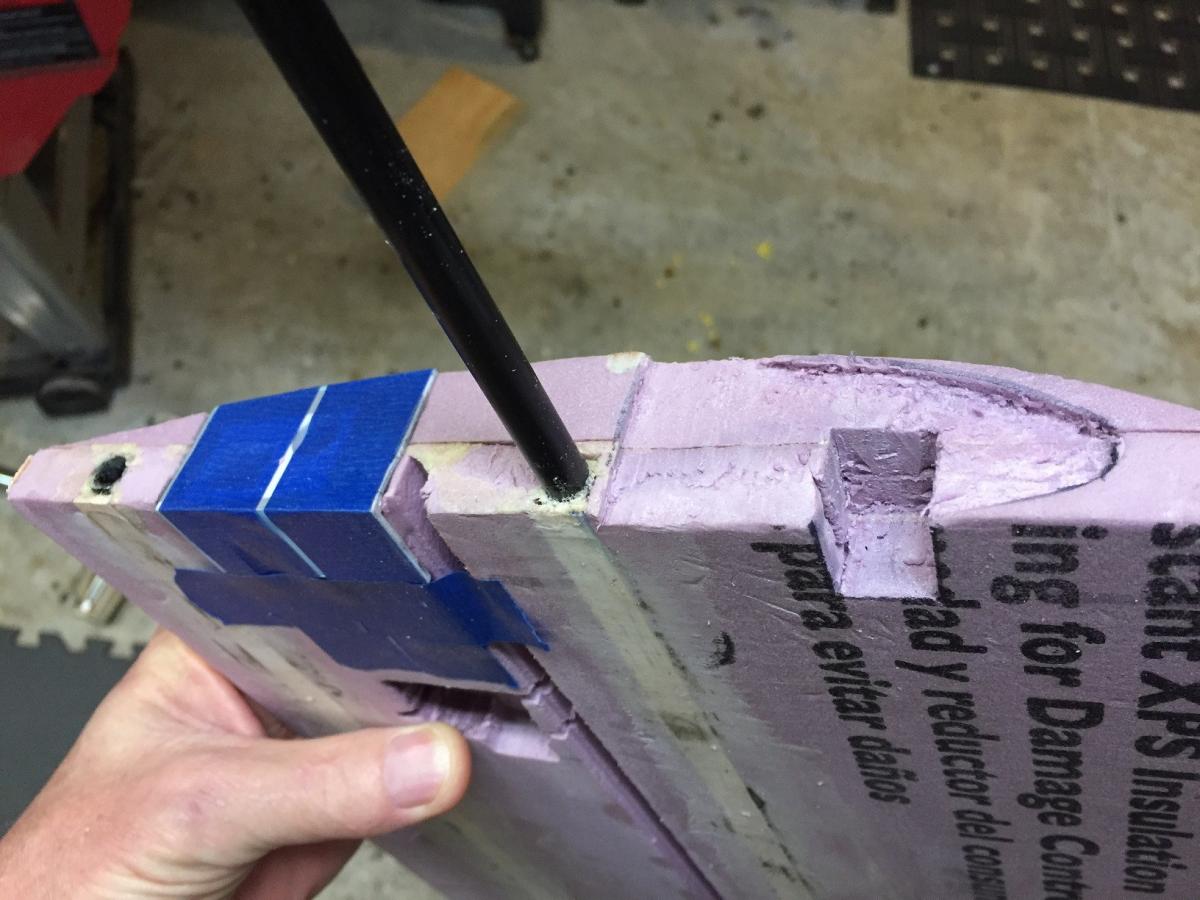

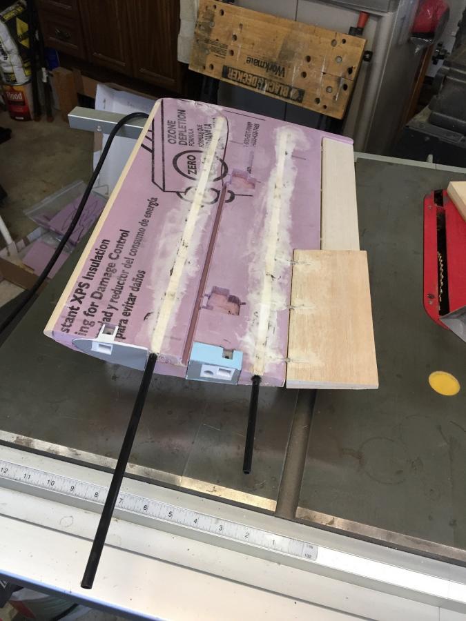

    That is the bottom view of the port outer panel where the servo's and wiring slots and CF tubes
    got installed. That Dremel horizontal milling setup in the center view is a Dremel drill press
    machine that I clamped into a horizontal position used to mill out the servo pockets and other slots
    Click image for larger version  Name:	IMG_1358.JPG Views:	15 Size:	147.5 KB ID:	243995

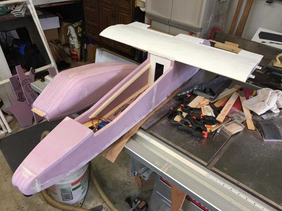

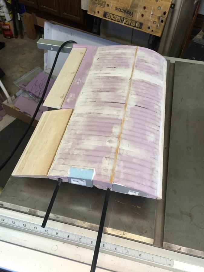

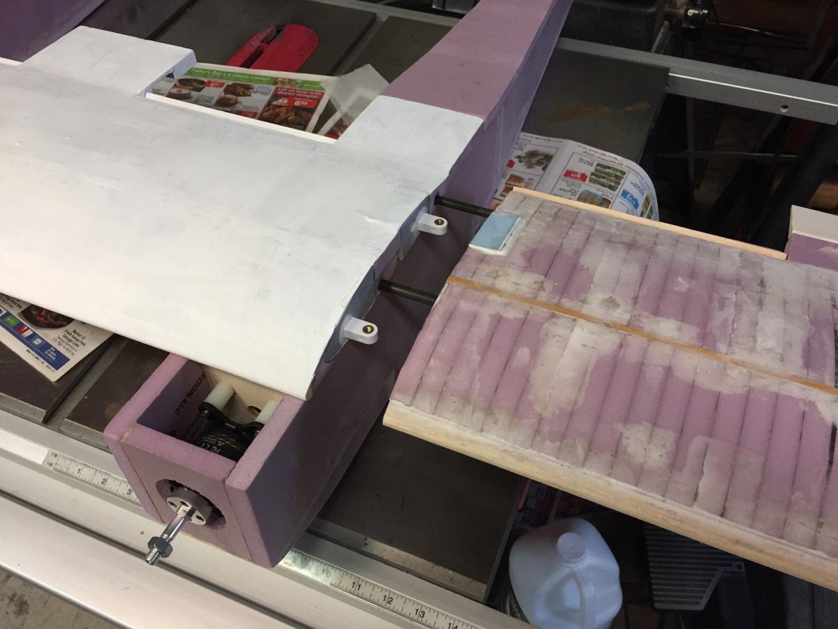

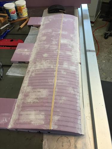

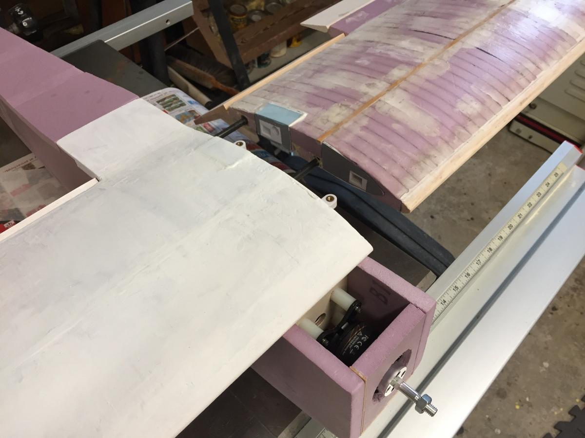

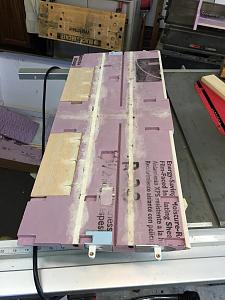

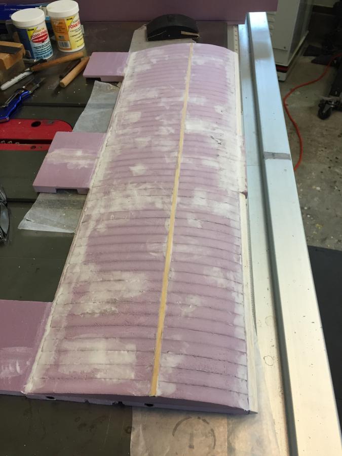

    So here is the center wing panel with all the airfoils glued on with Gorilla amber and the
    Foam-Tac Foam Filler/Finish process started.

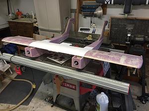

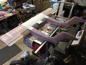

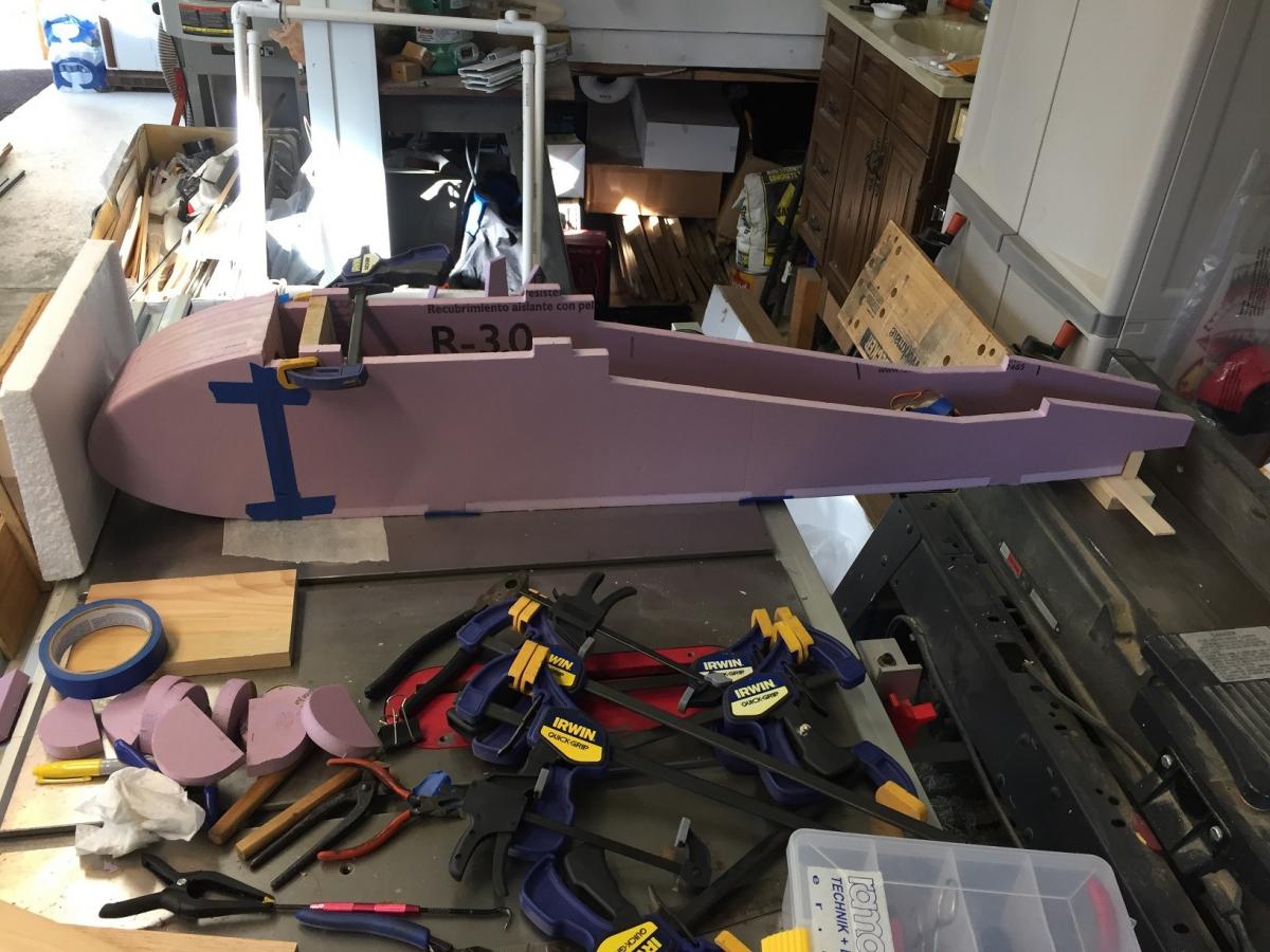

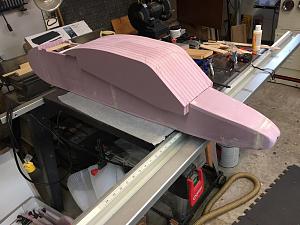

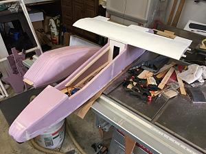

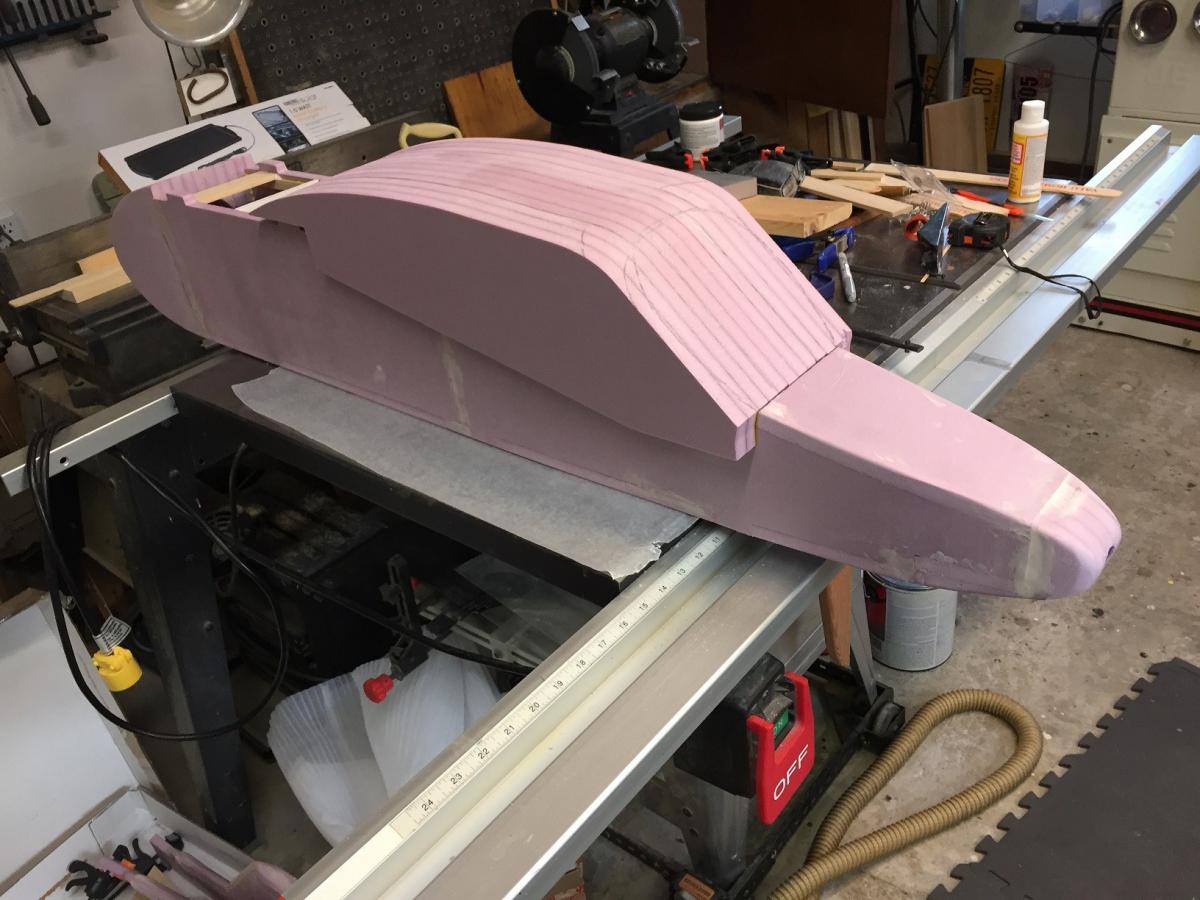

    Here's the fuselage, right and center wing panels. The booms and tail assembly aren't shown.
    Here's the tail assembly. I used attachment tabs from the Dynam FW 190
    that was on MRC clearance. Using techniques for easier part assembly
    that I have plagiarized from Alpha's great efforts over the years :face_with_hand_over

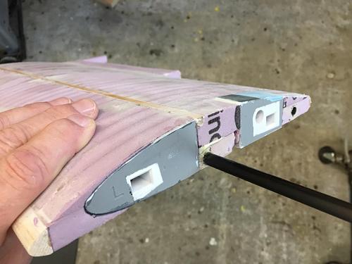

    Click image for larger version  Name:	IMG_1372.JPG Views:	6 Size:	91.0 KB ID:	243878

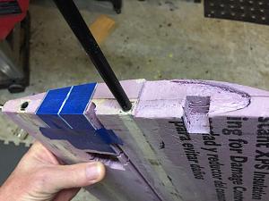

    Wing joiners that I saved from my wrecked FW A-10 and modded
    Click image for larger version  Name:	IMG_1361.JPG Views:	4 Size:	91.7 KB ID:	243879

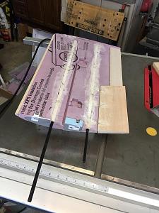

    Wing joiners installed in starboard outer wing panel.
    Click image for larger version  Name:	IMG_1362.JPG Views:	4 Size:	87.6 KB ID:	243880
    Port outer wing panel getting joiners installed
    Click image for larger version  Name:	IMG_1363.JPG Views:	4 Size:	109.9 KB ID:	243881Click image for larger version  Name:	IMG_1364.JPG Views:	4 Size:	107.4 KB ID:	243882

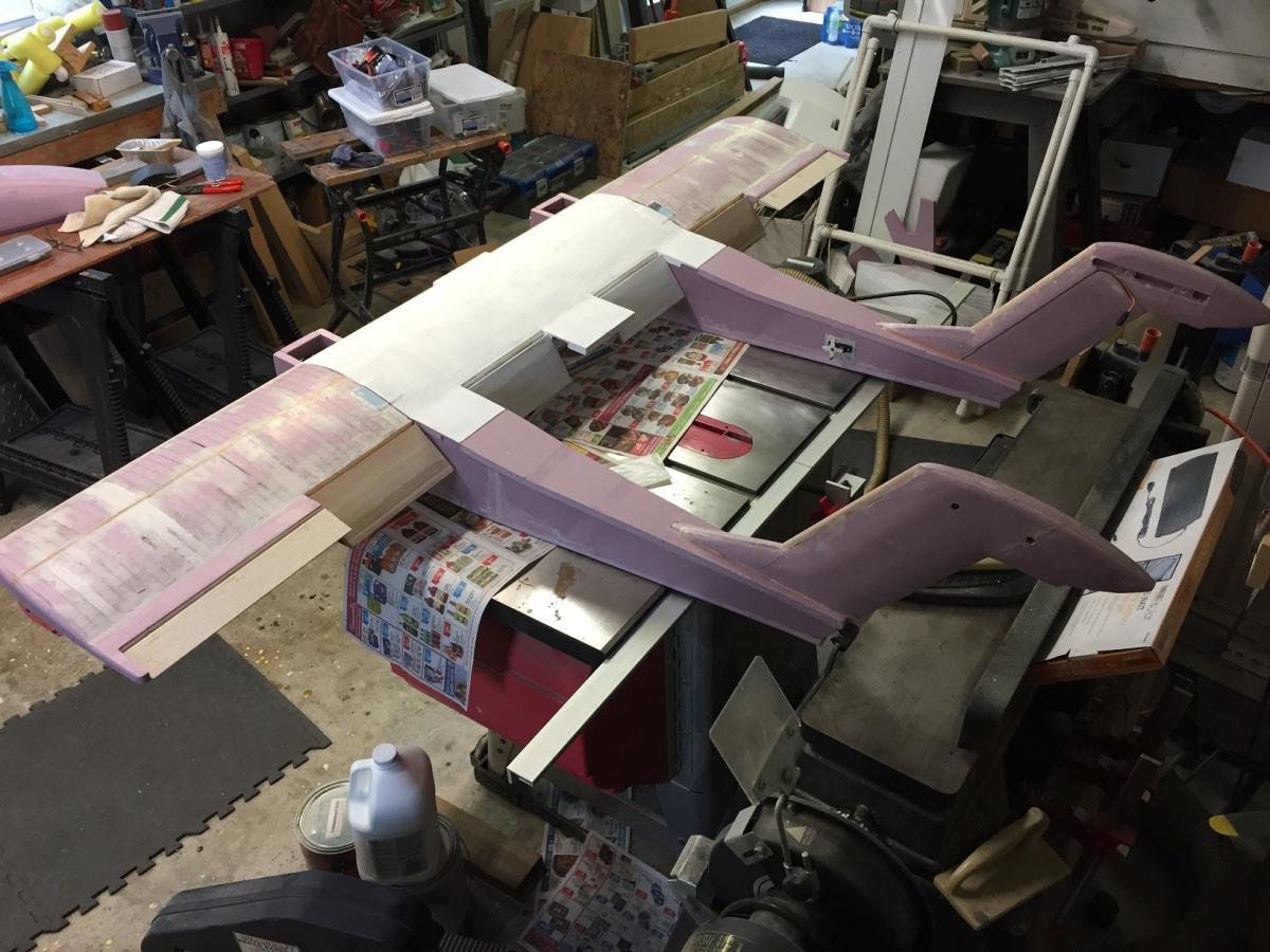

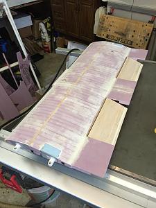

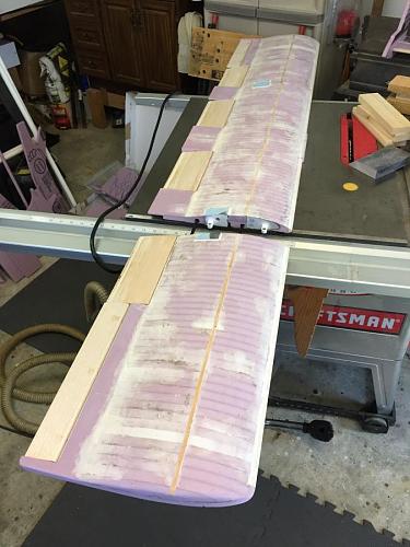

    Center wing panel with flaps installed - top/bottom views
    Click image for larger version  Name:	IMG_1366.JPG Views:	4 Size:	74.2 KB ID:	243883Click image for larger version  Name:	IMG_1367.JPG Views:	4 Size:	73.6 KB ID:	243884
    Port outer panel
    Click image for larger version  Name:	IMG_1368.JPG Views:	4 Size:	72.9 KB ID:	243885Click image for larger version  Name:	IMG_1369.JPG Views:	4 Size:	76.0 KB ID:	243886
    Test fitting all pieces together
    Click image for larger version  Name:	IMG_1370.JPG Views:	4 Size:	78.2 KB ID:	243887

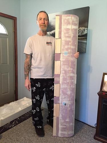

    I'm 6'3" Wing is now ready for finish sand and servo/control horn&rod install
    Click image for larger version  Name:	IMG_1371.JPG Views:	5 Size:	71.8 KB ID:	243888

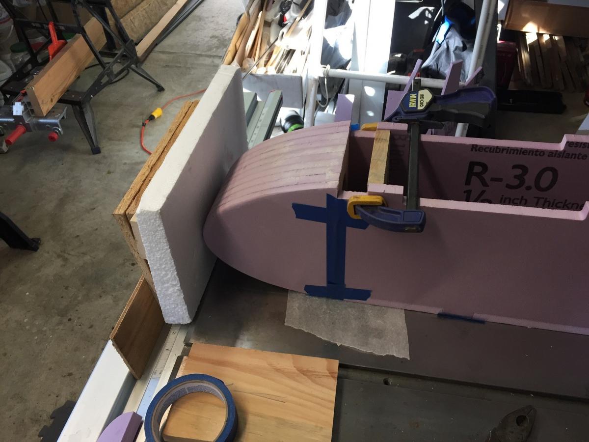

          Here's about another 12 hours of tedious (fun) work but it does make me really appreciate the benefits that the ARF foamie scene
          these past few years has allowed us especially in such stunning scale fidelity.

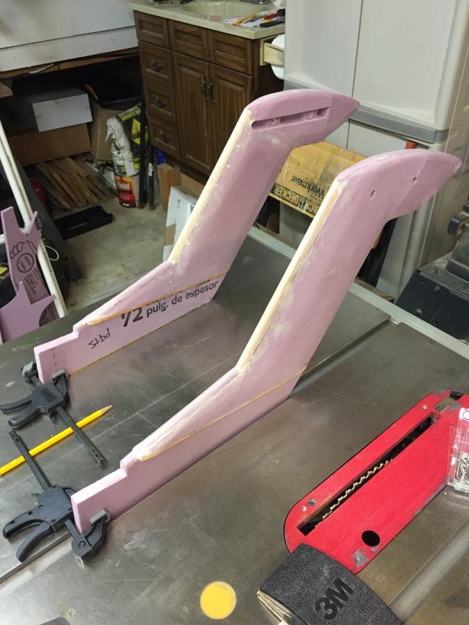

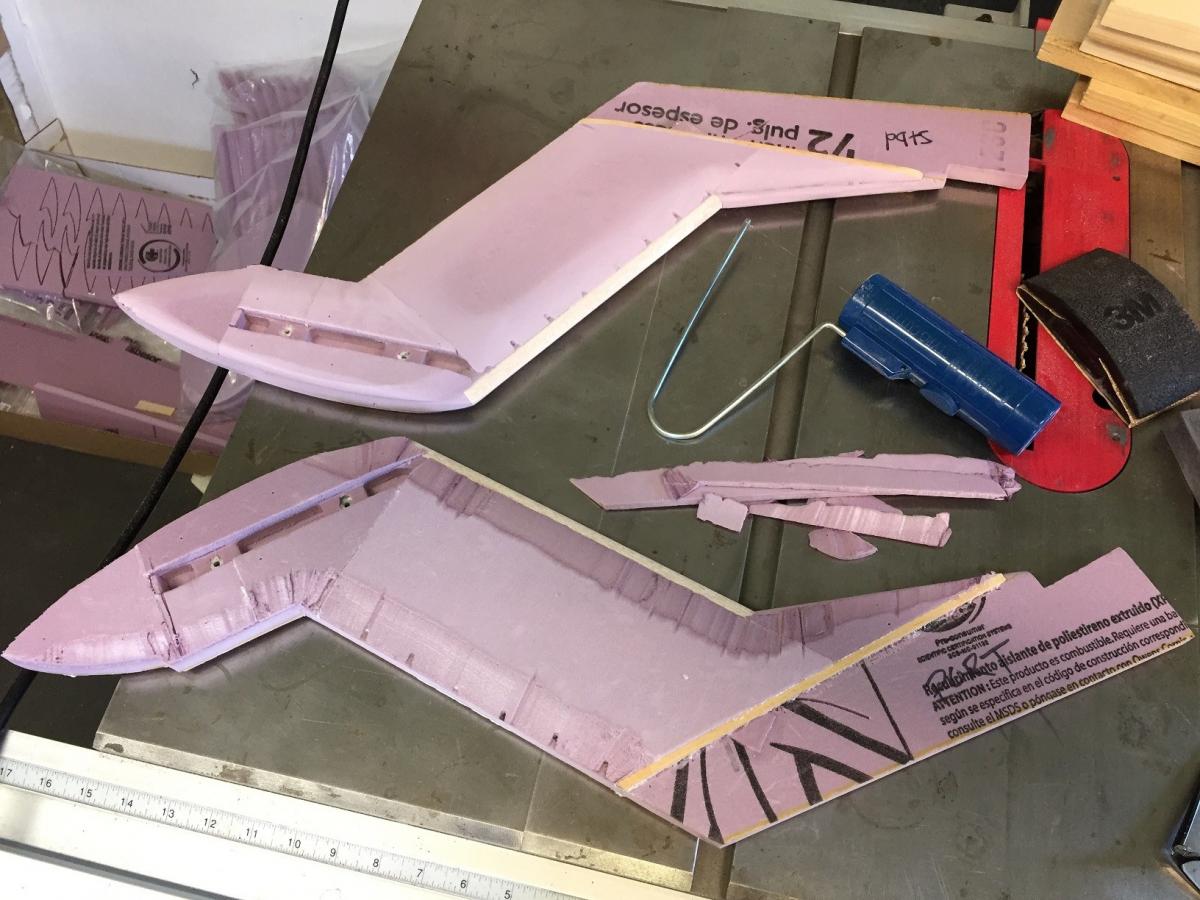

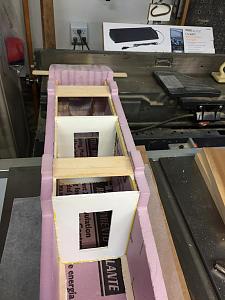

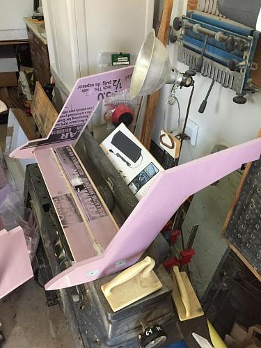

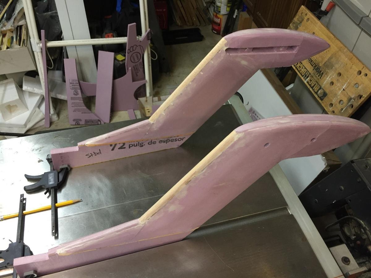

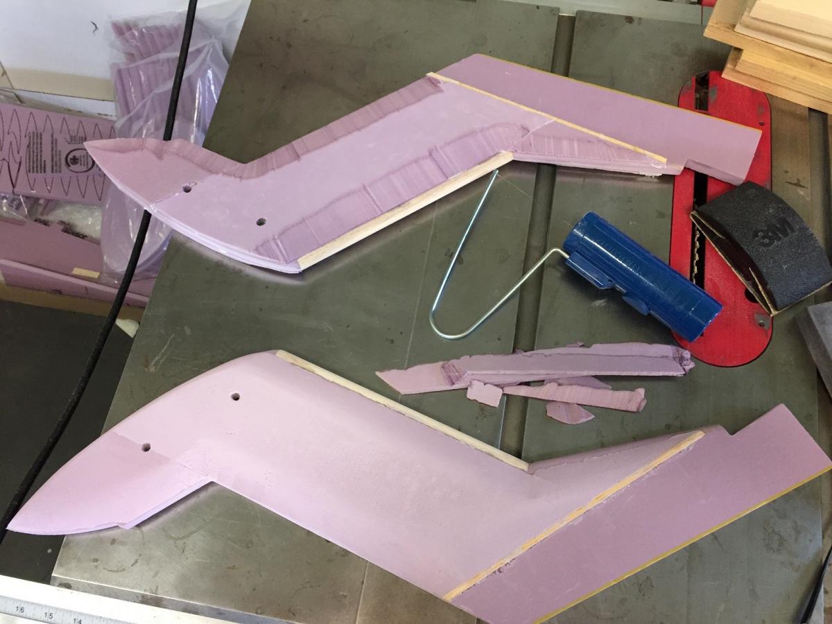

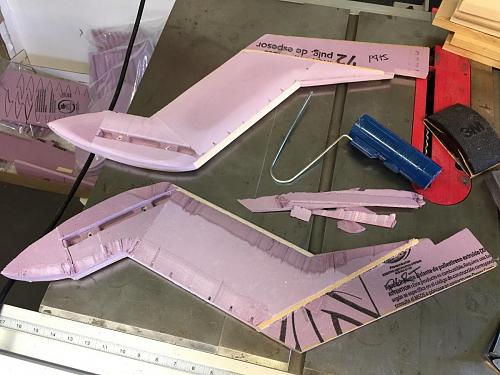

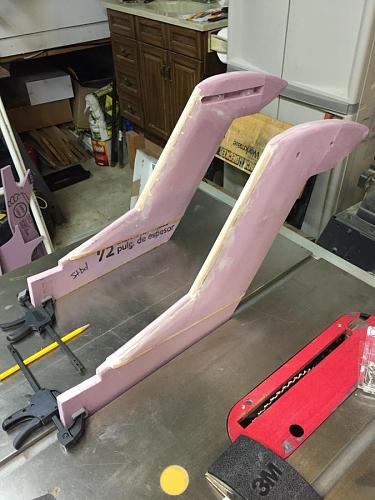

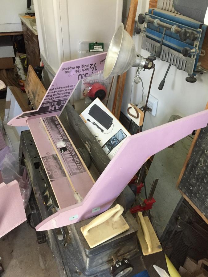

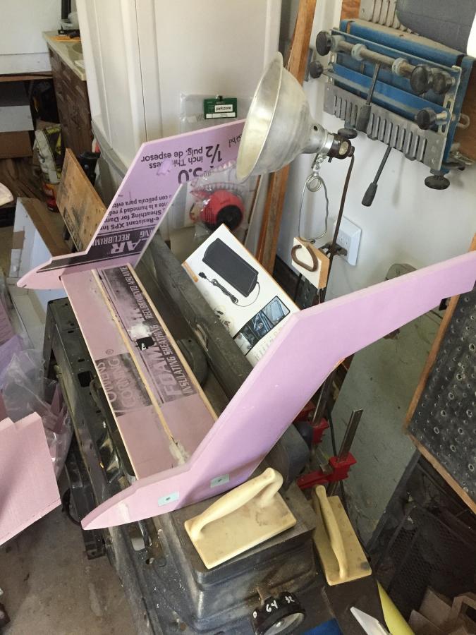

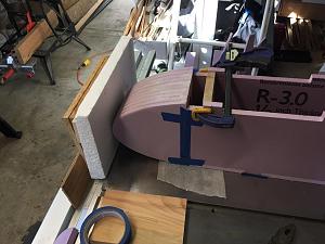

          The start of the vert stabs by checking horiz stab fit up.
          What you see is the 1/2 inch core of the vert stab.
          Click image for larger version  Name:	IMG_1372.JPG Views:	0 Size:	91.0 KB ID:	245551

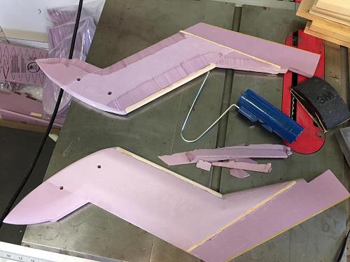

          Some foam wire carving and then elbow grease with the sanding rubber/foam blocks
          Click image for larger version  Name:	IMG_1373.JPG Views:	0 Size:	129.3 KB ID:	245552Click image for larger version  Name:	IMG_1374.JPG Views:	0 Size:	106.5 KB ID:	245553
          Working the aerodynamic details. The core of the vert stab is 1/2 inch with 1/4 inch
          slabs laminated to each side. Used the bandsaw to rip the 1/2" in halves.
          Click image for larger version  Name:	IMG_1377.JPG Views:	0 Size:	113.6 KB ID:	245554
          Fill-in work/touch-up using Foam Finish
          Click image for larger version  Name:	IMG_1375.JPG Views:	0 Size:	80.7 KB ID:	245555
          And lastly, a finish sand and coat of Mod Podge Matte. It is an excellent glue/sealer/finish
          that leaves the surface of the foam resistant to dings and compressions.
          Click image for larger version  Name:	IMG_1376.JPG Views:	0 Size:	110.4 KB ID:	245556
          Slowly but surely it is on it's way.

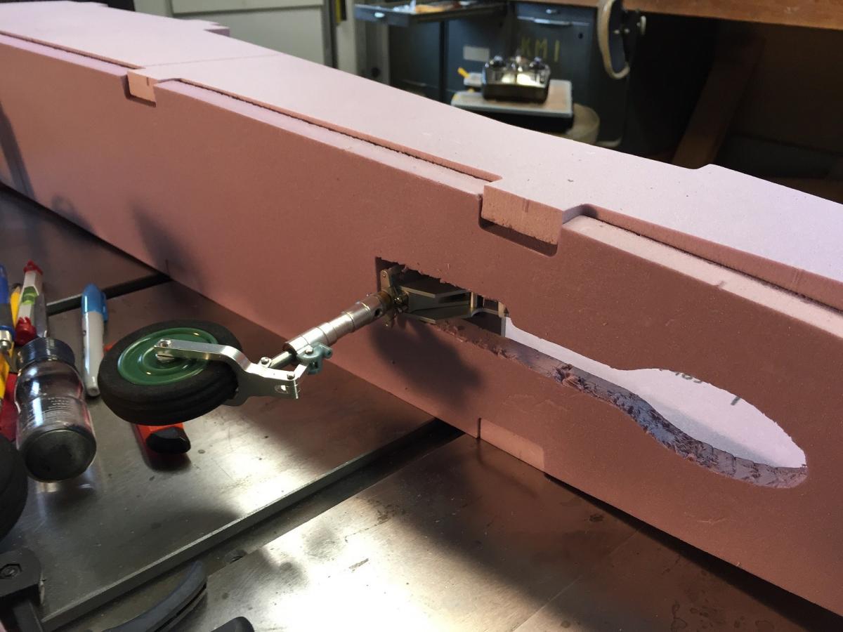

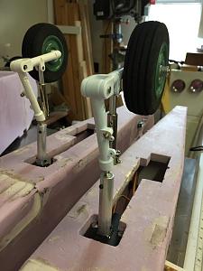

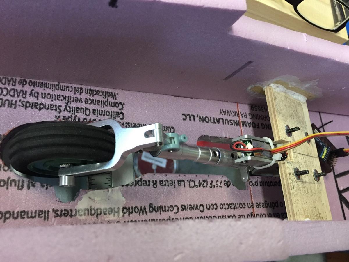

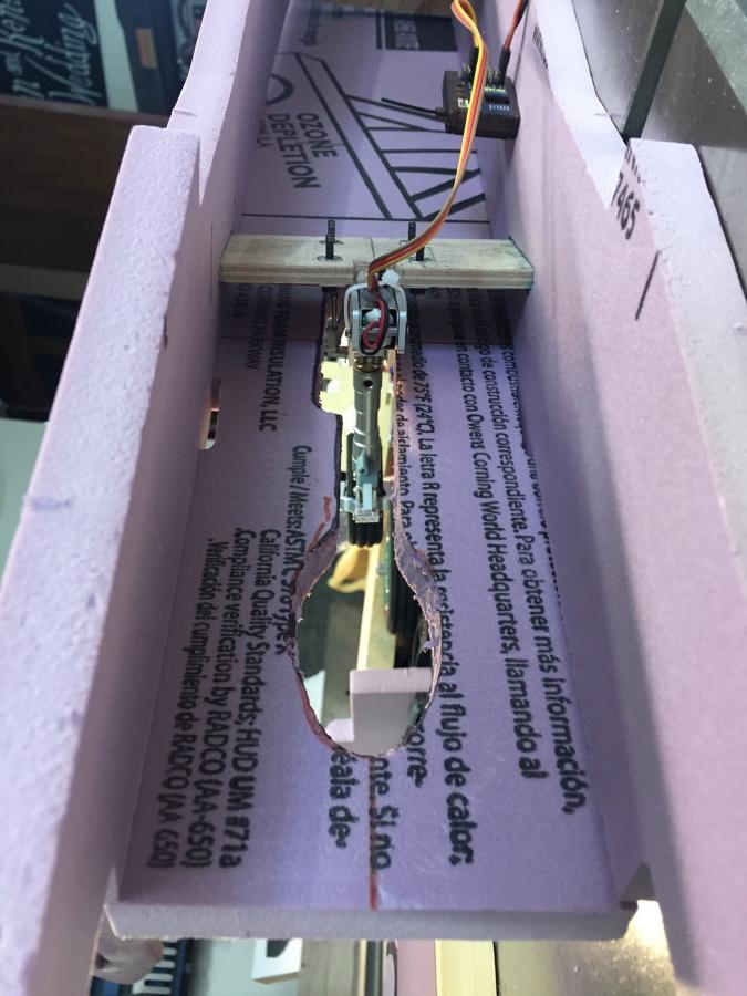

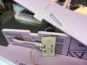

                  Over on the Pro-fly Bronco thread I commented about using the 90mm YAK-130 gear for that bird.
                  Well the owners of that bird will be able to see from this fitting in the near future if they missed an opportunity.
                  I say missed opportunity because Freewing discontinued the YAK and I got lucky and got the last gear set from Motion.

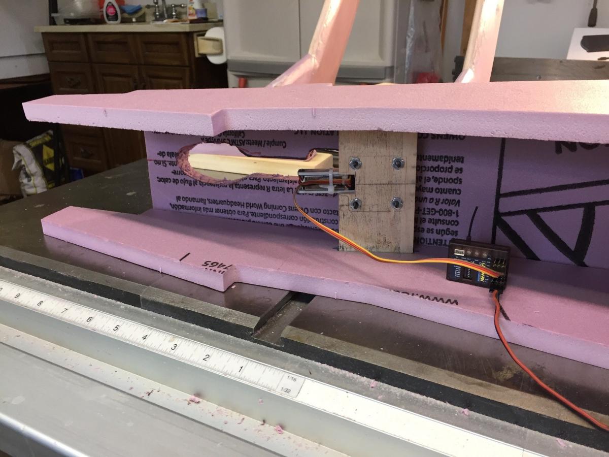

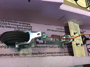

                  Am using an E-Flite 110 degree nose etract which is the ticket for getting the nose gear tucked away nicely.
                  Plan to use E-Flite 90 degree nose etracts on the mains because I want that mount plate that doesn't require recessing
                  the etract so as to use a solid versus notched ply mount plate.
                  Click image for larger version  Name:	IMG_1378.JPG Views:	0 Size:	124.9 KB ID:	251209
                  Sizing the dado joint and angle for the nose gear
                  Click image for larger version  Name:	IMG_1384.JPG Views:	0 Size:	138.5 KB ID:	251210
                  Determined gear clearance hole, maybe do gear doors later
                  Click image for larger version  Name:	IMG_1383.JPG Views:	0 Size:	119.6 KB ID:	251211

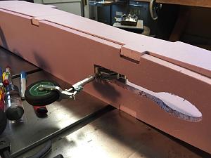

                  Checking gear down geometry
                  Click image for larger version  Name:	IMG_1381.JPG Views:	0 Size:	94.5 KB ID:	251212Click image for larger version  Name:	IMG_1382.JPG Views:	0 Size:	73.3 KB ID:	251213
                  Checking gear up geometry, the 110 degree was the right choice

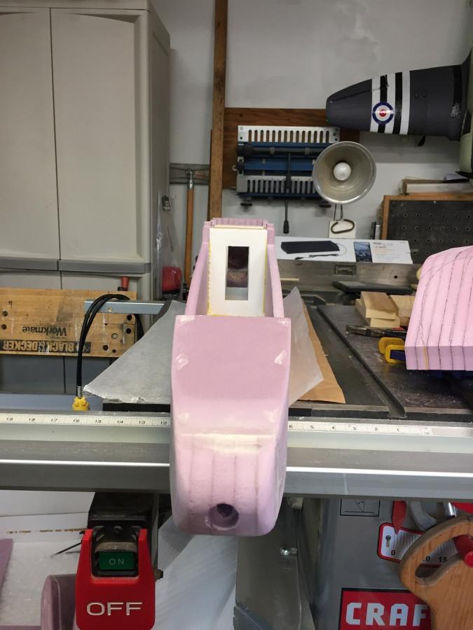

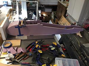

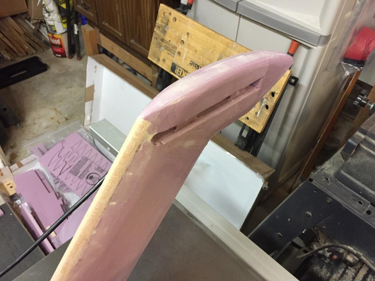

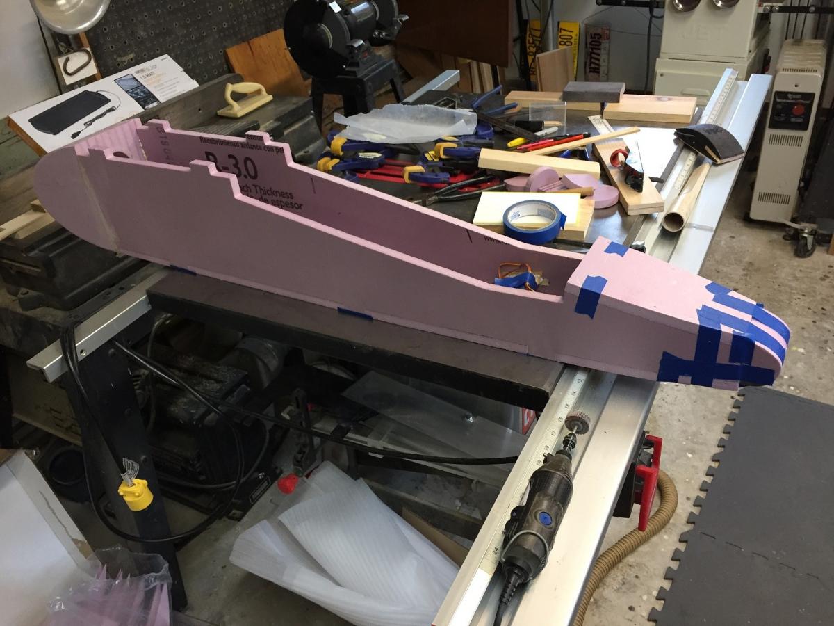

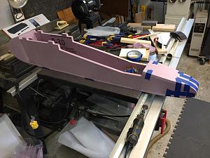

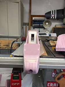

                  Gluing up the fuse tail and then some sanding.
                  Click image for larger version  Name:	IMG_1395.JPG Views:	0 Size:	70.4 KB ID:	251216Click image for larger version  Name:	IMG_1401.JPG Views:	0 Size:	79.8 KB ID:	251217
                  Putting the butt cheek on.
                  Click image for larger version  Name:	IMG_1403.JPG Views:	0 Size:	110.3 KB ID:	251218Click image for larger version  Name:	IMG_1404.JPG Views:	0 Size:	133.6 KB ID:	251219
                  Getting the nose Gorilla'd on, luv that for structural strength.
                  Click image for larger version  Name:	IMG_1405.JPG Views:	0 Size:	129.1 KB ID:	251220

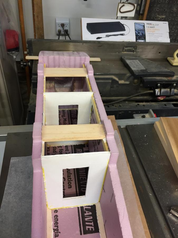

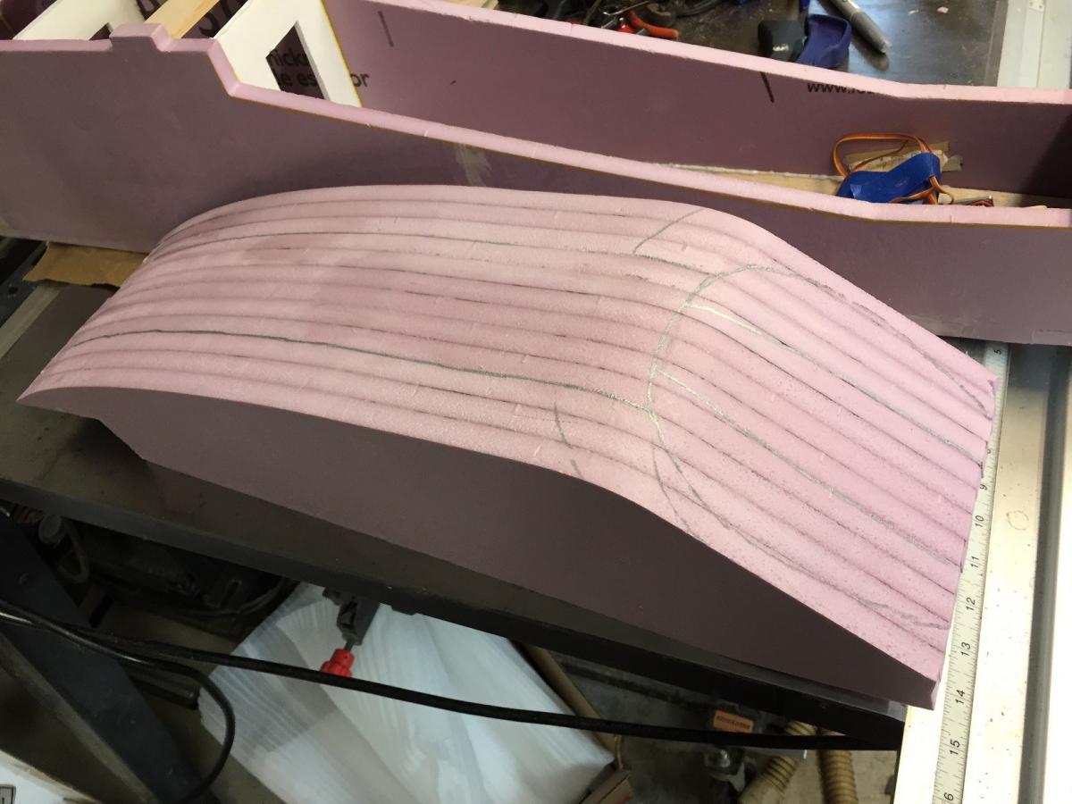

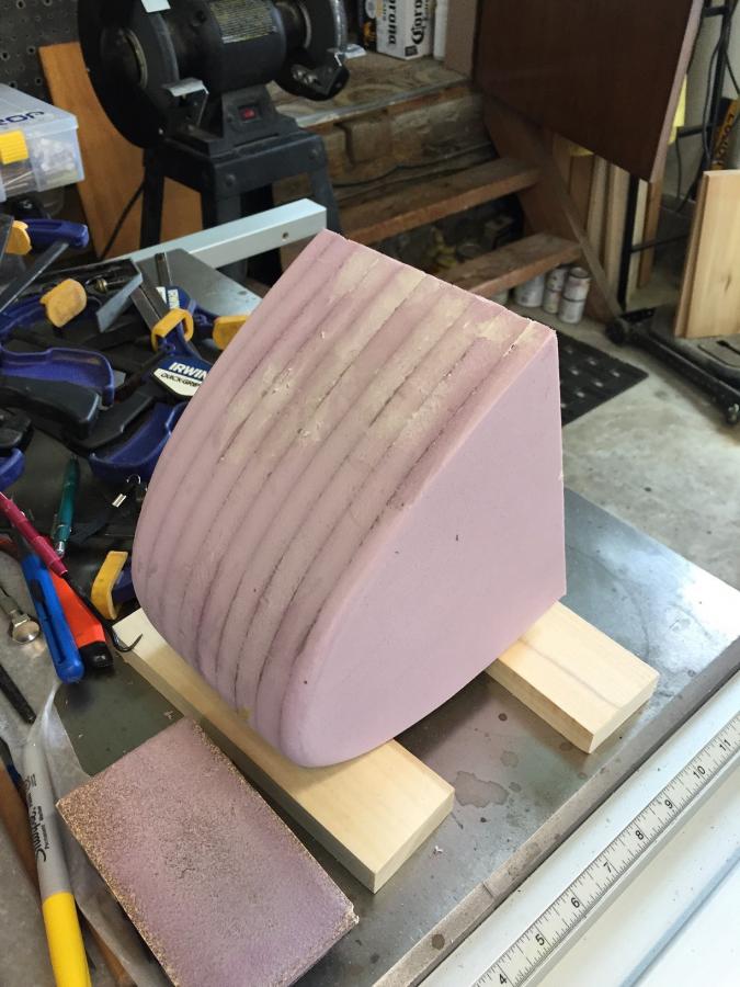

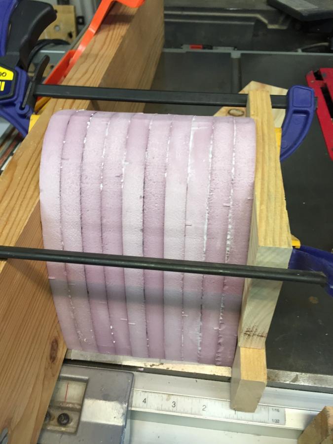

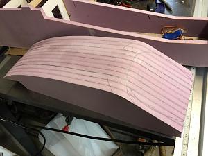

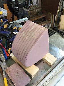

                  Got all the pieces laminated for the canopy, decided to go this route
                  rather than my original plan of dropping a C-note for the Pro-Fly cockpit.
                  Click image for larger version  Name:	IMG_1409.JPG Views:	0 Size:	98.5 KB ID:	251221 Click image for larger version  Name:	image_55494.jpg Views:	3 Size:	120.9 KB ID:	251222
                  A couple structural bulkheads plus two mounting plates(1/4" Home Depot paint stir sticks) for the wing bolts.
                  Also got the landing light mount hole done with a forstner bit
                  Click image for larger version  Name:	IMG_1407.JPG Views:	0 Size:	70.5 KB ID:	251223Click image for larger version  Name:	IMG_1408.JPG Views:	0 Size:	67.1 KB ID:	251224

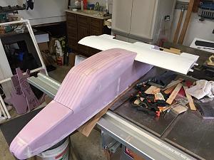

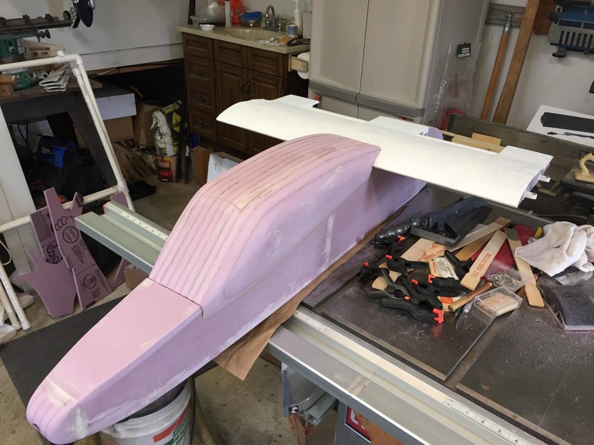

                  Canopy is sanded to rough geometry and fitted against the center wing
                  Click image for larger version  Name:	IMG_1410.JPG Views:	0 Size:	139.9 KB ID:	251225Click image for larger version  Name:	IMG_1411.JPG Views:	0 Size:	132.8 KB ID:	251226
                  The wing has it's base white coat because I like Alpha like the white wing with OD green fuse.

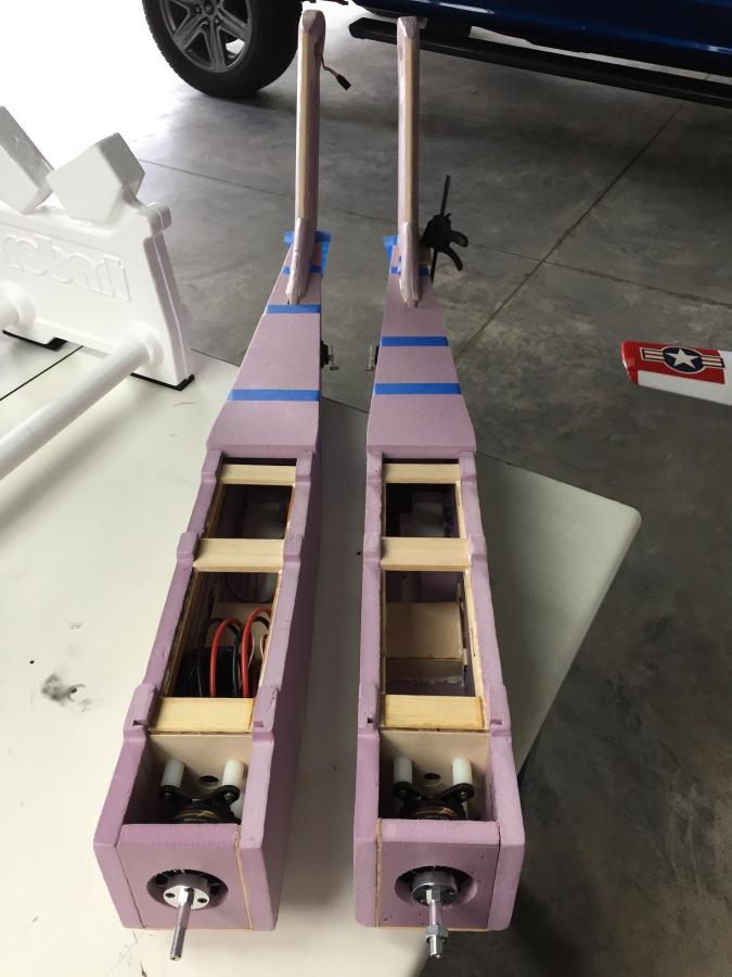

                              Just about have the booms completed, probably another round of update pics in a week.
                                Well that was a looooong week :lying_face:
                                It's been sweltering for our standards in temps here in the northeast so back inside from outdoor work and back to the build.
                                Had my every 2 month EGD from the VA this morning so no messing around other than to fiddle with the Bronco this afternoon.

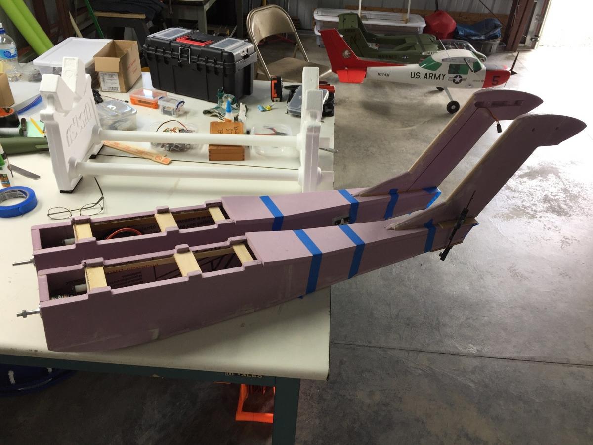

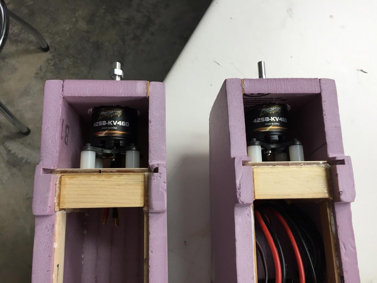

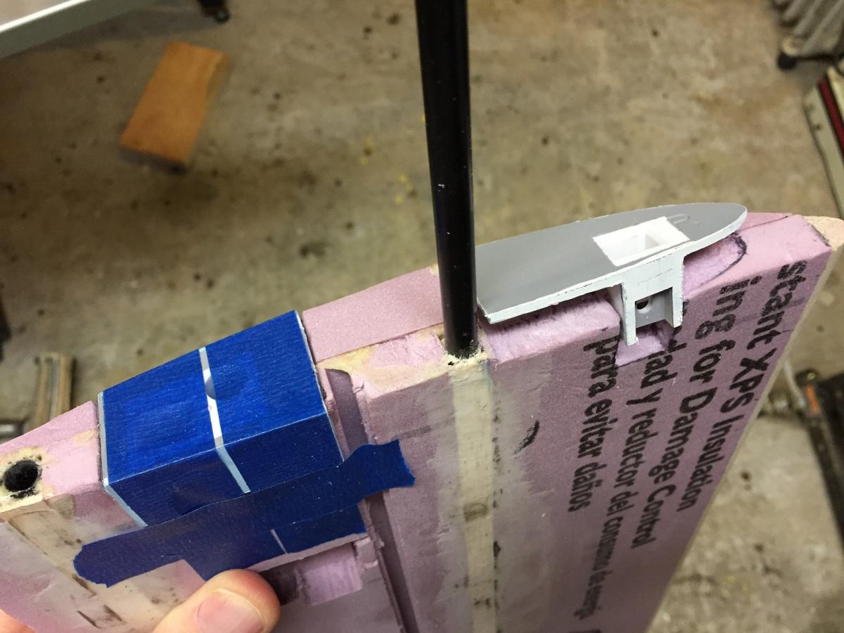

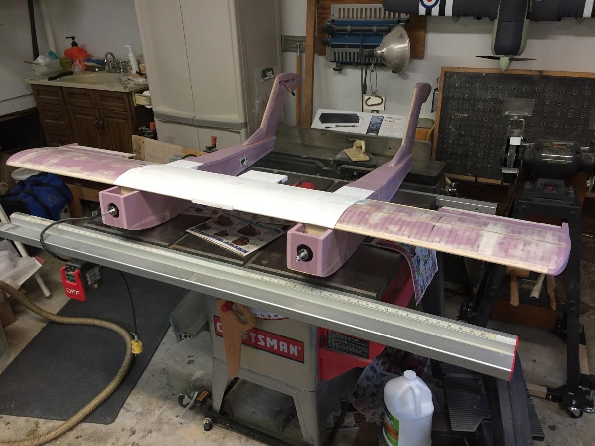

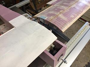

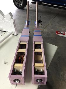

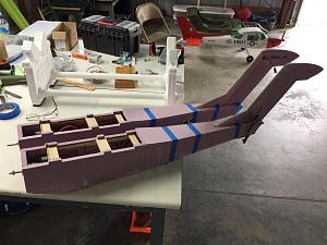

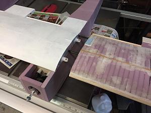

                                Trial fitted the center wing and outer panels to the booms in preparation for installing the mounting hardware for the wing/boom connection.
                                The FMS Tigercat motors. And the verticals getting Gorilla'd to the booms
                                Click image for larger version  Name:	IMG_1420.JPG Views:	73 Size:	91.2 KB ID:	263224Click image for larger version  Name:	IMG_1421.JPG Views:	42 Size:	60.6 KB ID:	263225Click image for larger version  Name:	IMG_1422.JPG Views:	40 Size:	125.6 KB ID:	263226
                                Perfect fit to the booms regarding flap spacing.
                                Start sanding the booms later this week.
                                Click image for larger version  Name:	IMG_1424.JPG Views:	41 Size:	143.9 KB ID:	263227Click image for larger version  Name:	IMG_1425.JPG Views:	40 Size:	128.6 KB ID:	263228

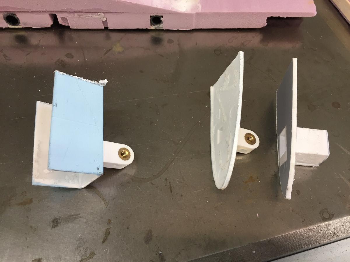

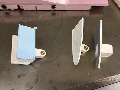

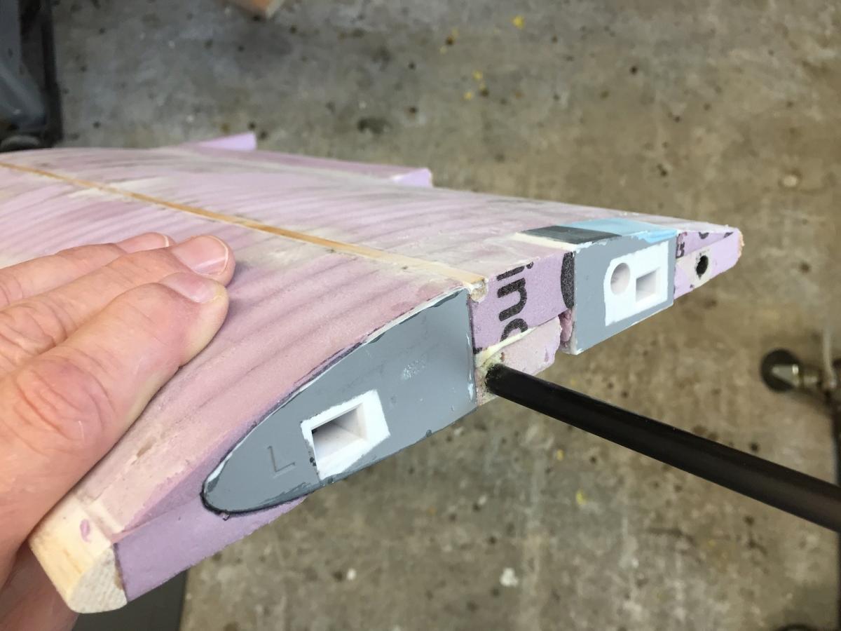

                                Just showing off the salvaged/modified FW A-10 wing hard point attachments
                                Click image for larger version  Name:	IMG_1426.JPG Views:	39 Size:	102.2 KB ID:	263229Click image for larger version  Name:	IMG_1427.JPG Views:	40 Size:	92.8 KB ID:	263230
                                The hard work of fabrication is basically complete, now onto the tedious wiring task from the booms to the fuselage after the empanages are attached to the wing.

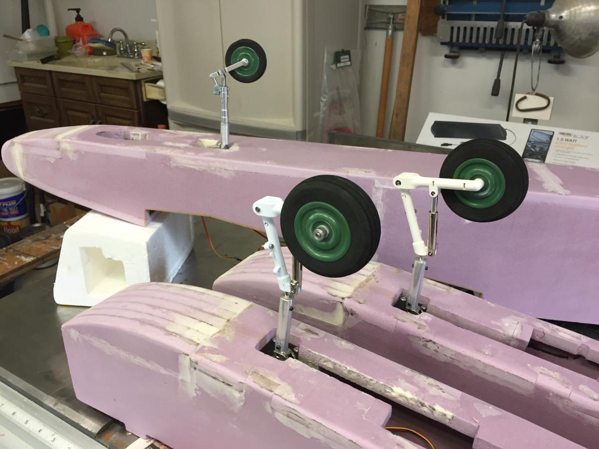

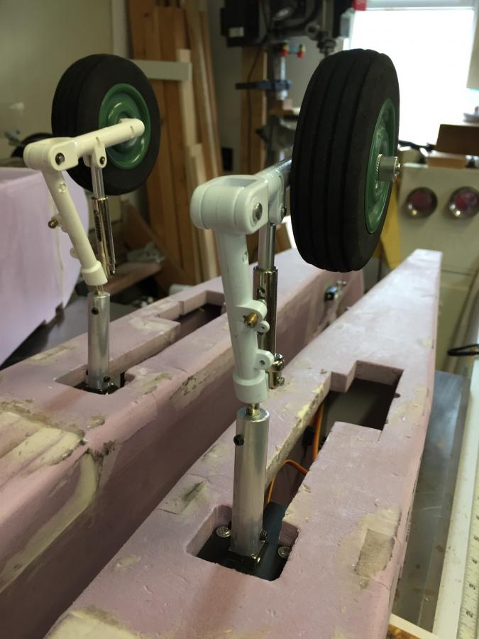

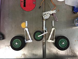

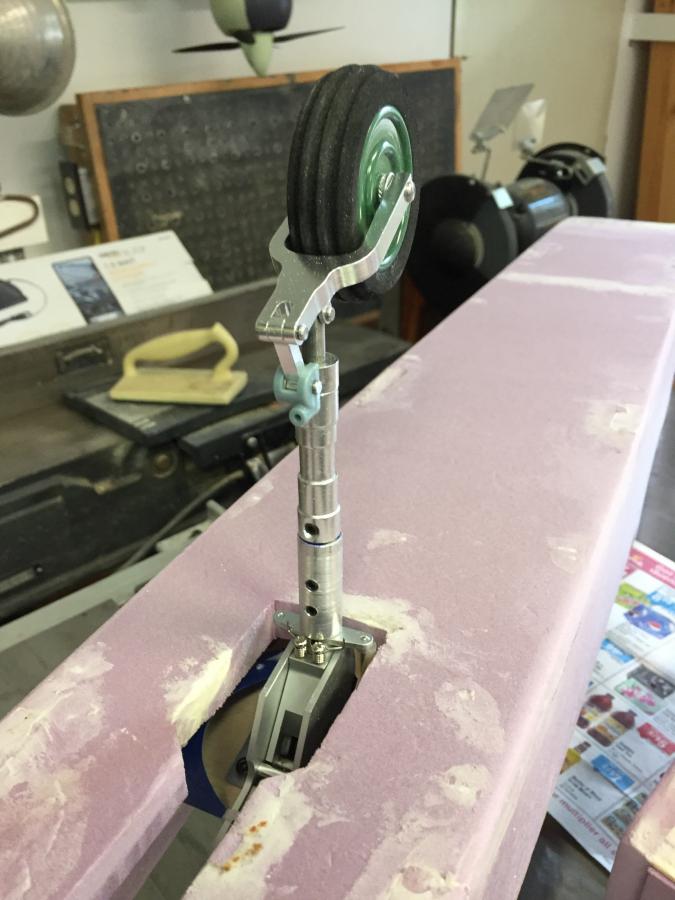

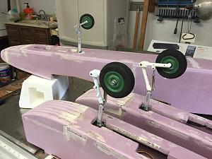

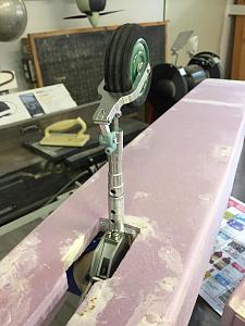

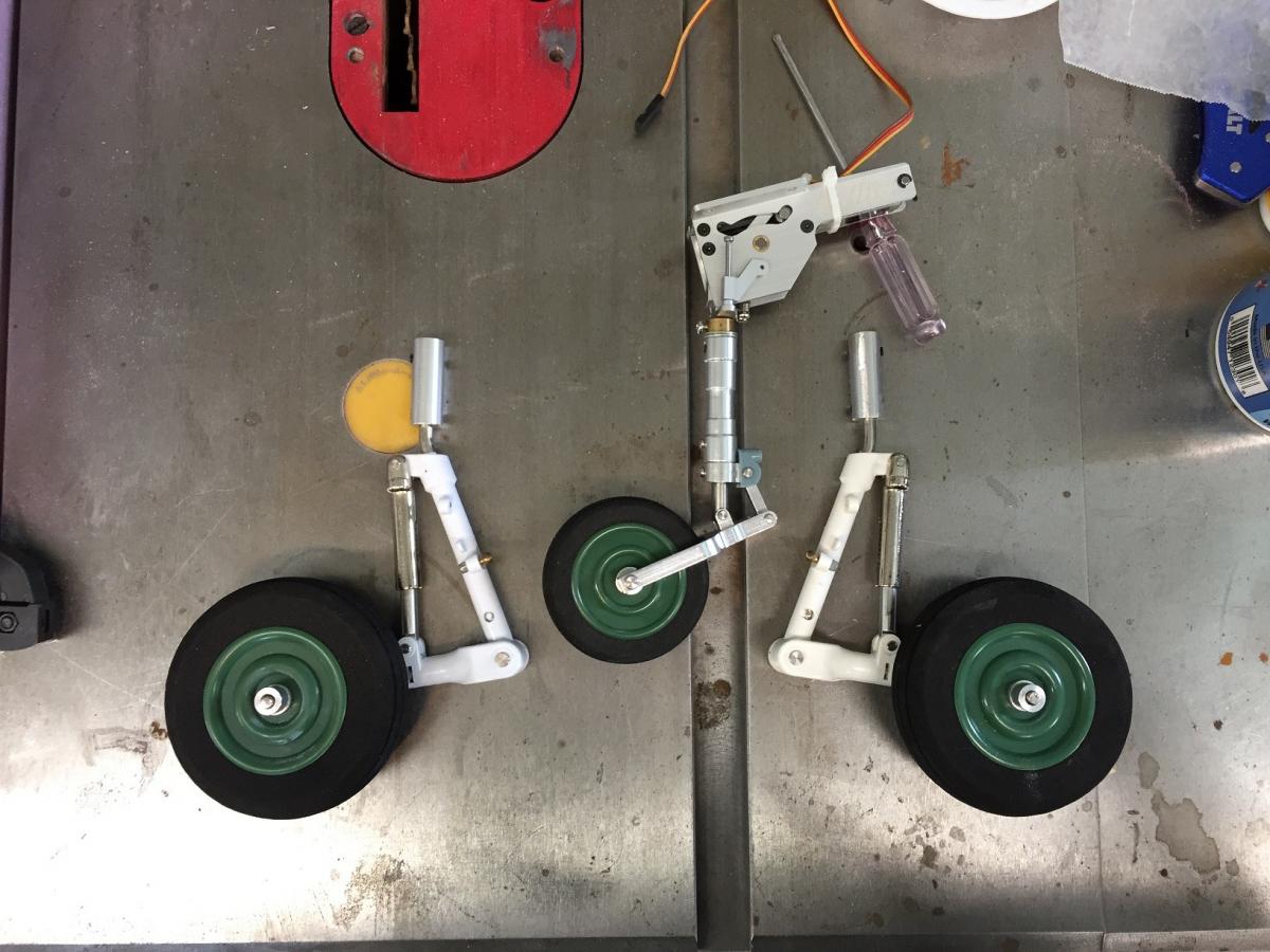

                                  Another 6 hour effort to get the 90mm YAK 130 gear to the proper lengths and mounted. Glad am done for the day cause the work shop is now 85 :hot_face:
                                  (add an hour also due to the trip to the hardware store for a busted 4mm x 0.7 tap but ended up getting a dozen 8-23 set screws and tapping those into the alum legs instead.)
                                  Used the main gear etracts that I salvaged from my wrecked FW A-10 2 years ago and the 110 Eflite nose etract as mentioned in post #9.
                                  Click on pics to view enlarged
                                  Click image for larger version  Name:	IMG_1436.JPG Views:	0 Size:	109.7 KB ID:	265593Click image for larger version  Name:	IMG_1438.JPG Views:	0 Size:	66.8 KB ID:	265594Click image for larger version  Name:	IMG_1437.JPG Views:	0 Size:	61.5 KB ID:	265595
