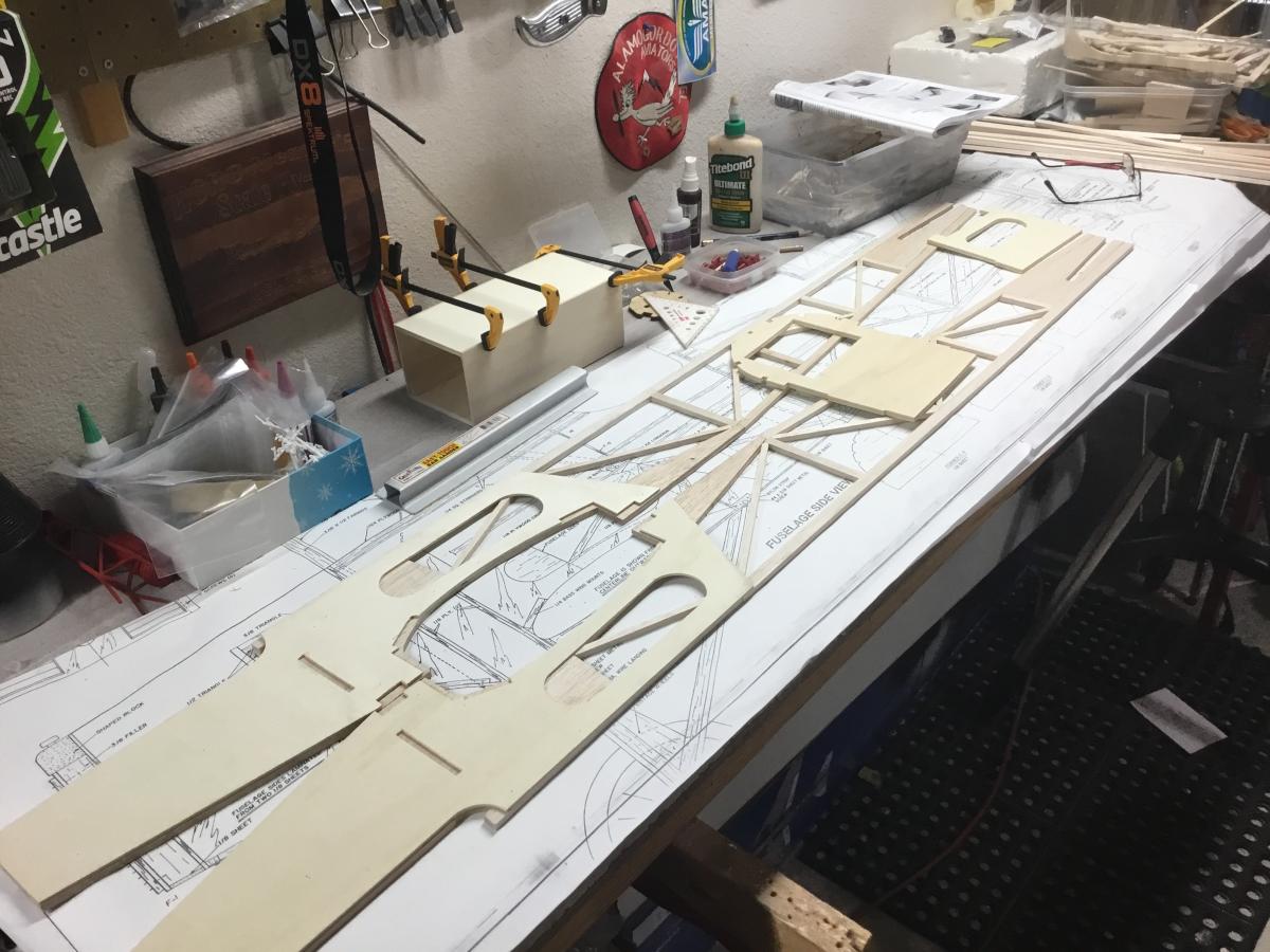

    I've had this kit for years and since I have the time I figured I'd get it done.

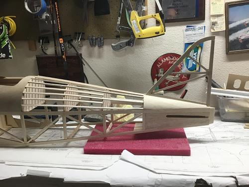

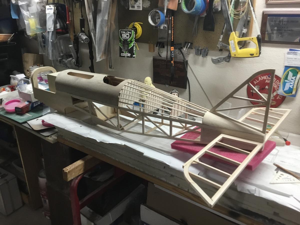

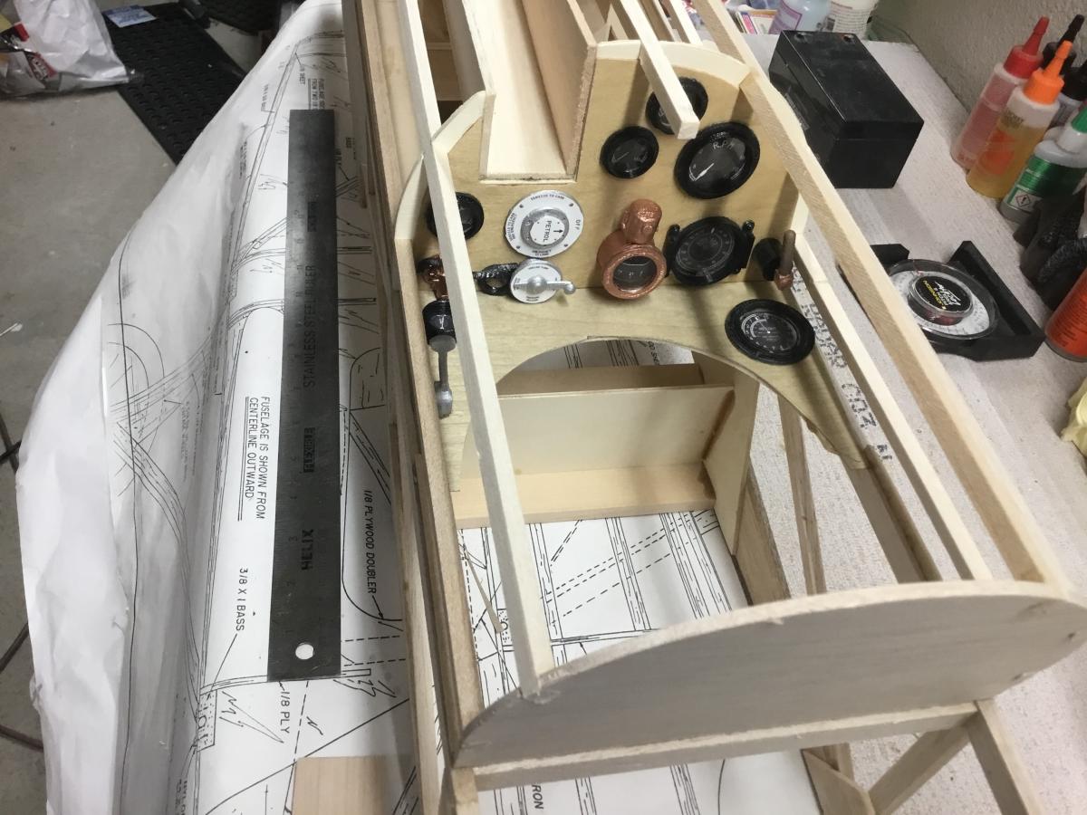

        Now that's finished I can sheet the fuse.
        Mike
        • #5

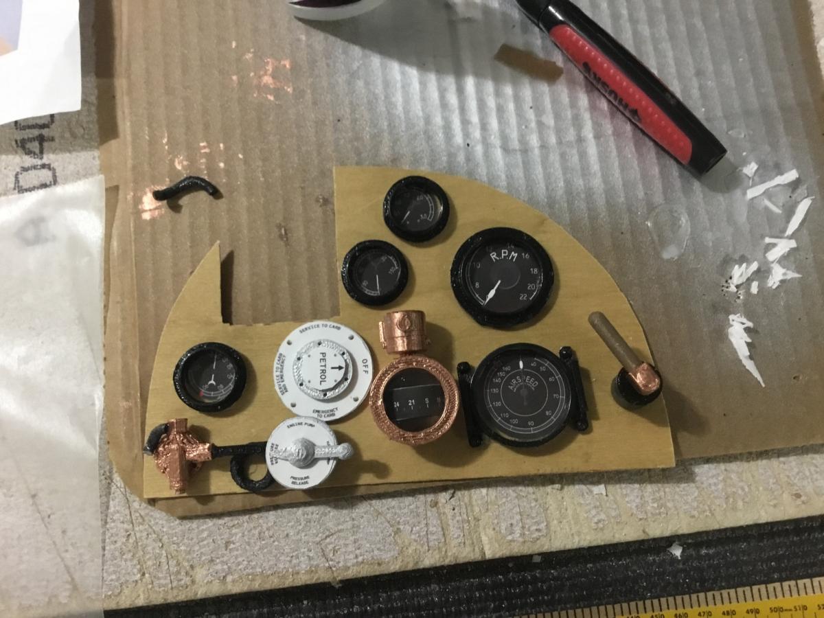

          Beautiful work, Mike! Nice cockpit details. Is the engine a four stroke?

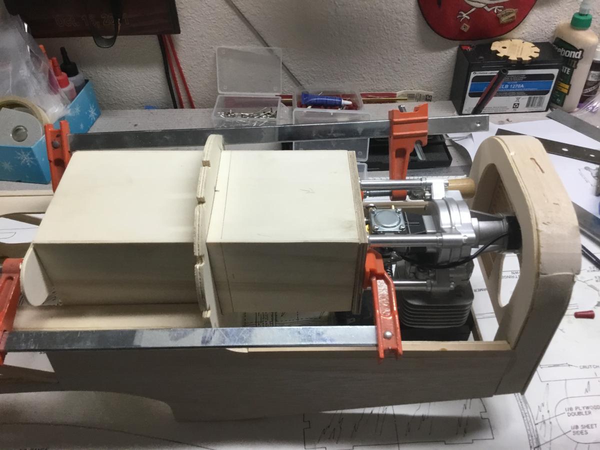

            Thanks
            I'm using a DLE 30 . Though about a 4 stroke but had the DLE laying around./

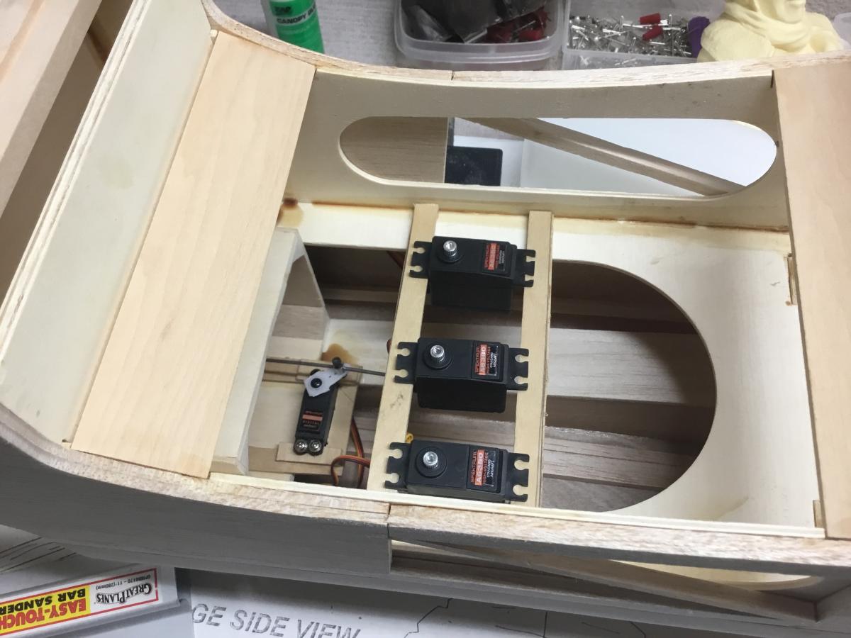

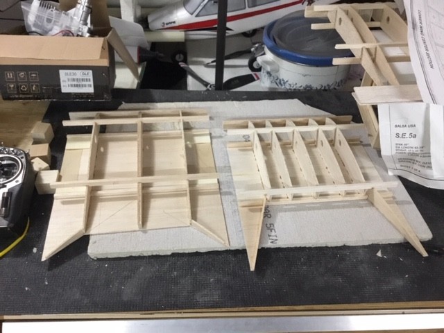

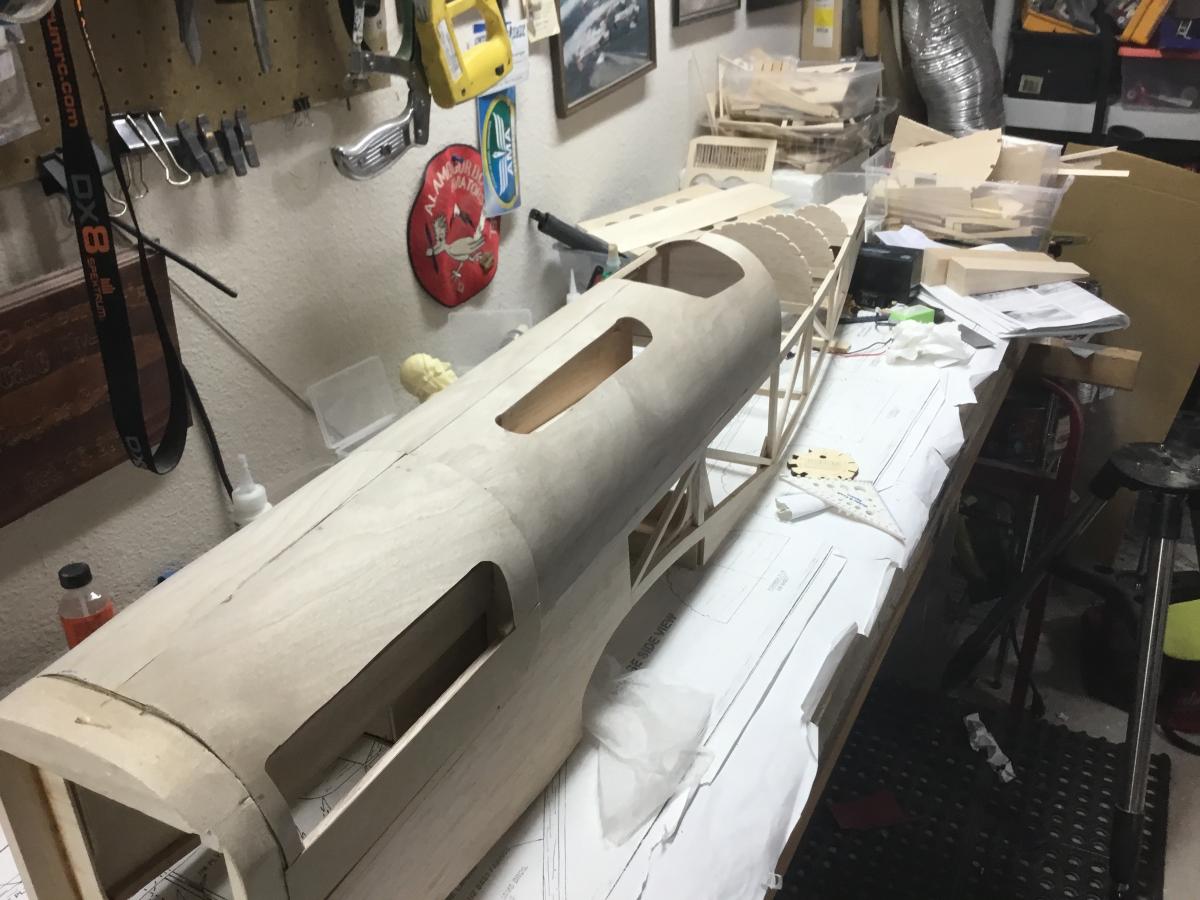

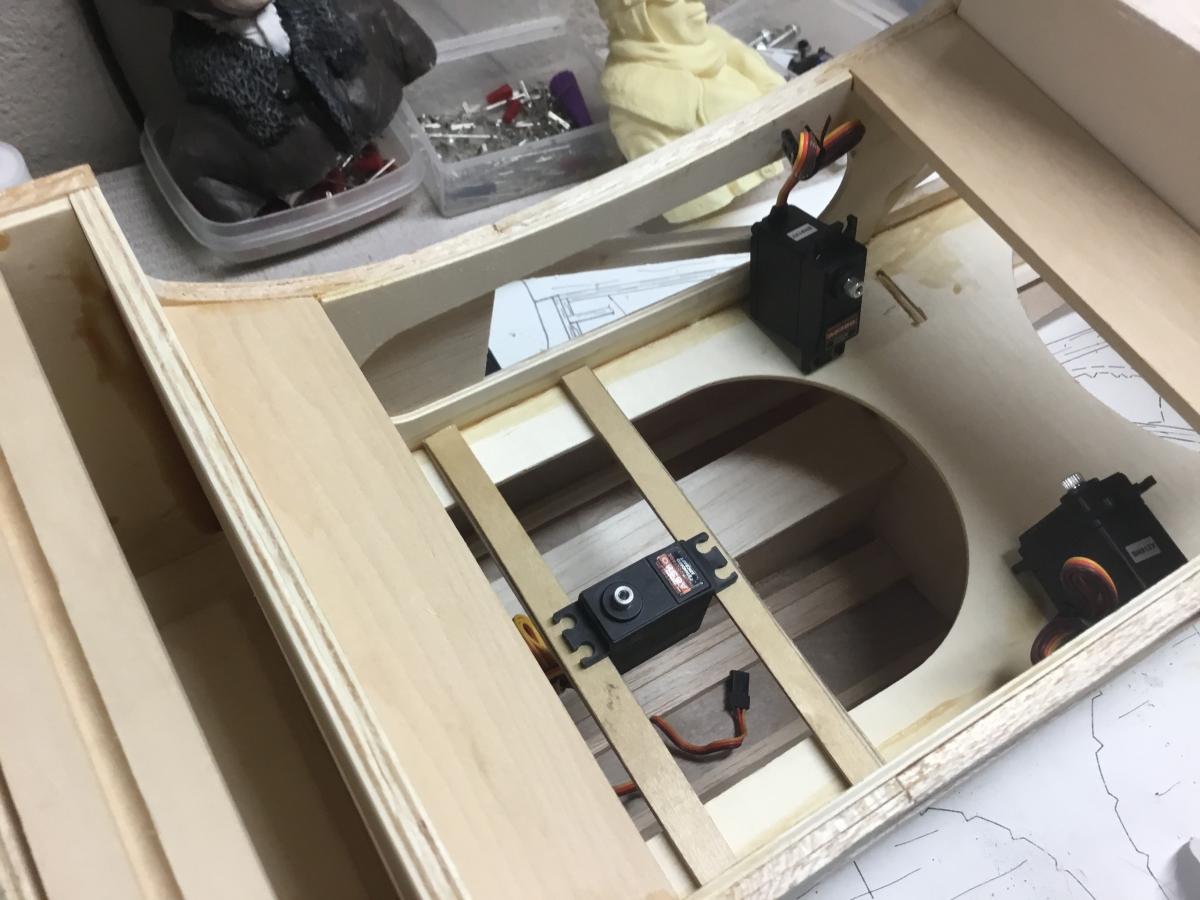

              Did a bit of sheeting. I'm trying to figure out servo placement before I go to far. I'd like to do pull /pull on the elevator and rudder. Think I need to mount the two elevator servos vertically. I need to make the servo tray removable to service the tank and throttle servo if need be.
              Mike

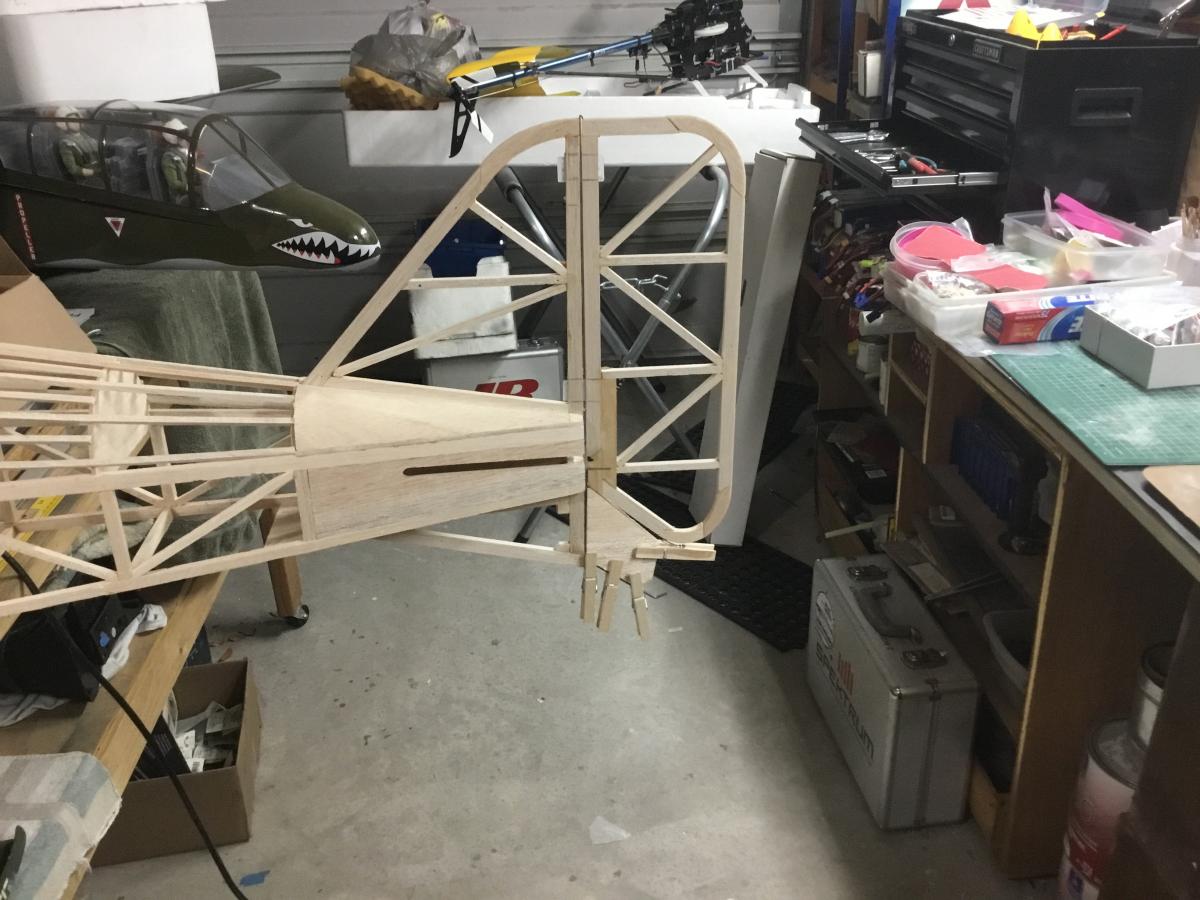

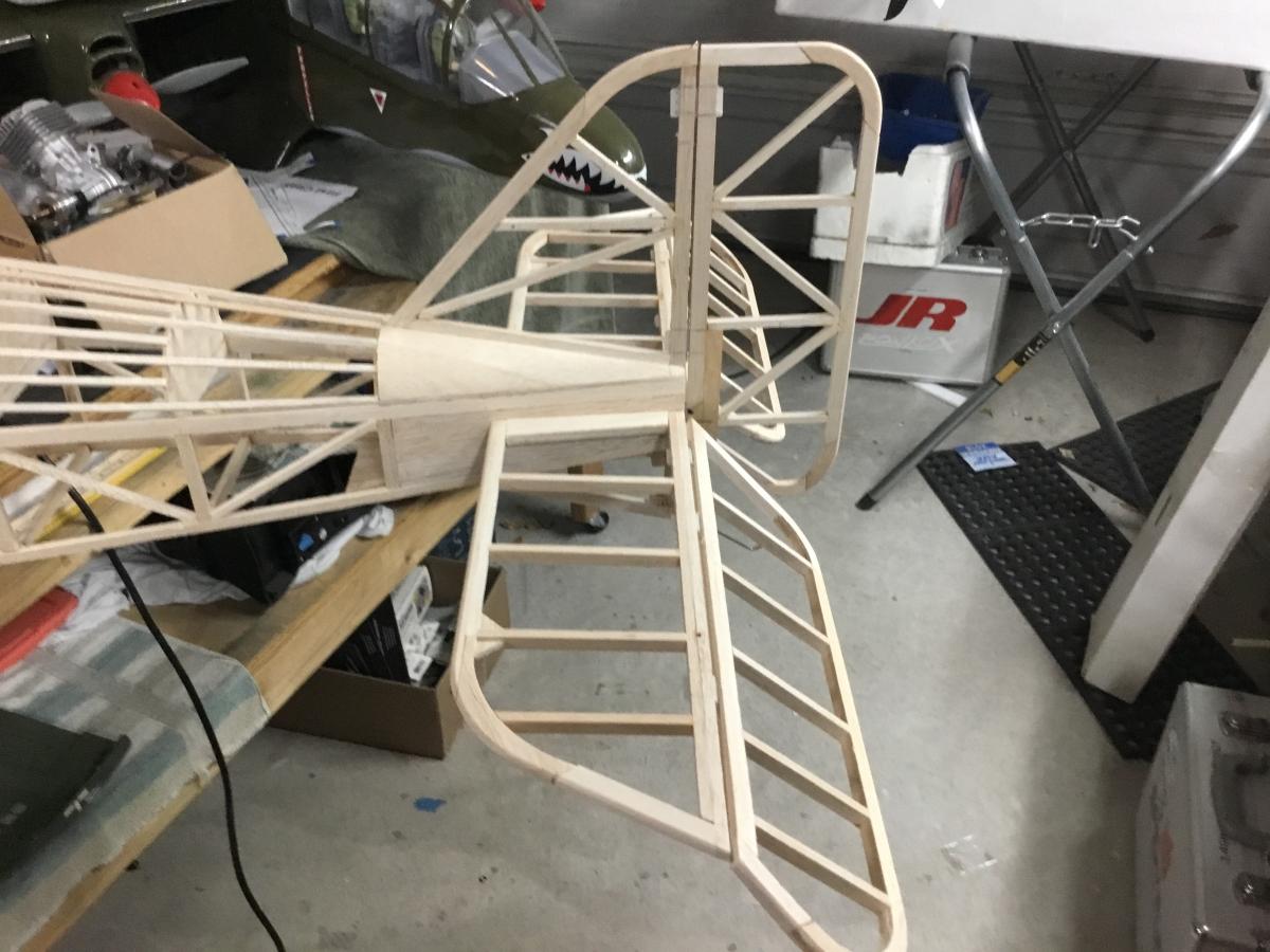

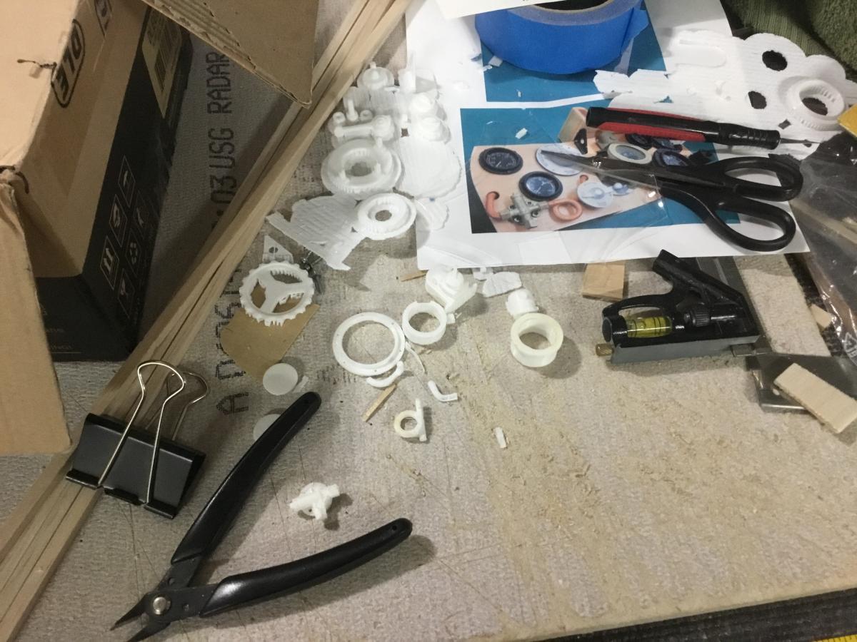

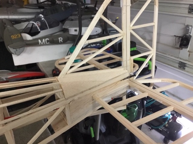

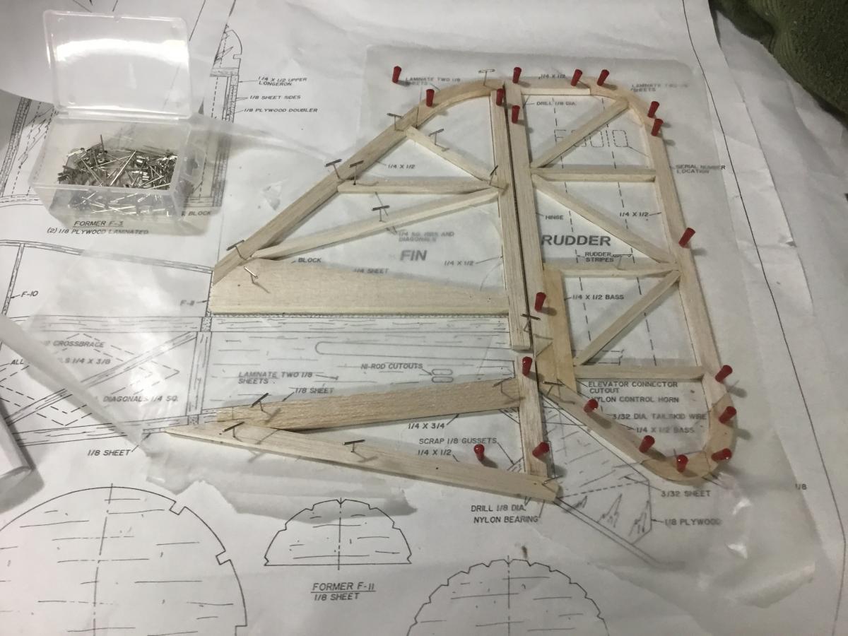

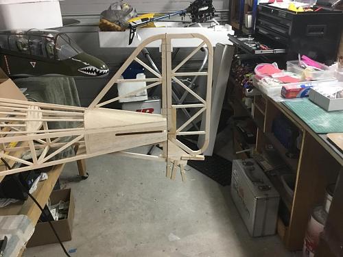

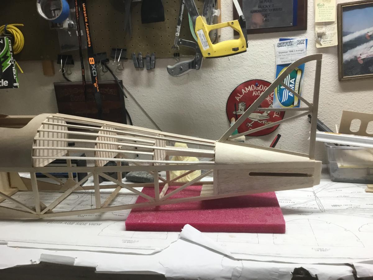

                Shaping those blocks on the tail was ridiculous . Thank God for power tools. Almost time to build two wings.
                Mike
                • #9
                  Nice progress, Mike.

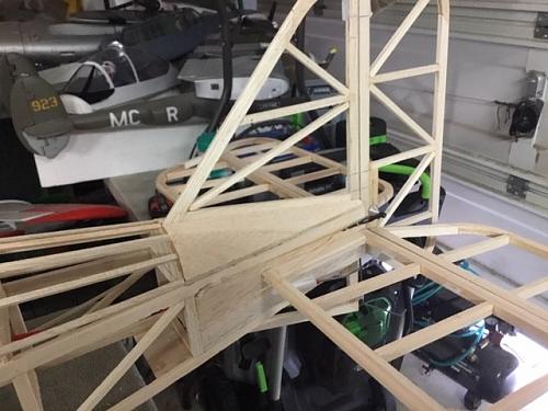

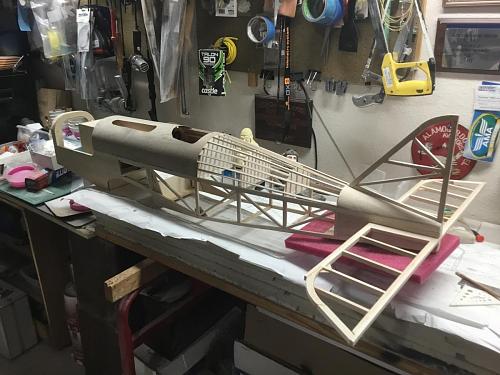

                    Thanks spent the morning hinging and working on the tail skid. It's close enough that can move on to the elevators.
                    Mike

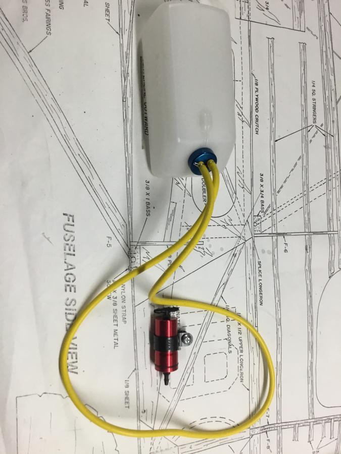

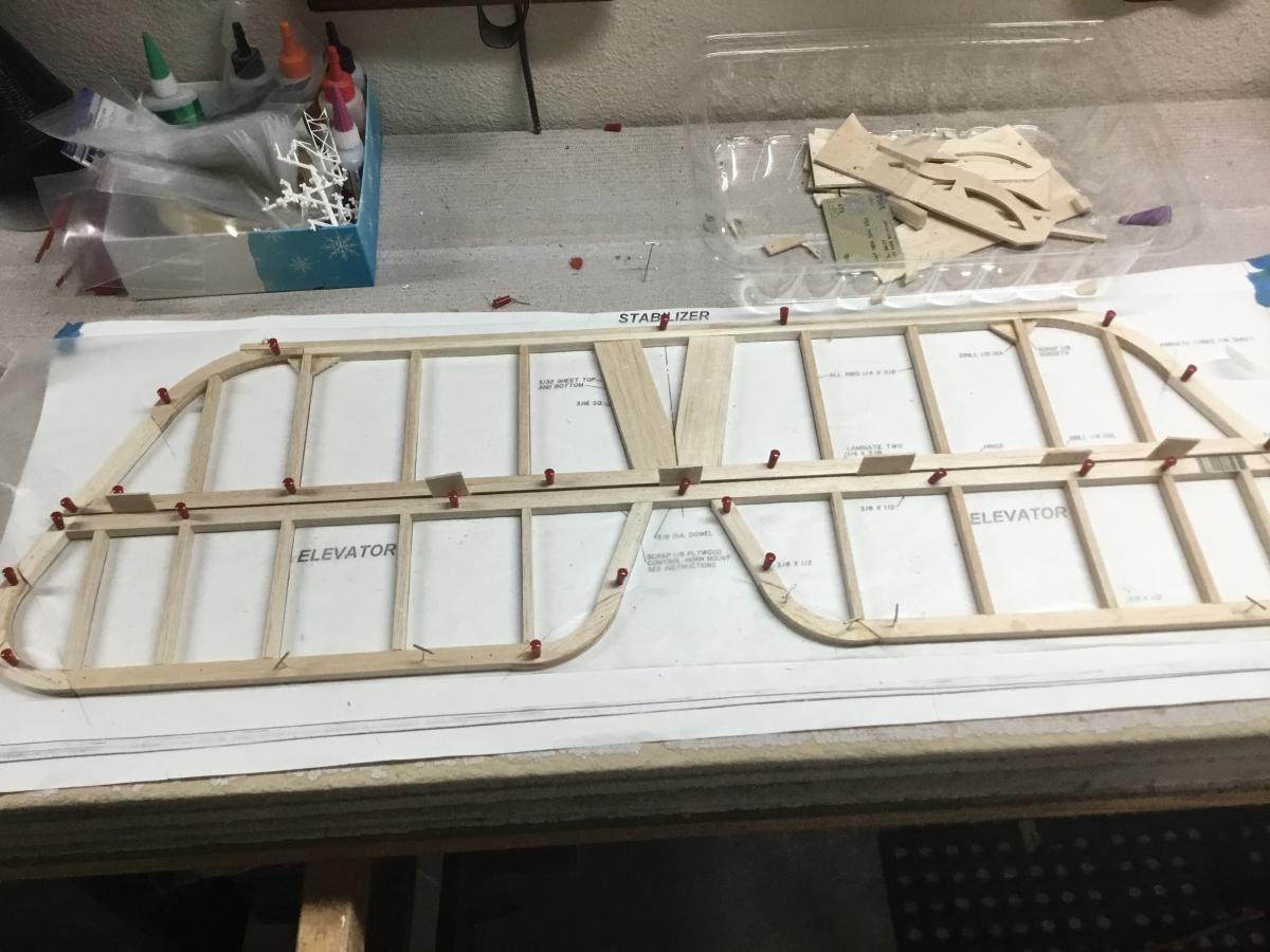

                      Got the elevator hinged and the fuel tank figured out. The red thing is quick fire fuel filter. Pretty cool holds a 1/2 once of fuel and makes priming easier. Also eliminates the need for a third line to fill. Now I've got to build 4 wing panels.

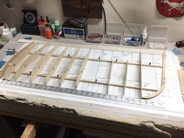

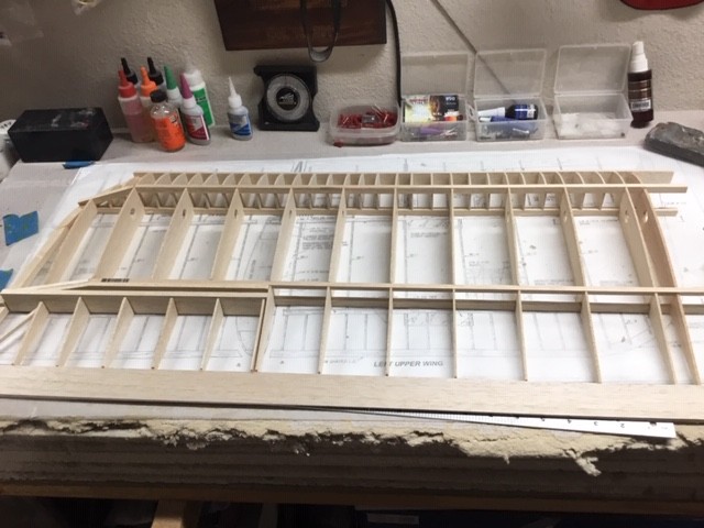

                      • #12
                        Two down and two to go.
                        Mike
                        • #13
                          Lookin' good Mike!
                          • #14

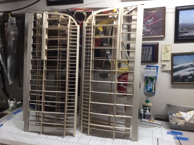

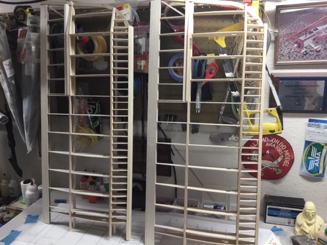

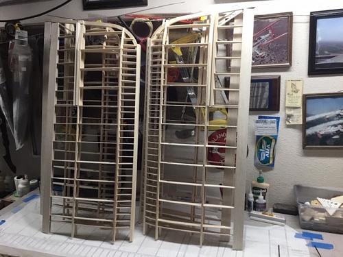

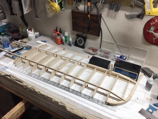

                            Last wing panel finished. It's back to my part time job at the hobby shop today. We're opening to walk in traffic with restrictions. Things will slowdown on the build. I have a bunch of sanding prep to do before covering.

                            • #15
                              Really nice work, Mike. Glad your hobby shop is opening back up. That's a good sign.

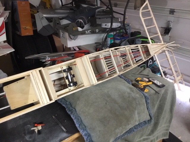

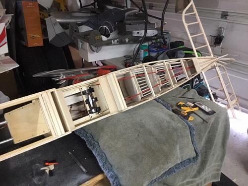

                                  So there I was being all smart and stuff about the radio install and how to get to the tank and throttle servo if need be. It was a epic fail. I had to make the servo tray removable and relocate things. I'm pretty much done with the fuse so final sanding and covering are next. I still need to build the center sections of the wings.
                                  Mike

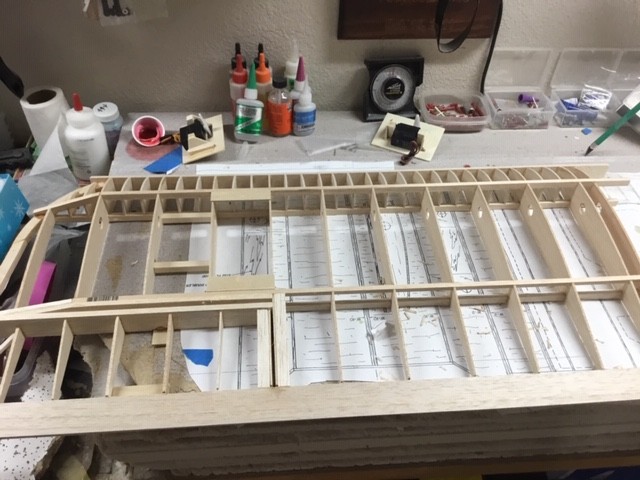

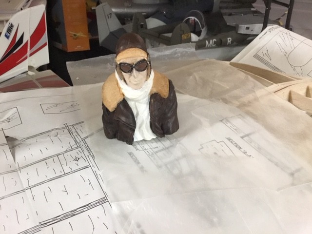

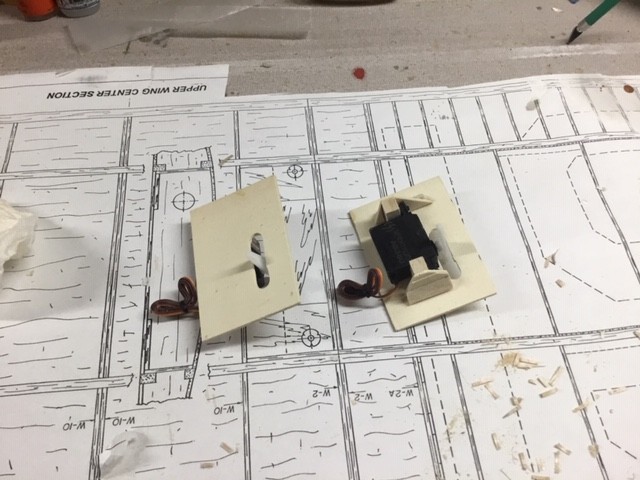

                                      Corona Build. Spent some time installing all the hard points in the wings and building the servo mounts for the ailerons. Finished the second center section and started what I hate most painting pilots. Needs a bunch of shading but it's a start. I have zero talent when it comes to painting pilots.
                                      Mike
                                      • #20
                                        Your pilot definitely has a ghostly pale about him but not everybody is an artist I know I'm not. Hang in there.
