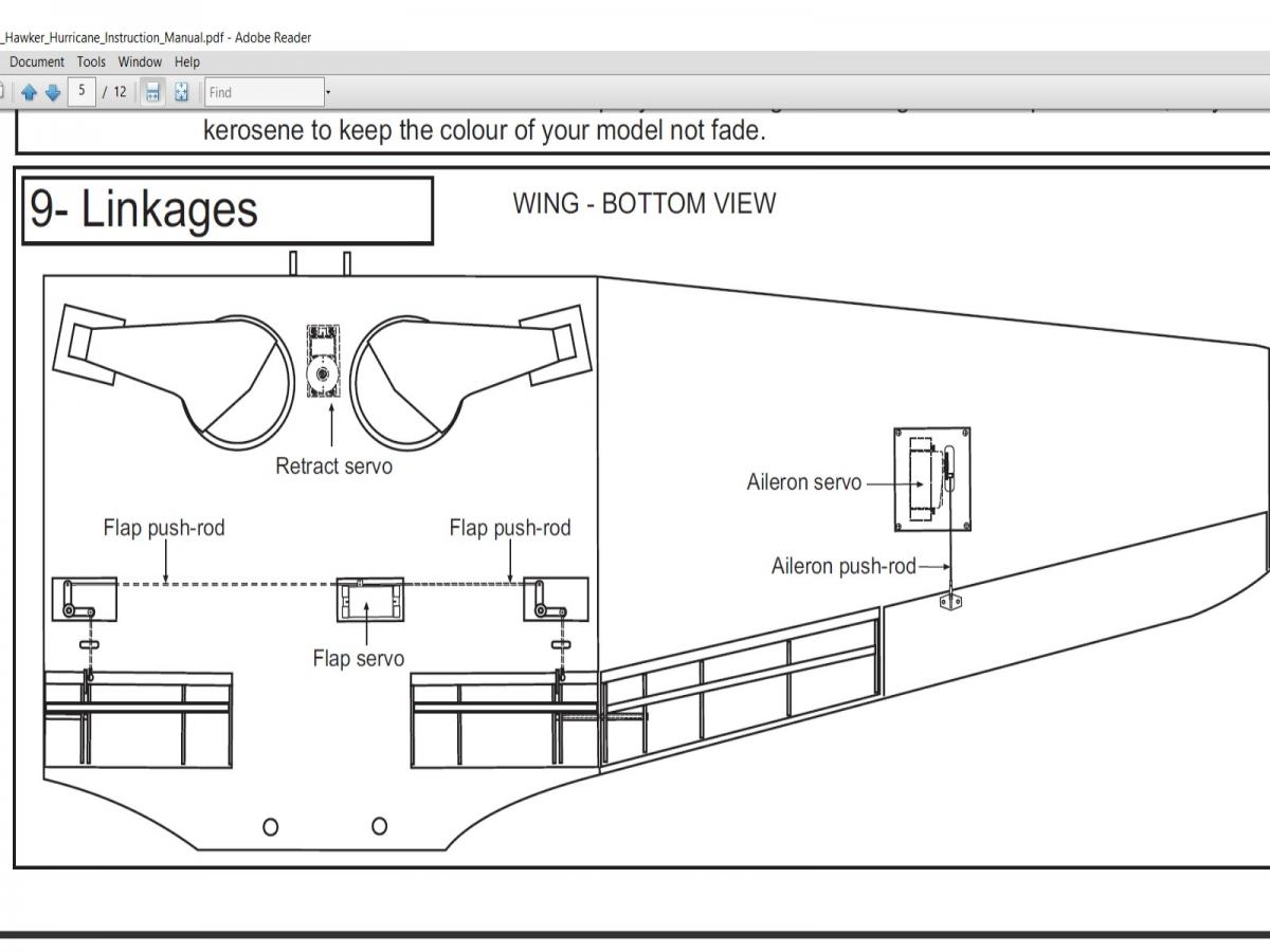

                        Hi
                        Just look at the manual before you buy its online.

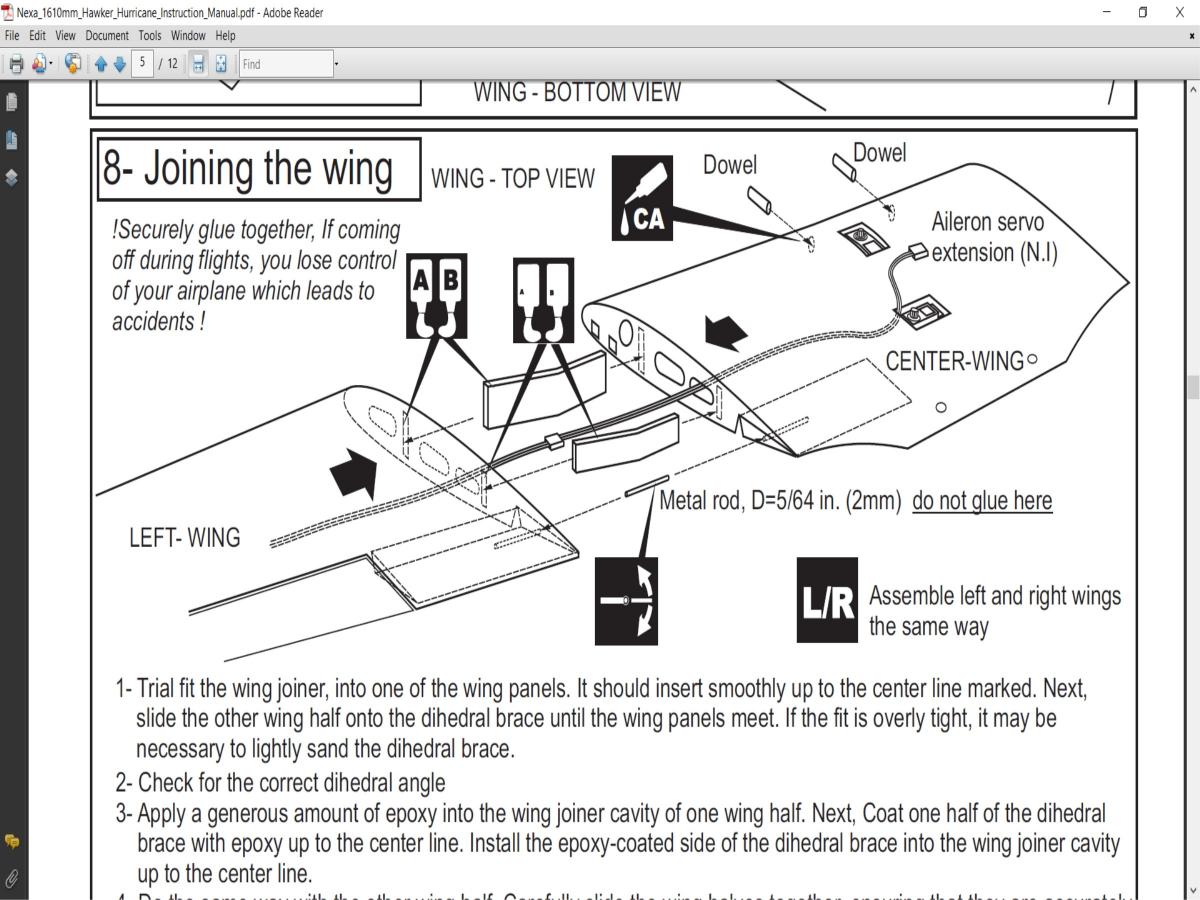

                                  Right now my biggest beef is the ad for the plane, which states 2 piece wing with an aluminum joiner. Where in reality the joiner is plywood and you need to glue the wings together to maintain the strength. I don't mind a one piece wing but my current airplane hauler is on the smaller side so a two piece wing would suite me better.

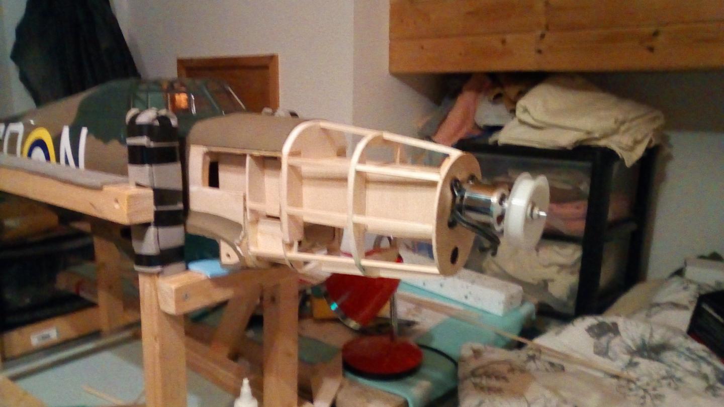

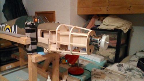

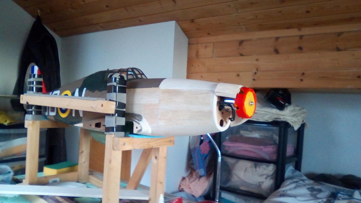

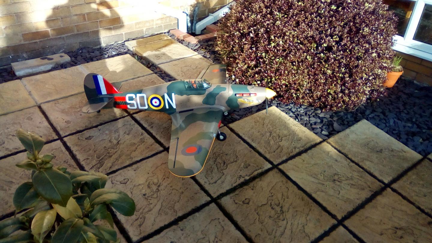

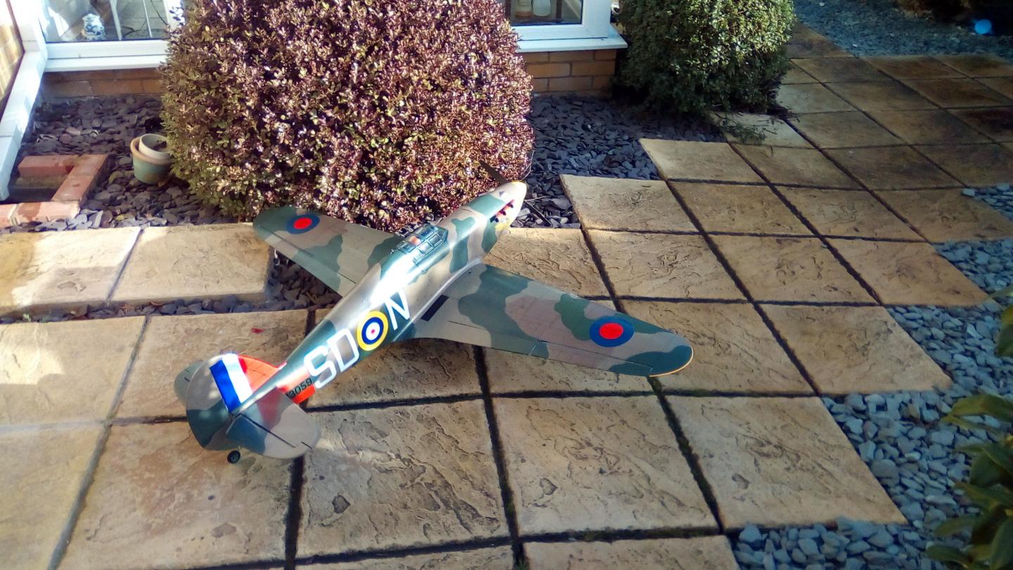

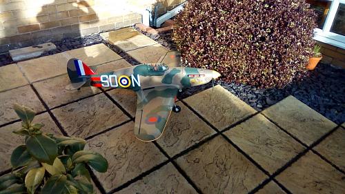

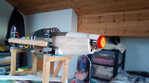

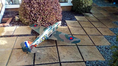

                                      ​I am not buying this plane because I already have an old Black Horse 60" balsa model which I inherited from a fellow club member after he crashed it and destroyed the front end. Most Hurricanes that look pretty scale in proportions need a chunk of nose weight but I overcame this during the rebuild by extending the nose about two inches and rebuilding it in balsa due to lack of replacement grp.. Not for the scale purist but in the air its close enough for me. Extending the firewall box and fixing the motor directly to the firewall helped move the cg forward, the battery forward and the esc under the motor. So unless you fancy some major surgery you are stuck with the extra weight which does nothing good for the wing loading. I attach a couple of pictures to show what I did and how it ended up in case anyone is mad enough to try it or use part of the info to assist getting the cg forward.. For me the airframe was free and it passes the time!!!.
                                      Black Horse Hurricane 1520mm 2900gms 37.8dm WA. WL 77gms/dm2 power req 785 to 940w SK3 4240 740kv rated at 870w 50amp max. Hobbywing Skywalker 80mp esc with separate ztw 6to10amp BEC 350mah 2s lipo. Turnigy 3000mah 5s 30c lipo(430gms) 30gms nose weight and 25gm spinner nut, 12x8jxf 20v 1/2t 16amp 330w, 2/3t 27a 550w, 3/4t 36a 690w, FF 51a 960w. Throttle curve 0,25,50,74, 82%max. rudder, aileron and flap servosTurnigy TSS-11MGA 11g 2.2-2.5kgf digital MG ball bearing servo. Elevator servo Macgregor MG1703 DS 17g 3 to 3.3kgf metal gear servo. Maiden flight time 4.5 mins 55% left on lipo. It flies at scale speed with this power system, not fast.
