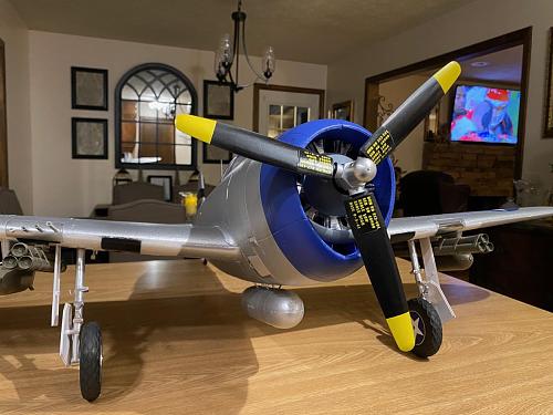

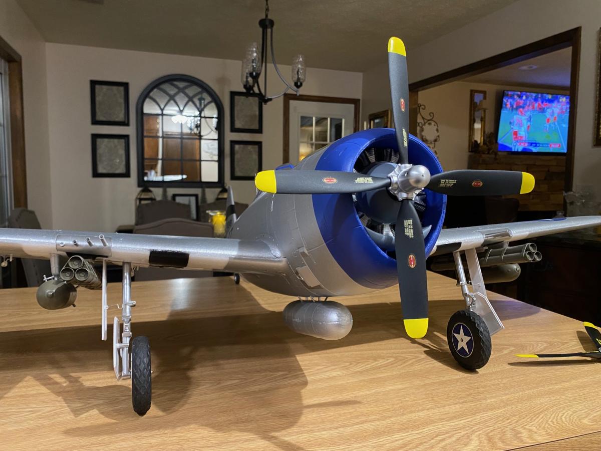

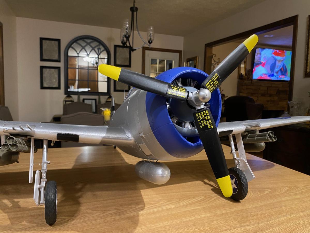

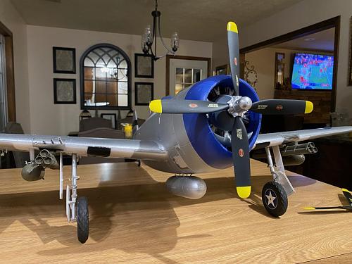

                      Hey Guys,
                      I found a Prop I'm excited about trying, it is a 12x6x3 prop off of a Banana Hobby Wildcat F4F 1.2m. Part# BHLX-F4F-W18009. I haven't flown with it yet but looks like a good match for the P-47.
                      My T-28 1.2m has a 12x7x3 prop with a 3540-850kv motor and 70A Avian ESC. The P-47 has a 3541-880kv motor and the same 70A Avian ESC. I ran the specs through eCalc and the results are almost identical.The only modification I had to do was cut 4mm off of the Propeller hub, it was a little to long.
