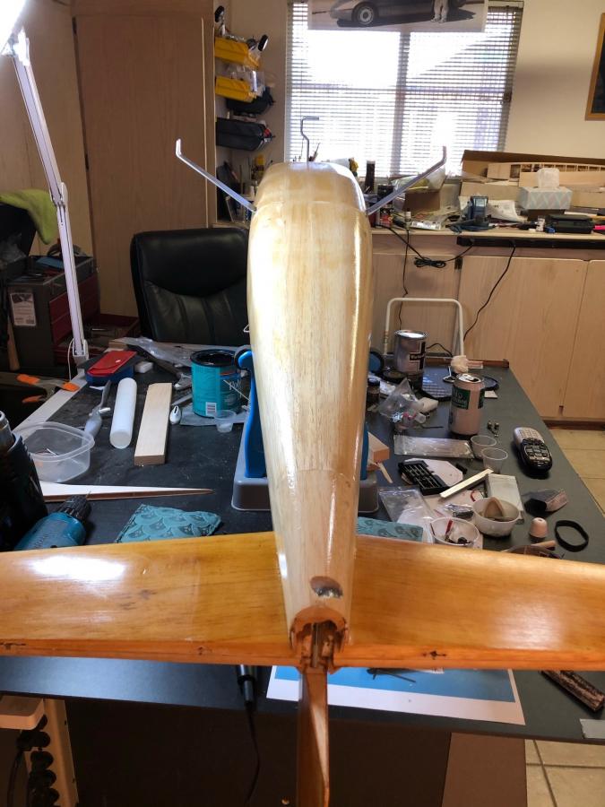

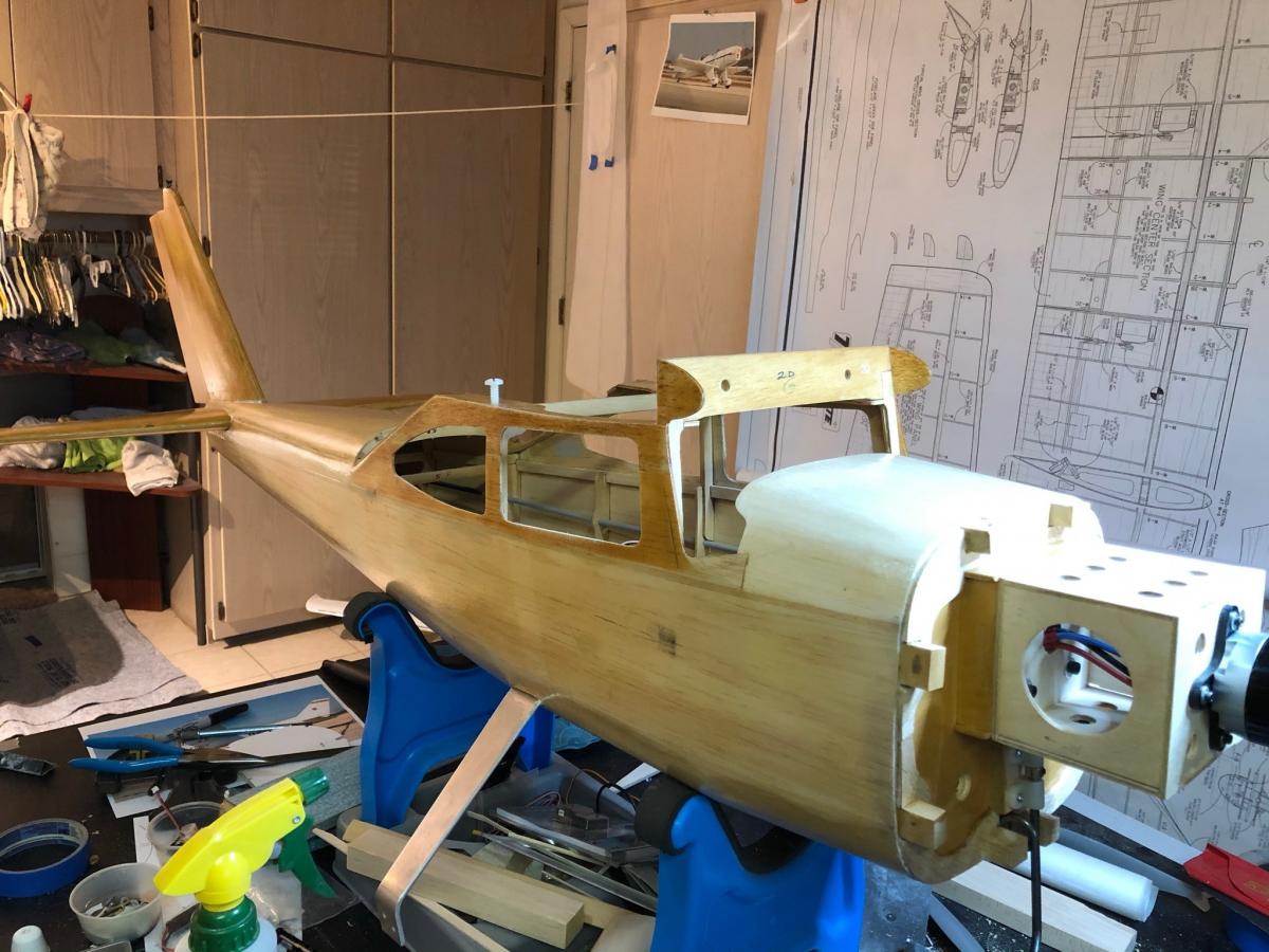

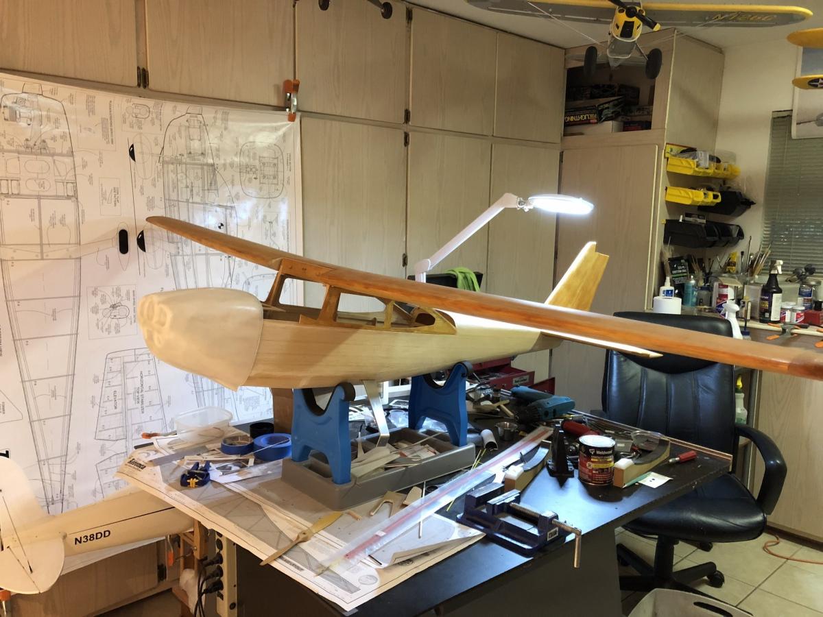

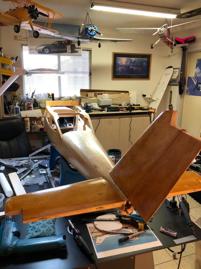

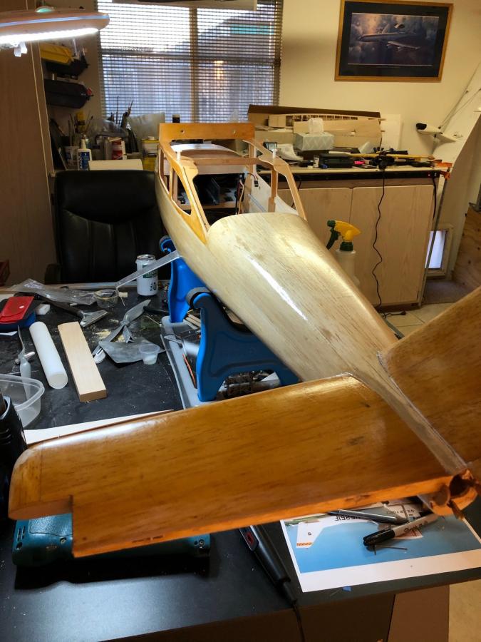

    Another kit rescue - Top Flite Cessna becomes T-41

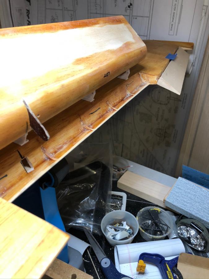

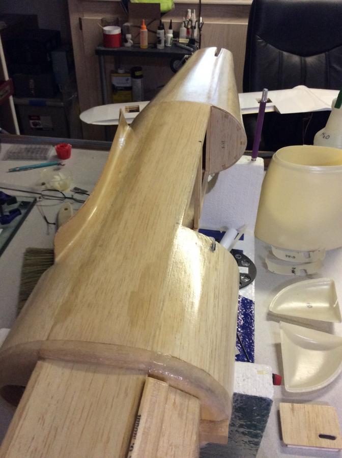

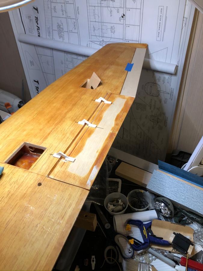

    She was collecting dust. In a garage in Phoenix, now the work begins. I got Futaba servos installed and tail surfaces operate nicely. Admiral RX with gyro going in, EFlite Power 60 with Hobbywing 120. I will do the same water based Warbird colors and Polycryllic that I used with the Ryan. I do like these big birds.
    After the maiden and test flights, it will probably be a fundraiser raffle prize.

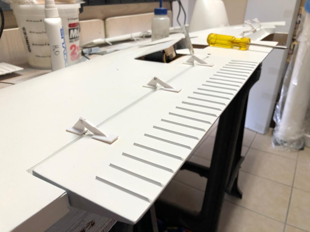

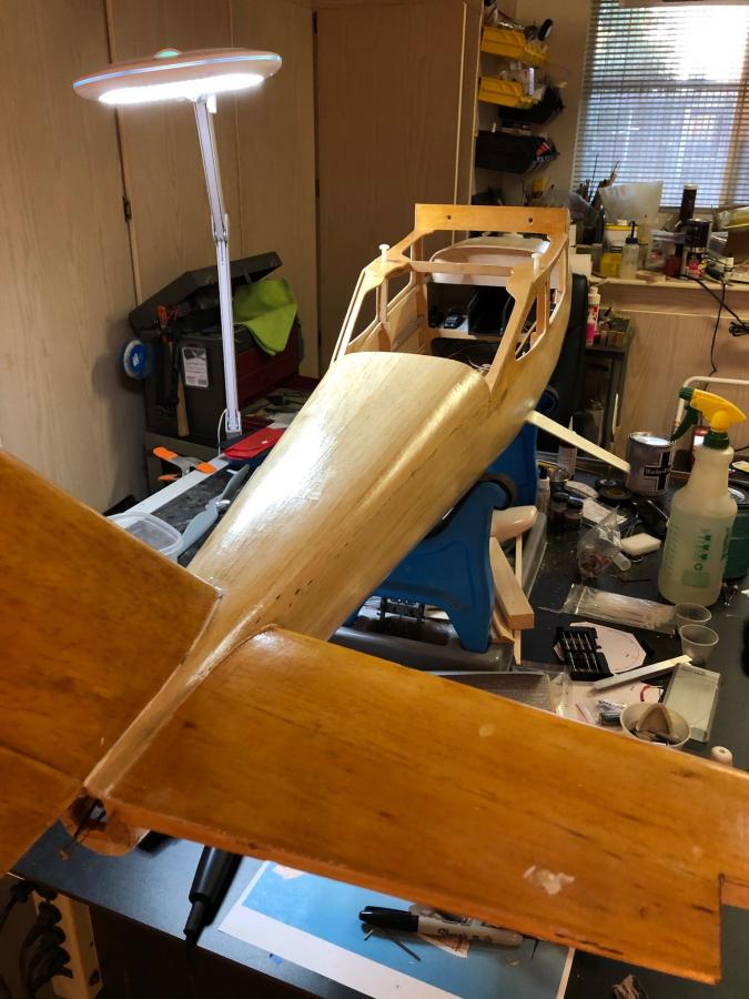

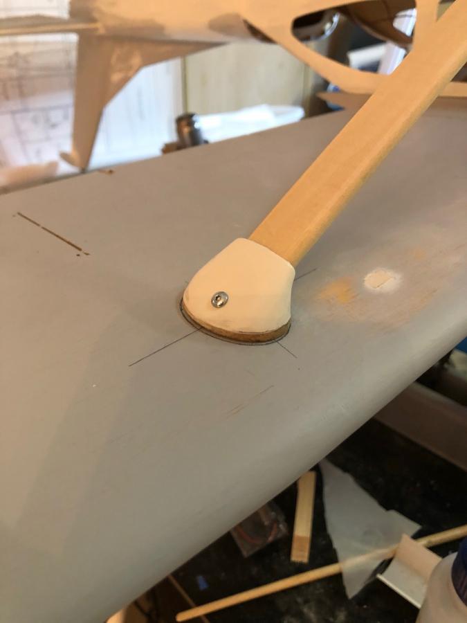

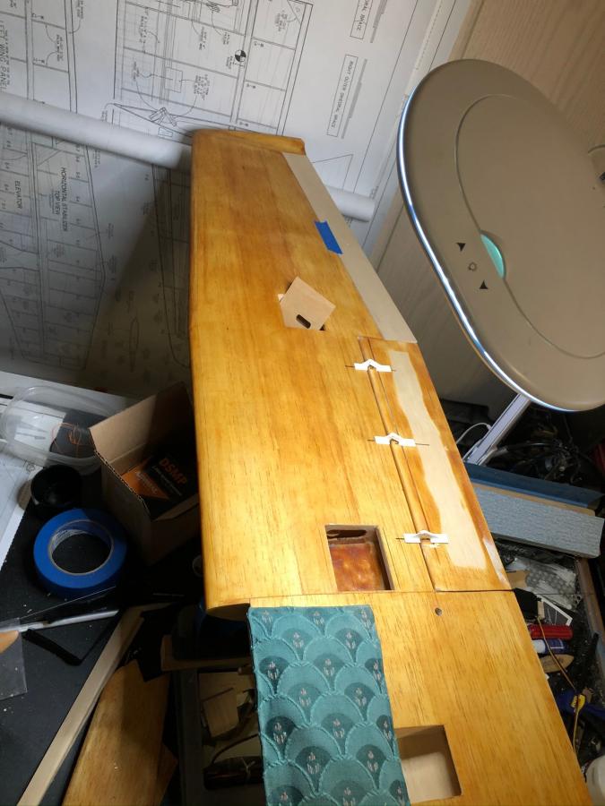

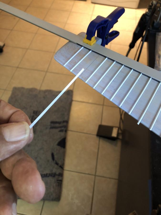

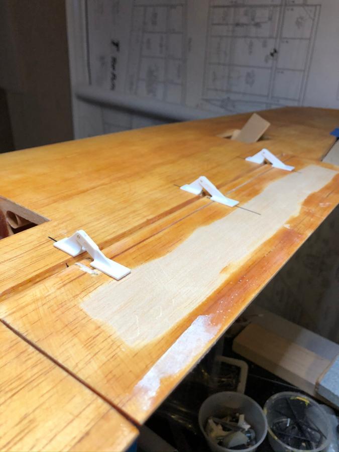

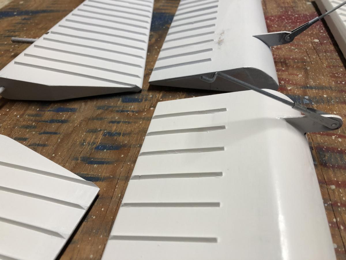

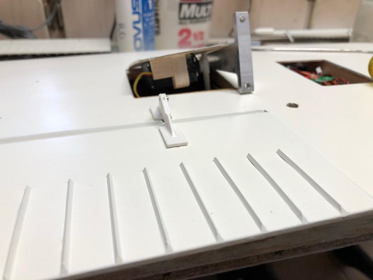

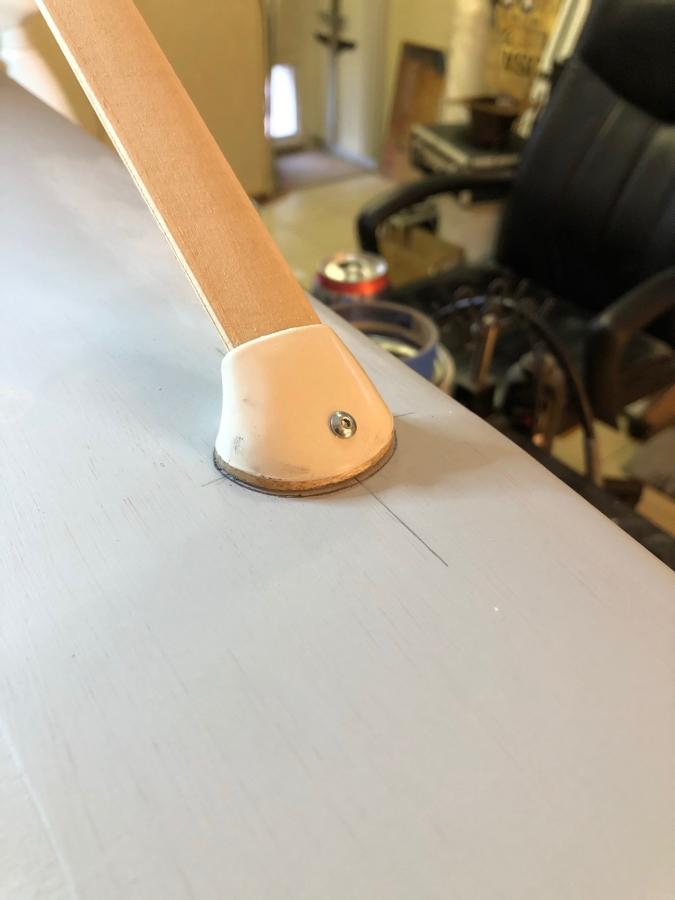

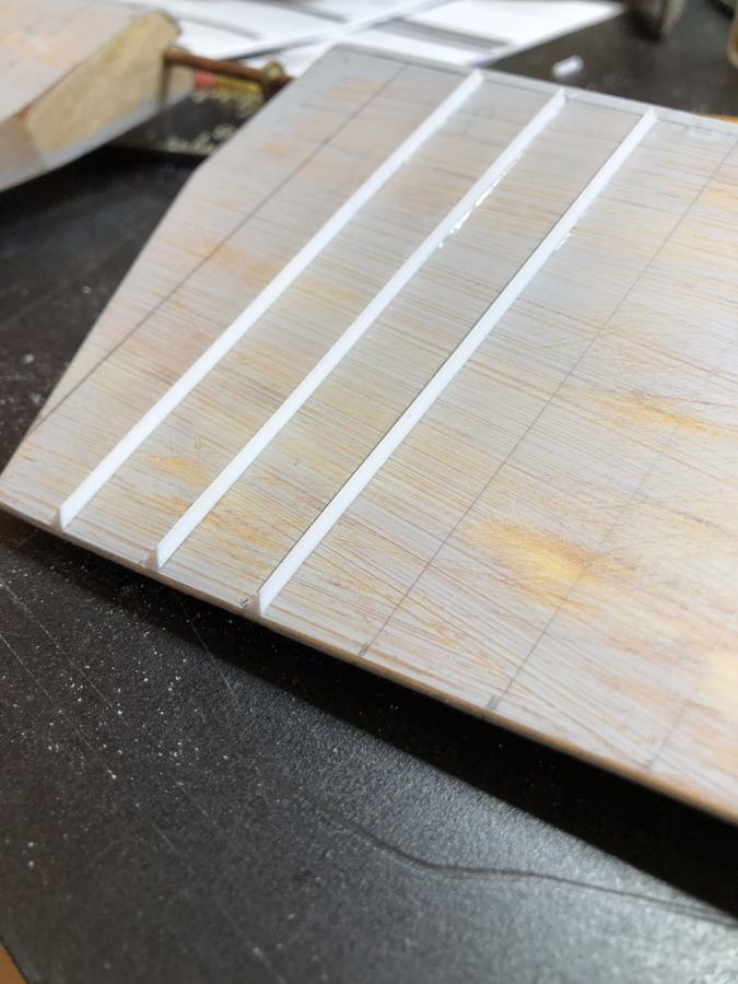

    Progress with Flaps and ailerons. All nice fit and function.

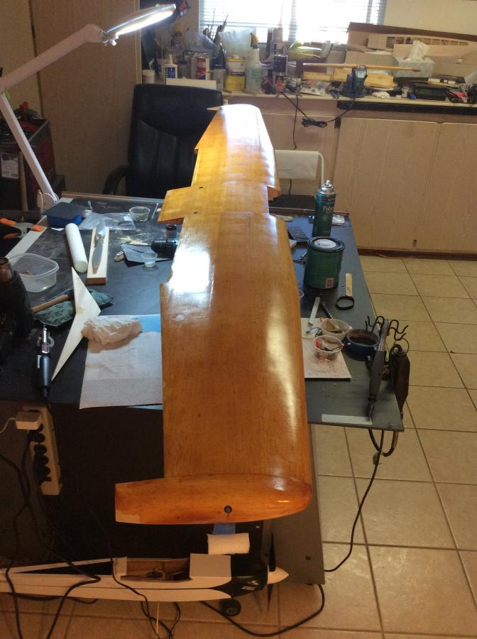

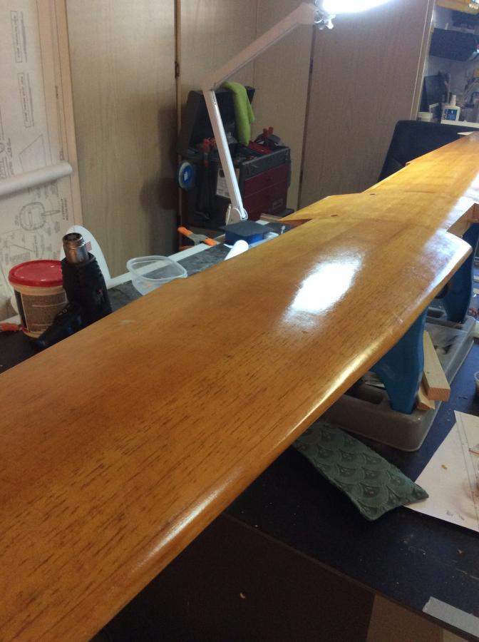

        F22trainer I must have missed the details of your method; are you applying polycrylic directly onto the balsa, instead of glassing with it?
        • F22trainer
          Piper PhD
          • Mar 2018
          • 1484
          • Sun City, Az

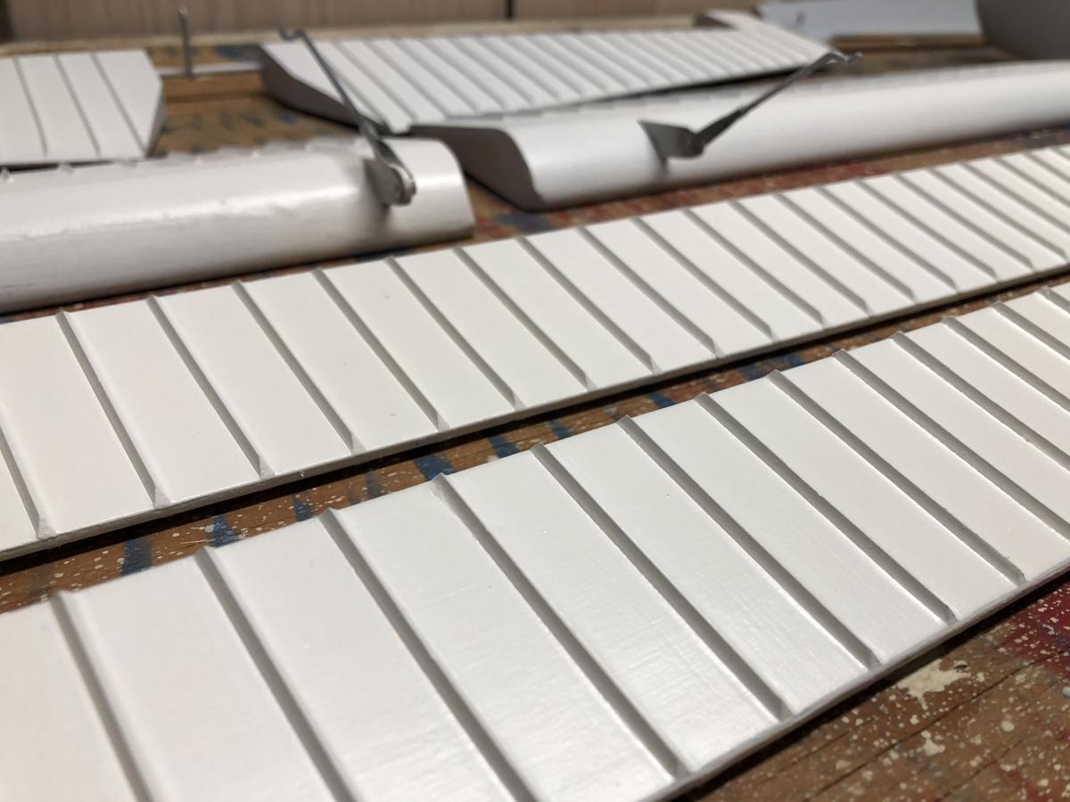

          I found by using 2 light Coates over the balsa and letting it dry to touch, I can then lay the glass down and apply another coat to adhere the glass into the soft Polycryllic - gives it a nice bite into the surface with no bubbles or runs. That I let dry overnight, then 2 more Coates with a foam brush about an hour apart. The next day I can sand with #200 wet/dry, one more coat and sand with #600, then another and final sand with #1200.
          After that, primer (Warbird colors gray) 3 Coates with #1200 sand between coats, then pigment color (also from Warbird Colors) with same sand. Last coat is sprayed and sanded with #1200 2 times. Then it gets flown - assuming that goes well, decals and stripes etc., then 2 Coates of spray Polycryllic - no sanding necessary.
          For this plane, the previous builder already glassed the wing and tail feathers, with a very light epoxy and glass so I will only need to glass the fuselage, I can sand and apply the polycryllic over the epoxy. It lays down really smooth with light coat.

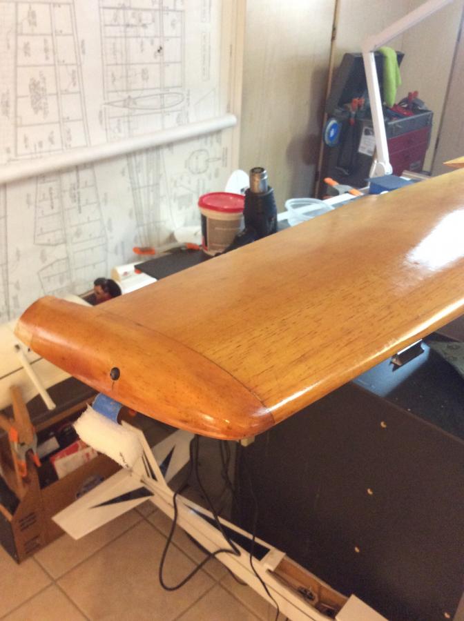

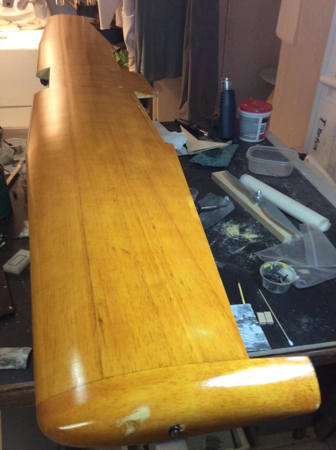

            Here’s the Ryan before primer: Click image for larger version

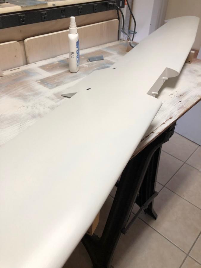

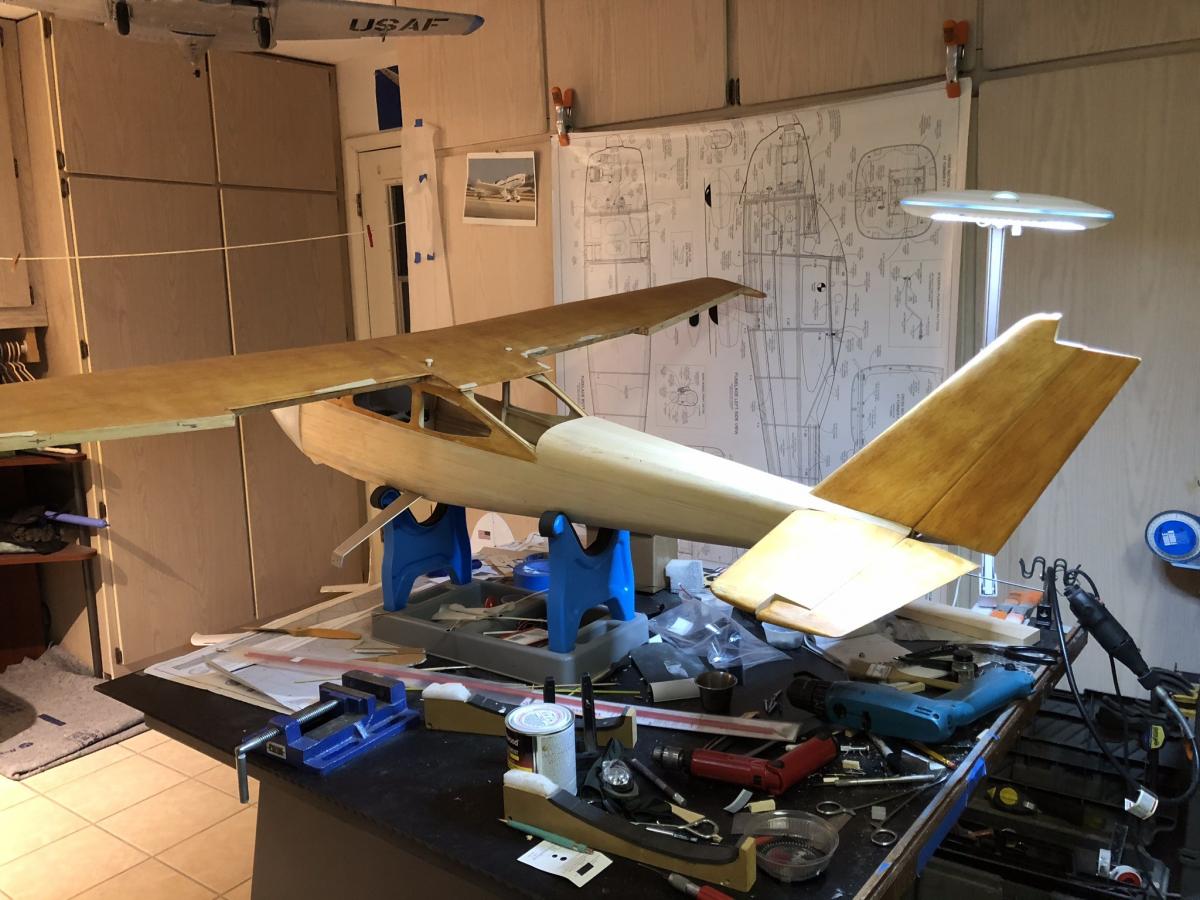

                Got a bit of time to check in and labor on the Mescalero.

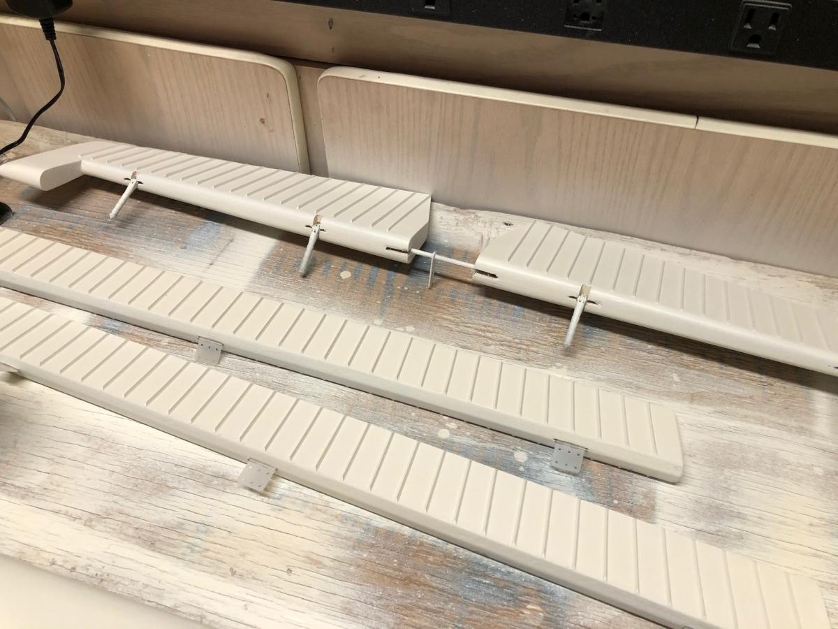

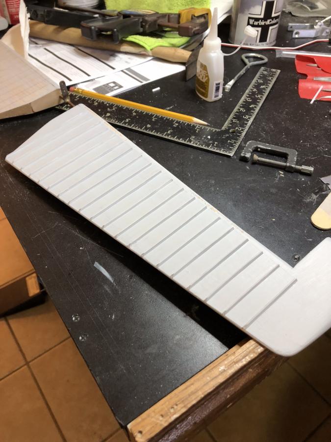

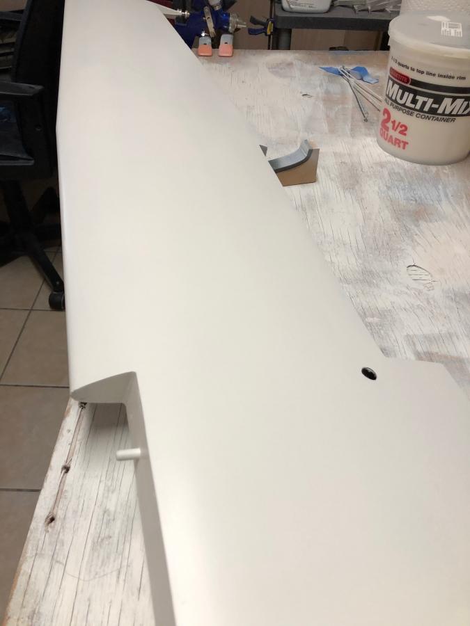

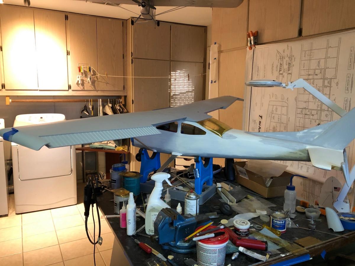

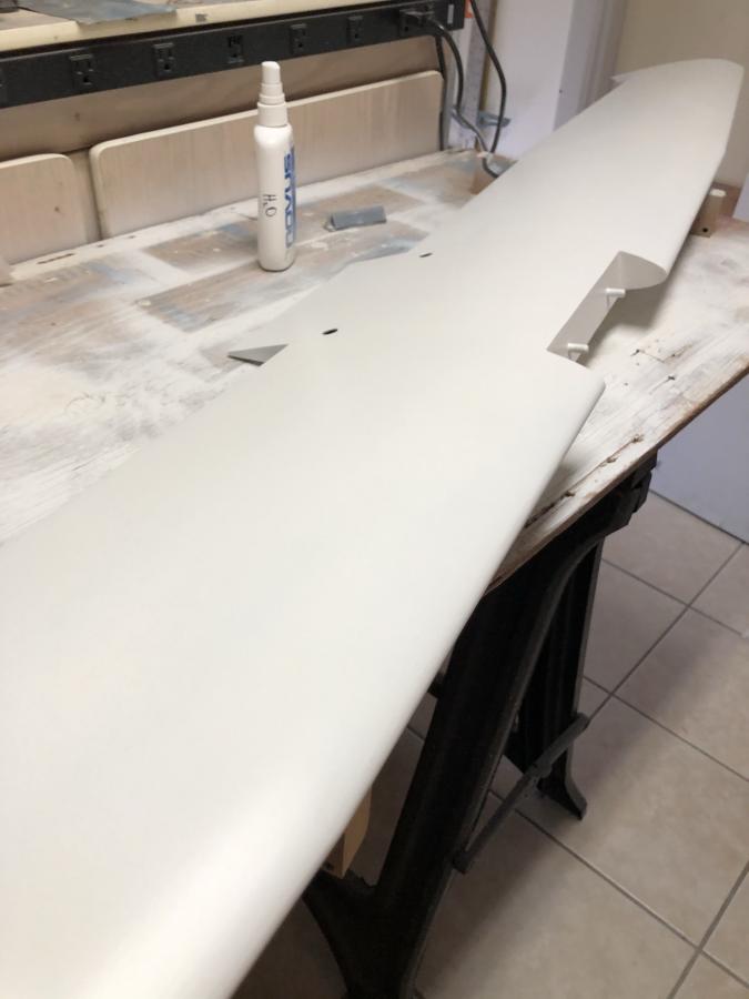

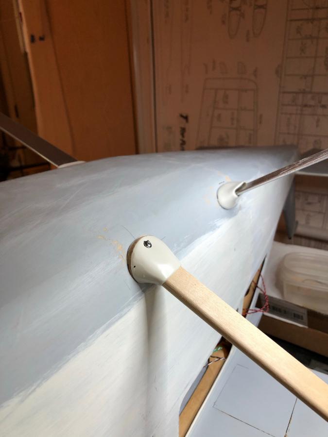

                      Almost ready for primer

                        Primer begins tomorrow.

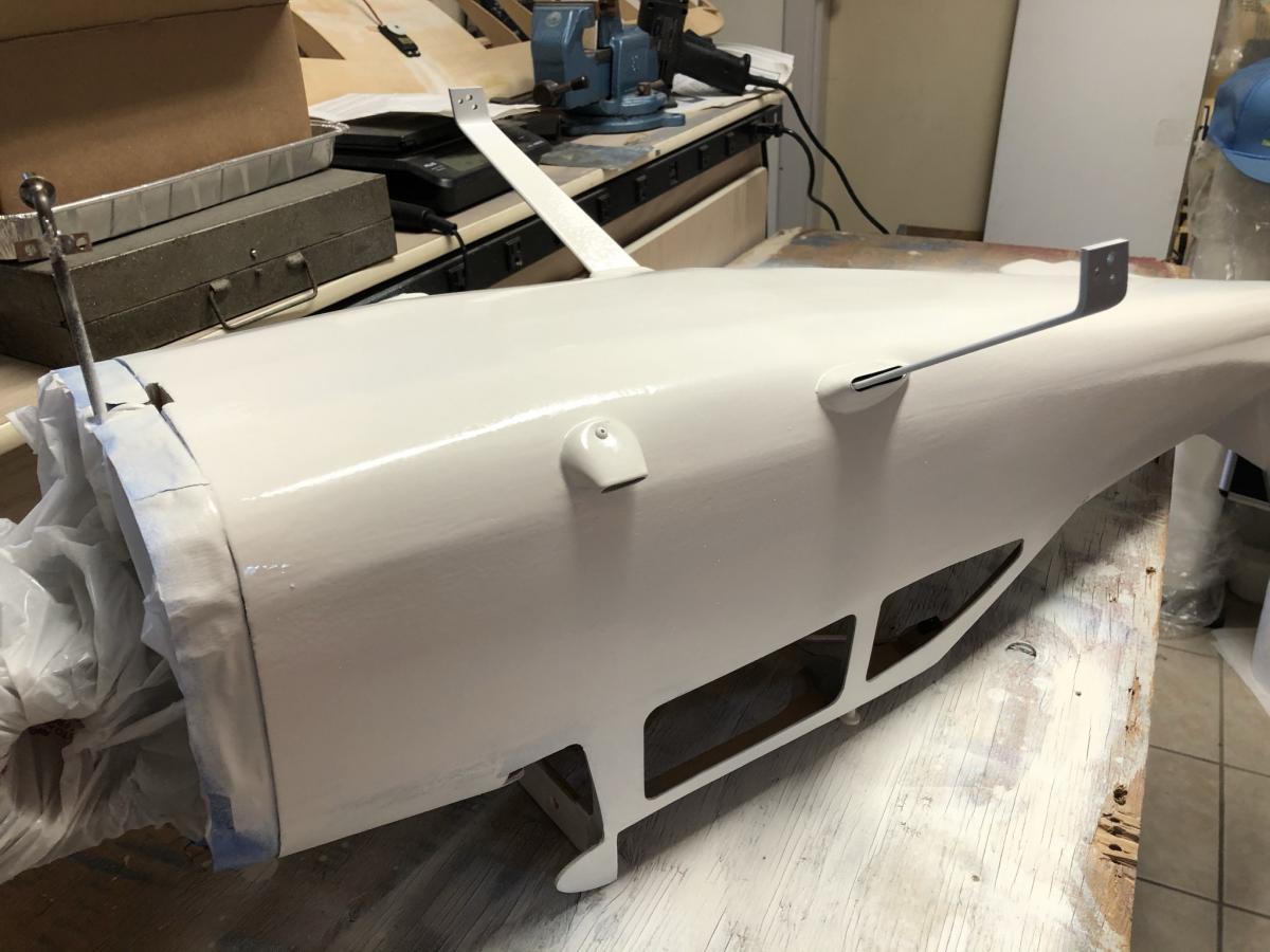

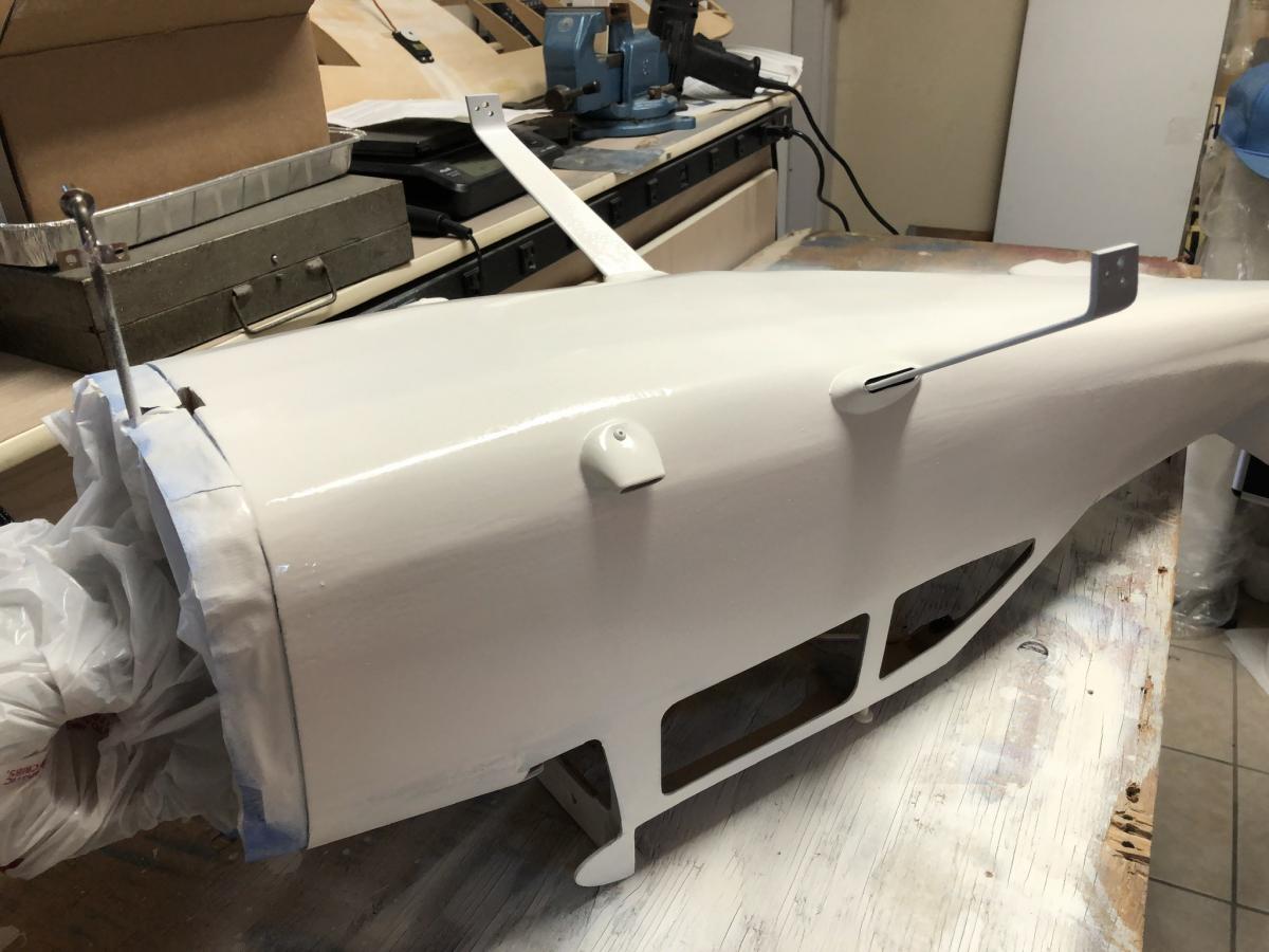

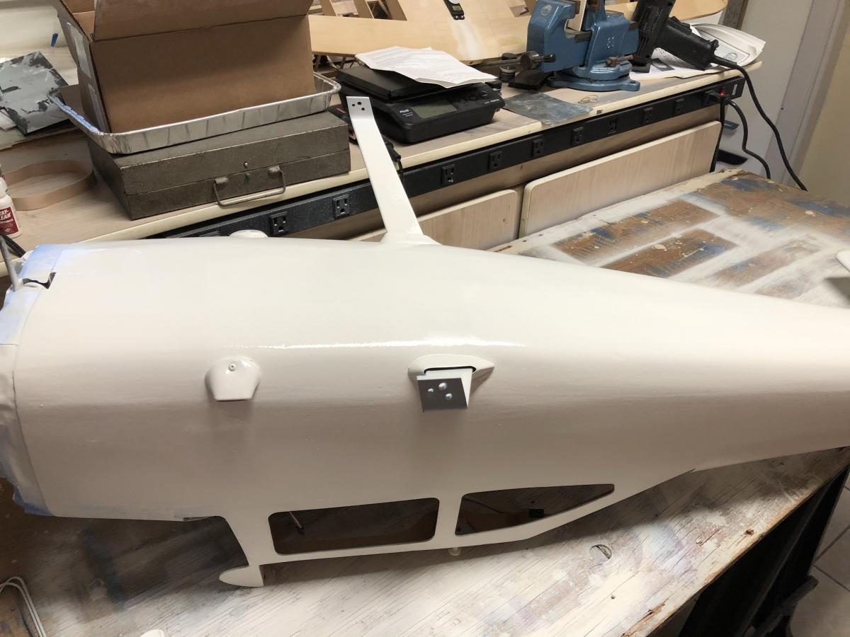

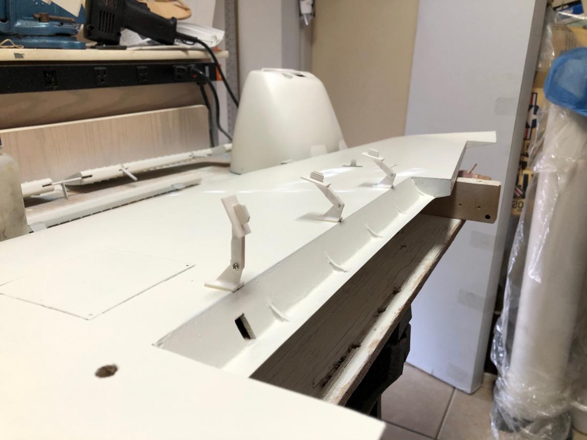

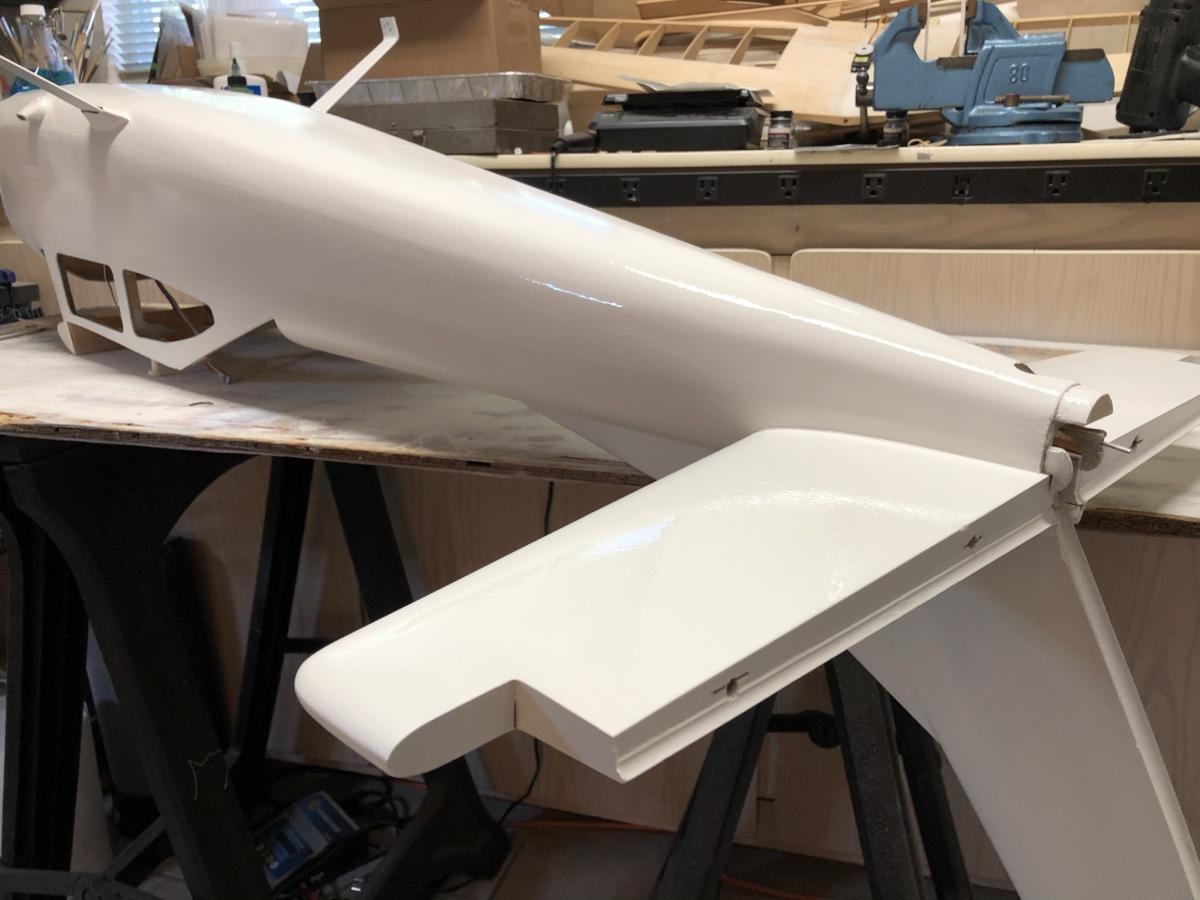

                          I’m still here - but work is busy. Here’s an update and the raffle is shaping up - legal department working out details and graphics from Callie are on the way.

                            Interesting glassing process, it really came out nice- what weight glass cloth do you use?
                            • F22trainer
                              Piper PhD
                              • Mar 2018
                              • 1484
                              • Sun City, Az
                              Originally posted by Desolation Angels
                              Beautiful work F22!- she is lovely!
                              0.5 oz. is best but can be hard to find. .75 or similar nylon from Sig - Koverall. Both work well, but the glass is much more flexible and forgiving in tight areas or compound curves.Thanks!

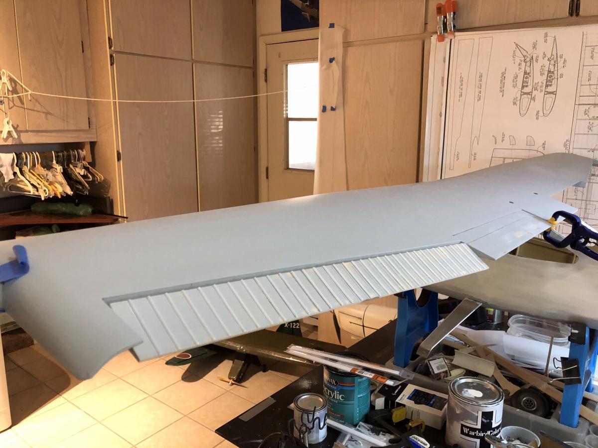

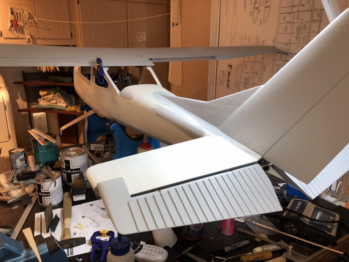

                                  #17
                                  Been awhile since I was able to updat - a lot going on in the aviation world, and it is not slowing up.
                                  But here ya go, she has paint and the graphics from Callie are ready as well.

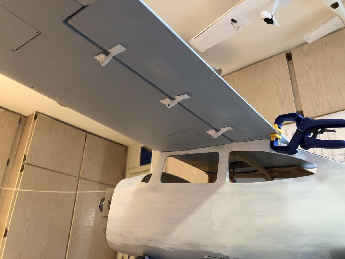

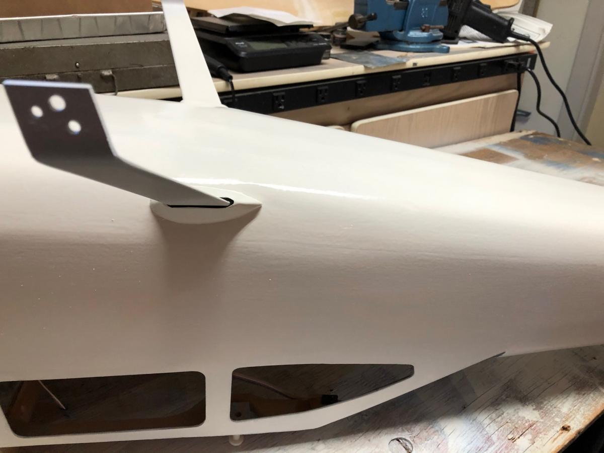

                                        #20

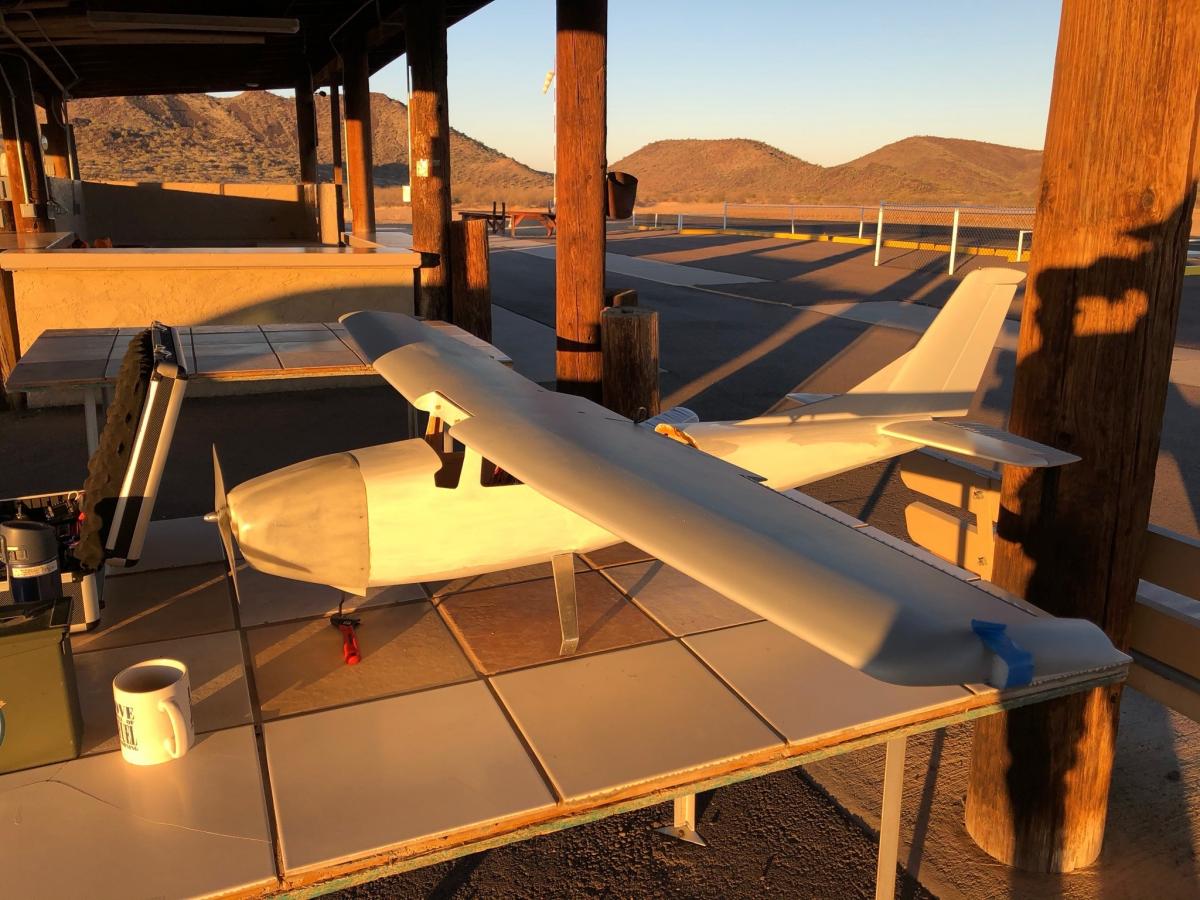

                                        And just like that, it is going back together. The new HVLP helped a lot! Very smooth application and no overspray.
