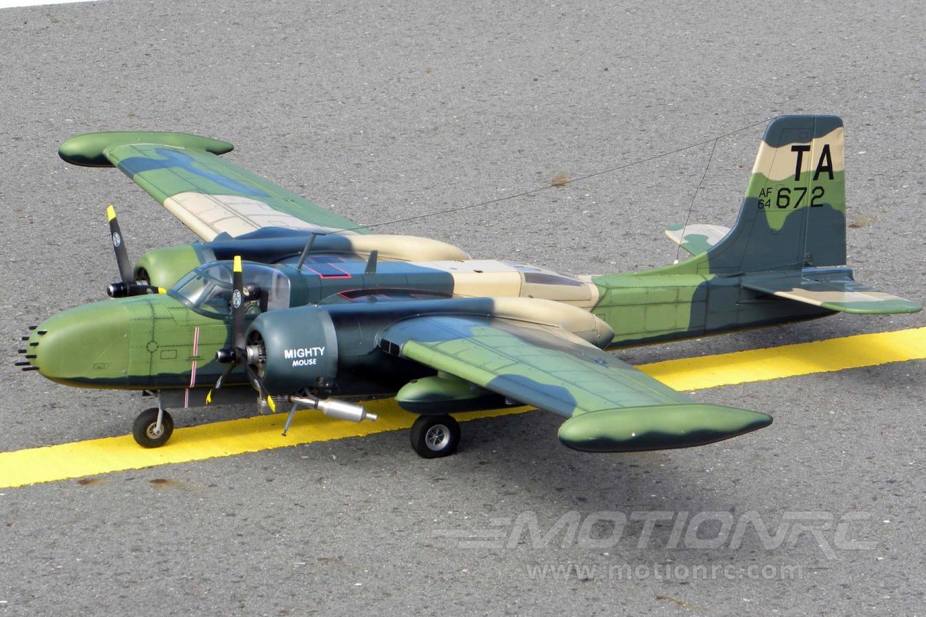

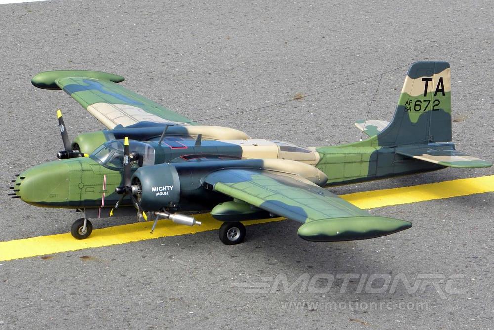

    Nexa A-26 Invader Camo 1730mm (68") Wingspan - ARF
    Click image for larger version  Name:	mastera.jpg Views:	1 Size:	198.9 KB ID:	280616
    The Douglas A-26 Invader (designated B-26 between 1948 and 1965) is an American twin-engined light bomber and ground attack aircraft. Built by Douglas Aircraft Company during World War II, the Invader also saw service during several major Cold War conflicts. A limited number of highly modified United States Air Force aircraft served in Southeast Asia until 1969. It was a fast aircraft capable of carrying a large bomb load. A range of guns could be fitted to produce a formidable ground-attack aircraft.
    The Nexa A-26 Invader is a 68" wingspan electric or gas option scale series warbird, constructed primarily from balsa wood and covered with a fuel-resistant covering. This ARF requires assembly and installation of your choice of servos and power system, and includes painted pilot, tanks, antenna and other scale details. The large battery hatch affords ample room for either electric or gas setups. To complete the scale appeal of this A-26, the model includes electric retracts and scale struts. Impress at your flying field with this iconic stunner!

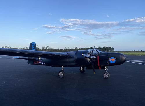

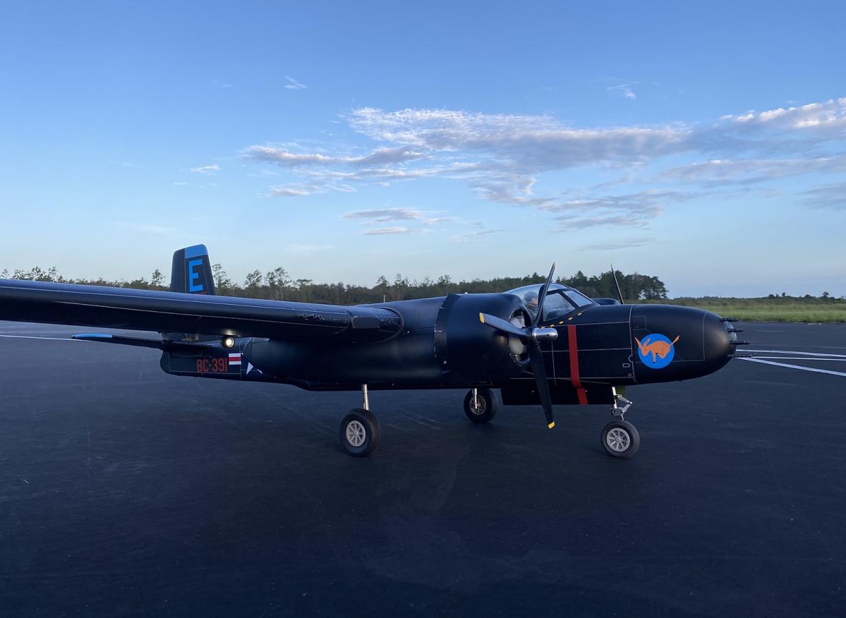

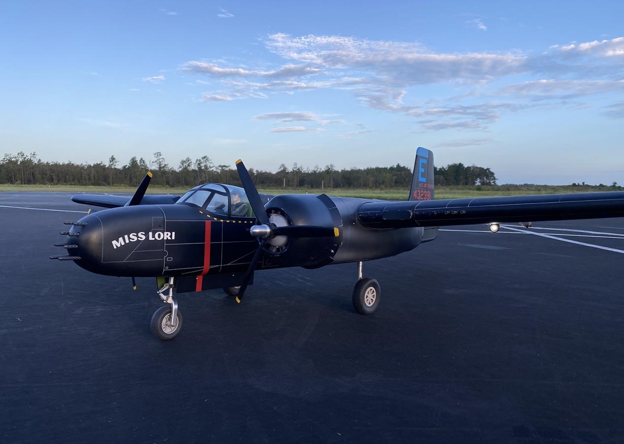

            Three years ago, I found one of these from gas-only days, NIB, and did the conversion to electric power and electric retracts. I used the "high performance" motors that MRC sells for the P-38 and F7F Tigercat, with the largest Master Airscrew 3-blade props that would clear the fuselage. The retracts are those sold for the P-38, but they are a little marginal. The struts are the upgrade aluminum P-38 struts with Robart scale wheels. This is a very nice flying model, although I do miss flaps when landing, which would surely slow it down a lot, That says, it always flares nicely.
