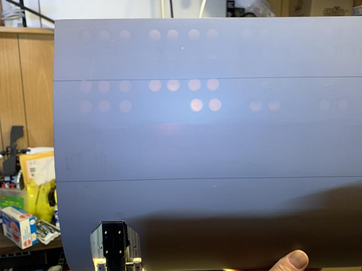

      Does anyone have any idea where the holes on top of the main wing are supposed to be cut.
      As I've been all over it and cannot feel where the holes are under the covering, I am guessing that they have not been cut
      This is for the motor leads to exit

            Holes? I don’t worry about those either. If there aren’t any under the covering, I just make my own. Just make sure you make them in a place that won’t be exposed when the wing is mounted to the fuse. These balsa ARF’s require some hobby building experience. If this is your first one, I can see your confusion. You can use it as a learning experience and mistakes hopefully can be corrected without damaging the plane. Personally, I would not have picked this one as the first one.

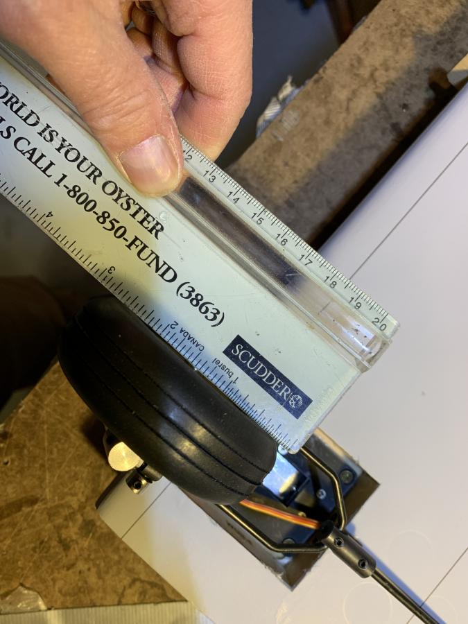

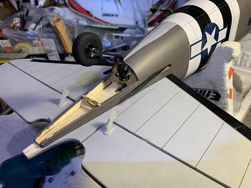

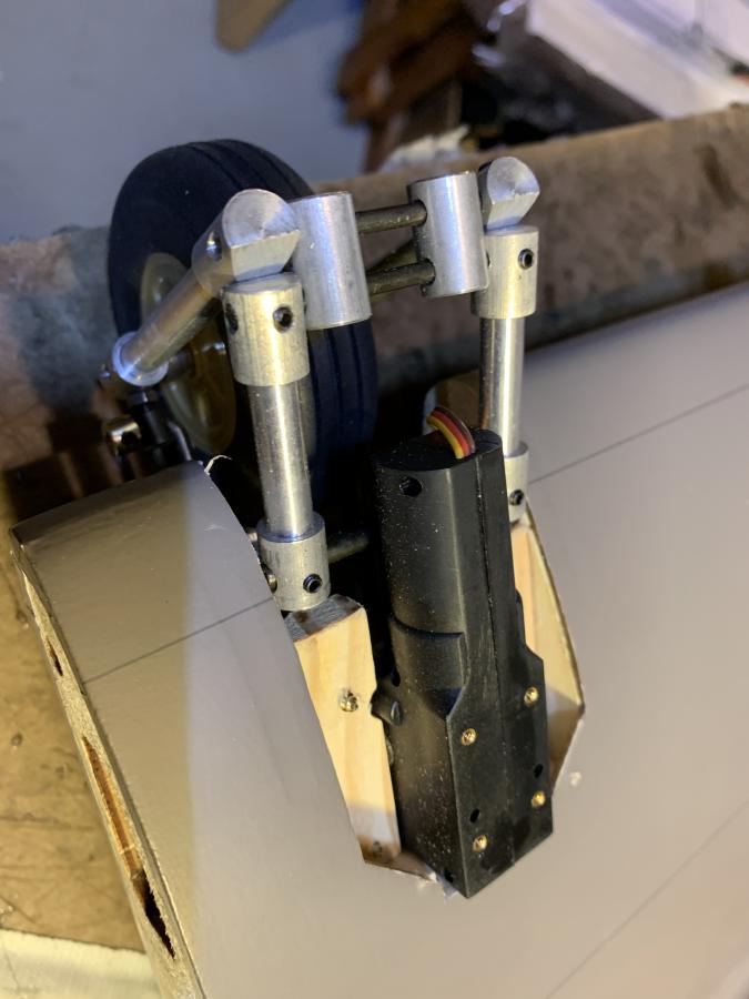

                        Just unboxed the C-47. Very good quality. For the person who was worried about the tires/retracts being inadequate for grass ops, worry not. It comes with 3" tires and very strong looking components in the strut assembly. The retracts are the biggest I've seen since being in this hobby. I can't say about their function but they are very stout in appearance. I doubt I'll need to use any bigger tires or worry about them holding up during rough landings. The build will be similar to the Twin Otter - lots and lots of little and big parts that need to be "jig sawed" together. The TO took me 2 to 3 weeks of a couple of hours each day. This one should be about the same. Many of the components are the same.
                        For the person who was wondering about where to put the holes on the top side to run wiring through, I've out up a picture of the main wing section with a light shining from behind. You can see all the holes in that section. If one hole isn't big enough, just join 2 holes when you cut out the covering to make a bigger oval hole. (Do that within the boundaries of the fuselage so all the holes are within the internal opening.)

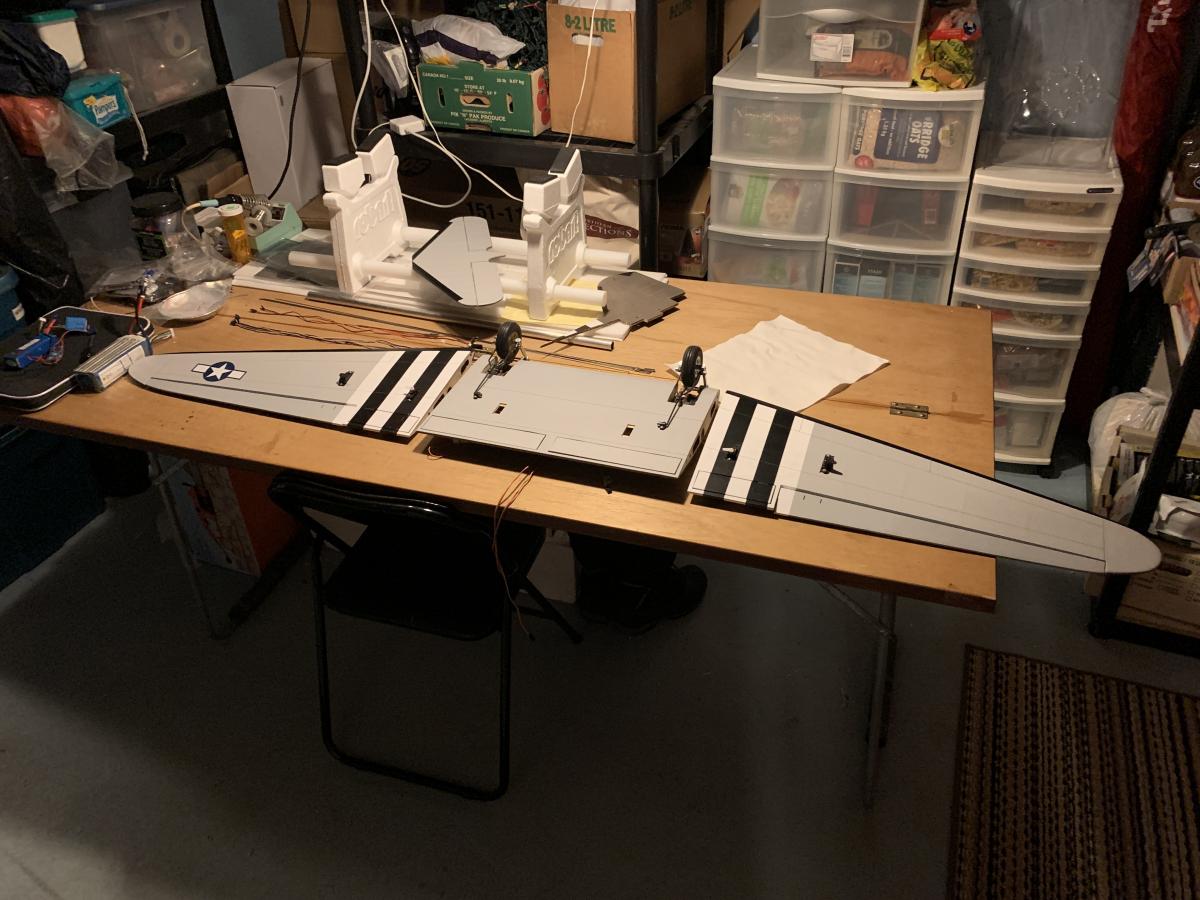

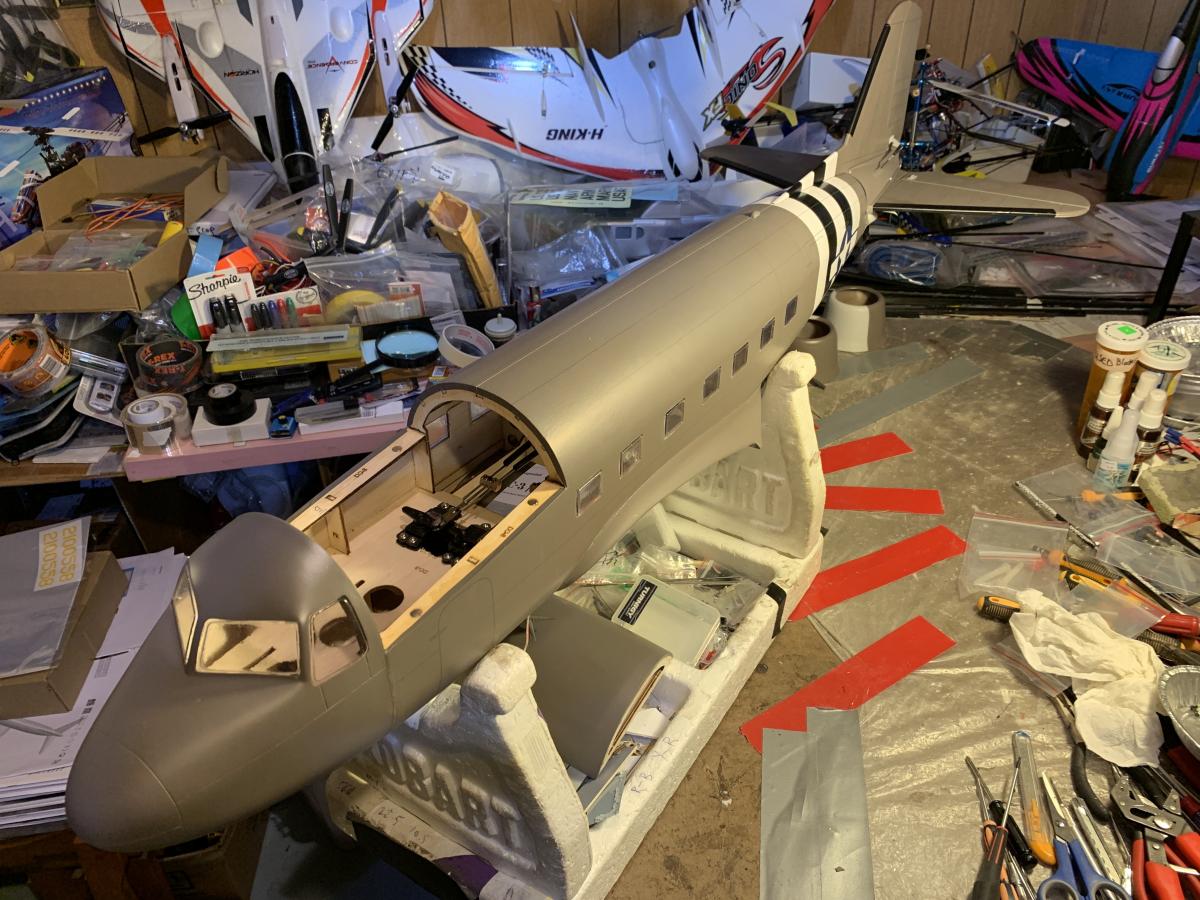

                                  I decided to take some pics of the build just for my own records, so here's what I've got so far:
                                  I only follow the instructions loosely and do things in an order that makes more sense to me.

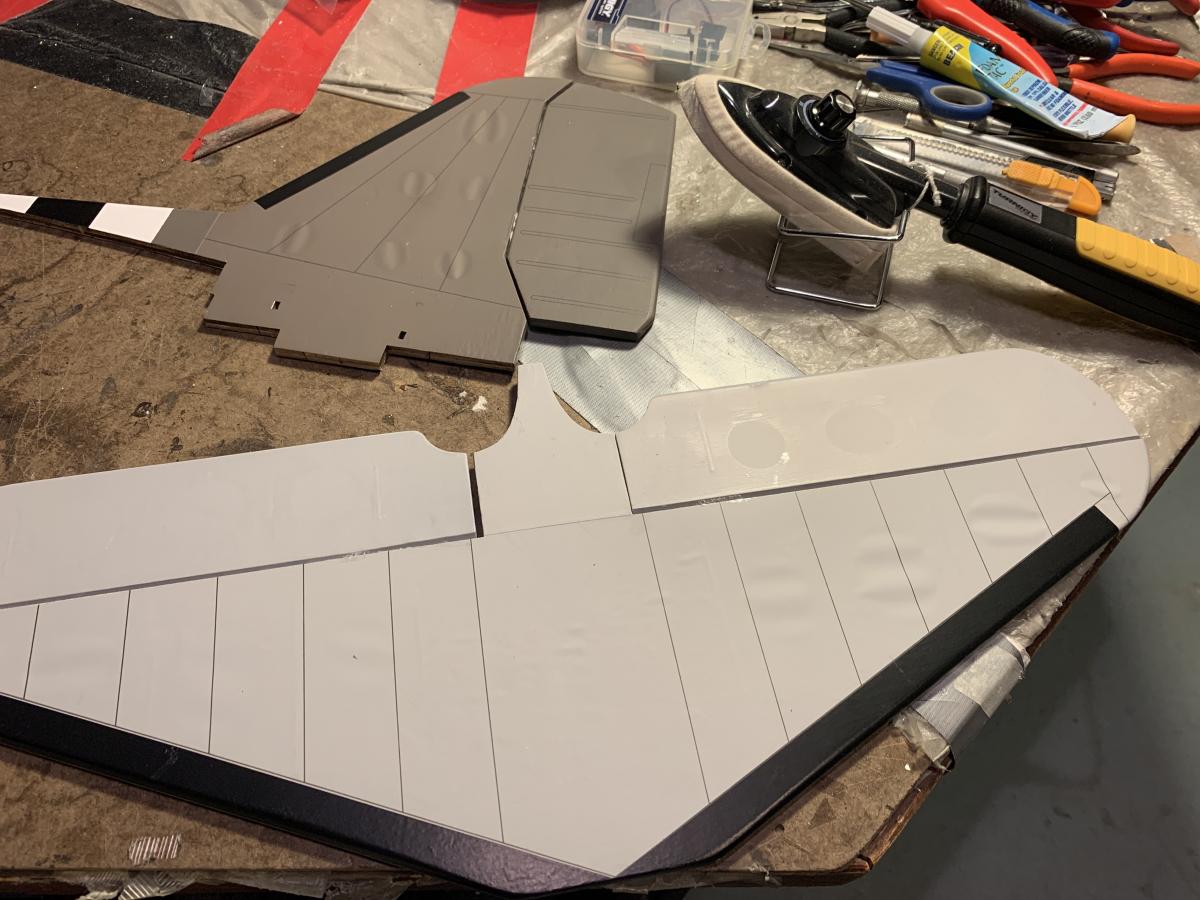

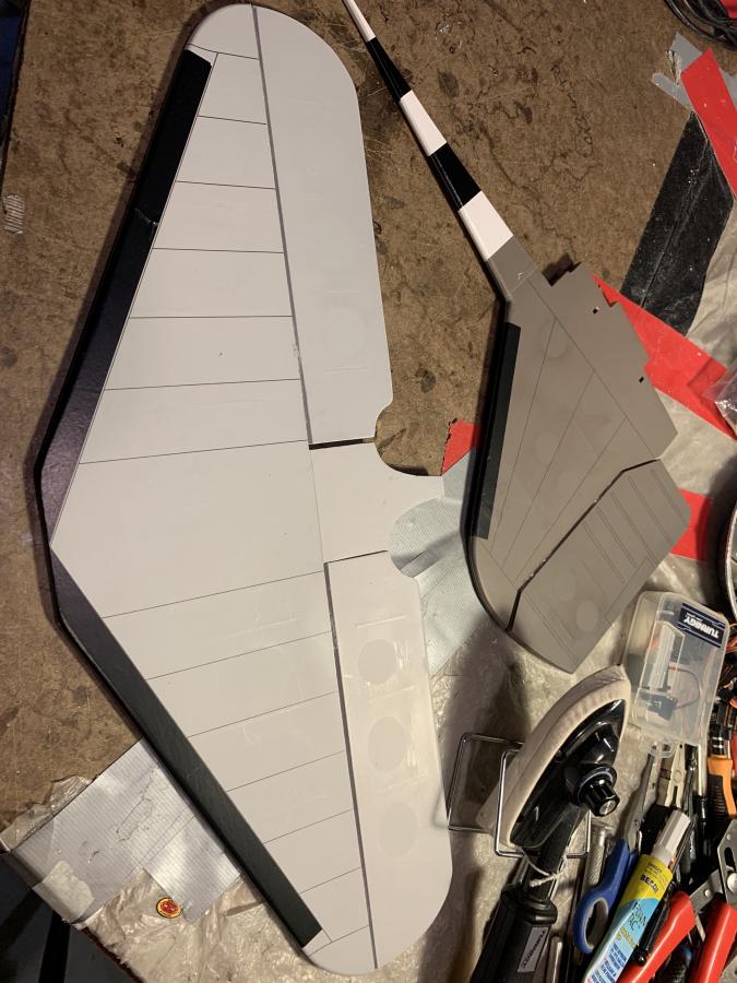

                                  After the usual unboxing to do inventory and check condition of parts, next came the ironing. Most parts were very good out of the box. Only the tail sections were wrinkly. Before and after pics ..............

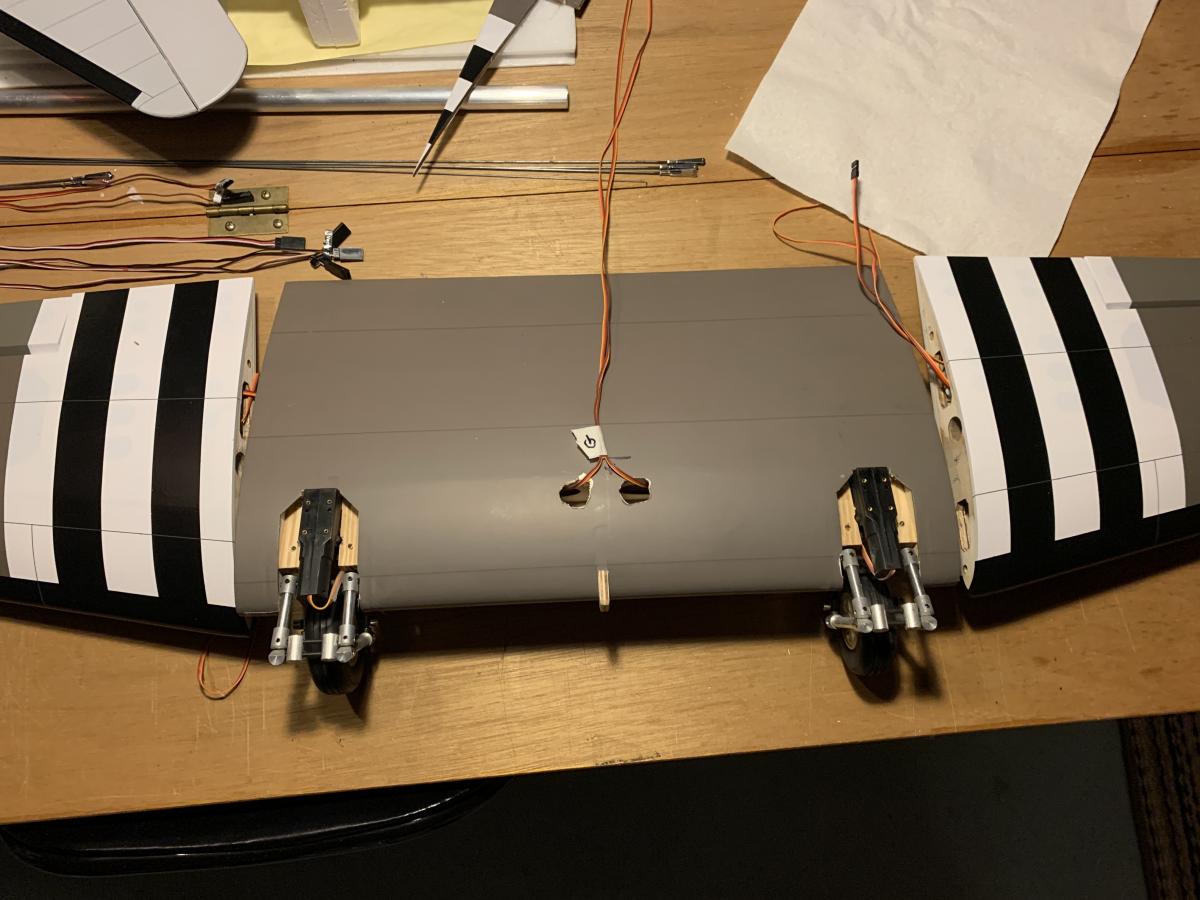

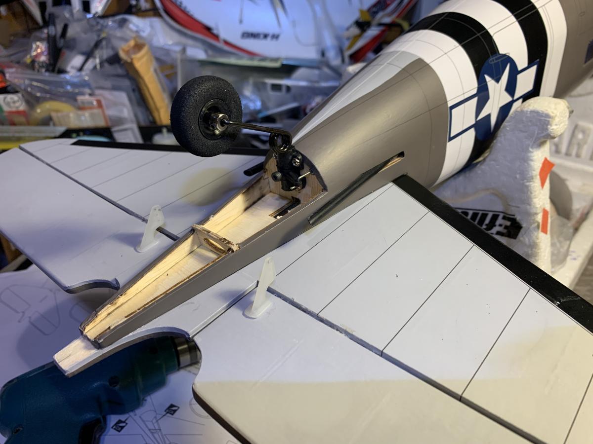

                                  Tested retracts and then started to install the servos in the wings. Used old 9g servos from previously retired FMS planes for flaps and the original stock elevator servos from the Freewing MiG 29 that Motion replaced with higher torque ones. The original servos will do fine for the ailerons. All servo slots had to be trimmed slightly for easier fitment.

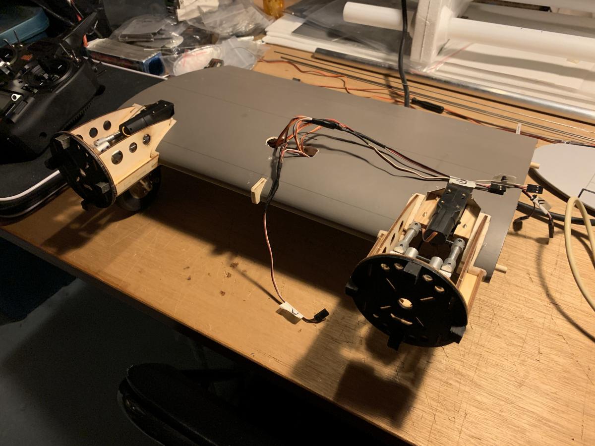

                                  Running the wiring after cutting a couple of holes where all of it will feed through. I didn't have any "Y's" left, so I just soldered the 4 flaps servo wires together to make my own. The others are in pairs.

                                        Next phase:

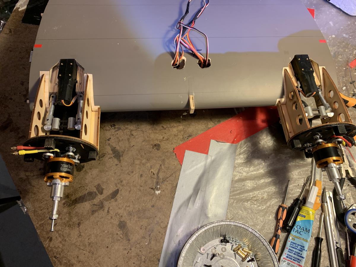

                                        Motor mounts installed:
                                        Click image for larger version  Name:	IMG_3809.JPG Views:	0 Size:	130.4 KB ID:	300719

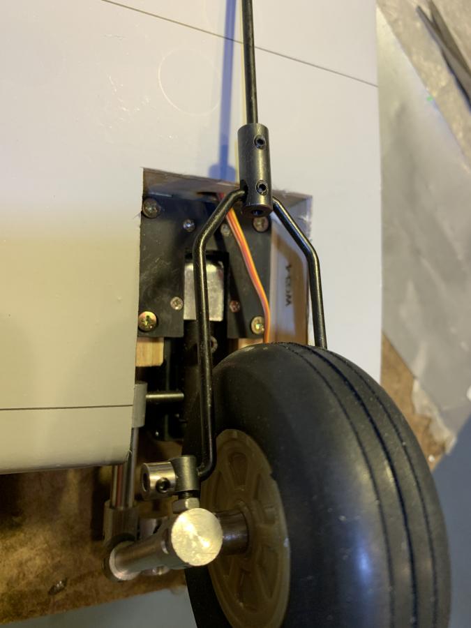

                                        Tail wheel assembled and installed and rod attached:
                                        Click image for larger version  Name:	IMG_3810.JPG Views:	0 Size:	105.8 KB ID:	300720

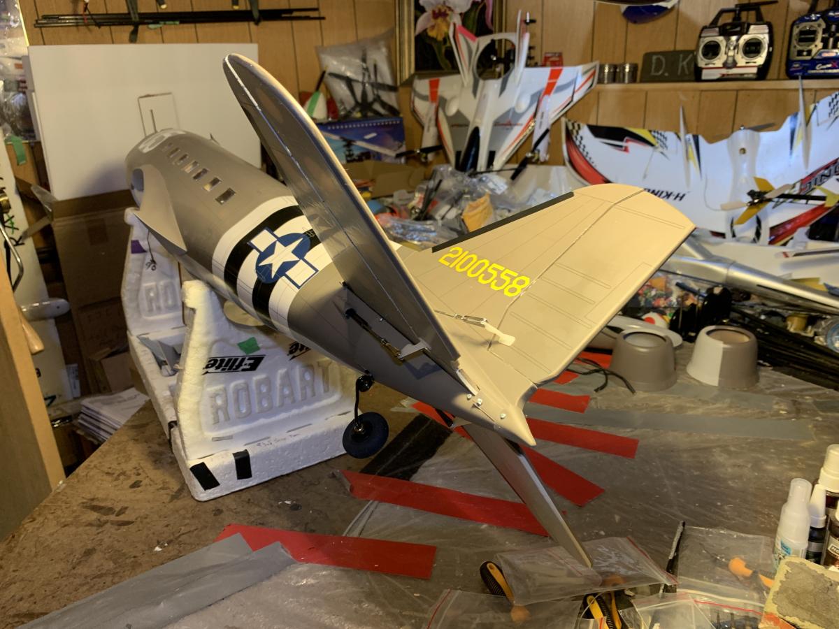

                                        Tail assembly complete:
                                        Click image for larger version  Name:	IMG_3813.JPG Views:	0 Size:	141.5 KB ID:	300721Click image for larger version  Name:	IMG_3811.JPG Views:	0 Size:	178.0 KB ID:	300722

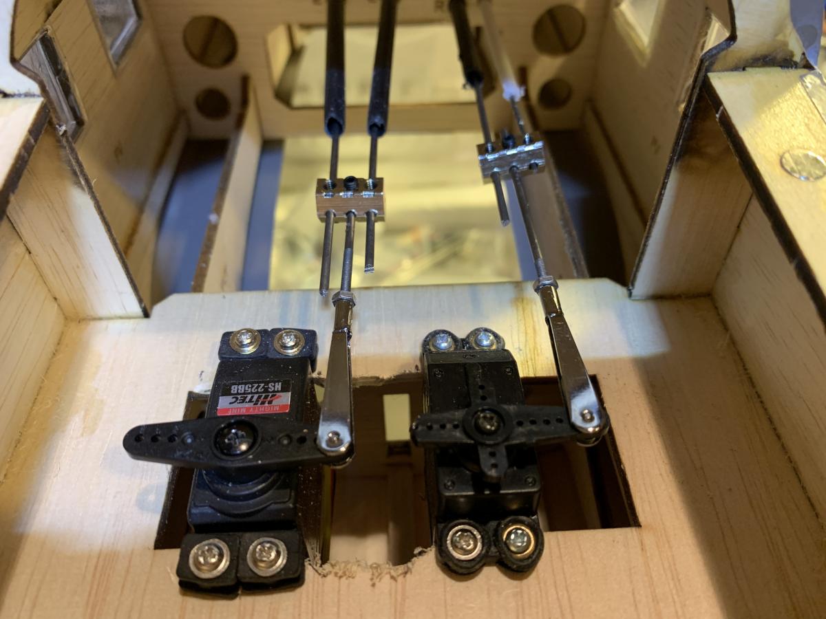

                                        Main interior servos installed, push rods connected, tail surfaces neutralized via TX/RX.
                                        Click image for larger version  Name:	IMG_3812.JPG Views:	0 Size:	107.2 KB ID:	300723
                                        Motors installed and distance from firewall to prop base set:
                                        Click image for larger version  Name:	IMG_3814.JPG Views:	0 Size:	156.1 KB ID:	300724
                                        NOTE: There was NOT nearly enough washers and nuts in the kit to do all the assembly. Luckily, I have plenty of these collected over the years from dead planes. Anyone doing a "first" build of such a kit, will likely be cussing for having to go to the fastener shop or contacting Motion for the missing parts.
