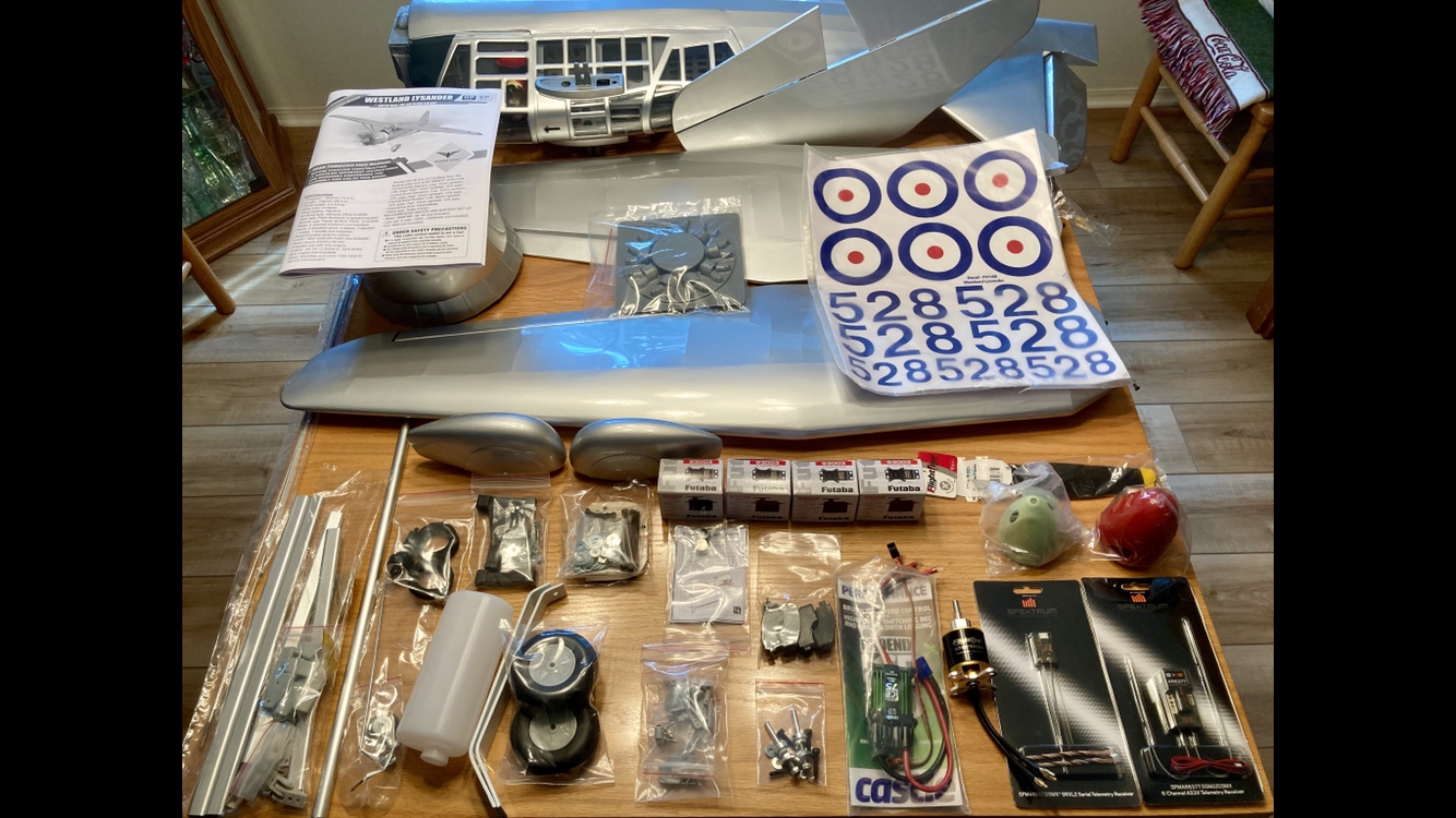

    Papa is really getting a taste of the old days, of balsa planes, and the pleasure of assembly. Tower Hobbies is really giving, at first site, a quality ARF. Top materials and excellent building skills, are the first things that is seen in this model. The Boozers are really enjoy giving all you guys, a look at the experience of balsa assembly, and flight performance of balsa planes. This plane will be no exception, a plane that is simple to assembly, being that it has no retractable gear are flaps. Another plane that is equal to the foamy 1700mm warbirds and easy to transport. We will also equip this plane with electric 4s power. Papa is trying hard to show the ease of battery power, and the scale performance that it gives. So come along on this ride, as Papa gives you a day by day process from start finish. As stated in other assemblies, I will try to stay with the manual as per the manufacturers recommendations. So, let's get started and have some fun! Isn't it about time you try a balsa plane? Maybe this one! Remember, after assembly the final trial will be on the Merry Boozer Channel, to see how this model performs. God, I am having the time of my life at 67 years young. I hope, you are as lucky of loving your hobby as I.

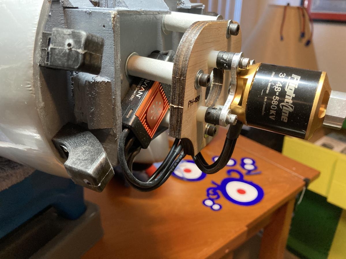

      What motor are you using? Phoenix planes are designed around RimFire motors. Rimfire motors use a different X spacing than all other manufactures motor's.

        I fly mine using a 3,000mAh 6S battery and a Suppo 4120/620kV motor. It has good power and flight times. I did not need to add any weight to achieve a good CoG with my set-up.
        The included wood for the electric motor option is pre-drilled for Rimfire motors, but it's easy to fill those holes with epoxy and then drill new holes for a different size X-mount. I have done the same for several Phoenix planes with good results.

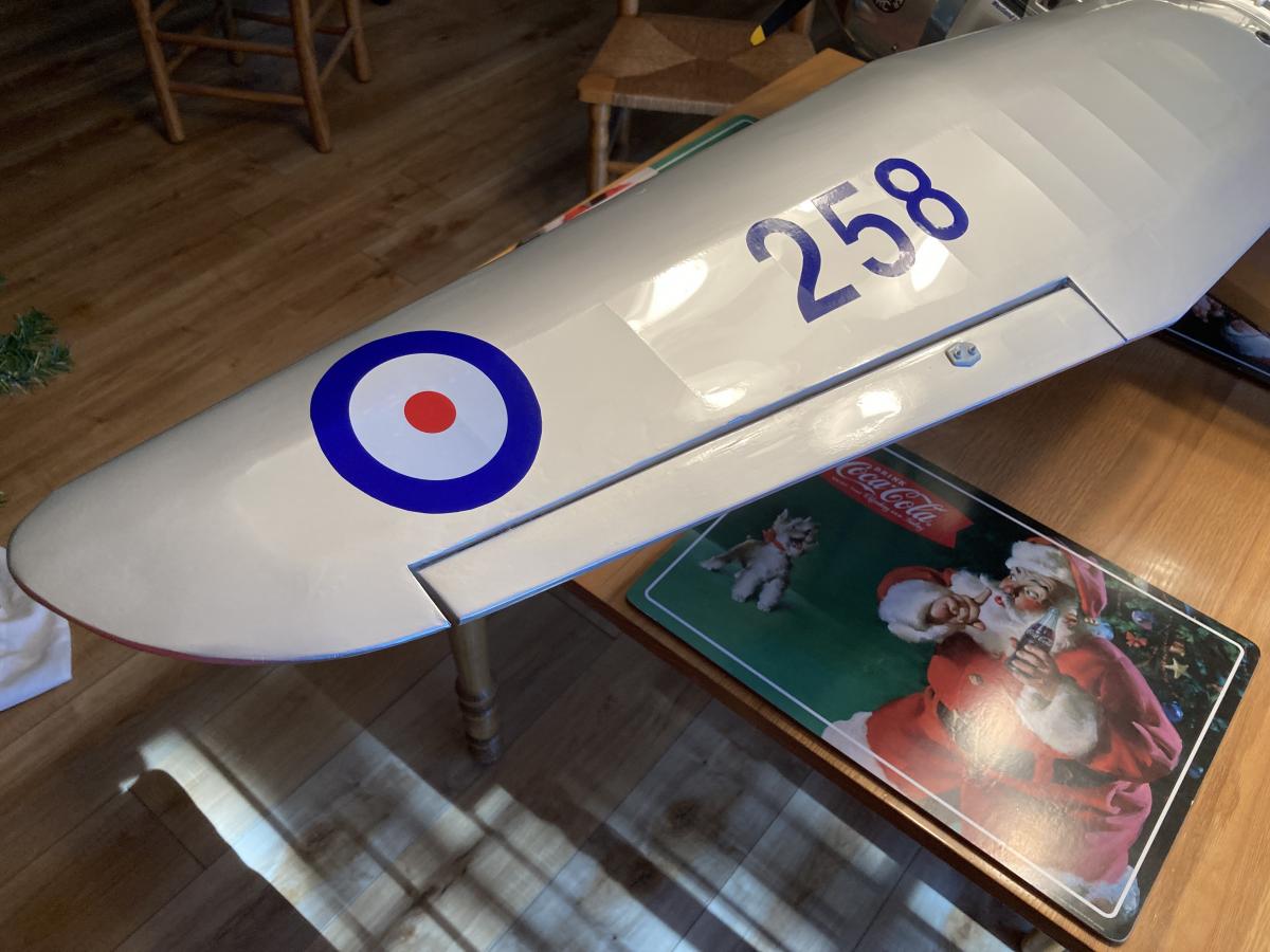

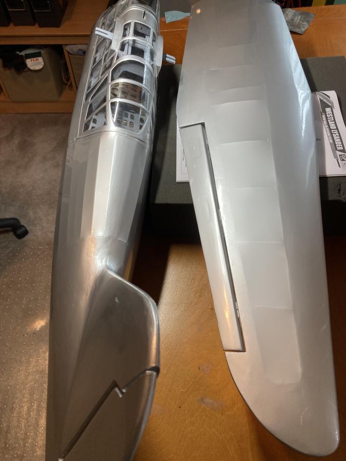

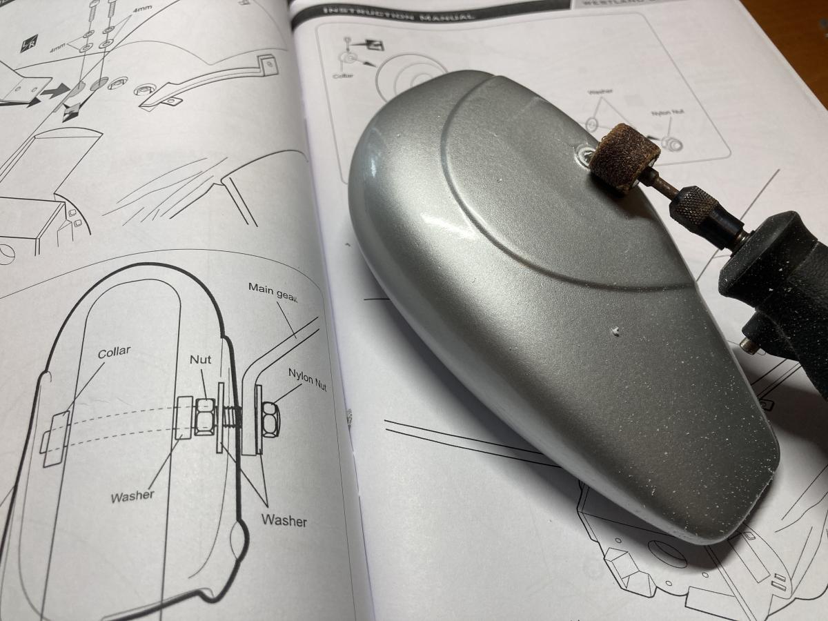

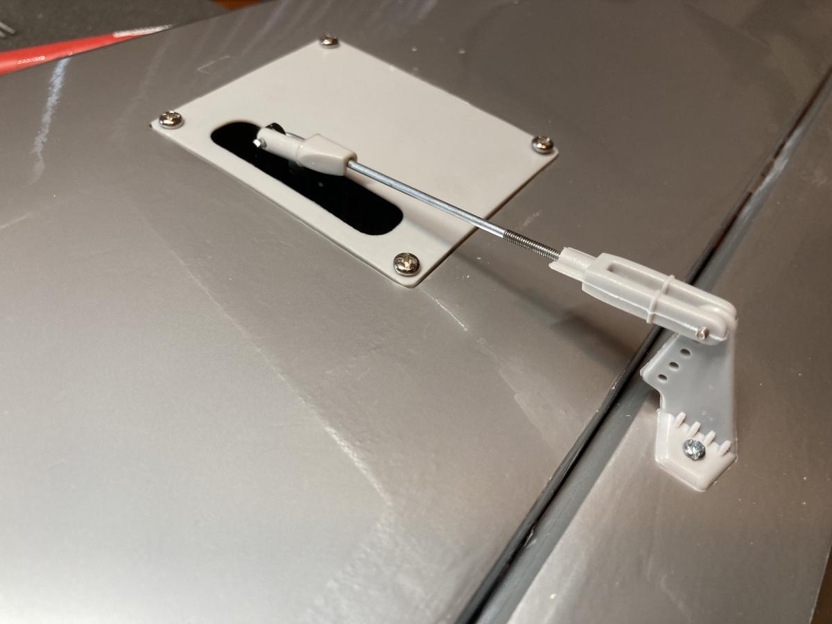

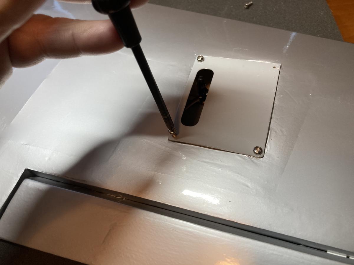

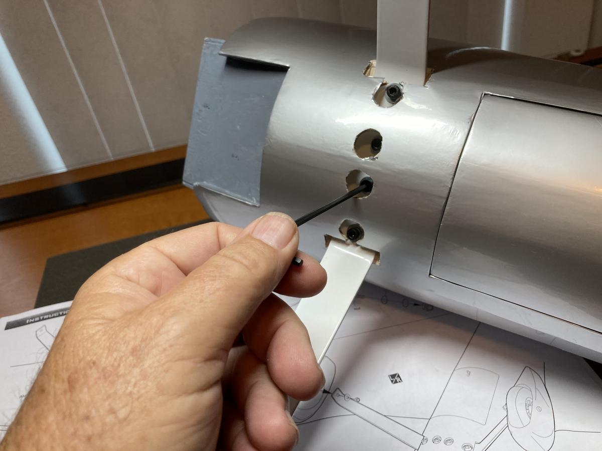

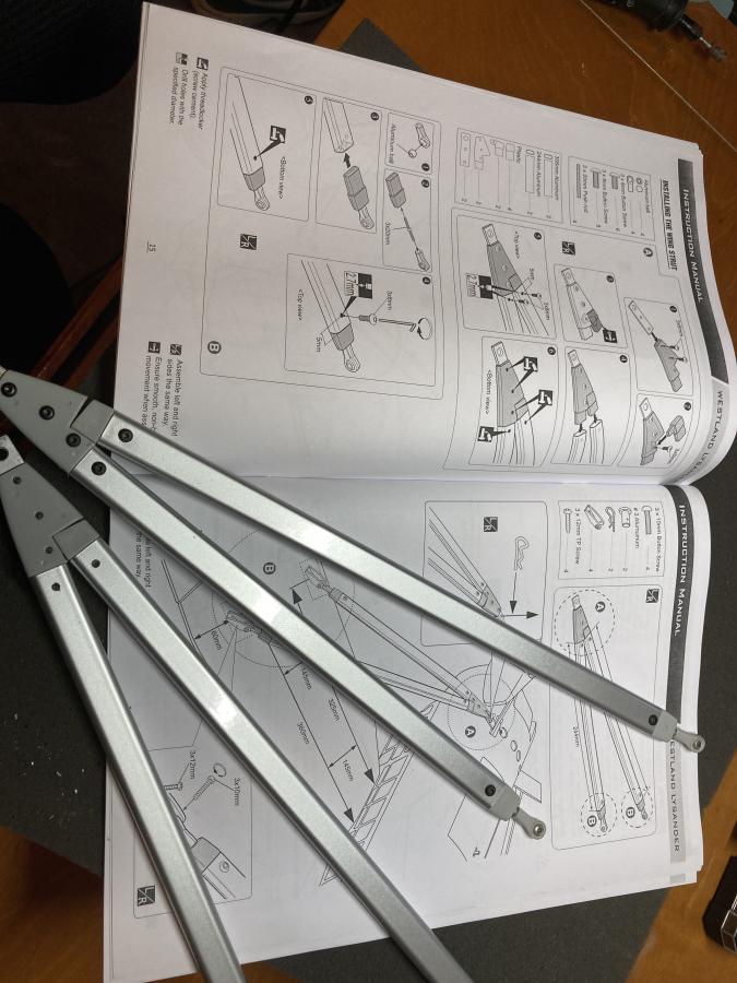

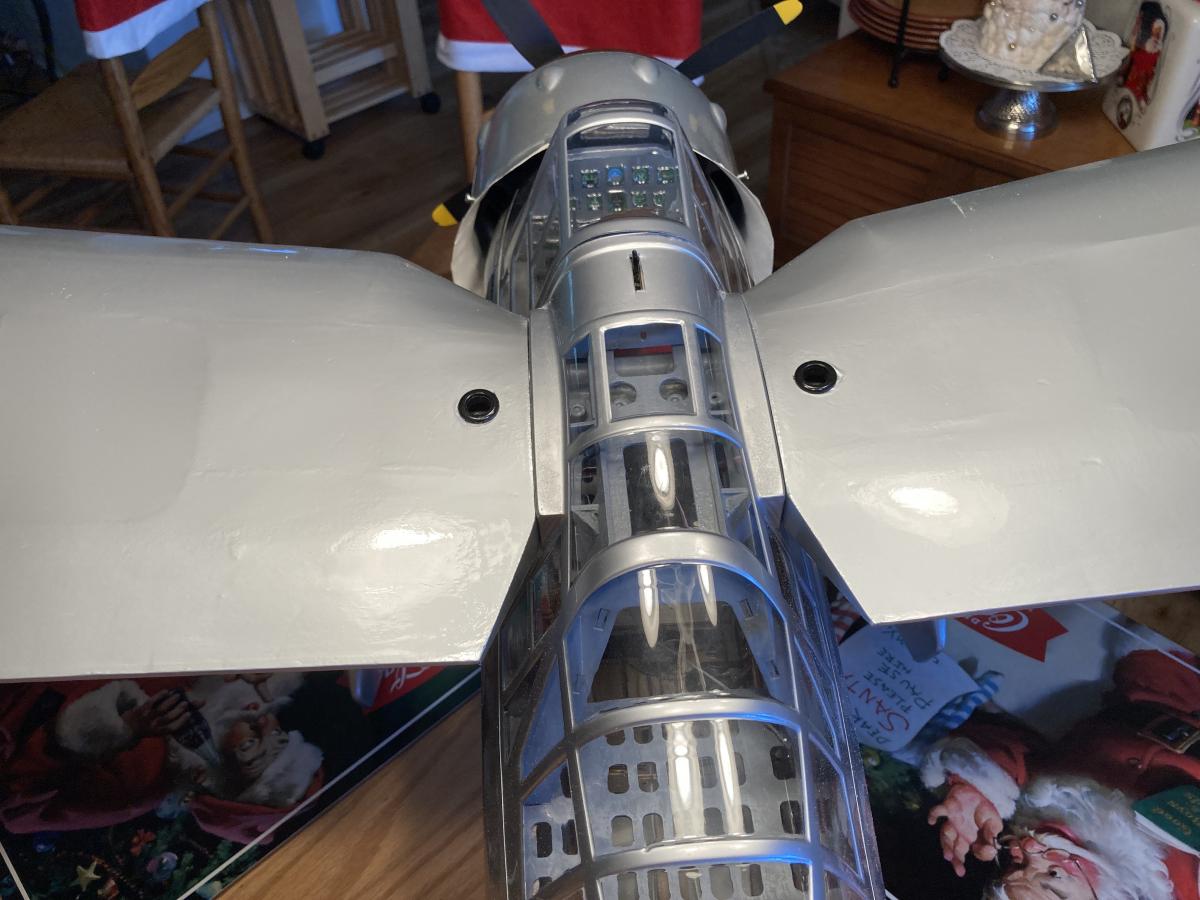

          DAY 1....Assembly of wing ailerons, servos, linkages, control horns, servo extension leads, main landing gear with wheel pants, assemble of wing struts. So, I have followed the manual and have not had any problems to speak off. I was short four screws to hold down the servo cover for one wing, but for an old modeler, have many on hand in the repair box. Parts are all high quality and no issues that have been problems in past ARF's.

            Looks like the aileron cover needs a shot of silver paint.

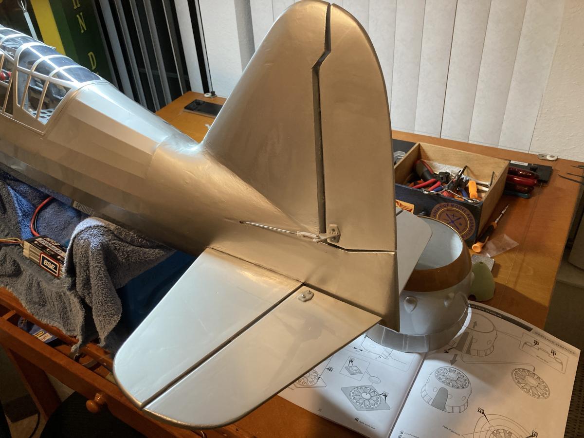

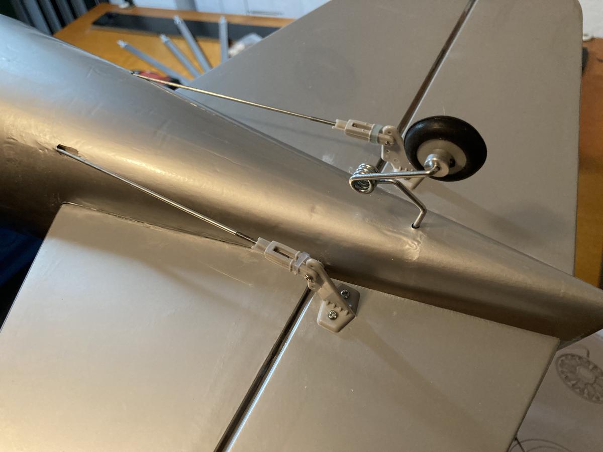

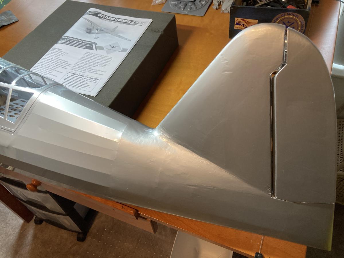

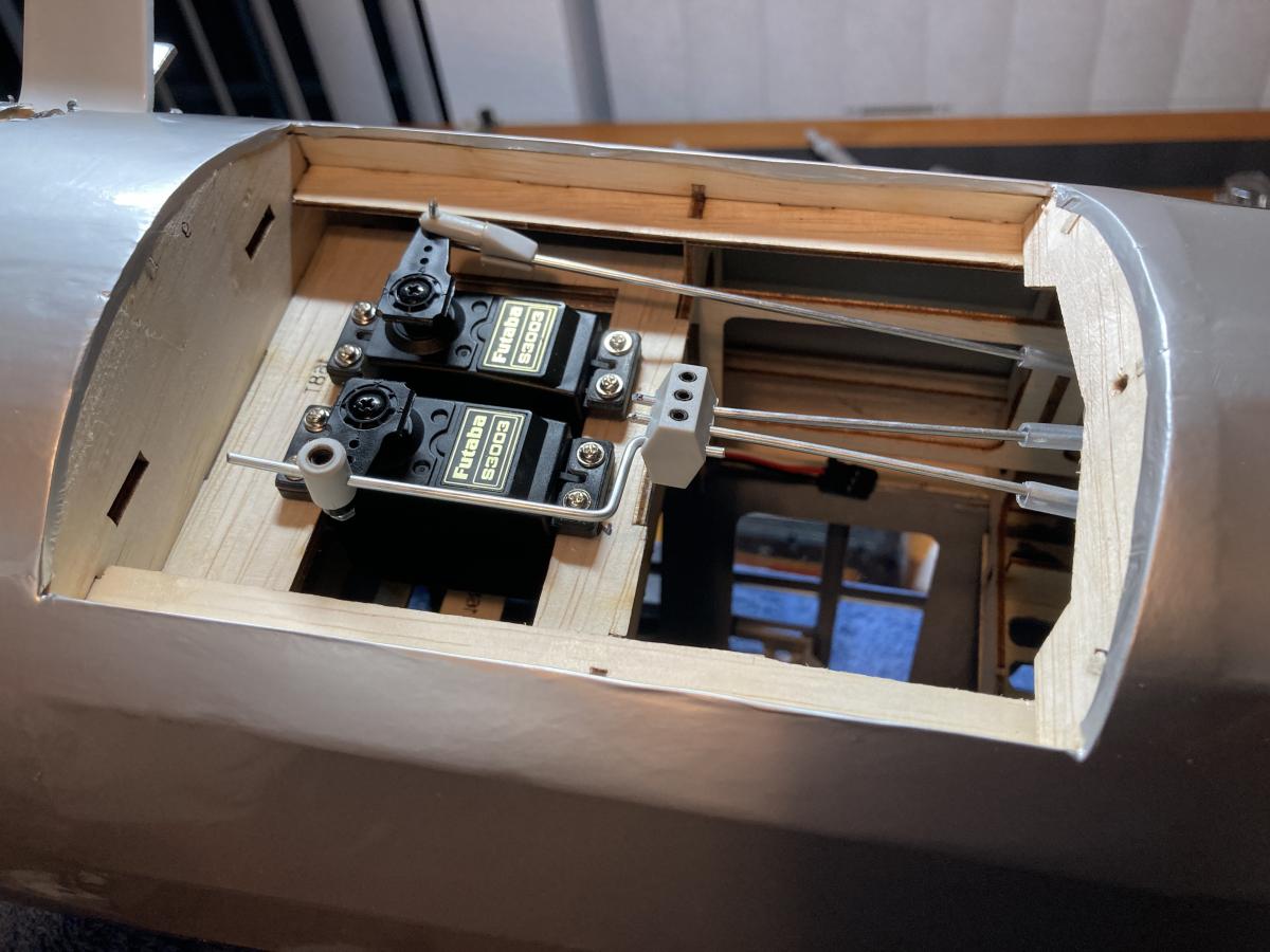

              DAY 2. Assembly of Rudder, Tail gear, Elevators, Controls horns, servos, linkage for both, and engine cowl mounts. Stayed with the instruction manual, have no changes to this point. Manual is very detailed and ease to follow. Very pleased with this adventure, and are at the home stretch. On to the engine and cowl install.

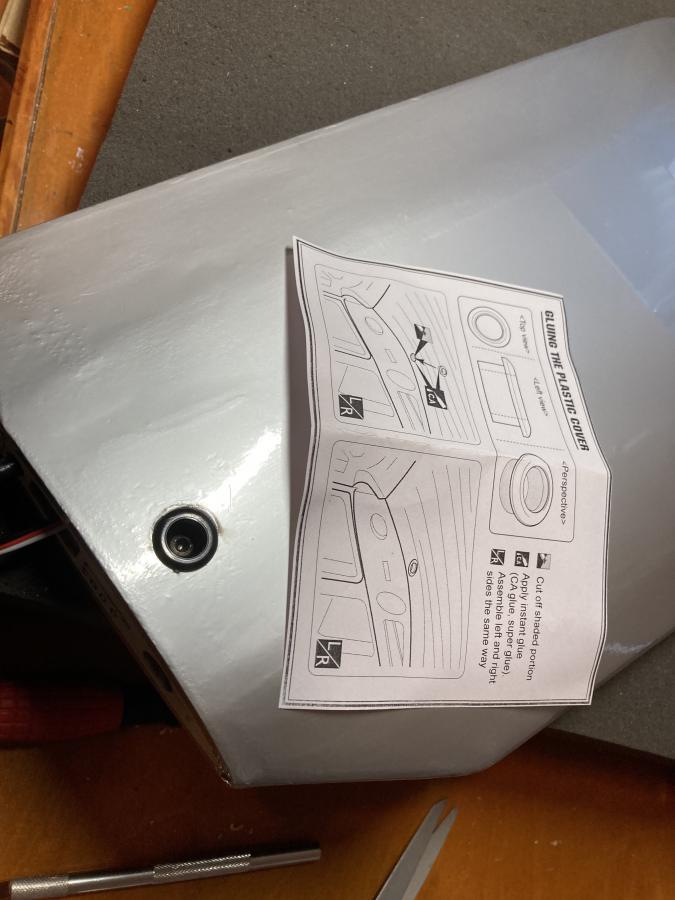

                pdansalvish...The aileron covers on most models are made of thin ply and blocks that are glued on, last you cover with silver covering. Not this model, made of molded plastic. Less work on my part, and maybe a lot stronger. I will paint both silver, but they are on the bottom of the wing. I will answer you question on motor and ESC in the next post. It is the next assemble. ALWAYS REMEMBER, DO NOT USE POWER SYSTEM IN THIS ASSEMBLE, UNTIL WE SUCCESSFULLY FLY THE MODEL IN THE VIDEOS. THAT WILL ALWAYS BE TRUE ON ANY ASSEMBLE THE BOOZERS DO, UNLESS WE USE THE POWER SYSTEM RECOMMENDED BY THE MODEL MAKER!!!!!!!!!!!!!!!!!!!!!!!!!

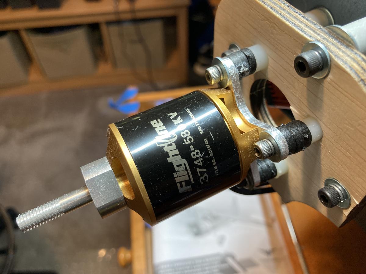

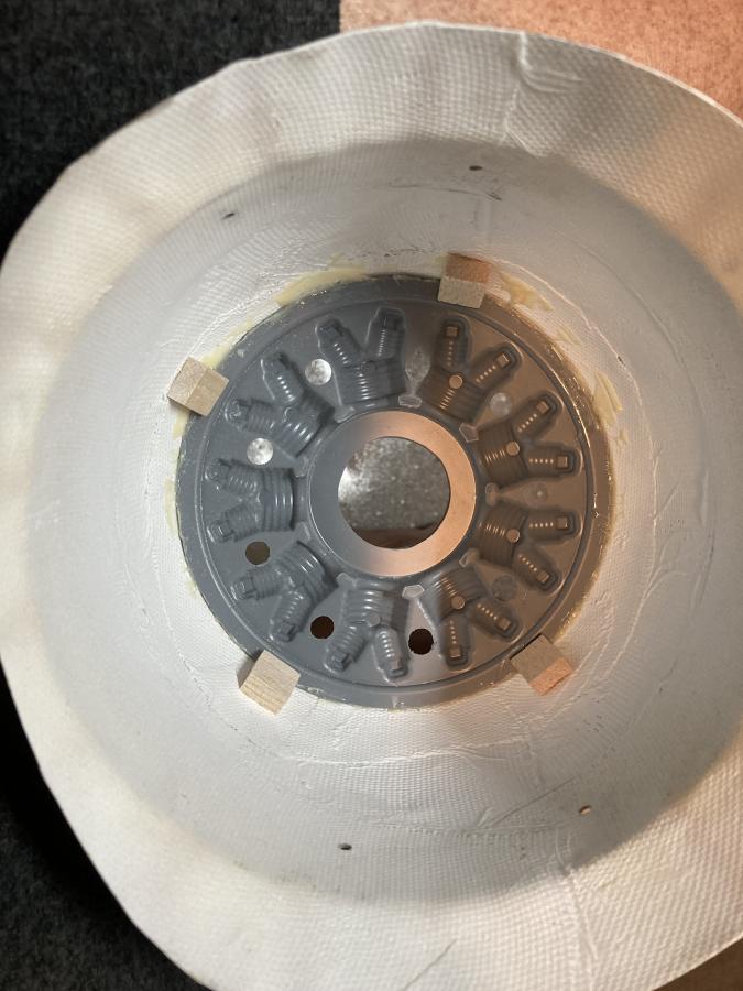

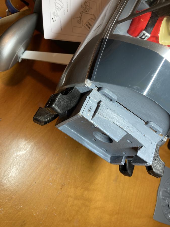

                      DAY 3, Install motor mount, motor, cowl, and ESC. Guys, this is part of the assembly is dependent on choice of motor. Each motor is going to be a different size. As you can see in the photos, I had to use several spacers, to get the motor shaft correct for the spinner. Please take your time on this procedure, it is critical to get this right. Attaching the cowl is as the instruction manual shows. The ESC and Receiver are from Spektrum, Wes and I are really loving this new technology. That beginning real time telemetry straight to your Spectrum radio and the smart battery technology. I will also show pictures and catalog number of these items. On the prop beginning used, we may also use the Spitfire 4-blade, just to see the performance difference between pervious 3-blade TA-152.

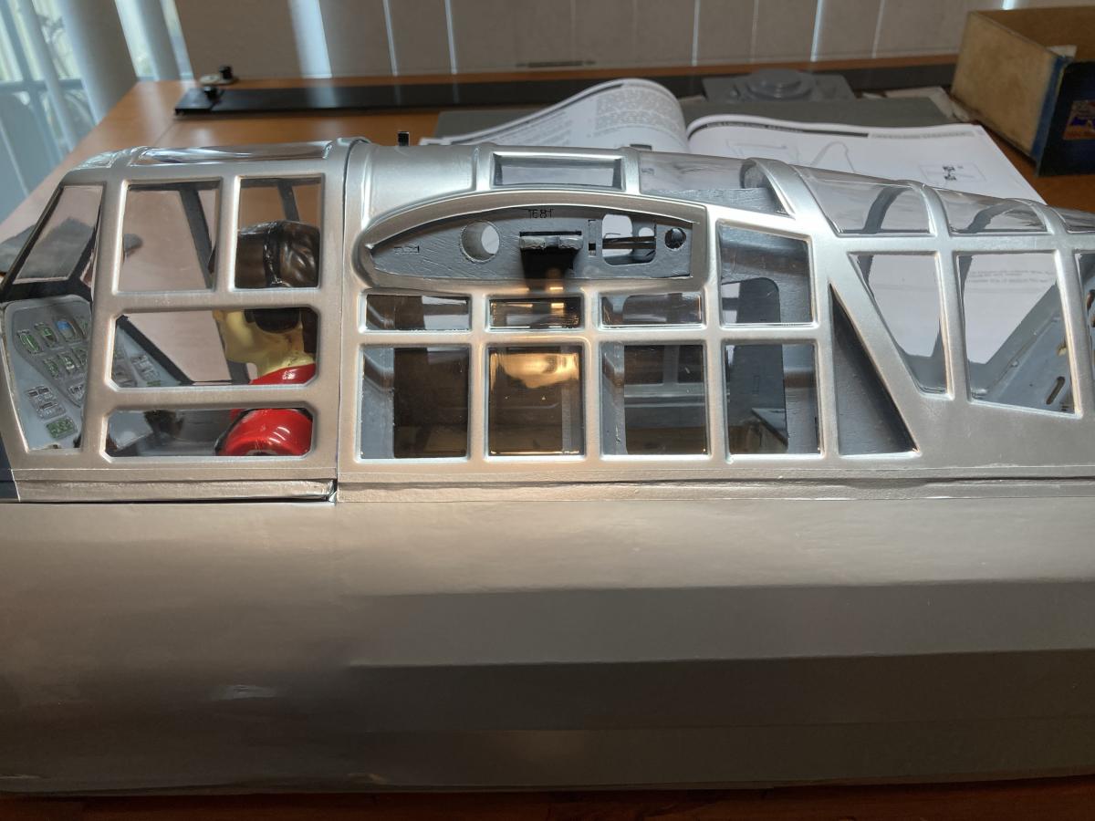

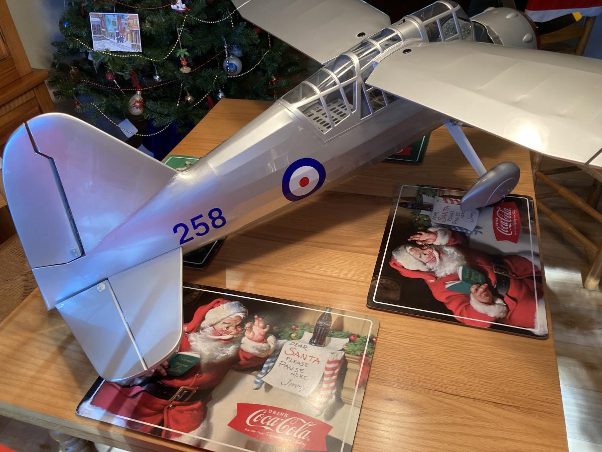

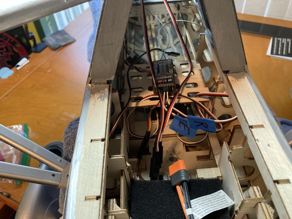

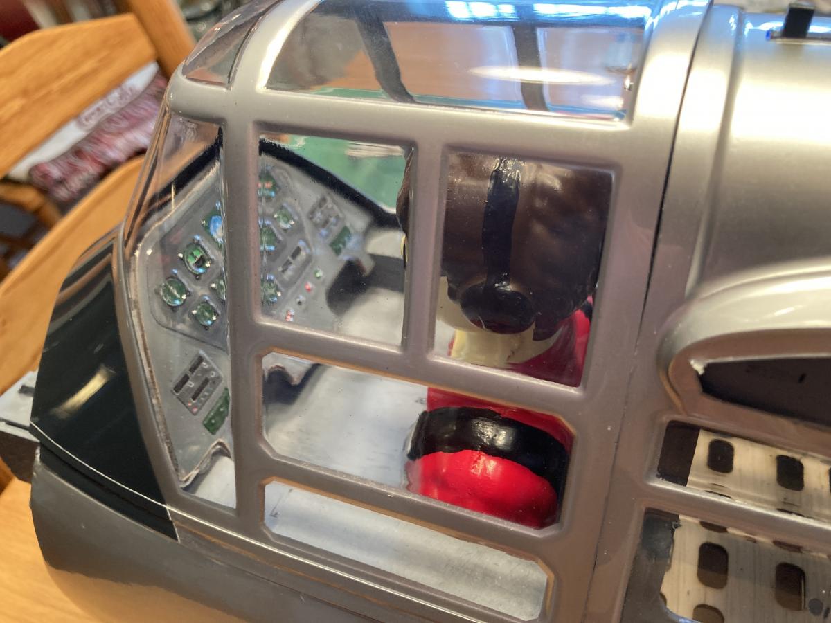

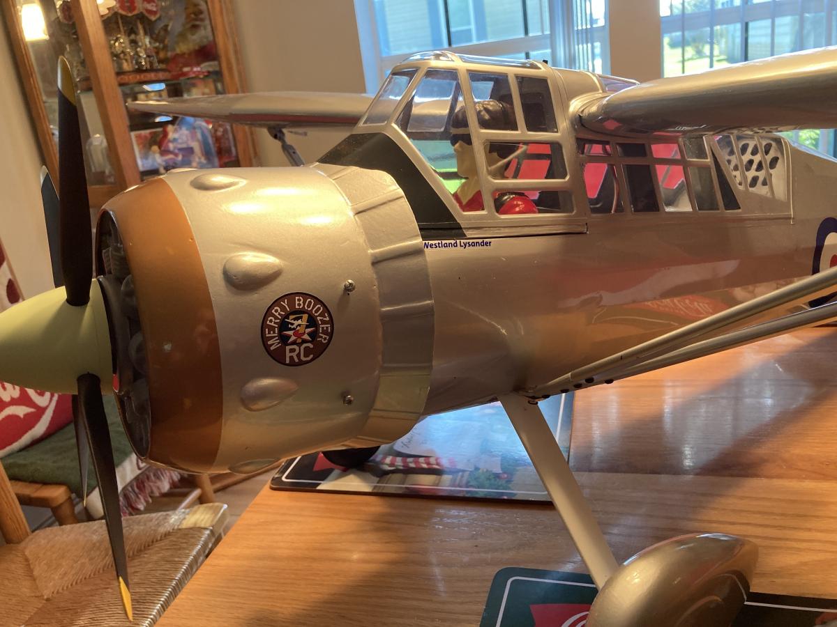

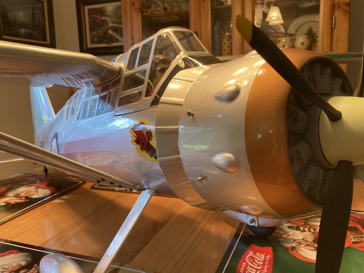

                        DAY 4, Installation of Spectrum receiver, and Decals. The choice of the Boozers, has always been the Spectrum brand of electronics. The new technology is awesome, and if you have not checked out this brand, you should. Decals are not hard, but I did cut out all the numbers. High quality and very easy to apply. So, look for the final test, go by The Merry Boozer Channel and see have the LYSANDER does in it maiden flight. Remember: Fly with your buddies and enjoy your sport.

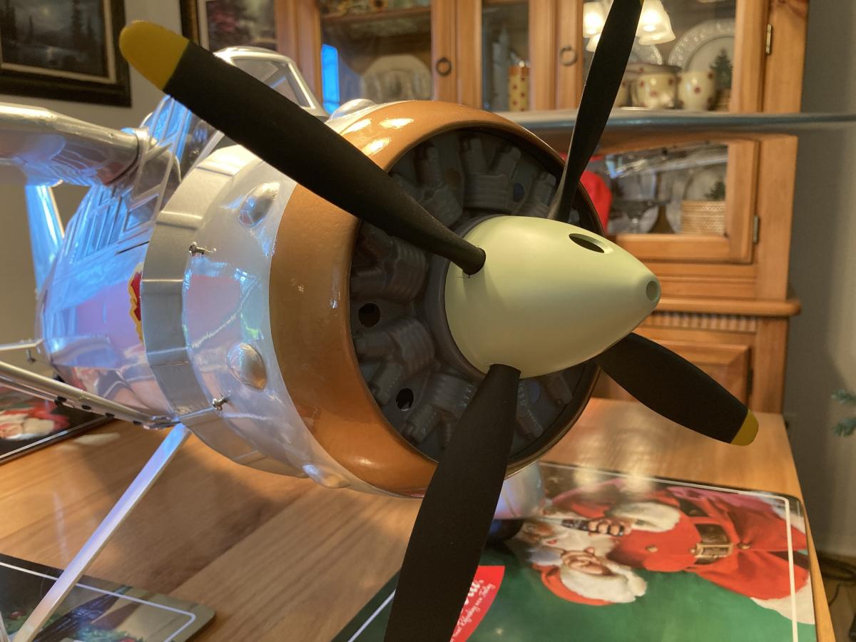

                          OBTW, the real Westland Lysander used a 3 bladed prop. There is a video of one flying from the Shuttleworth Collection on the net.

                                    Couple the FlightLine 4blade prop and spinner combo (12x7x4)

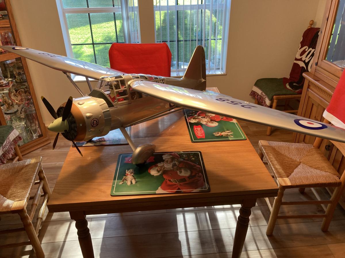

                                      #19
                                      Guys, we successfully maiden this plane and was very pleased with flight performance. Please go to the Boozer channel and watch the video.
