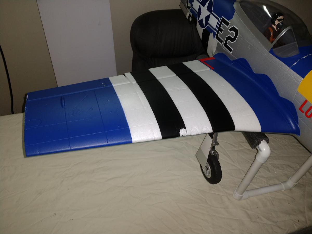

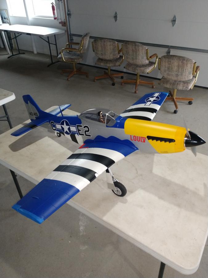

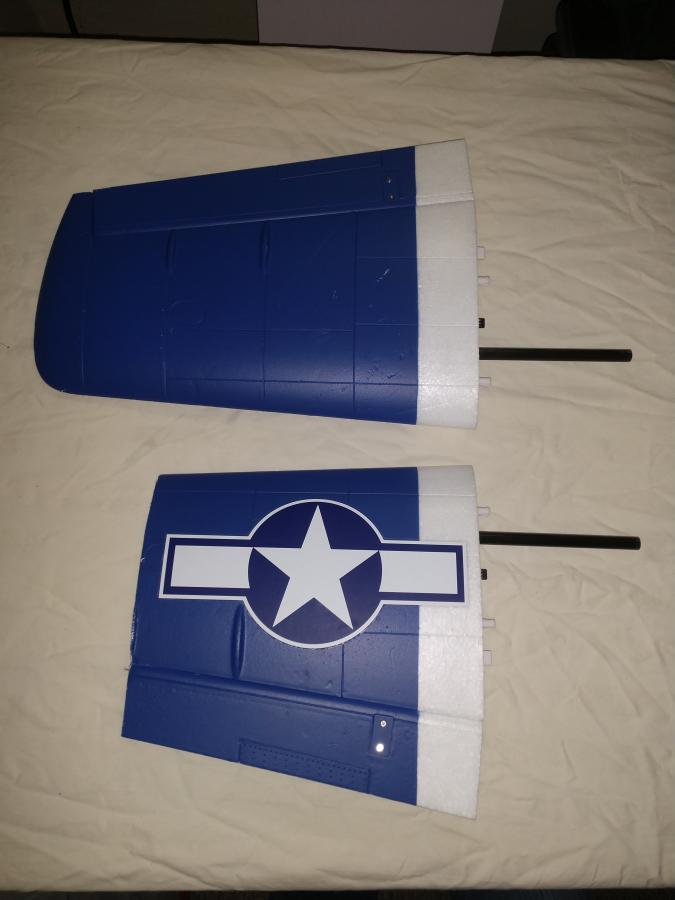

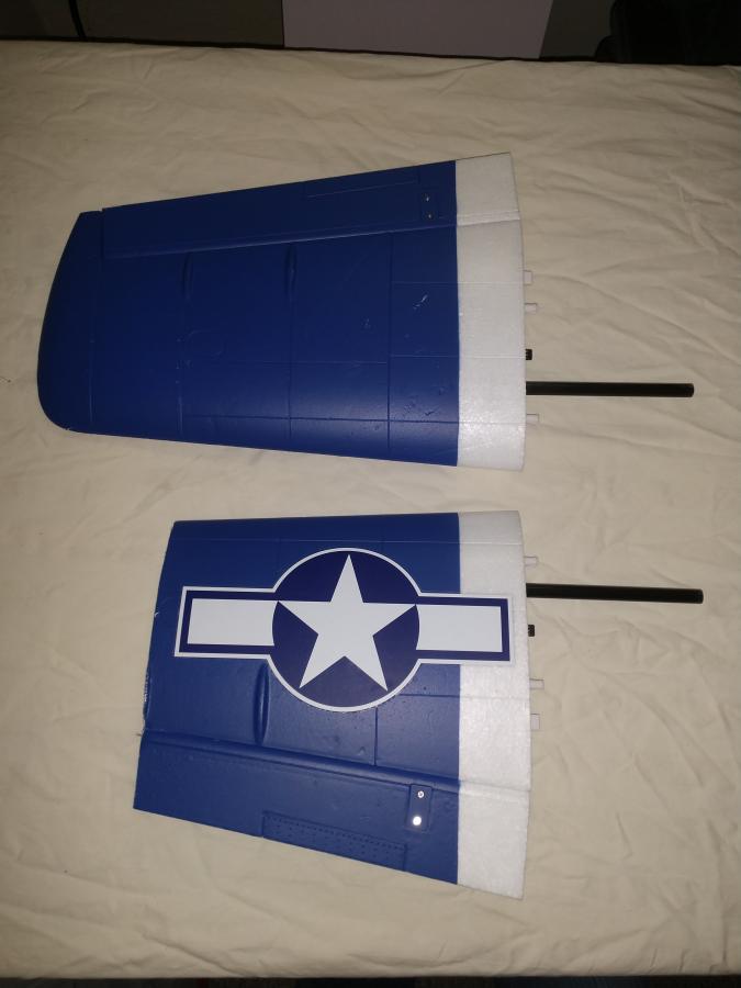

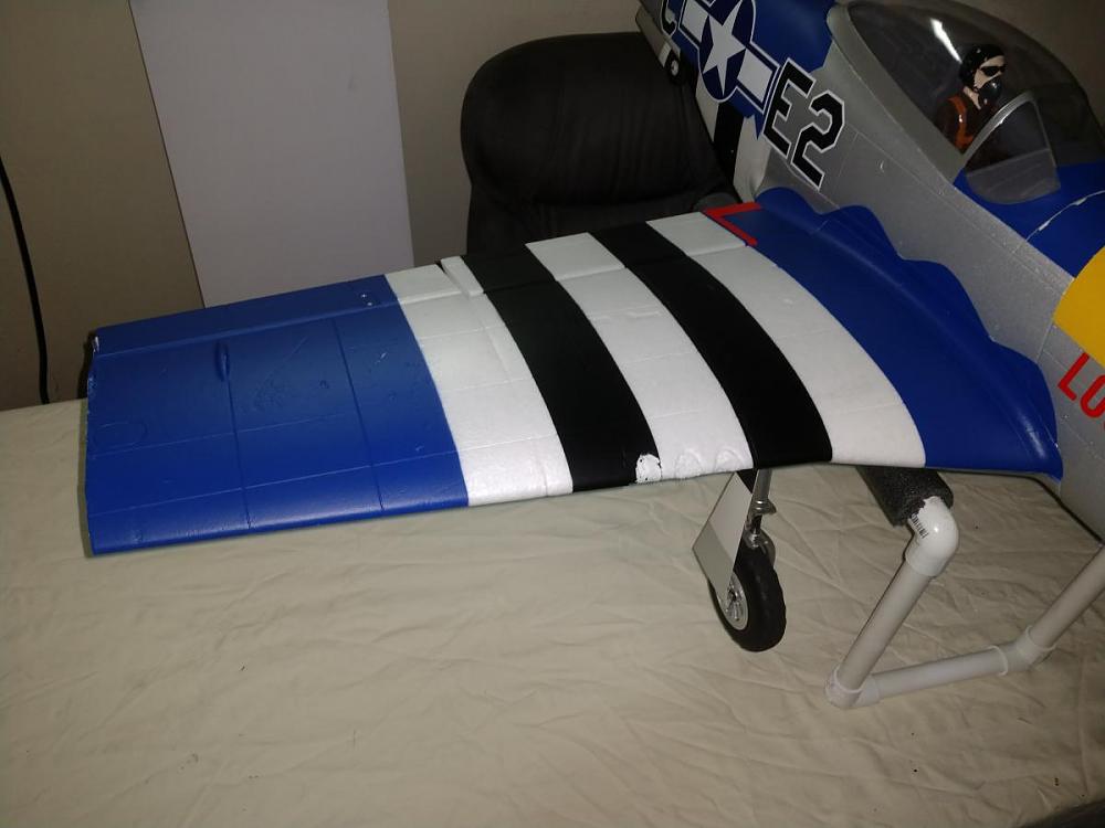

      Well I went ahead and clipped the wings. I took 4 & 1/8th inches off from each side. It now has a wingspan of 1295mm.
      I'll be test flying it tomorrow.

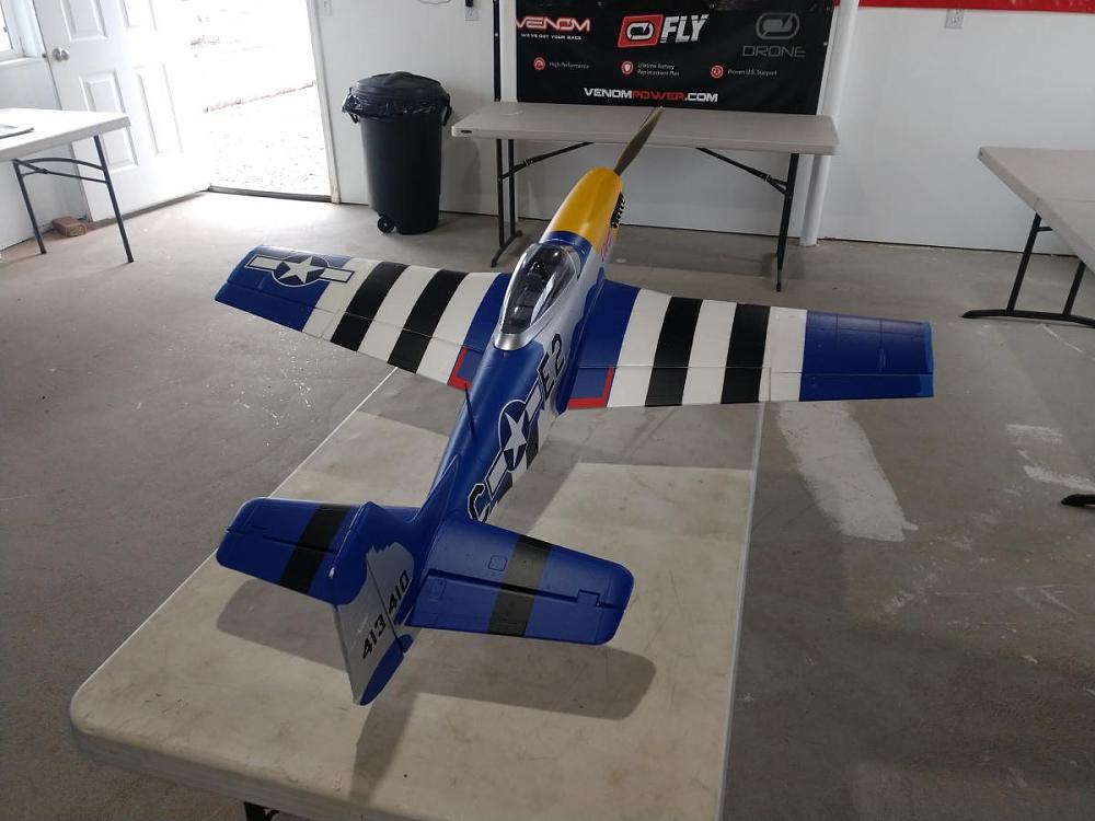

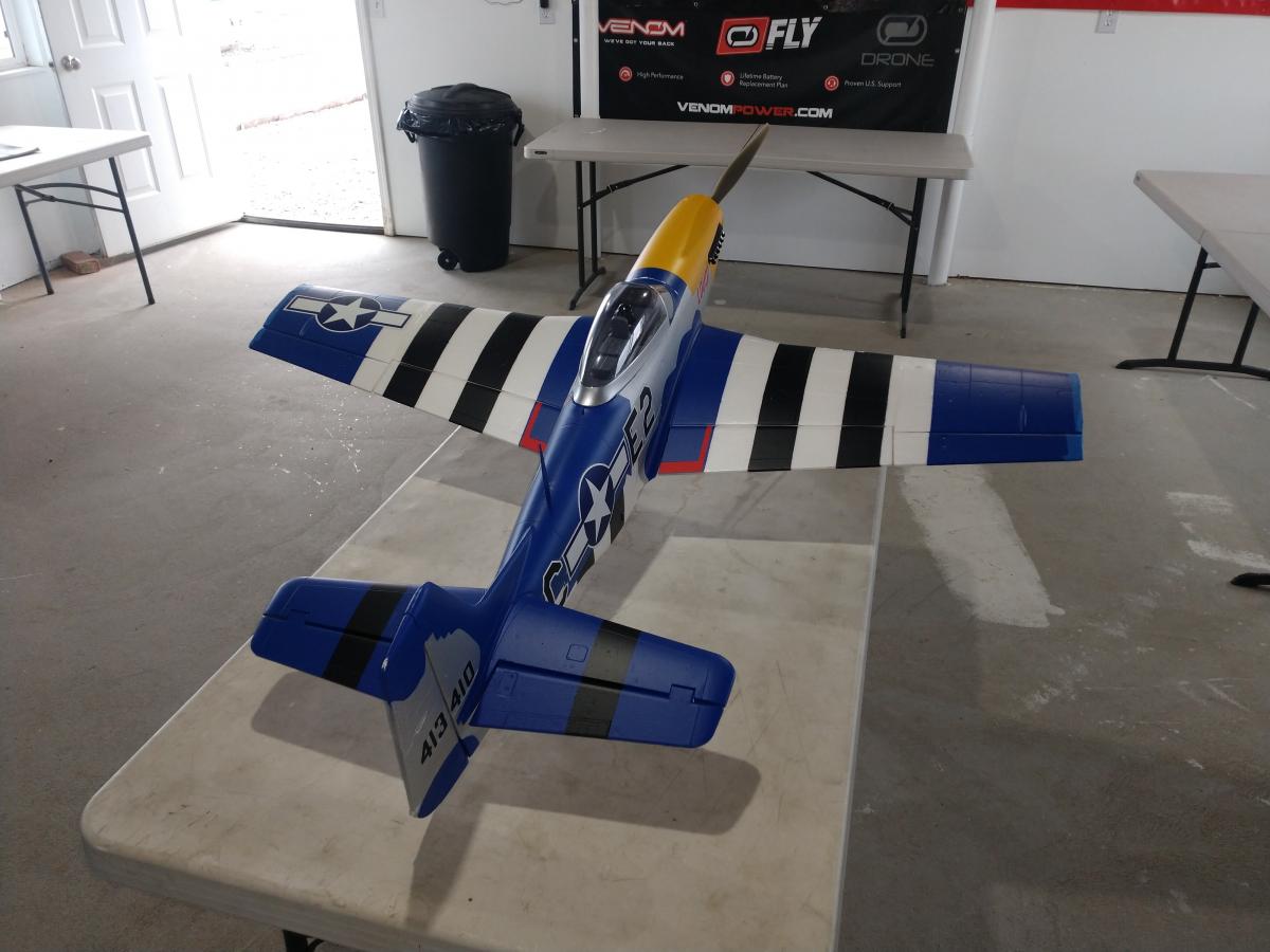

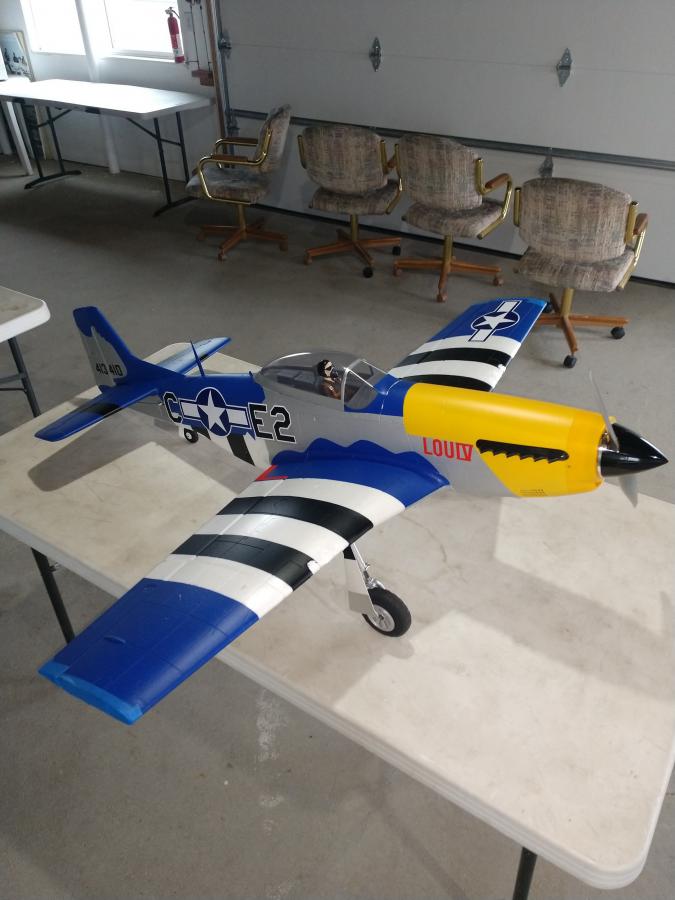

        Gave the new clipped wing mustang a test flight this morning. It flew amazing!!!!! Stability & Overall handling didn't change hardly at all compared to it's stock form. This completely shocked me, but I am super happy how it turned out.
        Here's a few quick pic's from this morning.

        I'll be cleaning up the cuts and smoothing out everything on the plane as much as possible. Then i'll paint it up as the Precious Metal reno air racer p-51.

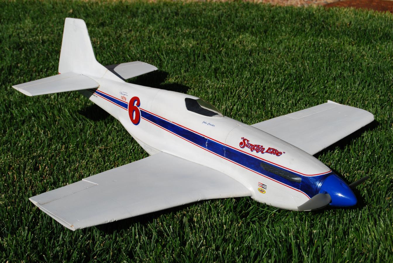

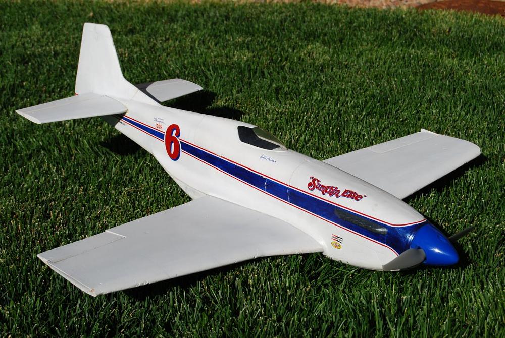

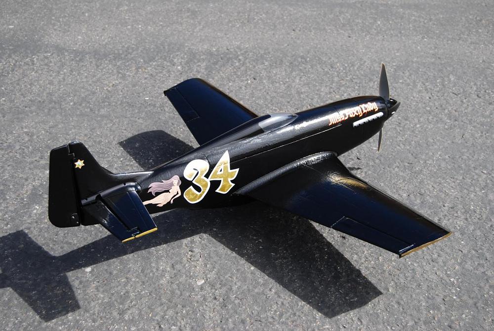

          Years ago, when Parkzone (efl) came out with their 1st Mustang, I put on the whole Reno Air Race competition. We had all the various Mustangs and Corsairs and even converted a T-28 into Rare bear! Clipped wings and Turtledecks. Now that's what I'm talking about! Click image for larger version

          Fly low, fly fast, turn left

              I vacuum-formed it from a mold I made. Then glued it on and spackled the rear to blend with the fuselage. Lastly painted the rear to match. Unfortunately, mine would be a little small for 1.5m. Check for different racing canopies online tho. Sig makes a few, and maybe one would work for you. Look for a long thing one to match your plane. If you go a bit bigger, you can actually trim it down for height and length.

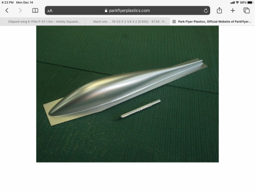

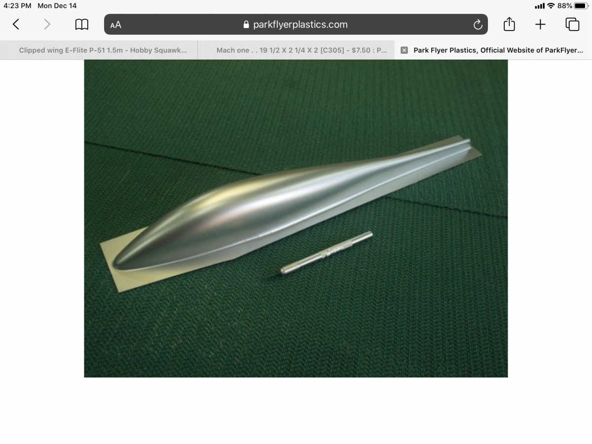

                  I bought a Mach one canopy for my 1400 FMS Mustang but it was lost to a midair with a friendly before I did the mod.
                  now I see Parkflyerplastics has this. https://parkflyerplastics.com/cart/i...roducts_id=850 Click image for larger version

                    That looks pretty good.
                    Thanks for the link and info! It's greatly appreciated.
