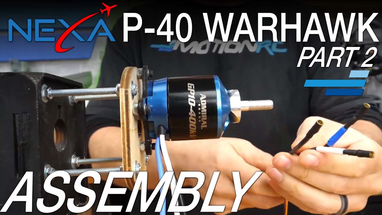

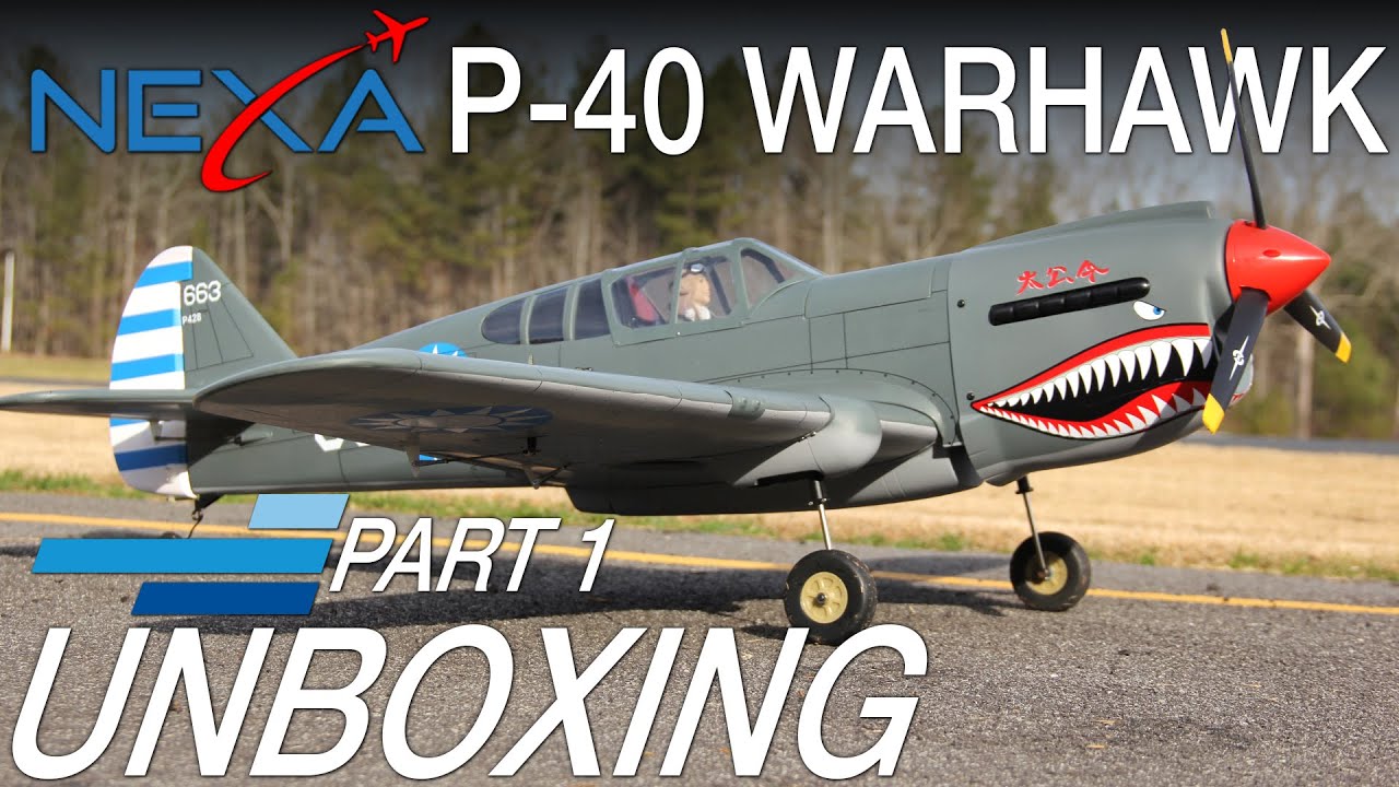

                    Just an update, 2 of our 3 video series on this P-40 are now live. Part 1 is the Unboxing and Spec and Part 2 is the step by step assembly

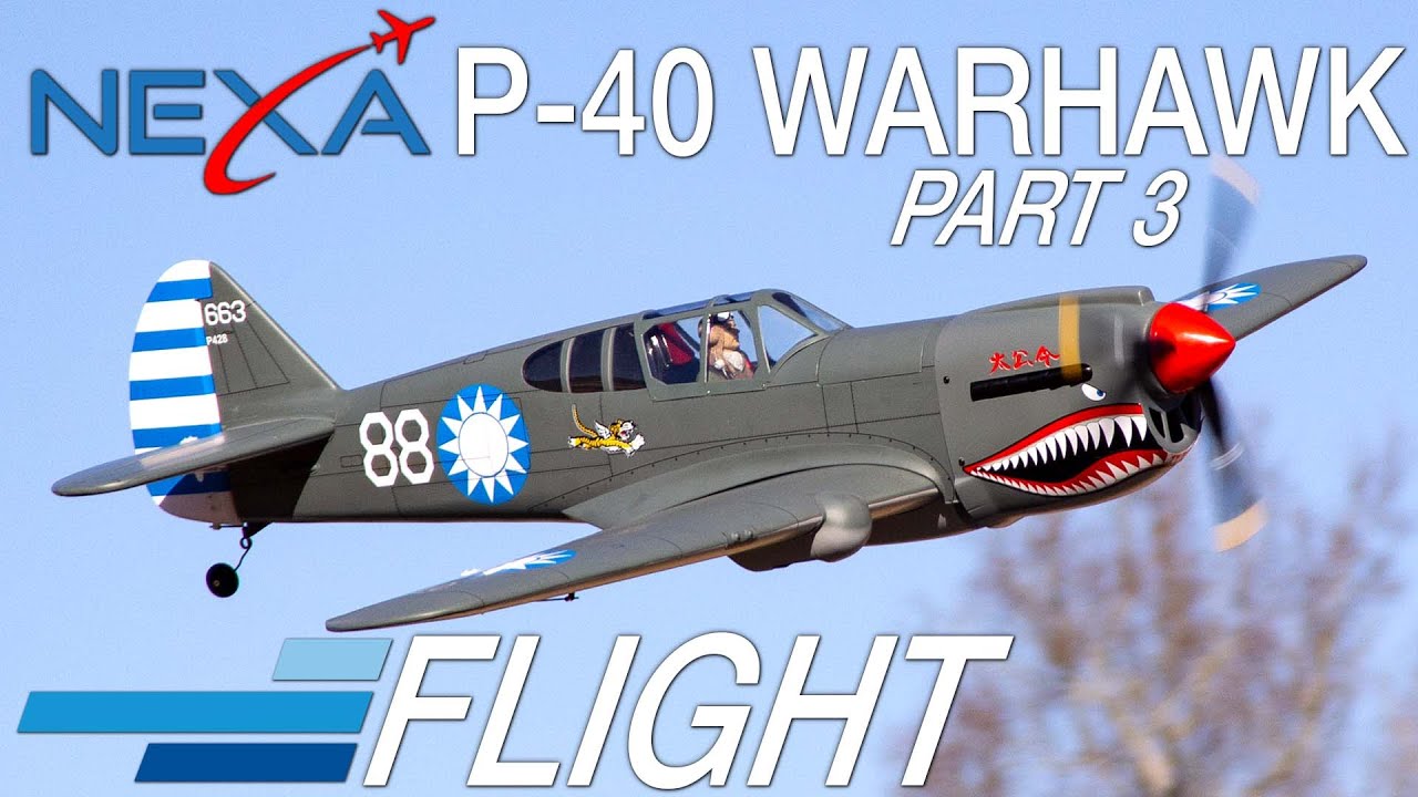

                          Flight video is live:

                            Thanks for posting the videos. I notice the aileron throws you start with are much greater than what the manual states. It states 6mm. I’m thinking that is going to be too little. Any thoughts on that? Thanks
