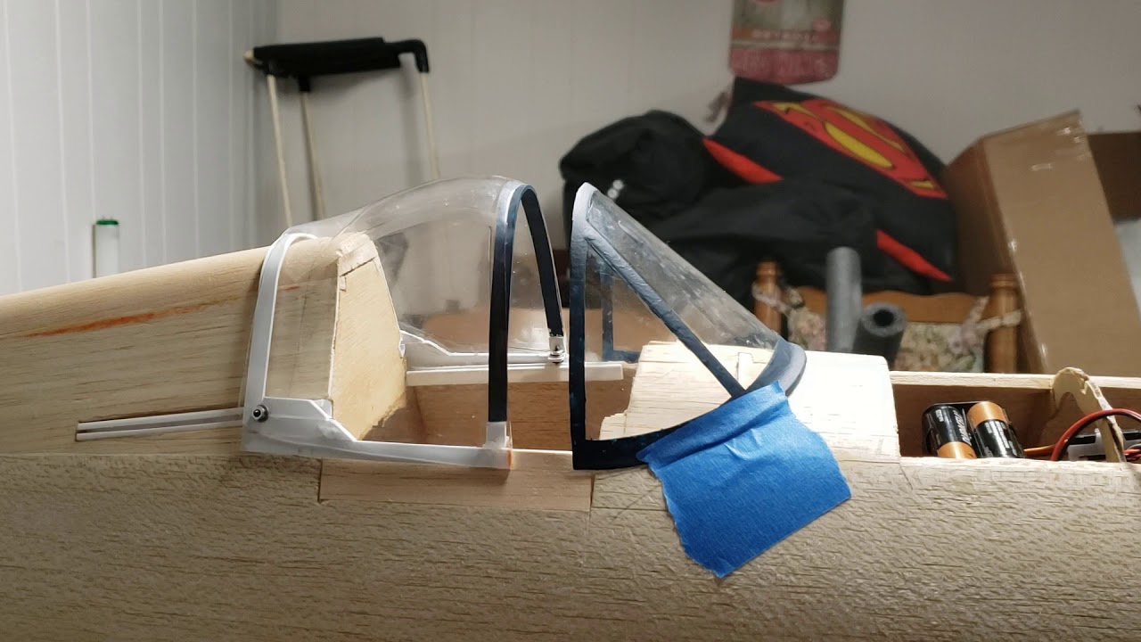

        Aros Here is the link to the sliding canopy.
          • 8202
          Ah man, that is sweet! I was hoping my builder for my 85" ESM Corsair would be able to do the servo-activated sliding canopy like that but for whatever reason he wasn't able so mine is manually activated. Look forward to seeing more videos!

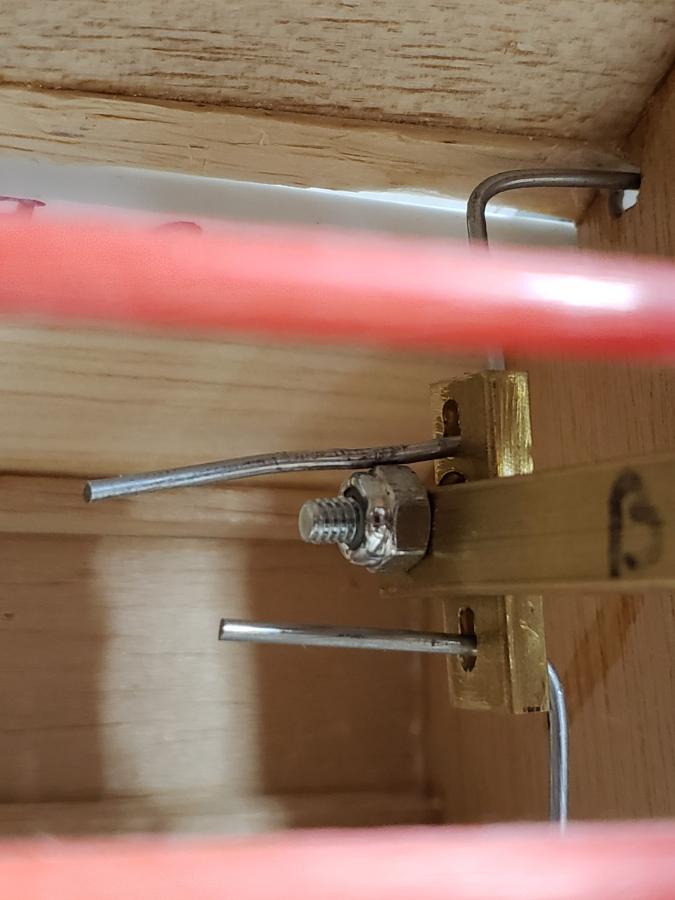

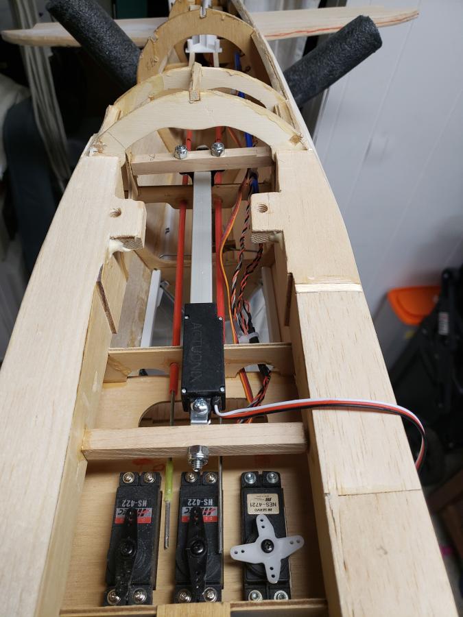

                Aros this sliding canopy using a linear servo that pushes straight backwords. Here are some photos of the assembly.
                  • 8202

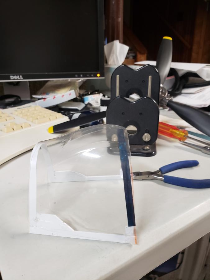

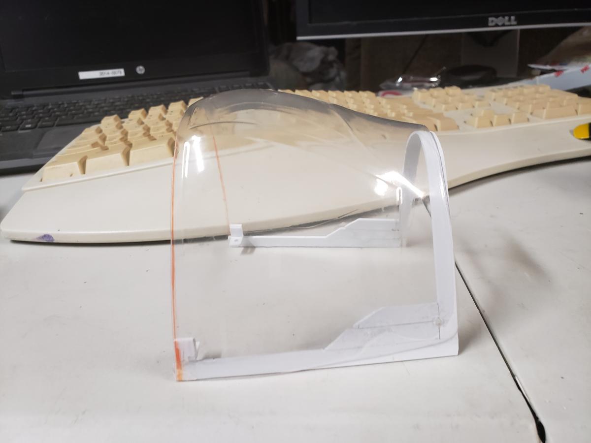

                  CorsairPilot17 Yeah that's what we were looking at for the mechanism. I think there was some kind of block based on re-routing the pushrods to make room for the full depth cockpit but I am not certain on that. Where did you get that canopy? I am in the hunt looking for a better canopy. The ones I have found so far are too flimsy. I need a sturdy canopy for mine. Sorry don't mean to hijack the thread that is about the FL Corsair...
                  • CorsairPilot17
                    • Sep 2020
                    • 16
                    Aros sorry for the long delay in my response, life got in the way. Anyway I used the standard and custom made the skeleton for both the sliding section and front section. With the skeleton it makes the standard canopy stiff enough to handle the pressure of the slide. You can try to make a skeleton out of fiberglass or carbon fiber, I just an not as good at using those materials.
                    I have also used the standard Top Flite cockpit kit, with some additional modifications. I just don't have the cockpit painted and finished. I will show photos when do with it. I used the dashboard from the 3d printed part from the bubble top Flightline mode. I have the dashboard lite up with LEDs.
