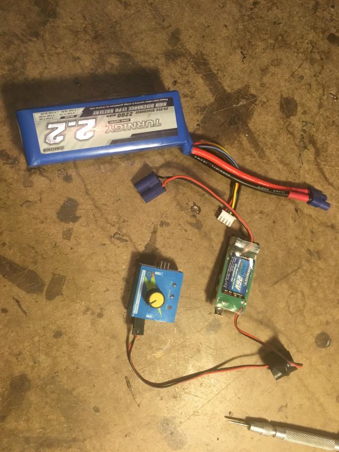

    You don't need to use the balance plug on your battery to tap for power. You can use the main power leads from any 2s or 3a LiPo battery and plug that into an external BEC and from that, plug it into the RX into any unused port or even into a "Y" if you don't have an empty port.
    Here is what I've used in the past with some planes. Note that I'm using this set-up to powering a servo test, but the end that goes into the tester is the same end that goes into your RX. I'm using a 2200mah, 3s LiPo but you can use a 2s or 3s with anything around 1000mah, more or less. The BEC will scale down the voltage to what the RX needs.

      Xviper, Thank you so much for your post! The smallest LiPo I have is 7.4V, 1500mAh, 2S. I bought them by mistake awhile ago. Still holding a storage charge. Will they provide enough power after going through the 5V BEC? No problem now with connections. Nice Christmas present for me!

        That LiPo will work. The BEC needs only 5V, so a 2s battery when fully charged will put out 8.4v. Just monitor the amount of juice it uses for one flight so you know how many flights you can do before you need to charge it back up. Don't let it get below about 3.8v/cell before charging.
