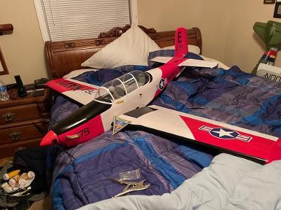

        ive just finished mine but not flown yet Click image for larger version
        • SWOFLY
          • 32
          I finished my T 34 in three days and flew it today. Very pleased with the entire project and the plane flew great. there is a few things I have issues with, first, I used a separate servo for nose gear steering. You can mount it under the battery tray and use a metal rod with a metal clevis attached to the steering bracket and one of the rotating rod connecters on the servo horn for easy adjustments. The other thing I would change is the four bolts used for mounting an electric motor are heavy and it takes quite a bit of adjustment to get the offset correct. I think a plywood box setup would be better. Otherwise this is a good quality model and a nice smooth flying scale looking airplane.

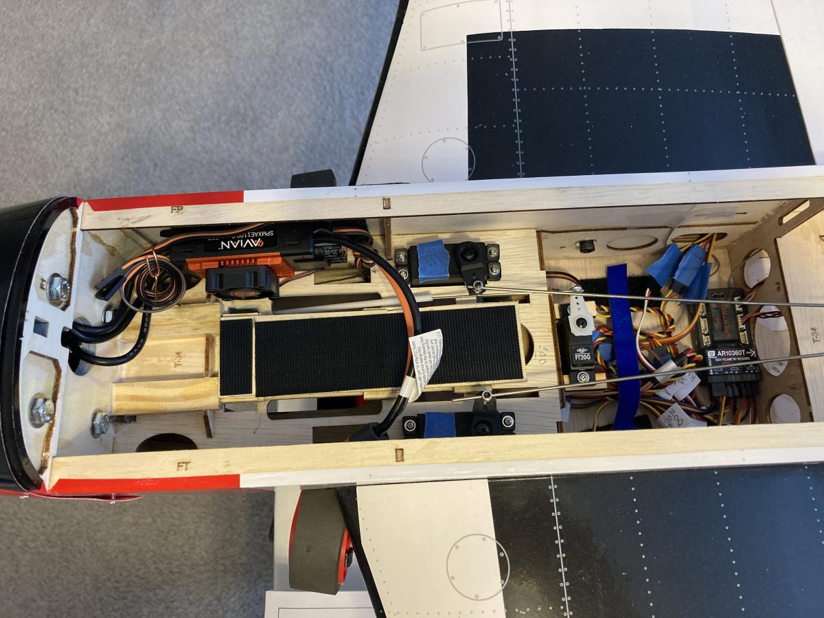

                                Information on my assembly:
                                • Maiden – 2/2/2024
                                • Motor – Cobra 4130/14 450kv
                                • ESC – 100-amp Spektrum Smart ESC (SPMXAE1100) – Overkill but was cheaper and lighter than the Spektum 80 amp)
                                • Prop – MAS 14/7/3 – Static test pulls 57 amps, inflight 53.5Amps
                                • Servos – HS-625MG (4) and HS-85MG (2 for flaps)
                                • Rx – AR10360T with SPM9747 remote
                                • Servos – HS65MG for ailerons, HS125MG for elevator
                                • 6 Minutes on 6S3300
                                Review
                                I am not convinced that I am the best person to review an ARF kit because I am primarily a balsa builder and have only assembled one ARF previously. From my perspective the construction of this ARF is good quality, the hardware provided is good and the instructions are adequate with a couple of exceptions mentioned below. This is not a kit that I would recommend for a first time ARF assembler but should not be a problem for those a bit more experienced. My plane is set up REAFFTG on a 10 channel Rx, with the three extra channels being used for nose wheel steering, thrust reverse and ASX3/SAFE control.
                                • As discussed by others, the primary issue while assembling this ARF is that the steering linkage for the recommended nose gear is on the right side (unchangeable) but the assembly directions assume that it is on the left. Looking at the problem, I saw three possible solutions:
                                o My initial plan was to get a nose retract with steering on the left side. I purchased the Eflight 25-46 Size retract set (EFLG330) for this purpose. I found that the Eflight gear would fit in this model with minor modifications, but the Nexa nose strut does not fit the Eflight nose retract. (The mains do fit.) I decided to save the all-metal Eflight retracts for use in case the lighter plastic Nexa gear fail.
                                o I also looked at the possibility of moving the rudder servo to the right side of the model and putting the elevator on the left. There is adequate access inside to move the linkage tubes, but this would necessitate a shorter rudder servo arm due to limited space between the servo and the side of the model.
                                o I opted for a dedicated nose wheel steering servo as others have done. Mine is located just aft of the joiner tube between the elevator and rudder servos. Instead of using a Y cable with the rudder servo, I put the NWS on its own channel. This allows the nose steering to be trimmed separately from the rudder. The NWS channel is set up with a mix from the rudder that is only active when the landing gear switch is down. This keeps the nose wheel from turning when retracted.
                                • A smaller issue with this kit is in regard to the battery compartment. If retracts are used, the nose wheel raises through the floor of the battery compartment when the gear are retracted. As a result, any battery (or fuel tank) mounted directly to the floor of the battery compartment would interfere with gear retraction. My solution was to build a false floor in the compartment using lite ply.
                                • On my model, there was a lot of paint on the inside of the wing T-nuts, making it very difficult to mount the wings the first time.
                                • As a result of the bevels on the flaps, they will only deploy down on this model. This prevents mixing the ailerons to the flaps for increased role rate. Not a big deal, just FYI.
                                • The recommended servos are a little large for the openings cut in the kit. Easy fix with a file.
                                • I really wish that the plastic pieces for the horizontal stab leading edge extensions were better quality. From a distance they look nice but up close you can see that the edge that is glued to the fuselage is curled and will not sit flush.
