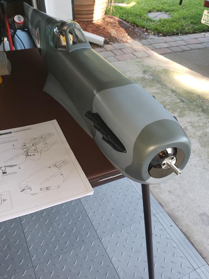

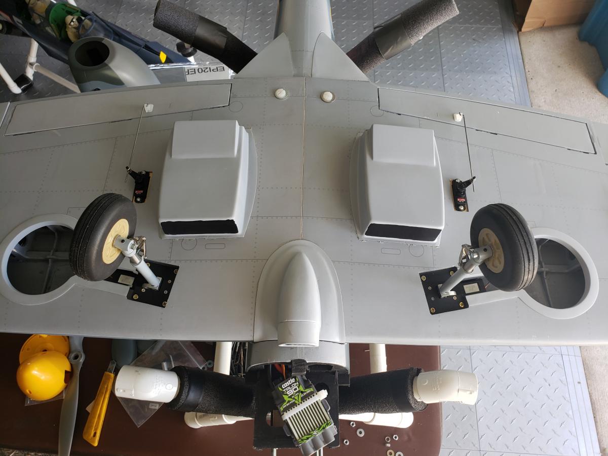

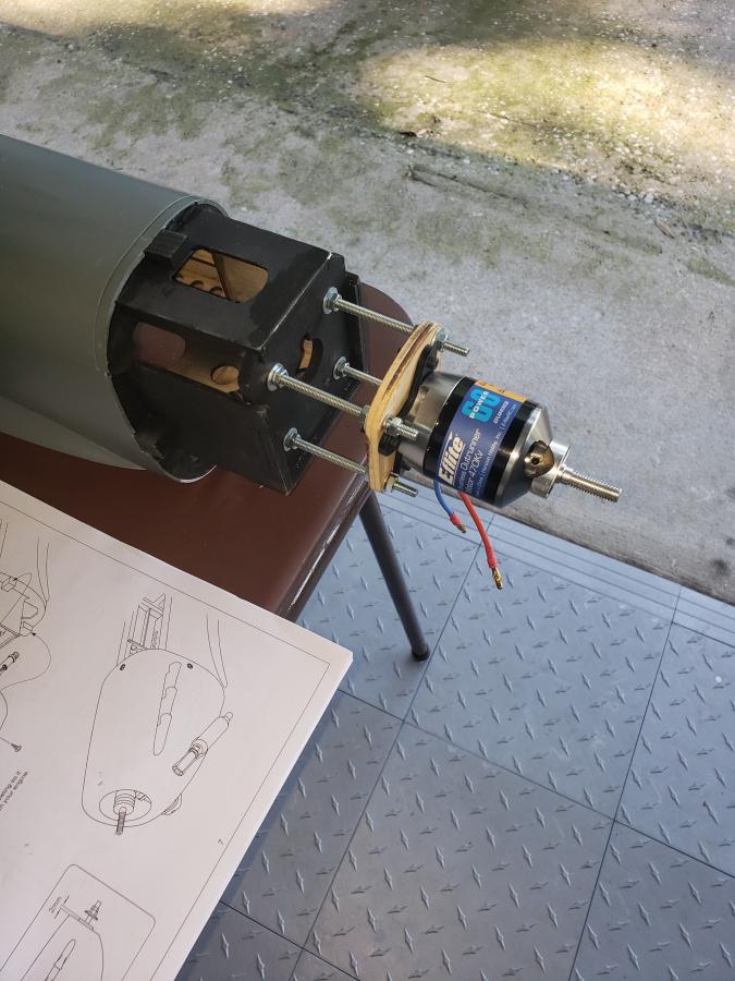

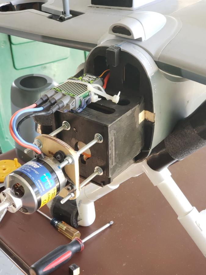

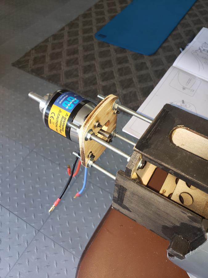

              Greetings, here's an update on progress thus far. I have the motor installed following the mounting directions right from the manual. Very easy, no issues. Kind of an interesting setup using long screws to attach the motor mount to the firewall. One nice thing about that is the ability to easily adjust the motor forward or back to extend just right with the cowl on. Note: Instead of using the plain washers that came with the plane, I'm going to use lock washers along with plenty of Loctite to keep the screws from loosening.
              I will also be spreading some epoxy in the corners and joints all around the firewall just for added strength.
              Click image for larger version  Name:	Motor2a.jpg Views:	0 Size:	85.8 KB ID:	312149Click image for larger version  Name:	Motot 2b.jpg Views:	0 Size:	70.1 KB ID:	312150

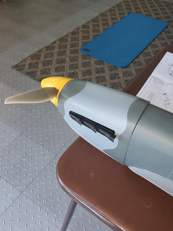

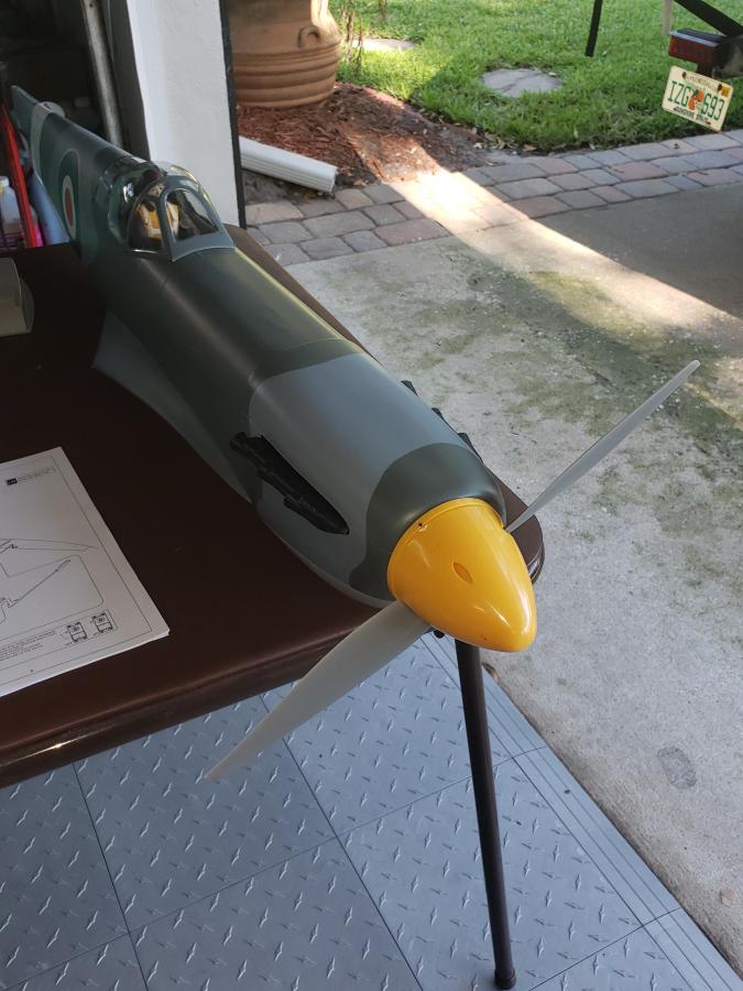

                Here's a look with the cowl, prop and nose cone temporarily in place. I'm showing an APC 16 x 8E prop because that's what I was using on the P51. I may come down to a 15 x 8, we'll see later.

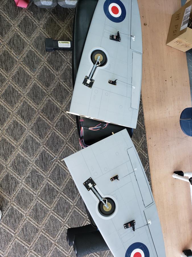

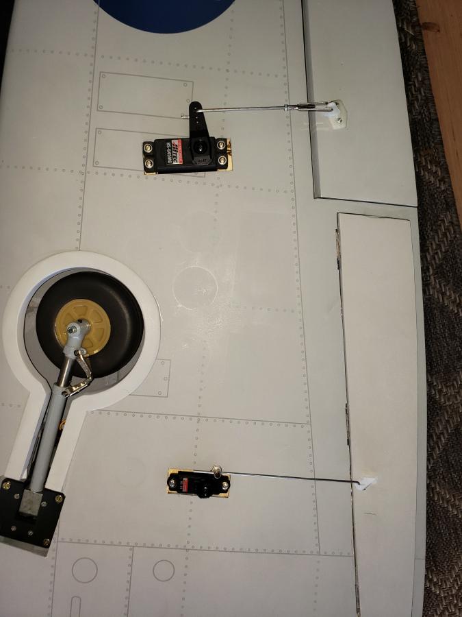

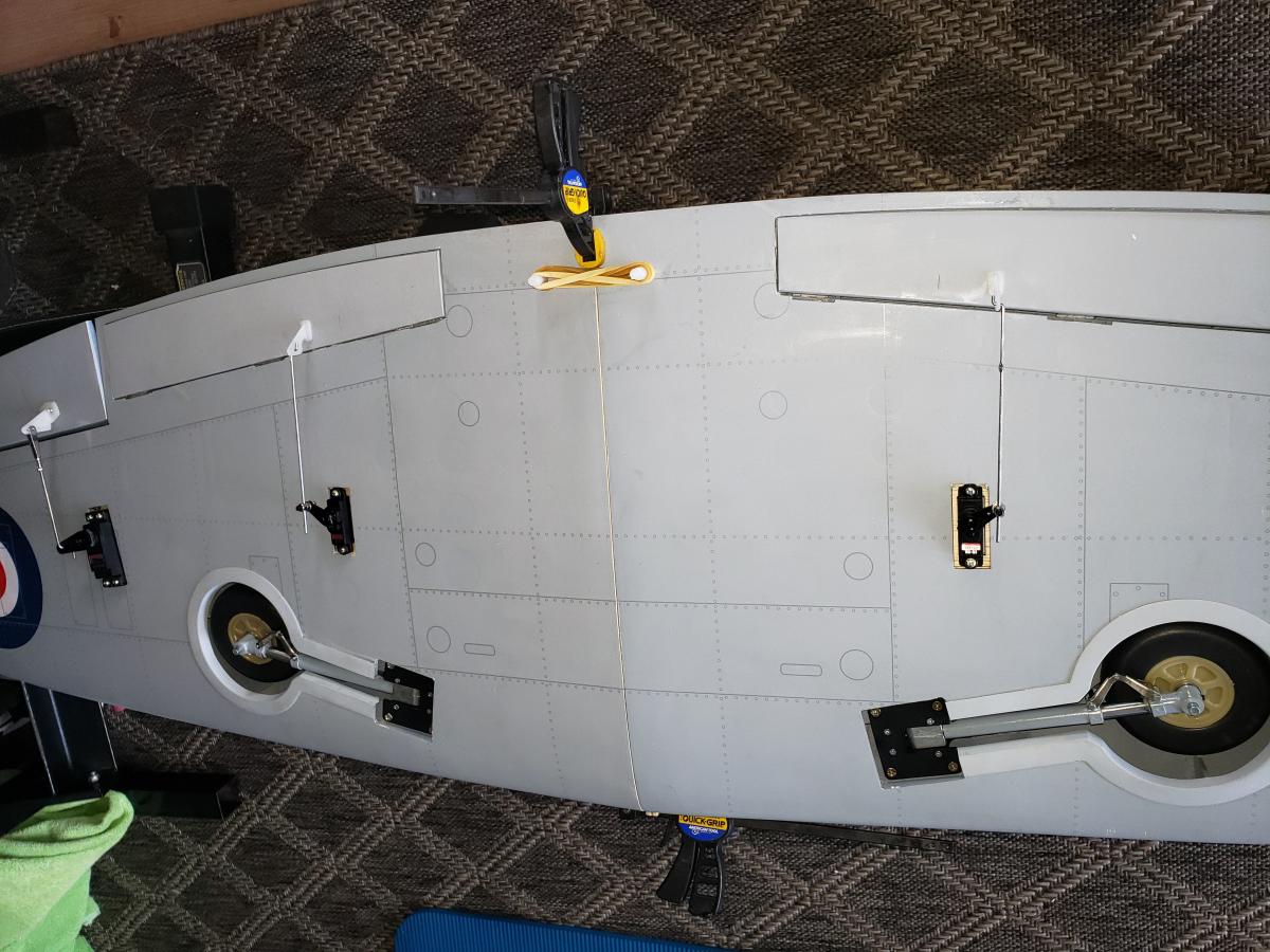

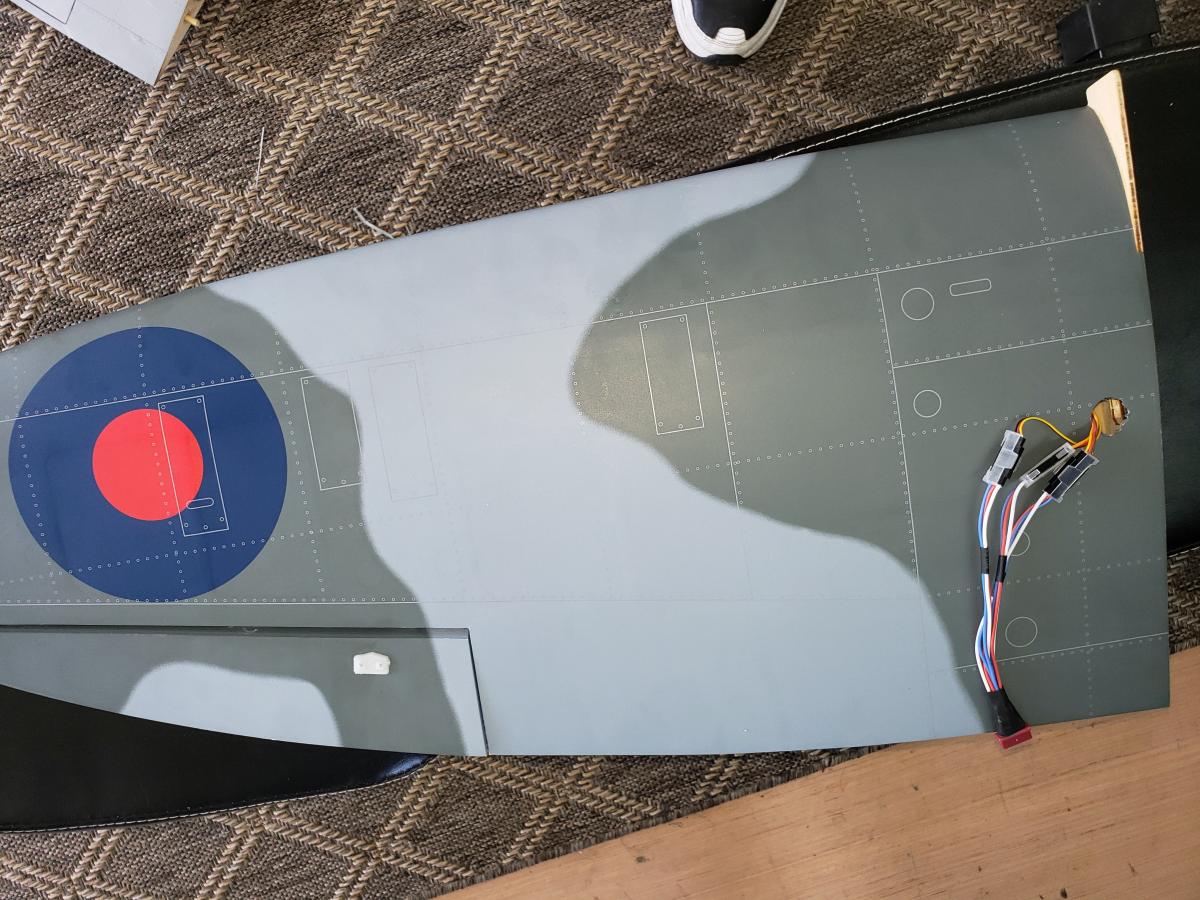

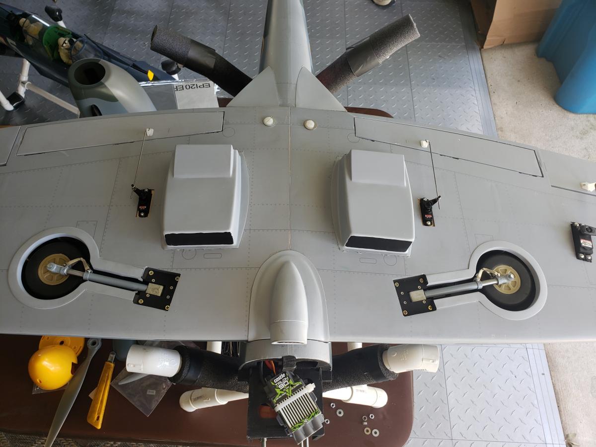

                  I got all the electronics setup on the wings. I'll be joining the wings tonight or tomorrow. I'm using HiTEC HS-81 mini servos for the flaps and HiTEC HS-645MG for the ailerons. I did have to trim open the servo mounting holes just a bit to fit my servos, no big deal.
                  I was happy to see that the hinges for the ailerons and the flaps are already installed. They seem very strong and installed well. Unfortunately I had to install the control horns, the one thing I hate installing more than hinges, is control horns.
                  The flap control horns are a piece of cake. I had to ream out the pre-cut slot in the flap just a bit to get the horn in. I kept it very snug and glued it with medium CA.
                  For the aileron horns your have to drill the screw holes in the flap into to attach the back plate. This is always tricky because you need to carefully align the holes as you're drilling.
                  Note: make sure you don't install the horns too close to the leading edge of the aileron, stay at least 1/2" behind the leading edge where the aileron is not at it's thickest point. If you're too close to the leading edge the screws won't be long enough.
                  To help with wire management I'll be using a 3-way multiplexer so that I'll only have to plug 2 plugs when installing and removing the wing, instead of 6 plugs. You'll notice in the picture, I always use those little plastic extension locks whenever I'm joining servo wires. Better safe than sorry.
                  Note: Instead of using the provide EZ link to connect the aileron push rods to the servo, I went with a "Z" bend.
                  One more thing, there is a little wooden dowel that you have to glue into one of the wings main rib. I have to ream out the hole for the dowel on each wing in order for the dowel to fit. Try to keep it a snug fit.

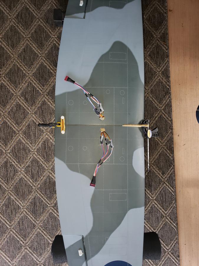

                    I joined the two wing halves using 30 minute epoxy (DONT ATTEMPT THIS WITH 5 MINUTE EPOXY). MAKE SURE you test fit the wing spar on both sides before trying to glue it. I found it to be a very tight fit and also the little dowel was a bit tricky to line up.
                    You can see on the pictures, I used a clamp on both ends of the center section and left those on overnight until the glue was fully hardened. I also screwed the plastic wing nuts halfway through each of the holes and wrapped rubber bands on both sides to keep the trailing edge sung while the glue dried.
                    Tip: Have some rubbing alcohol and a rag handy to wipe off any excess epoxy before it dries.

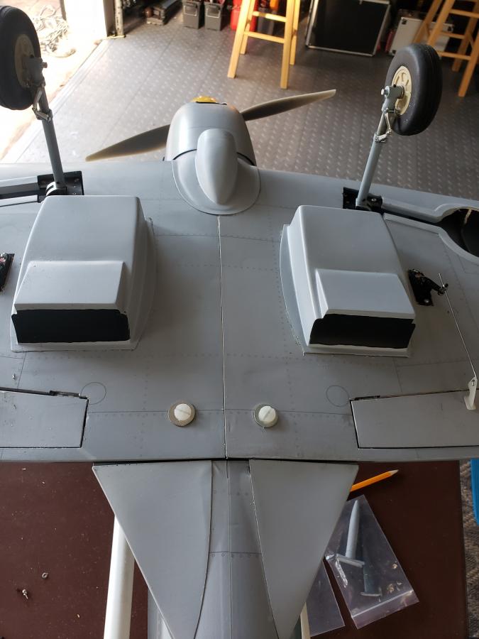

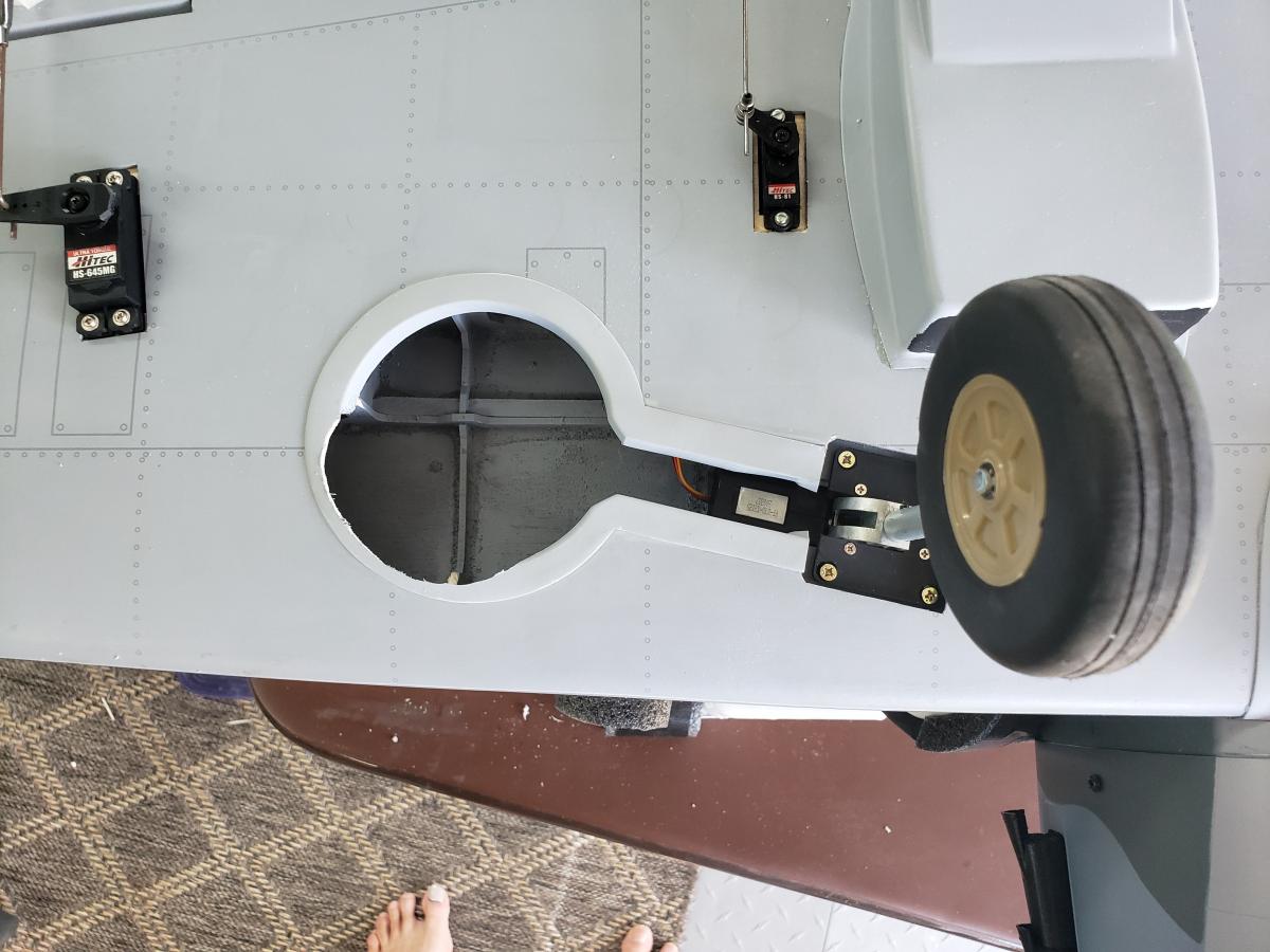

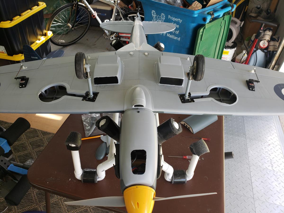

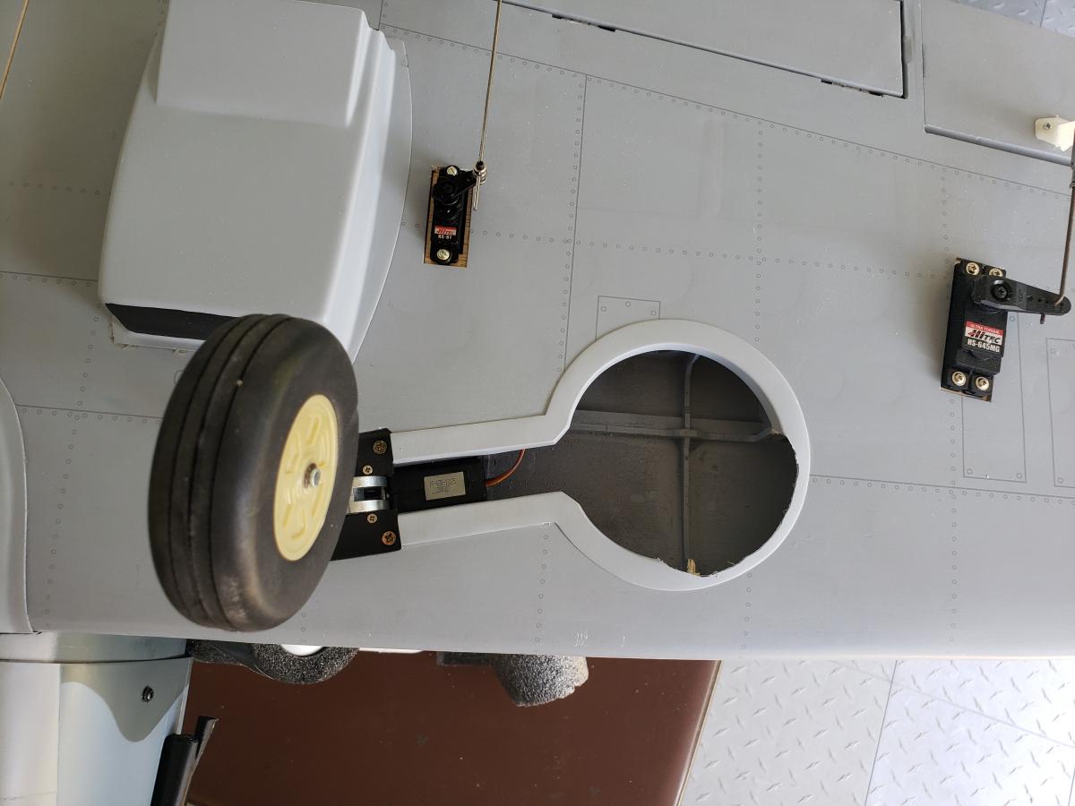

                      Remember in the beginning of this build thread how excited I was to see the landing gear already installed, well I'm not so excited anymore :(
                      You can see on the pics below how the wheel wells angle back toward the trailing edge of the wing, like they're supposed to. However, when you extend the gear the wheels are "toed out" way too much. To correct the problem I had to modify the gear where they connect to the struts and the ream out the wheel wells. This is really disappointing as this has been a decent model up to this point. See the next post for the modifications.
                      Click image for larger version  Name:	Gear 6a.jpg Views:	0 Size:	110.6 KB ID:	312913Click image for larger version  Name:	Gear 6b.jpg Views:	0 Size:	113.2 KB ID:	312914Click image for larger version  Name:	Gear 6c.jpg Views:	0 Size:	166.3 KB ID:	312915
                      • cjordan
                        Chris Jordan
                        • Dec 2017
                        • 29
                        • Maitland, Florida
                        To correct the wheel alignment issue I had to remove the struts from the landing gear and file flat spots on both sides of the gear post for the two grub screws on the struts.
                        You want a little, REPEAT a little Toe In on the landing gear wheels.
                        Once you get the angle of the wheels corrected with a little Toe In, they will not retract back into the wheel wells correctly. As you can see from the pics below, I had to ream out the wheel wells a bit with my Dremel tool. Ouch that hurt!
                        You'll also notice I cut a cooling hole in the bottom of the cowl. You definitely need a cooling hole!

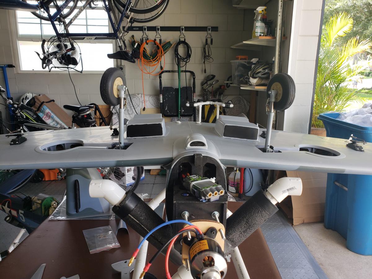

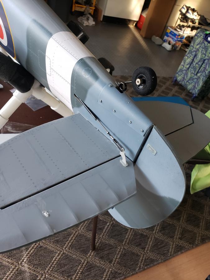

                          The wing bolts were a bit tricky to line up initially, I had to ream out the bolt holes on the wing a bit to make it work. I added washers on the wing bolts, just in case.
                          The tail wheel was very difficult to get installed. It was really hard getting the tail wheel landing gear pushed into the mount. Be patient, it will go eventually. You can also see how I used the little screws for the tail gear cover, no glue.
                          The plane weighs in at 9.5 pounds fully loaded. I'm using a 6S 6000 battery pushed all the way to the front.

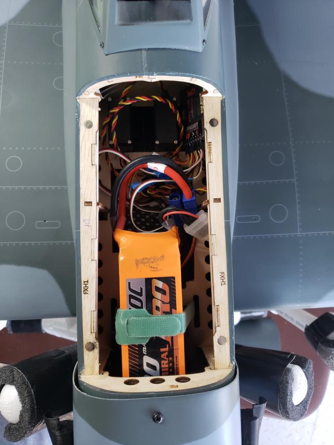

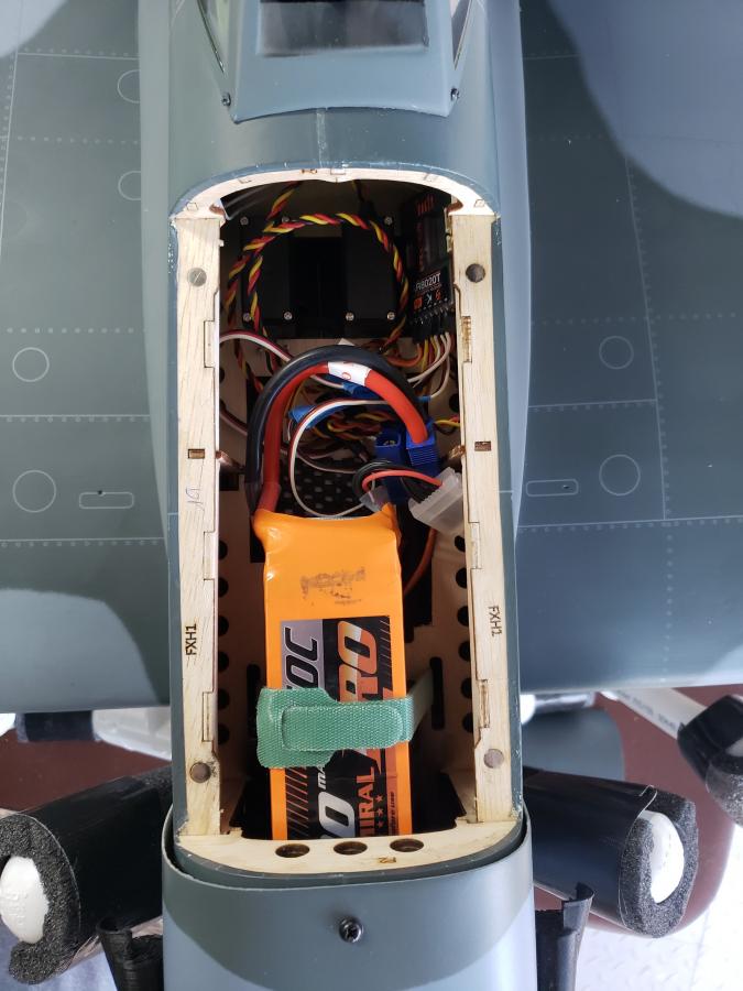

                            Alas! She's ready to maiden. I'm going to do the maiden flights first then come back and install the details like the guns, antenna, strut covers and decals.
                            It was tricky getting the motor at the right distance from the firewall and straight to line up with the cowl. Just be patient and use baby steps.
                            With the 6S 6000 battery pushed all the way to the front I get a perfect balance using the 95mm CG point as recommended in the manual.
                            I test drove her in the street in front of my house and tested the power. Holy Cow, she has tremendous power!

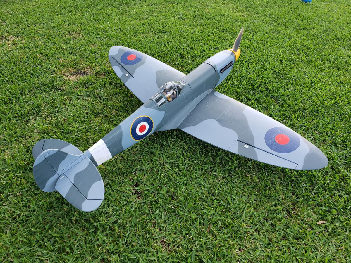

                              Completed the maiden today. SUCCESS!!!
                              As suspected, this plane and this setup has way more power than needed. I was surprise to see how well it tracked on our grass field. No problem keeping her straight.
                              I took off with no flaps and 50% power. It was in the air quickly. I only needed a few clicks of down elevator and a few clicks of right aileron and she was cruising.
                              As mentioned earlier, I'm using an APC 16x8E prop, but I'm definitely going to try a 15x8 and/or 15x10.
                              She fly great! Very stable like she's on rails. Inverted flight was perfect, so I know I have the CG right.
                              The landing flaps were perfect, no need for dialing in elevator and she really slows down well.
                              I had no issues with the landing and was able to taxi back just fine on the grass runway.
                              In summary, this is a solid plane. It feels light, 9.5lbs, when handling it on the ground, but in the air you feel the difference compared to a foamy. It flies really well.
                              If it weren't for the cheap landing gear and the issue with the wheel well alignment, I'd give this plane a 9.5. But unfortunately the landing gear issue puts it at a 7 for me.

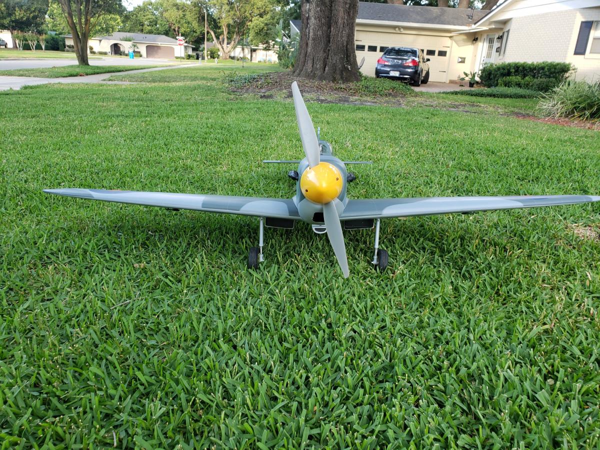

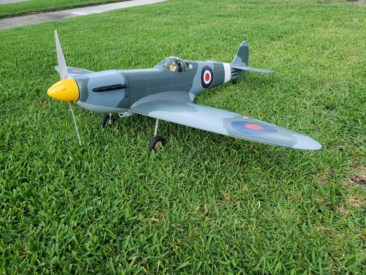

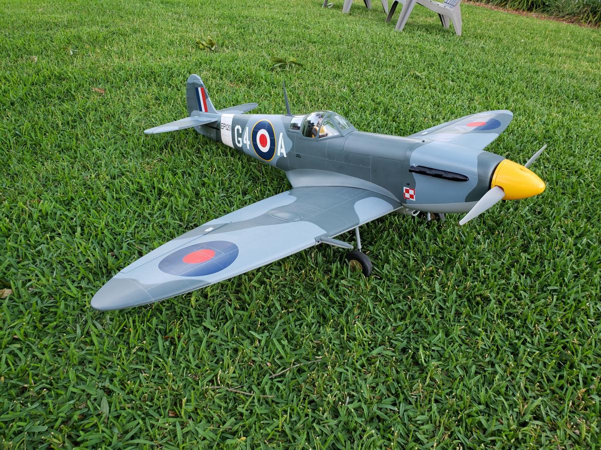

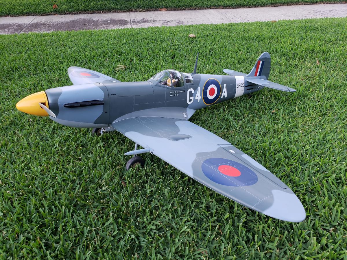

                                  #17
                                  Well here's the finished product. The letters on the side are actually left over Callie Graphics from another project. The decals that came with the plane we not good.
                                  I'm also disappointed with the small details like the guns and the antenna. Obviously these were made from a 3D printer, you can tell. And they want you to simply glue them on.
                                  I decided to screw them in but I don't expect them to last long.
                                  Forget about trying to use the strut covers. Because of the way the gear are angled, as described in my earlier post, the strut covers simply won't work. Very disappointing.
                                  In the end, the plane still looks cool in the air and flies great. Just don't look too closely.

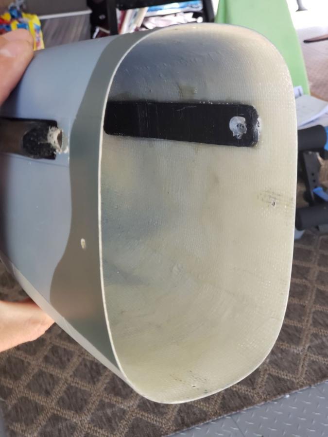

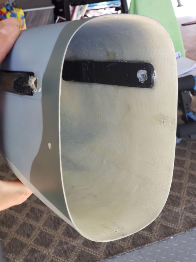

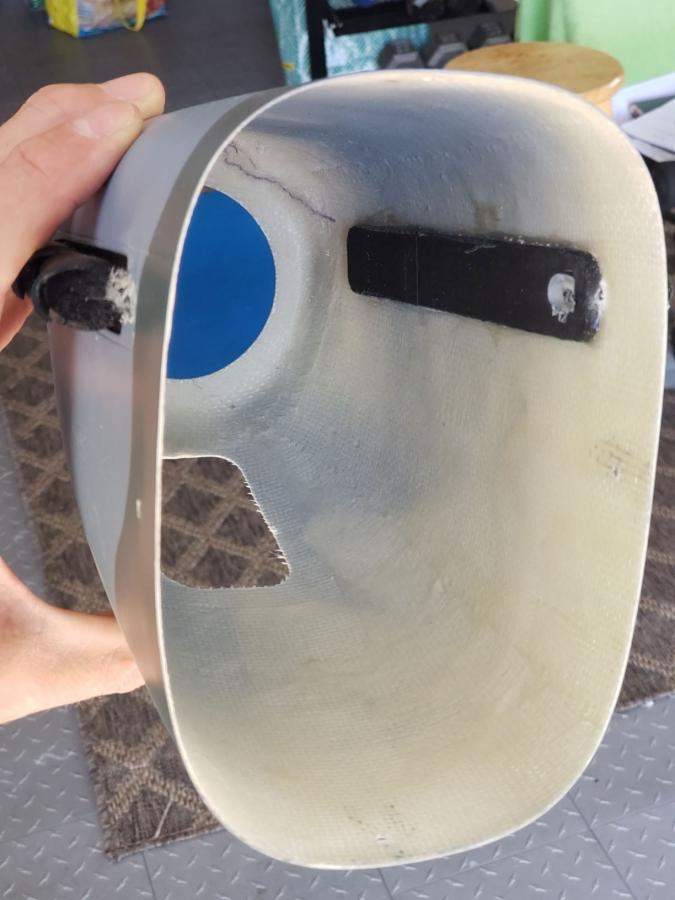

                                    In addition to the cooling hole I cut in the bottom of the cowl, I decided to drill a couple angled holes at the rear of the faux exhaust stacks to allow more air to flow through. I found the motor to be pretty hot after a flight.
                                    Also, during the maiden flight the right and left side cowl mounting blocks both came off the fire wall. I glued them back on with epoxy.
