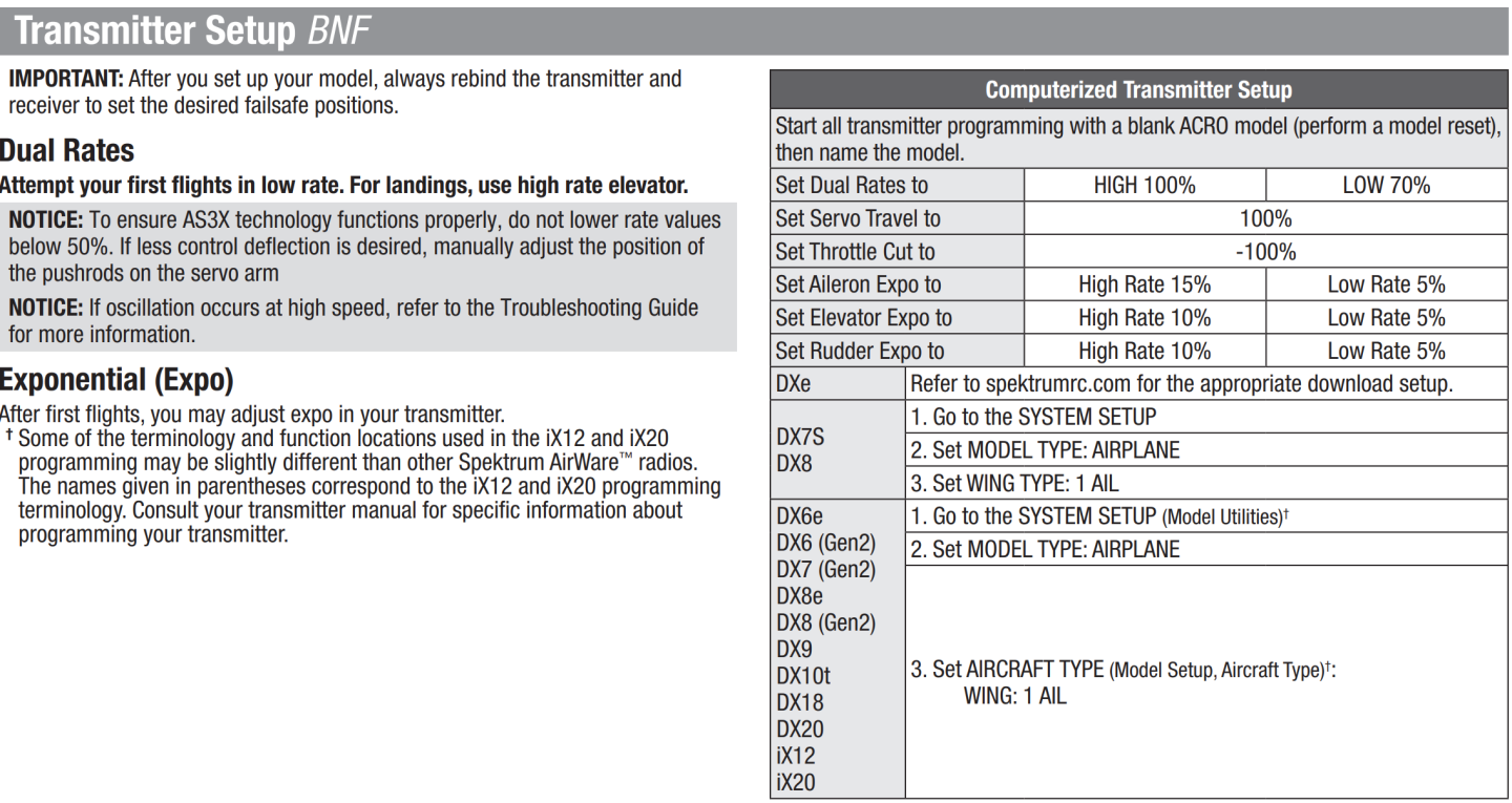

              I have the 1.1m T-28. When I get home, I’ll post a picture of the setup table from the manual.
              • rdvanput
                • Jan 2026
                • 8
                The first picture is my manual’s title page. The second picture is the transmitter setup chart, with the highlighted channel in question.

                  That's interesting and odd. Here is page 7 of the manual I downloaded from Horizon Hobby for your plane. As you can see, the part about reversing the gear channel is missing from my download.
Name:	Screenshot 2026-02-03 232104.png
                  However, not to worry, same applies in this plane. Since the plane doesn't have gear (retracts), they are using that channel for SAFE on/off. On my downloaded manual, page 10, it also goes on to show you how to select a switch, which you may still have to do. Reversing mearly allows SAFE to be ON or OFF in the positions they think is most user friendly. It really doesn't matter which position does what so long as you know what they are. You can simplify by assigning a voice announcement IF your TX has such a feature. On planes that have retracts, you would NOT use the gear channel.
