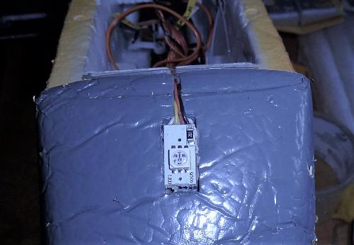

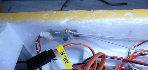

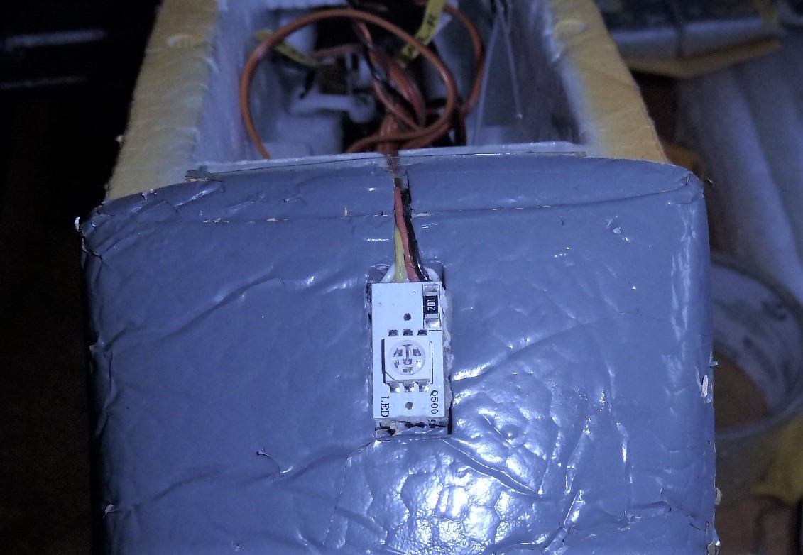

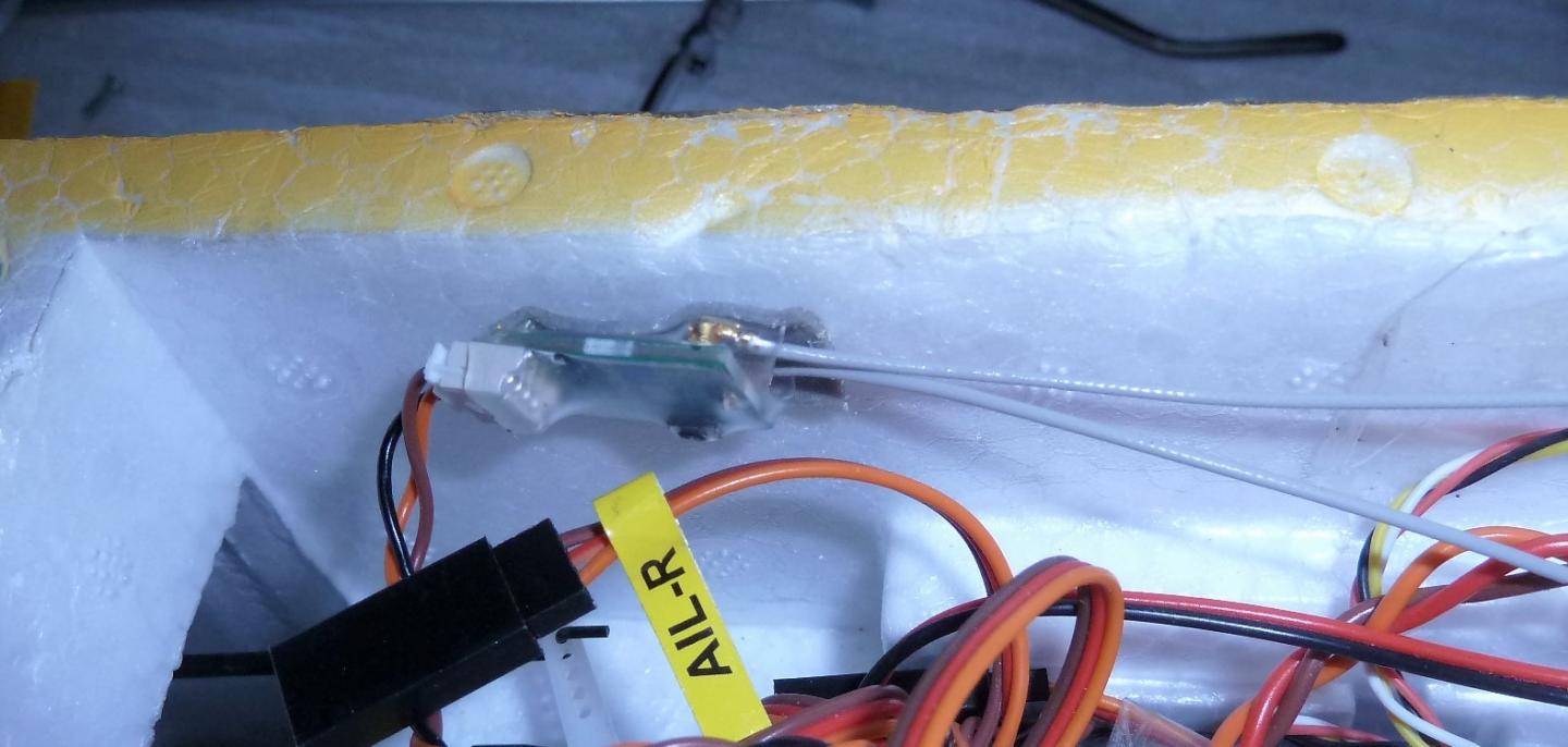

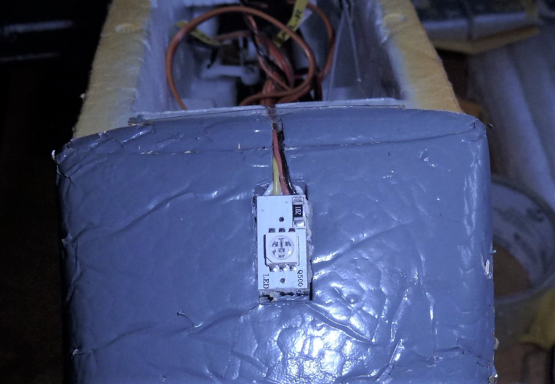

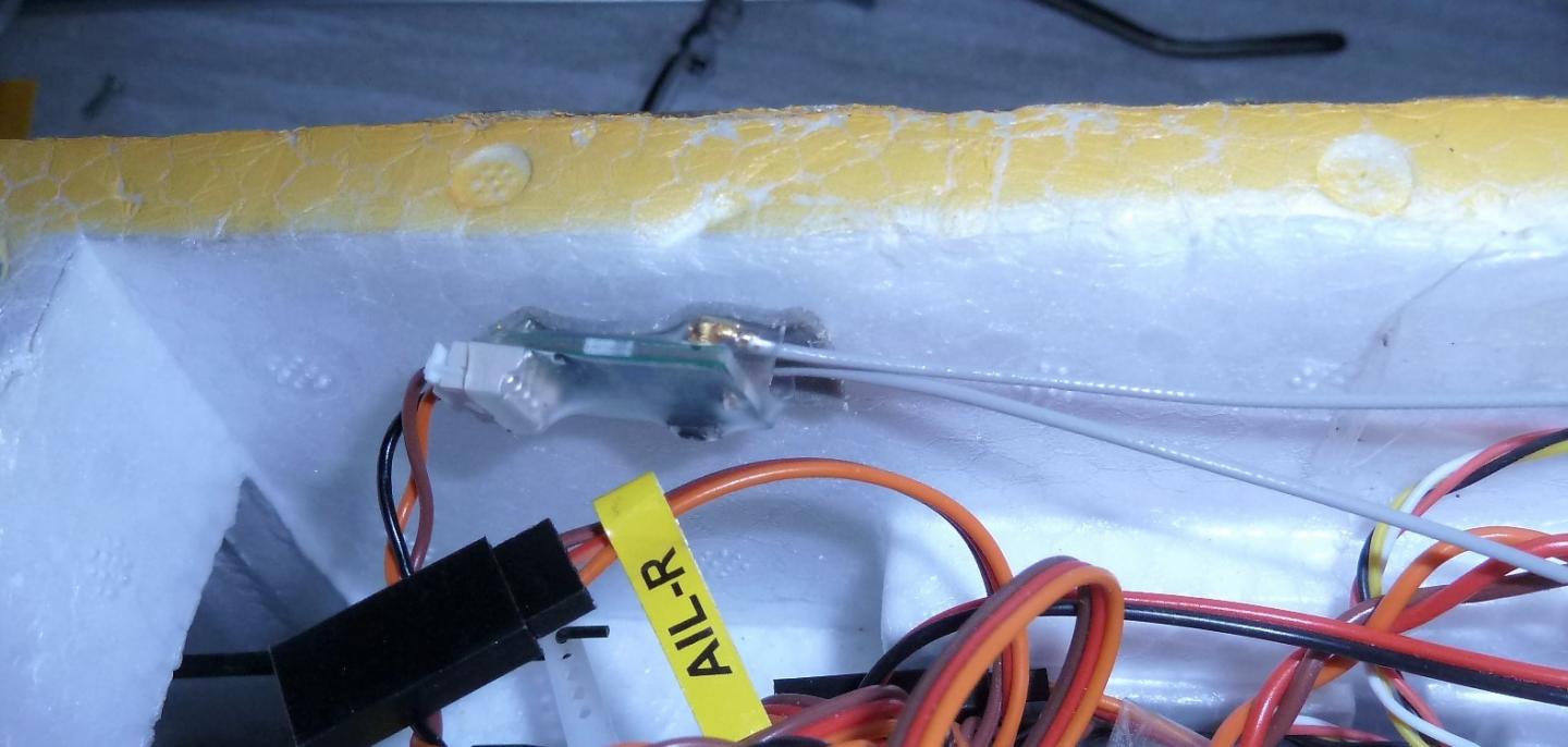

            Thanks to all that have responded, but I'm not sure you understand my question. Perhaps my question should be: What is the red/green light module imbedded in the windshield and the small module taped to the inside of the cabin of the HZ Carbon Cub? If I understand what the reply's say, these 2 items are not required for the SAFE system to work.
            It seems to me that I should be able to take all the electronics that are used in the Carbon Cub and install them in any other airplane of the same approx. size and weight, use the same TXM and fly the new plane using the SAFE system. I know I can replace individual electrical parts in the present plane as needed. The only thing that apparently is unavailable is the 2 modules mentioned above.

                      FYI only. Click image for larger version
ID:	324874Click image for larger version
ID:	324875 Here's a couple of pics.
