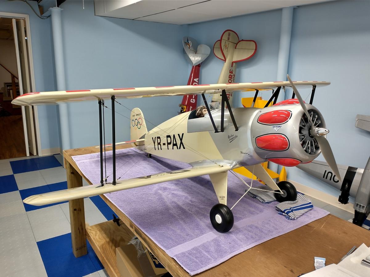

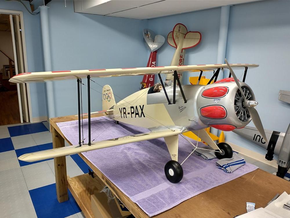

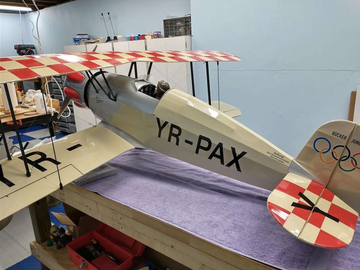

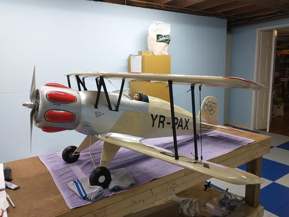

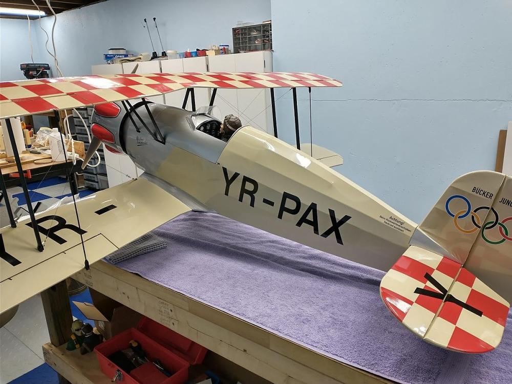

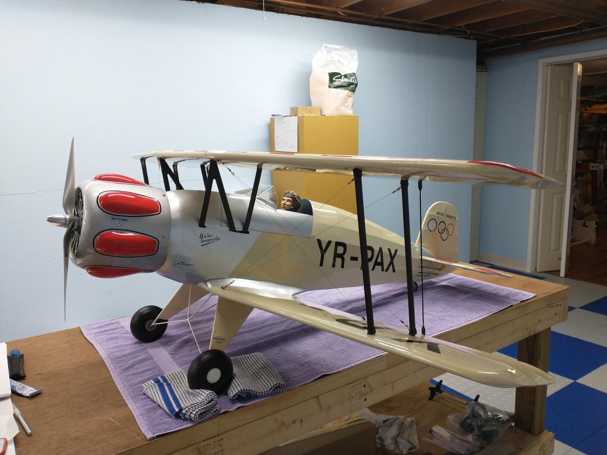

    Just finished up a 1/4 scale Bucker Jungmeister. It's the scheme flown in the 1936 Olympics by Alex Papana. It was the first full scale "purpose built" aerobatic biplane.
    It's a Seagull ARF found new, unbuilt from 2015. All graphics were done by Callie.
    Powered by a Power 110 on 8S, spinning an APC 18x10 prop.

      There are several mods to the original. The struts are K&S airfoiled aluminum. DuBro 1/4 scale cub wheels. Custom pilot. Hidden hatch latch and more.
