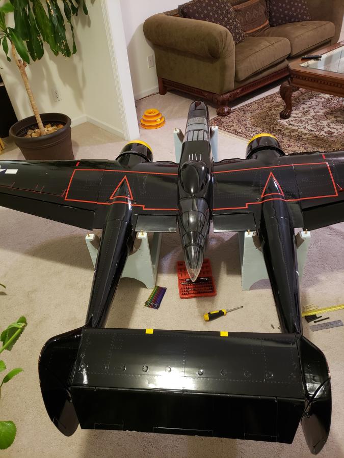

    Hello there! Calling all Experts!

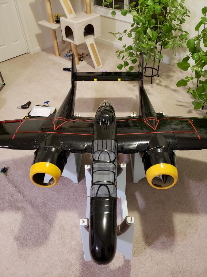

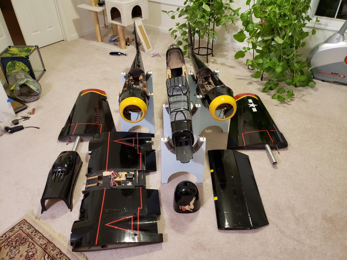

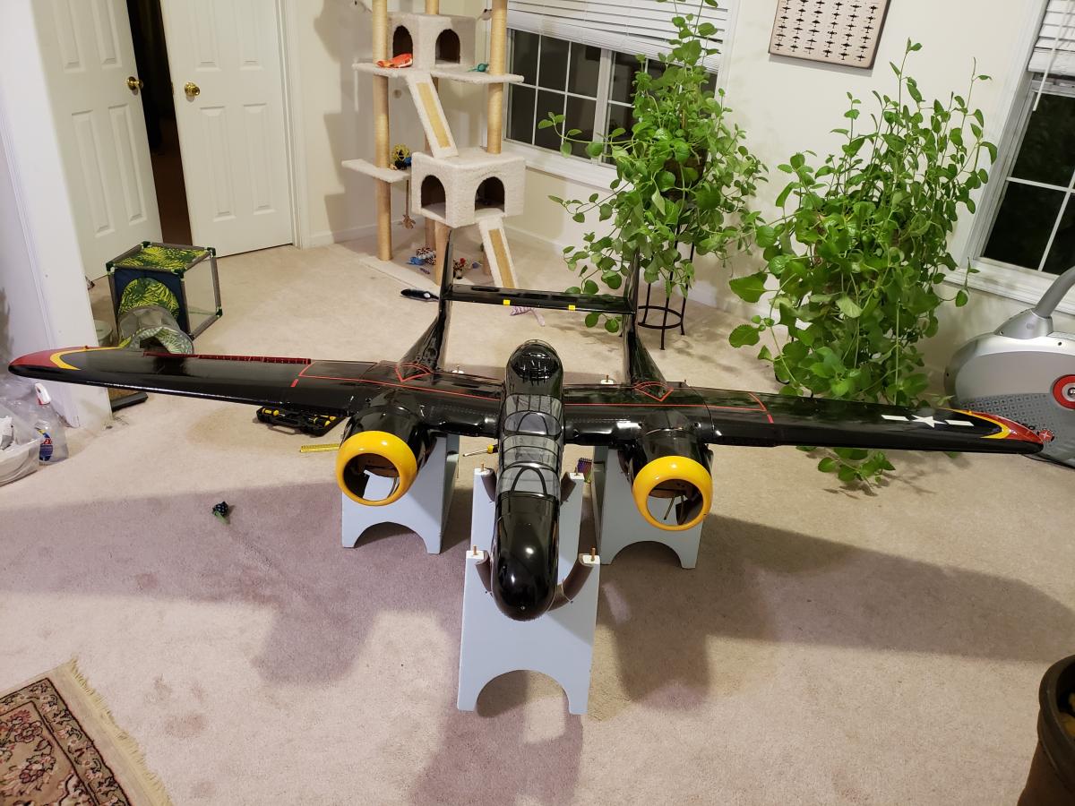

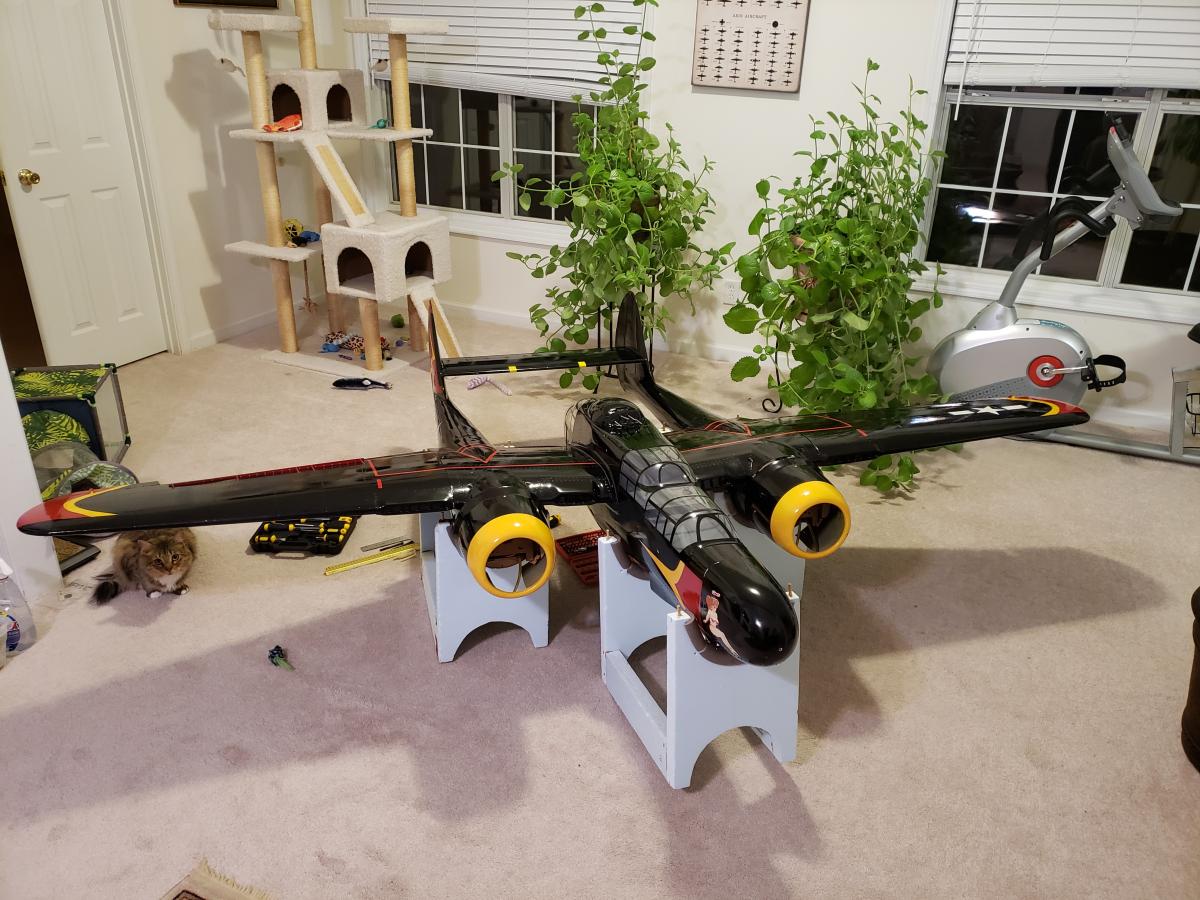

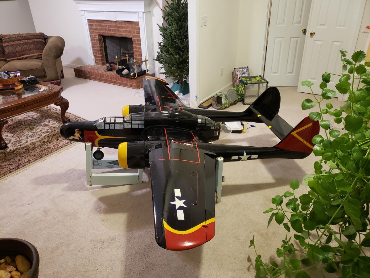

    So I've acquired this at a swap meet. If you know who built it, please don't mention names publicly. It was love at first site and love blinded me. I'm trying to transition from H9, Saito 1.0 sized warbirds to giant scale....so I bought this :) I'm considering selling it versus fixing it, or trading it for a more RTF WWII Giant Scale fighter, i.e.; Spitfire, Zero, FW-190, MIG-3, P-38, P-40 a different P-61...maybe a Jug if priced low enough. It would be ideal if they just needed livery before flight. I have lots of questions and concerns. They call it growing "pains" for a reason :)

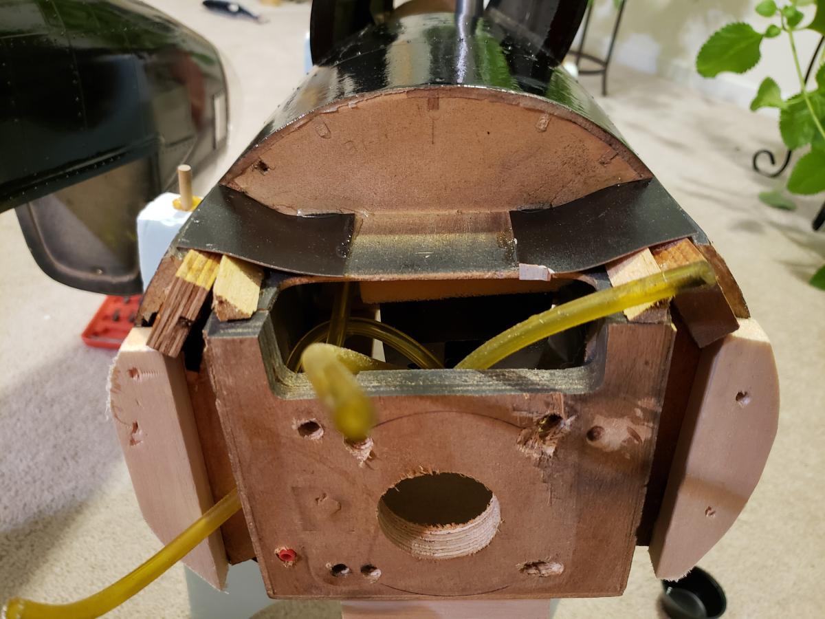

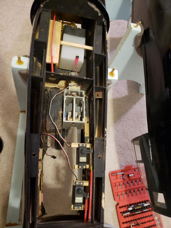

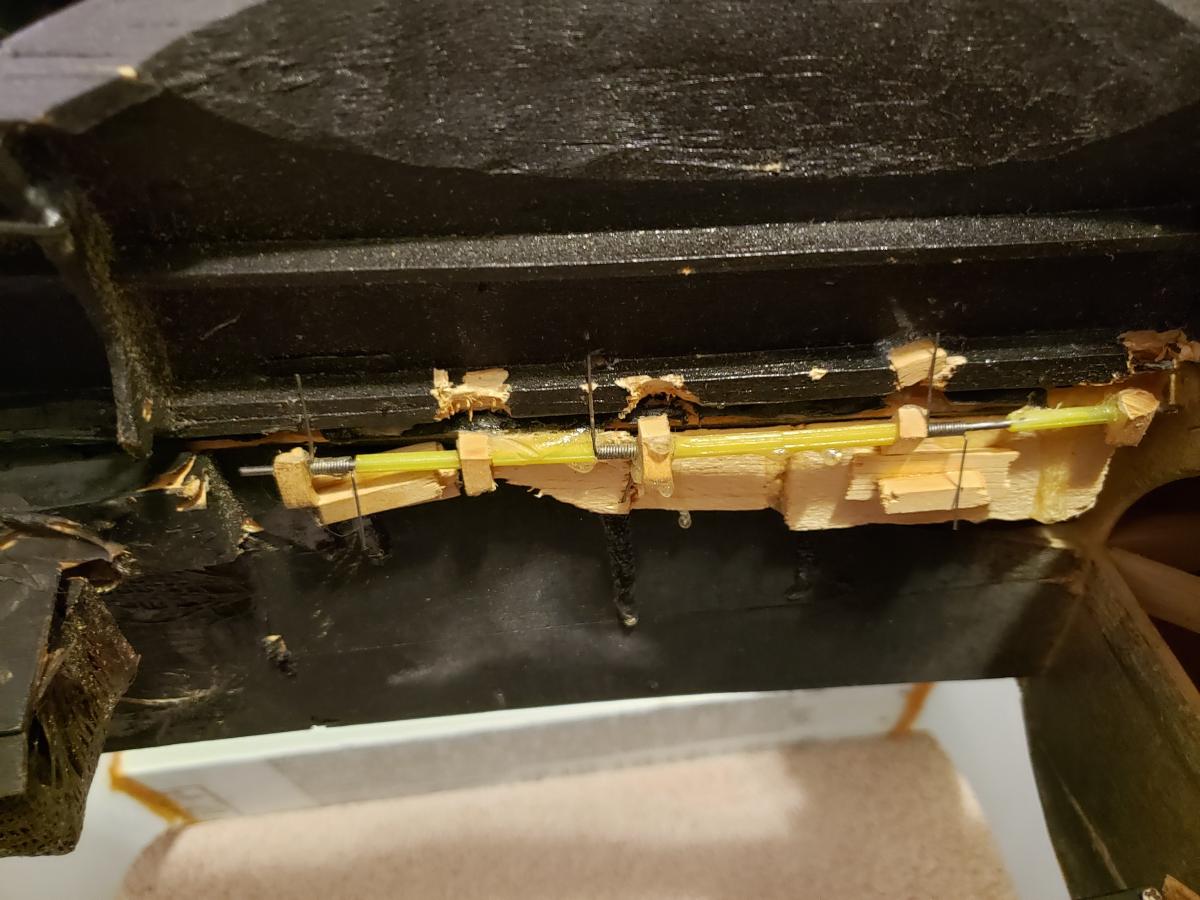

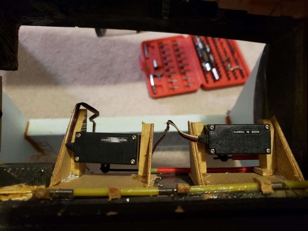

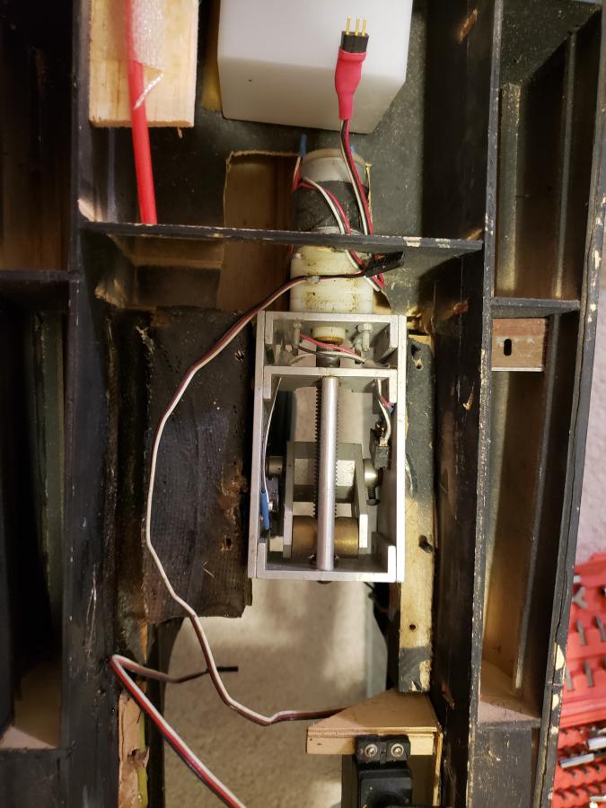

    1. I see concerns about the build

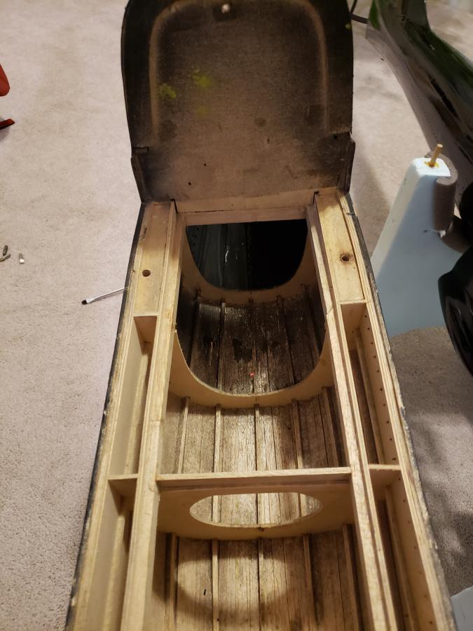

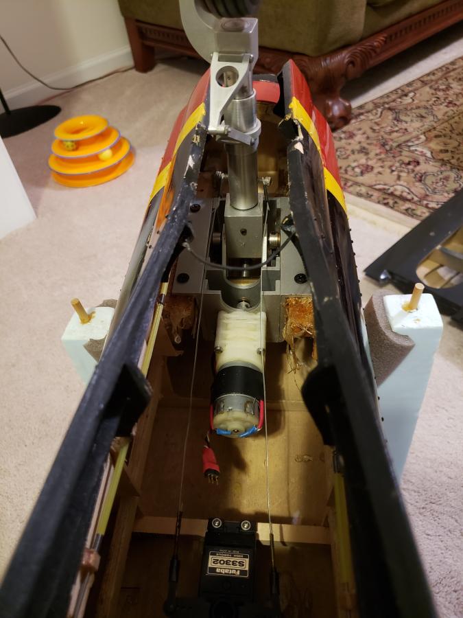

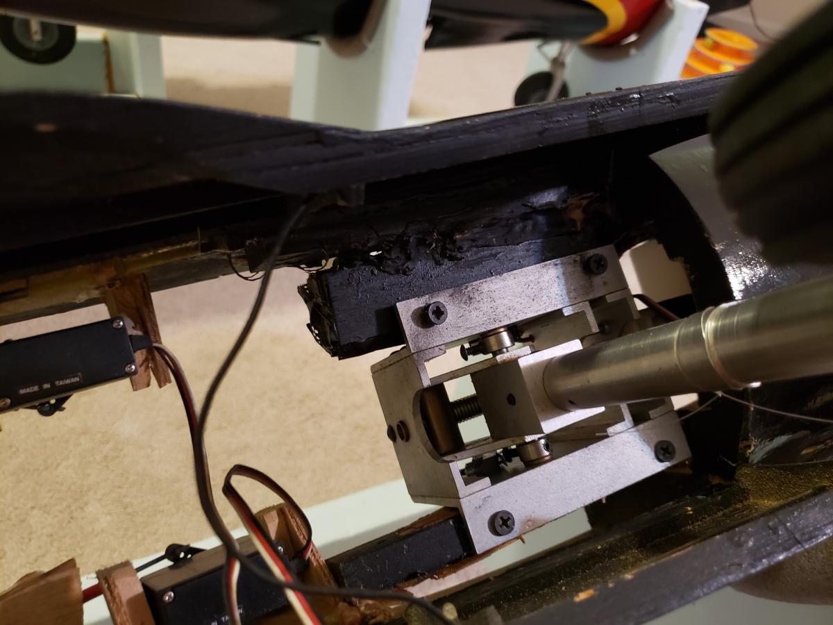

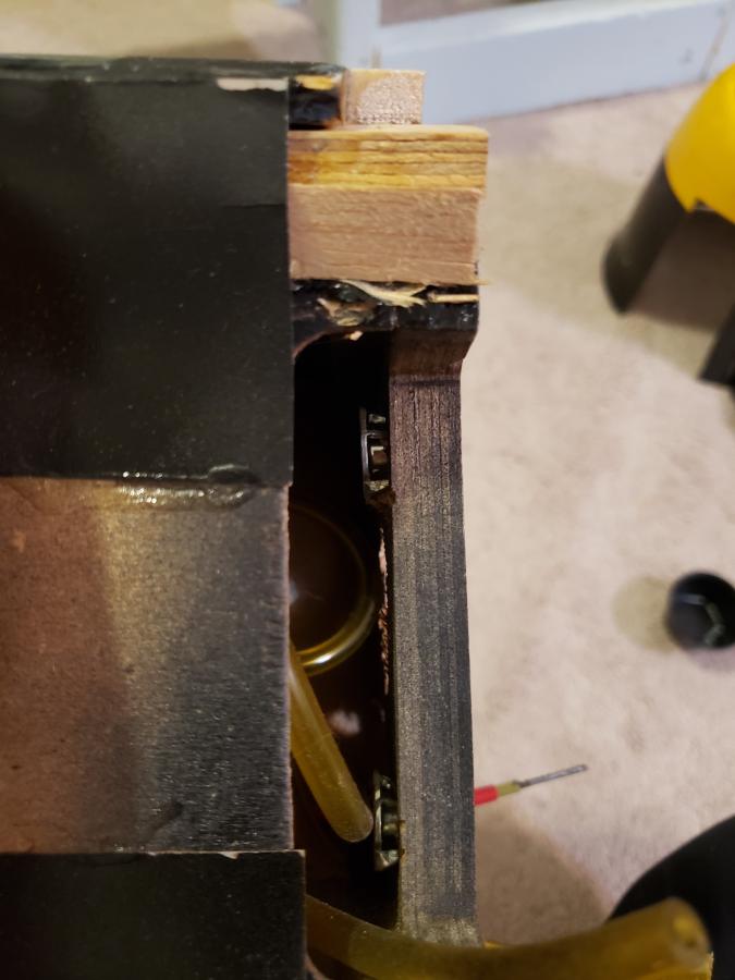

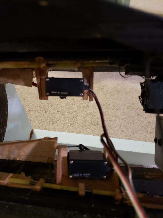

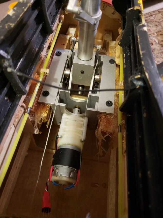

      1. Retracts are mounted where I can see through between the wood mounts & side of the fuse

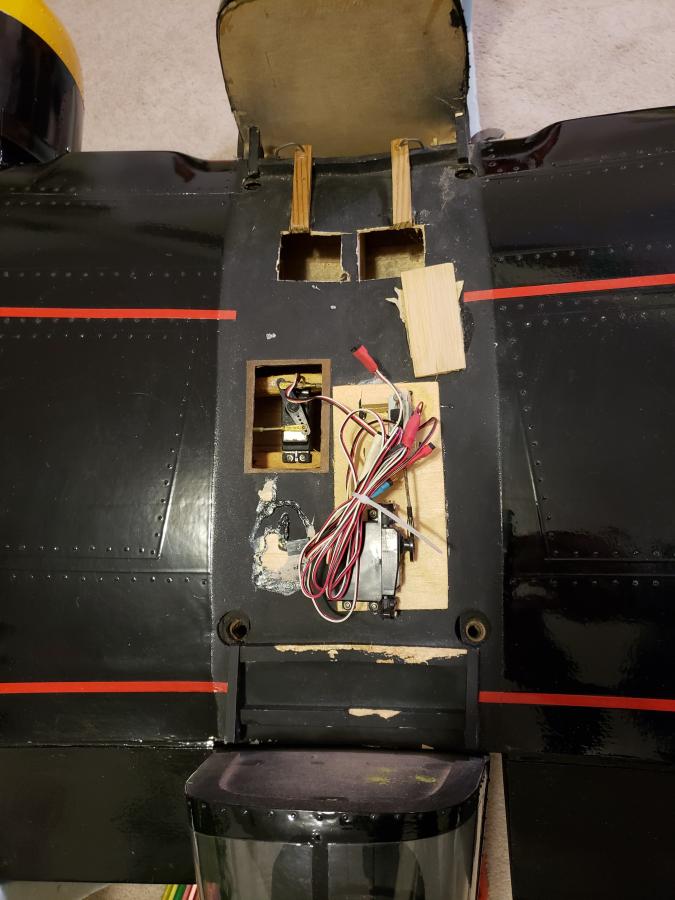

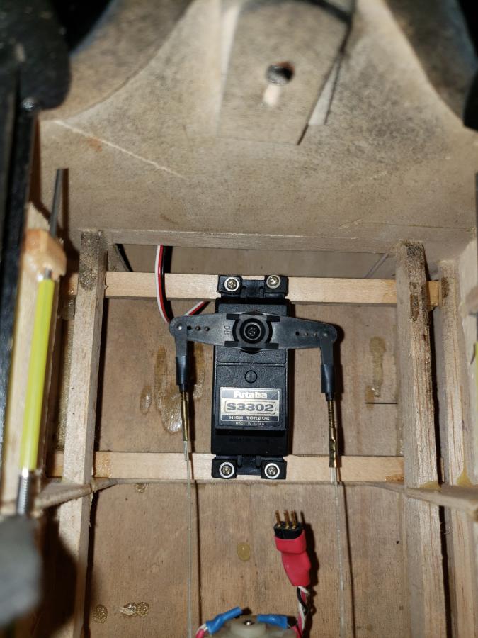

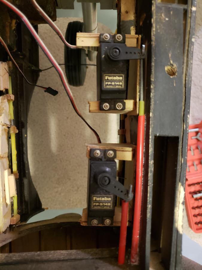

      2. Servo blocks aren't very straight/professional

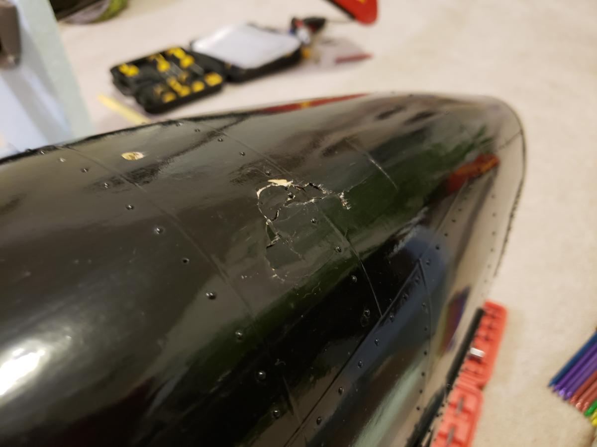

      3. scrap wood used as support in an area where people would see. After all the rivet and panel details, I wouldn't have expected it

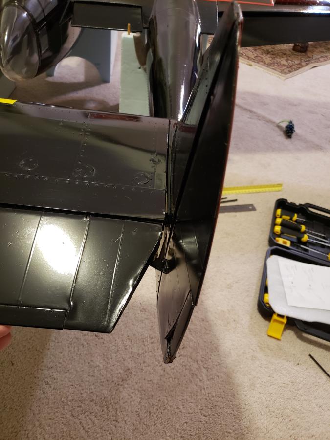

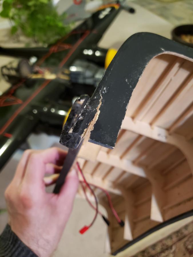

      4. The external, starboard stab rib isn't flush by about 1/8". The adhesive doesn't appear broken, as if the wood expanded/contracted so, they must've built it that way?

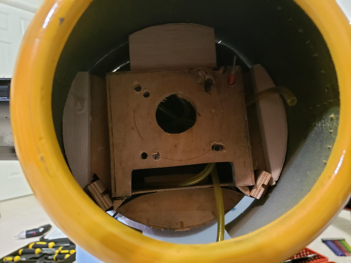

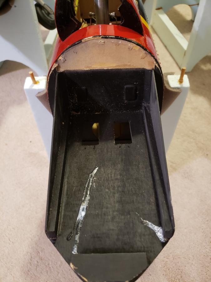

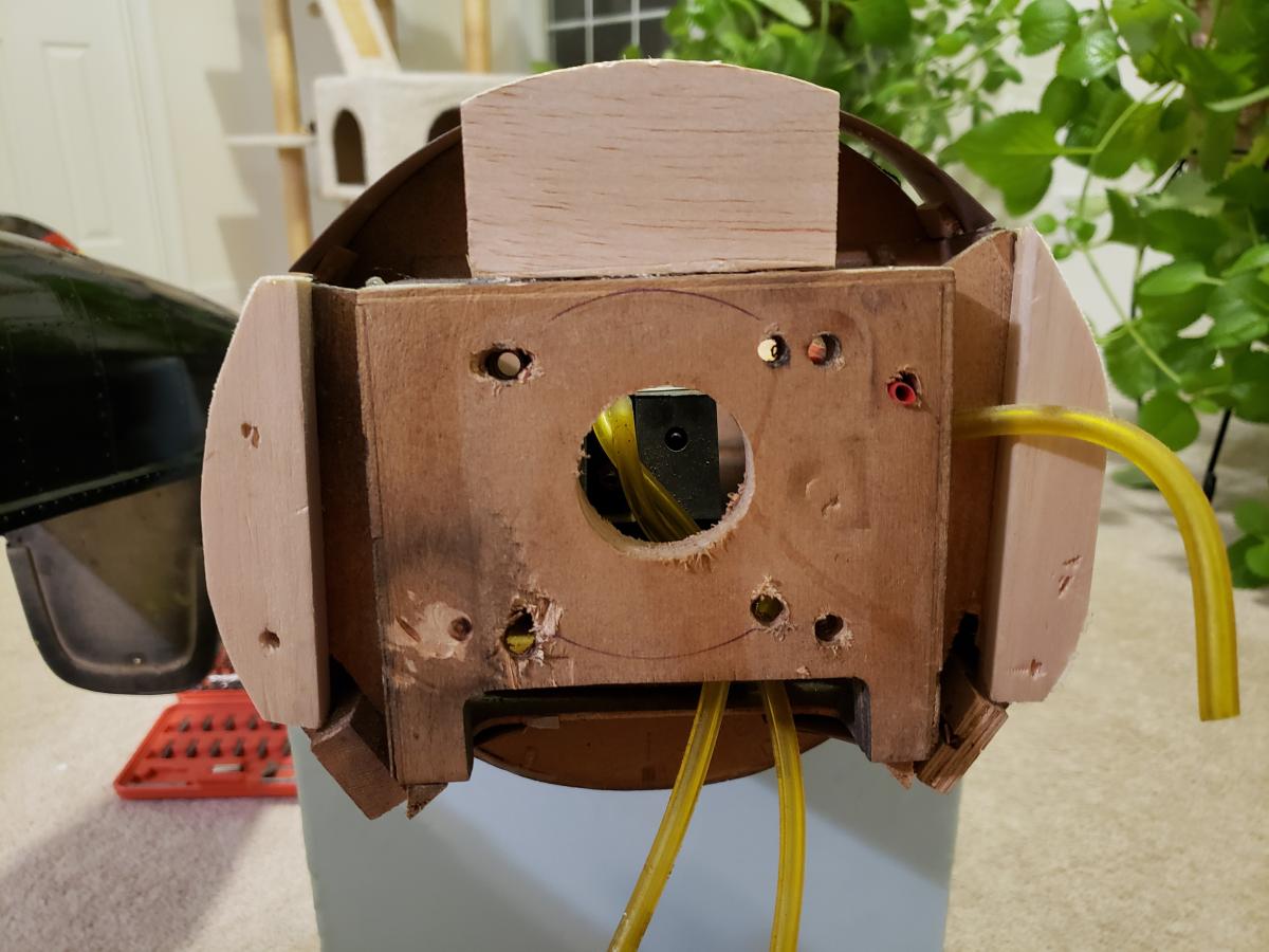

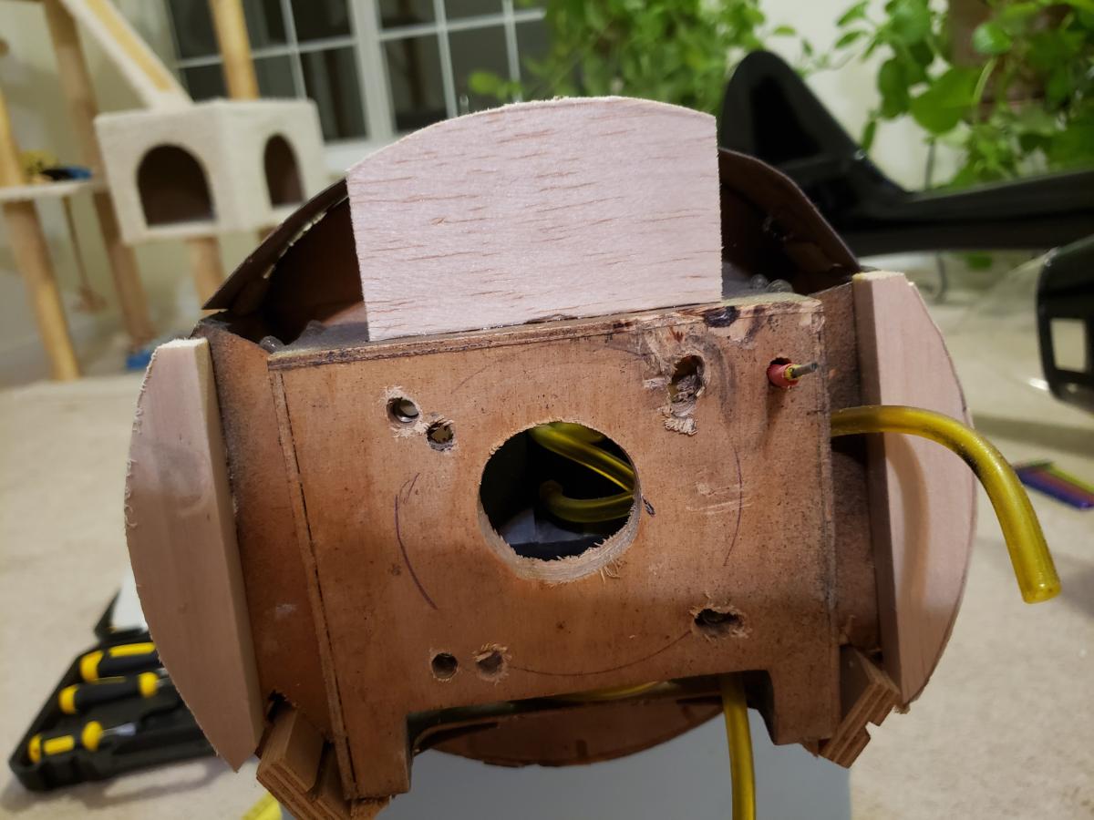

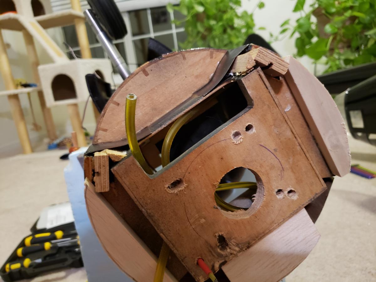

      5. Soft balsa blocks are used, with no sealant, with self-tapping wood screws, without CA on the threads to hold the cowl on a gasser. Imo, I would've used metal female bolt retainers in ply. Thoughts?

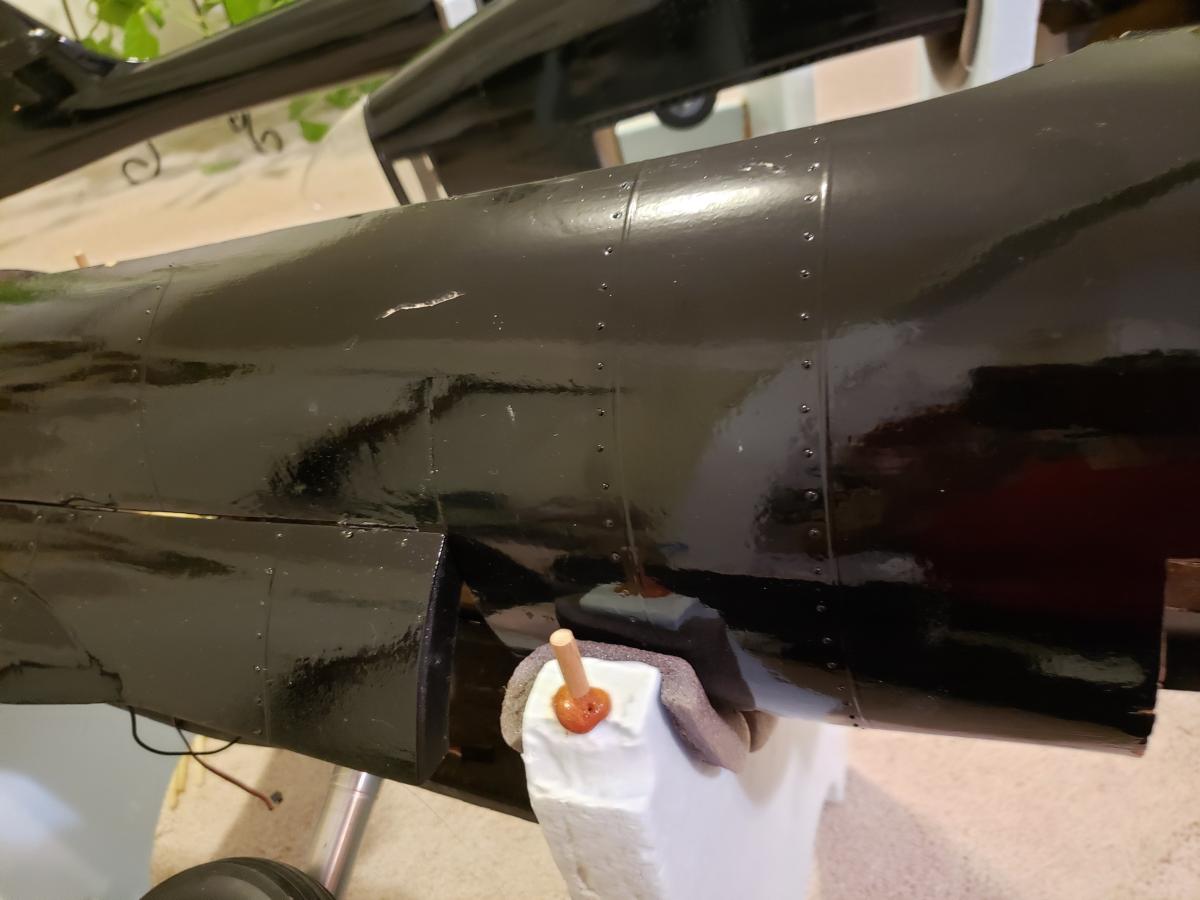

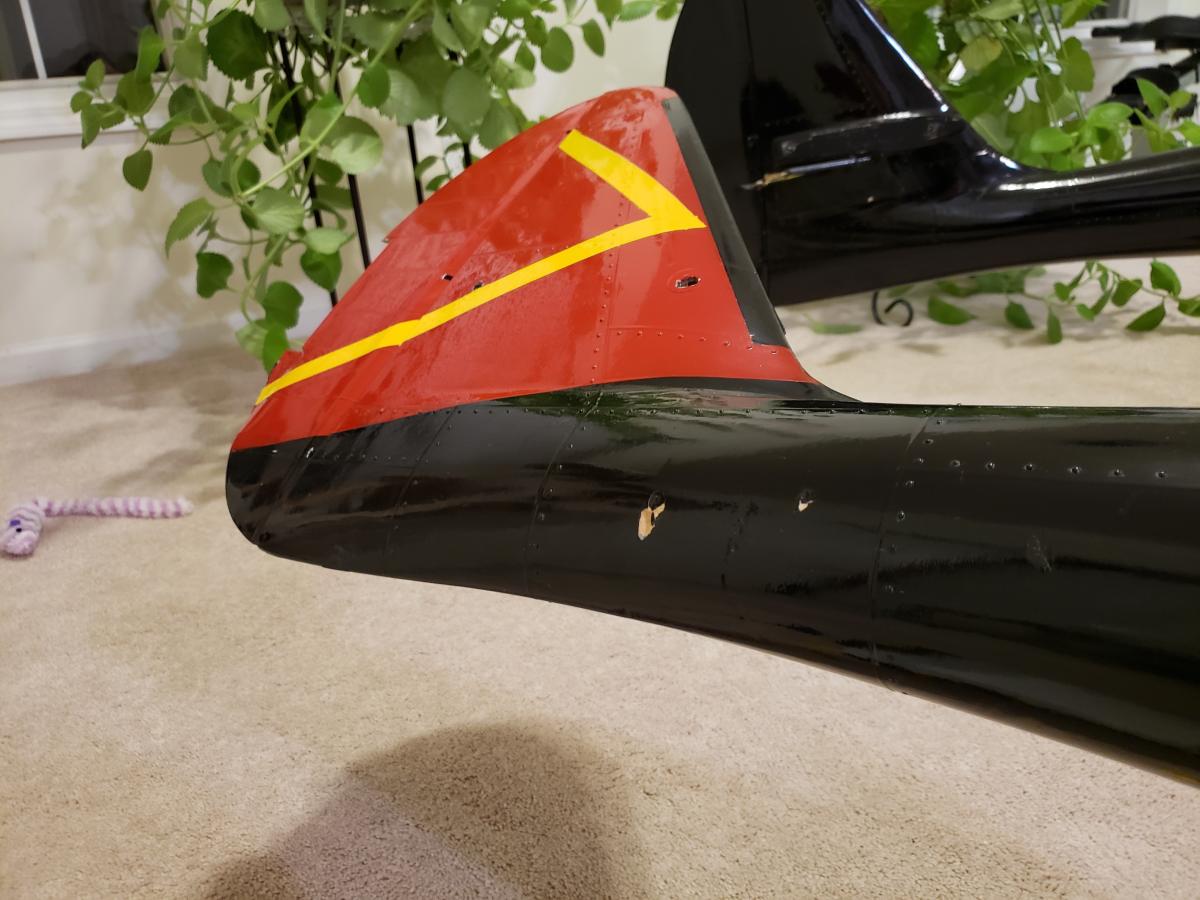

    2. There seems to be de-lamination in some areas

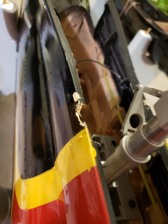

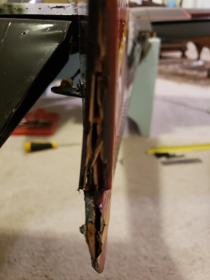

      1. The starboard rudder will need rebuilt. It's the worst area. It's next to the rib mentioned in 1d but again, the glue joint doesn't seem broken. I don't see signs of liquid damage.

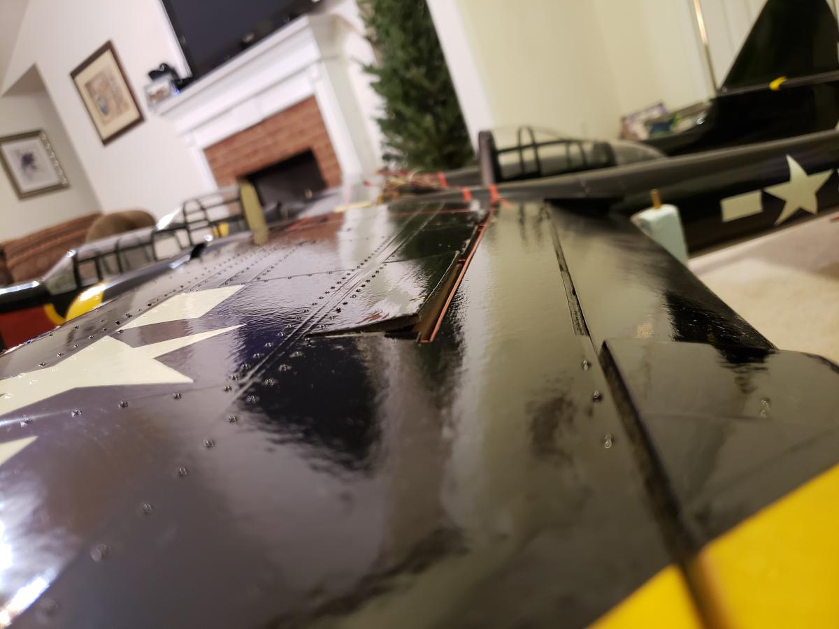

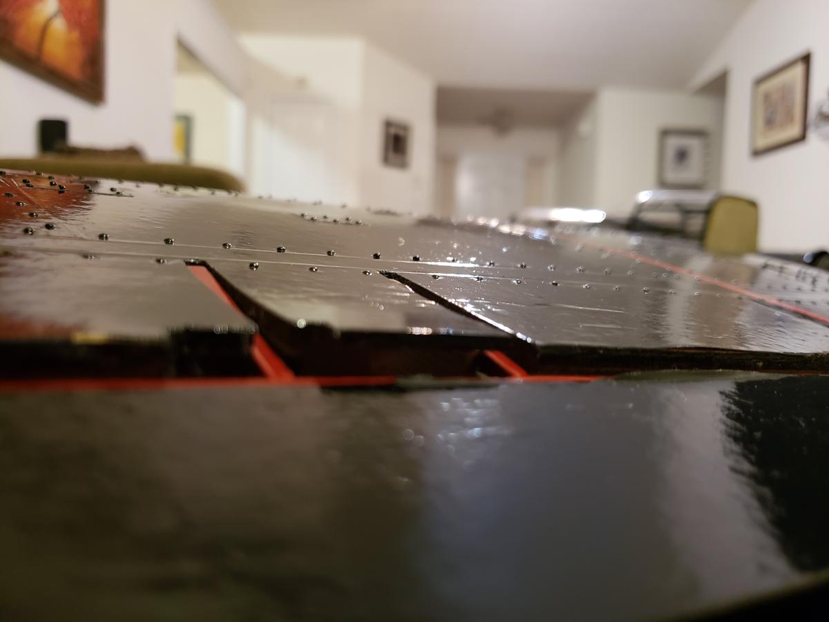

      2. The top of one wing, where the slats raise and lower is warped
      3. The top center section has split from the former

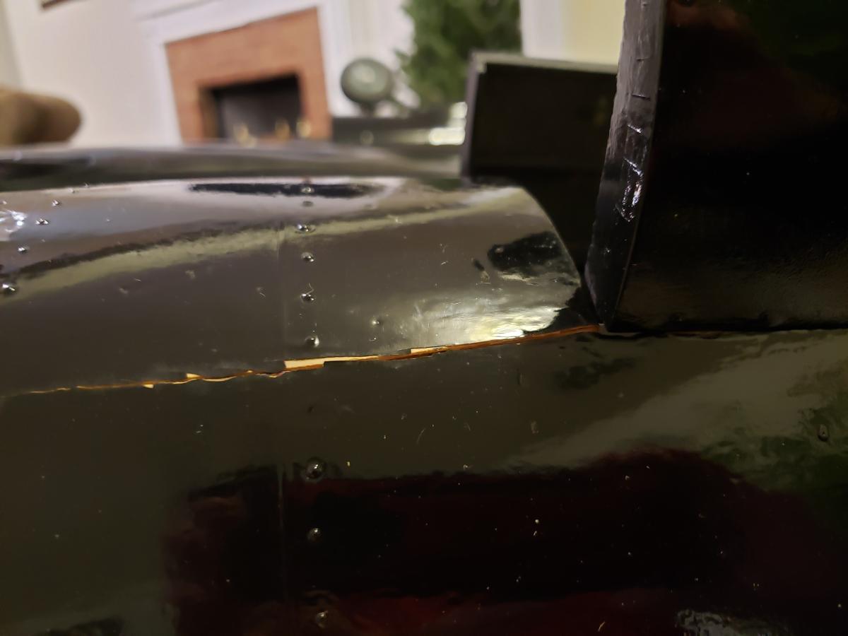

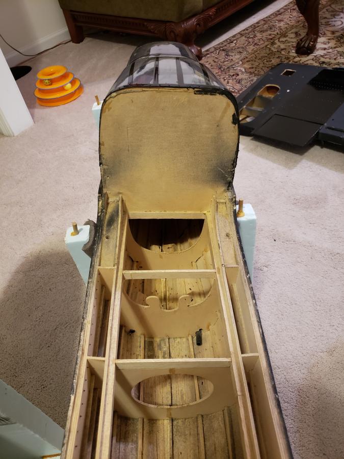

      4. There are a few cracks in the fuse, that I'd guess are from wood expanding/contracting
      5. THIS IS MY BIGGEST CONCERN...one wingtip has the aluminum tube adhered to the fiberglass wing tube. On the other wing, the tube slides out and I don't see signs of roughing it up before it would be glued AND, the fiberglass tube has broken almost entirely loose from the ribs and spars.

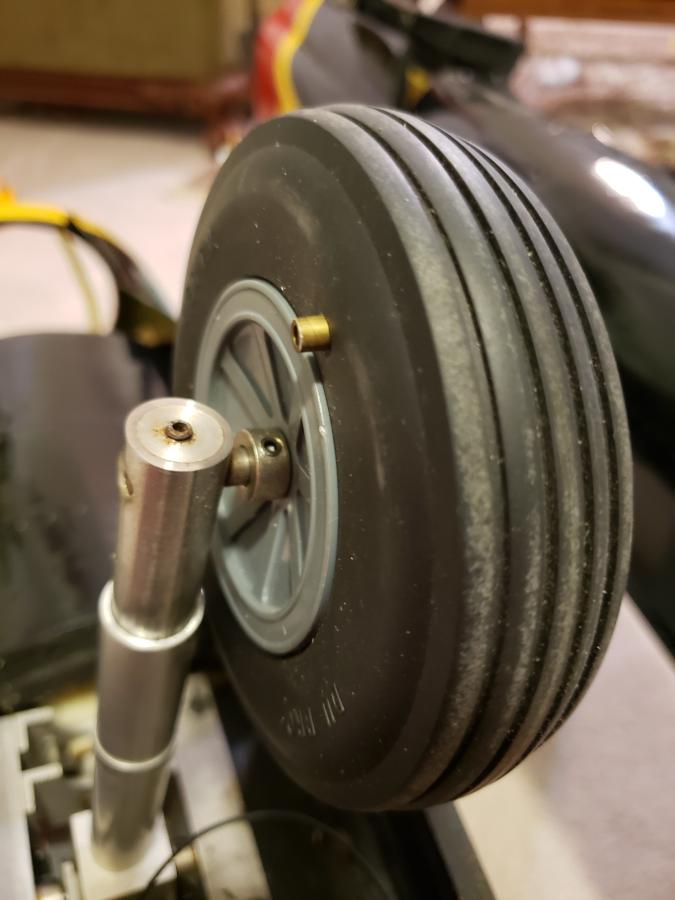

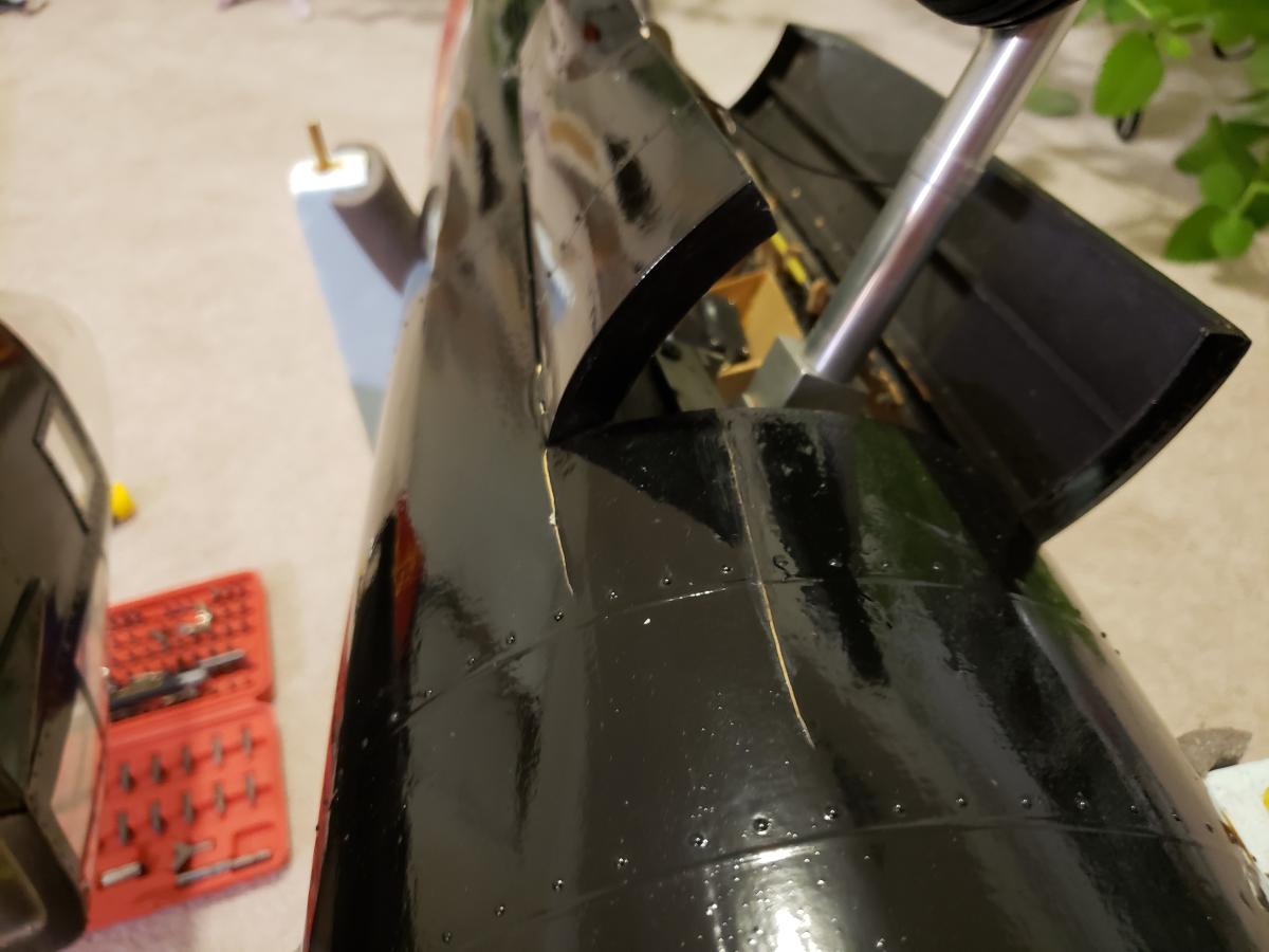

    4. Pushing on the wheels, the shocks feel "sticky" or "gummy". These are my first this size. Maybe they need rebuilt, if that's a thing? Maybe they're normal?
    5. The wheels are air filled. They have brass tubes I haven't seen before. Haven't had a chance to lookup what they are. I'm assuming maybe to fill but they slide so it doesn't seem like they would hold air, even if some kind of cap was put on them?

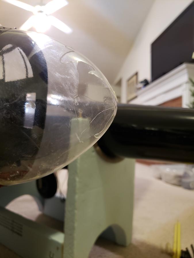

    6. The rear canopy is broken, but I've bought a replacement

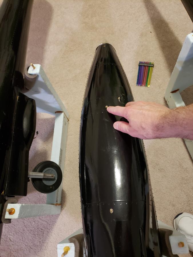

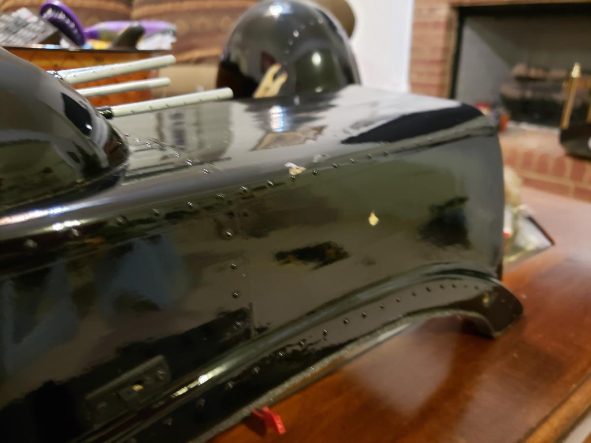

    7. There are round, faux panels where some have fallen off. I'm holding one in one of the pics. Are these stickers? If not, how did they cut such perfect circles??

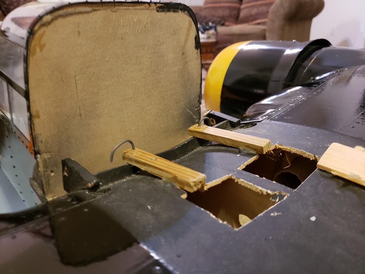

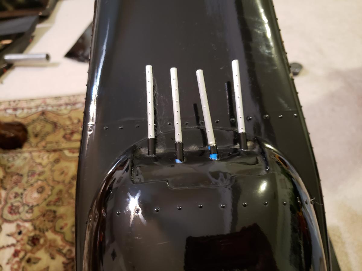

    8. There are "hooks" on the top of the center section, towards the front. What are they for? Going back to build quality, if hooks were needed, IMO, why wouldn't you use to matching I-hooks or J-hooks when you know people at the field are going to be all over this bird? If corners were cut here, where else?
    9. At a quick glance, the servo arms don't appear to be setup mechanically correct. The servos are older.
    10. Looks like there were either mistakes or there was a change in engine based on mounting holes in the firewalls. That's an easy enough fix. I don't see signs of combustion, and I don't see wingtip scuffs, etc. so I don't think it's been flown? Thoughts?

    12. The wood panel under the center nose cone has been broken and glued. Probably from handling. Not worried about that other than the pride of how it looks when showing it off.

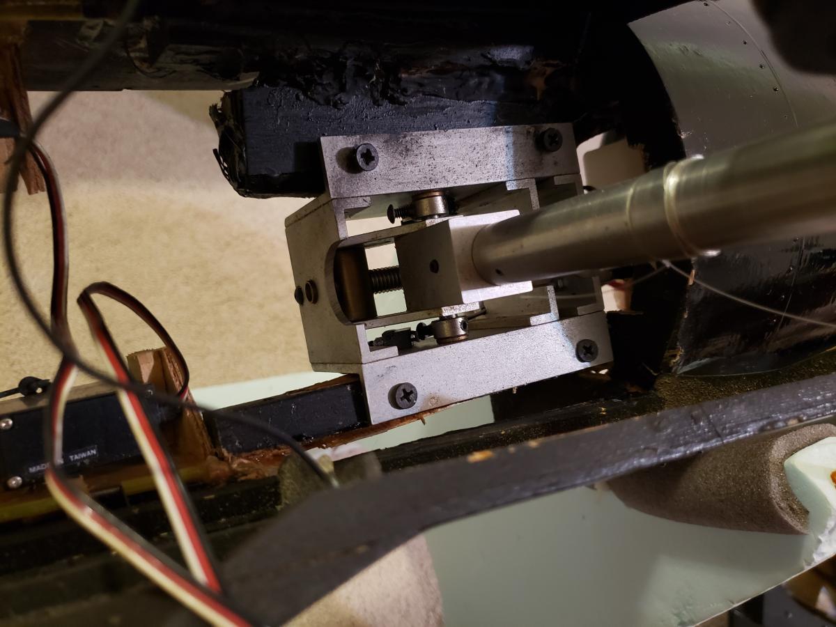

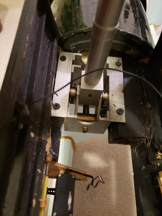

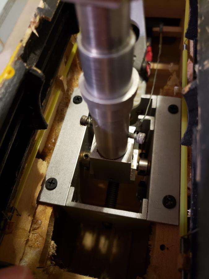

    13. I haven't tried cycling the retracts yet. Does anyone know the make/model?

    Whether these issues are from heat, age, building techniques, adhesives used, properly mixing adhesive, etc. etc. I'm concerned for the overall structural integrity. Am I being too paranoid?
