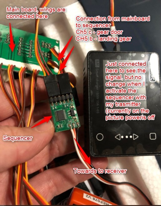

      Basically I have already checked the hub on the wing, everything works.Next step was the main board and its wires towards to the sequencer. At this connection point, when I installed my receiver, everything was worked (I just had to use 2 channels and switched to operate the door and landing gear).
      When I move 1 step forward and connect my receiver directly to the sequencery, nothing happenes.Click image for larger version

        Could be a bad sequencer. Have you confirmed that the gear port on the RX is functional?
