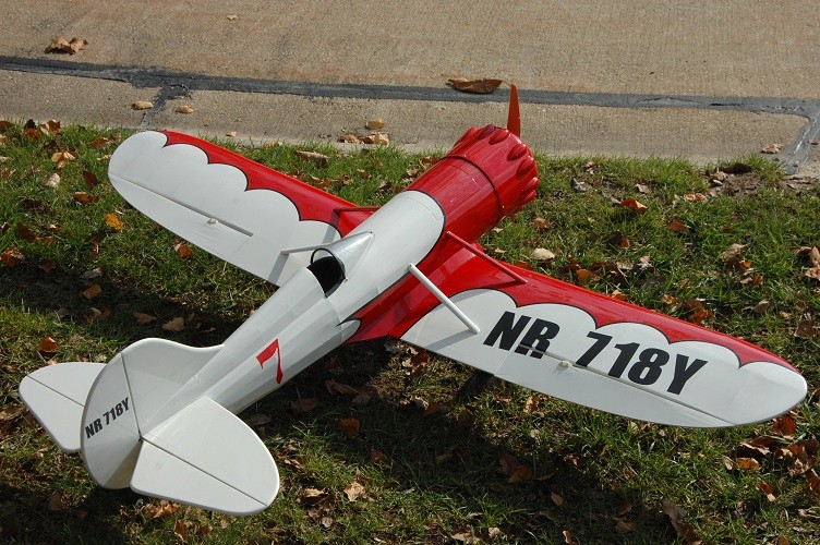

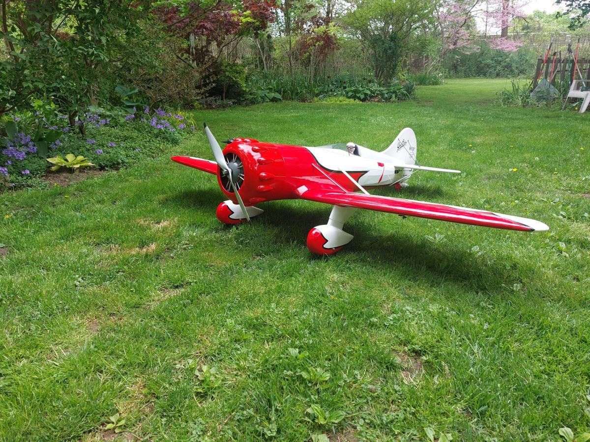

    I was lucky enough to acquire this model last month and have been working on it since- manufactured in maybe 2008 by Green Models and sold by Hobby Lobby the airplane was assembled but never flown. It had a gas engine installed at some point but was sold to me without which suited me fine as I prefer electrons for fuel anyway. There isn't a whole lot of information out there regarding this model but it flies well from all accounts and I have a CG so what more could one want?

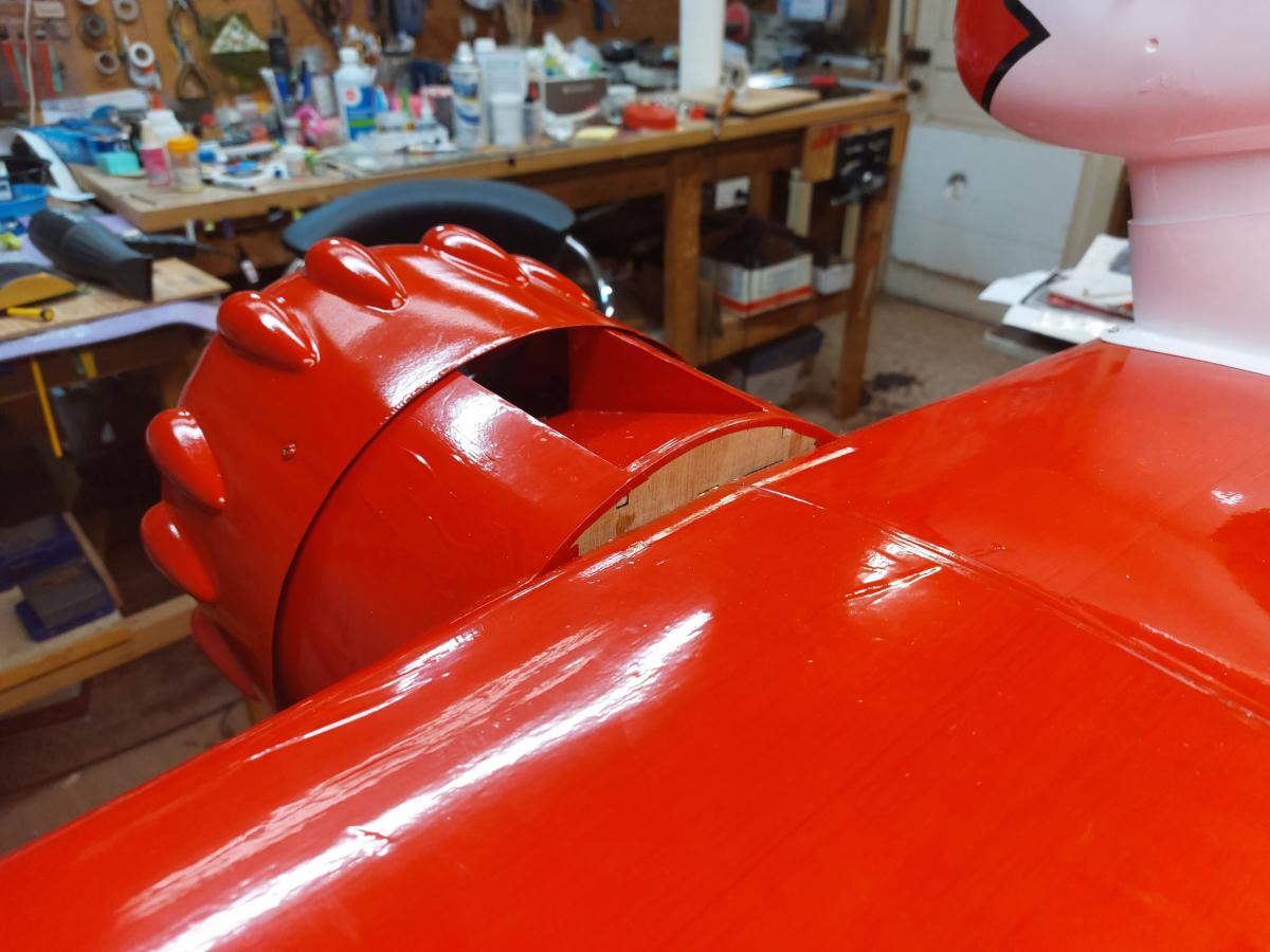

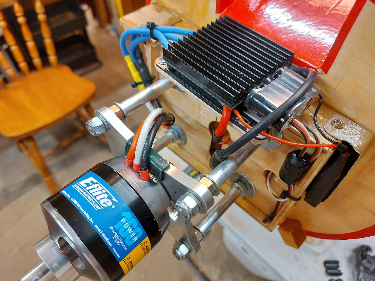

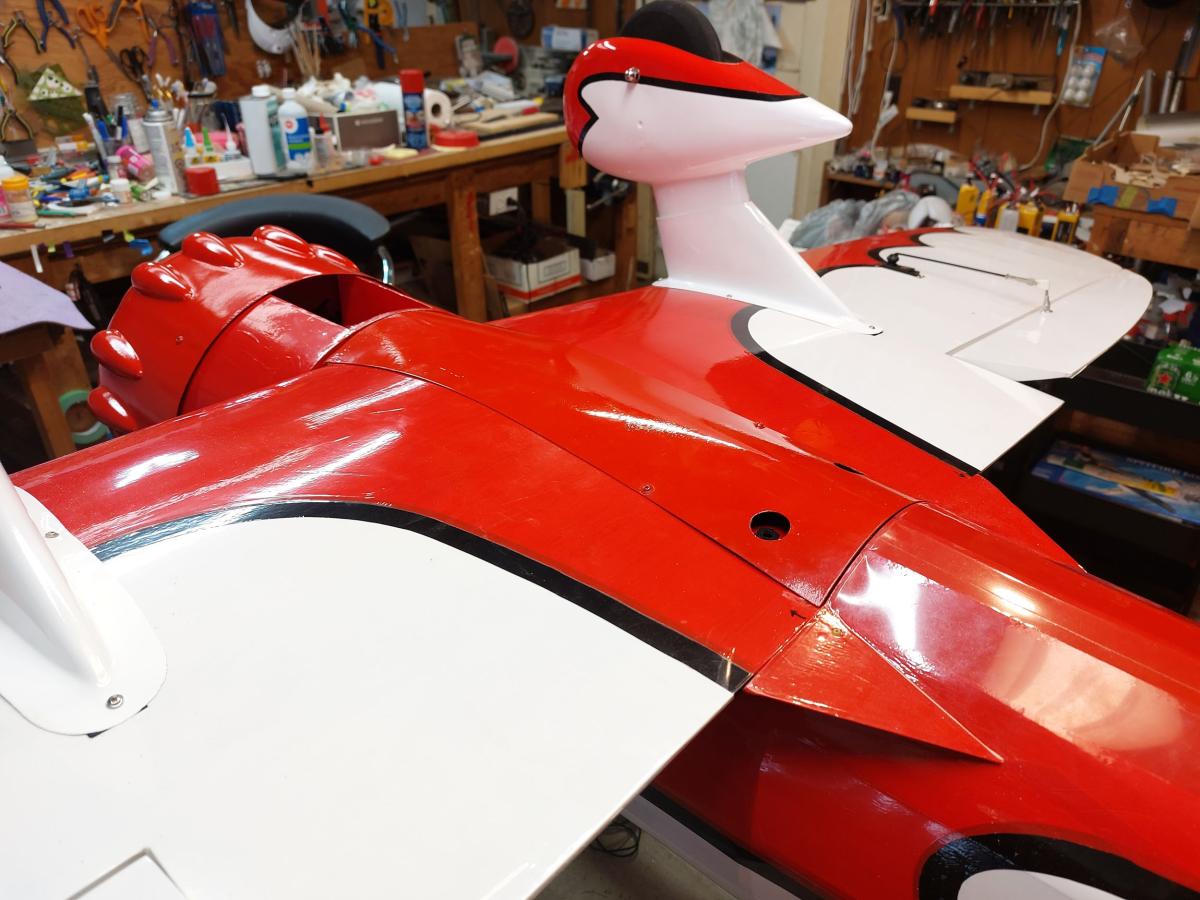

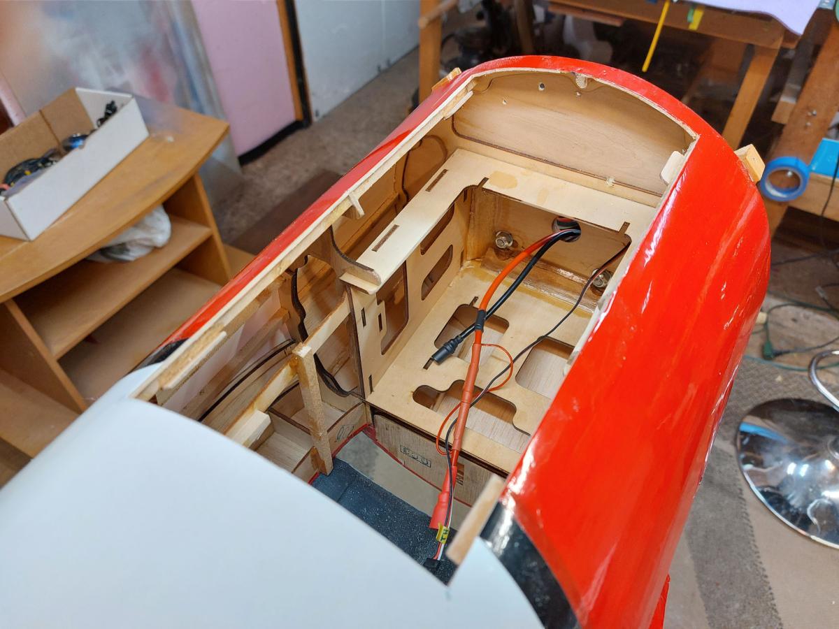

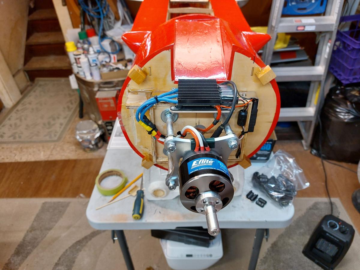

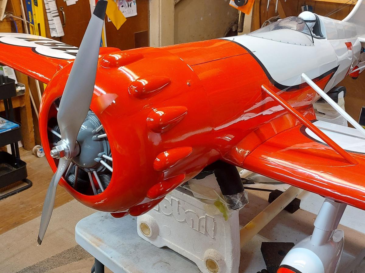

    The first order of business was to cut in a hatch for battery access- a later version had a hatch from the get go with a considerably larger opening than I created. An E-Flite Power 160 motor was installed using an X-mount from smallpartscnc.com and runs on 10S (5000mah) through a 120 Amp HV ESC. I lugged the fuselage outside the other day for a quick wattmeter test- 80 Amps, 2900 watts with an APC 20x10 prop so lots of power, if a bit over propped. I may go to a 20x8 or just reduce throttle travel a bit as the motor is rated at 70 A max.

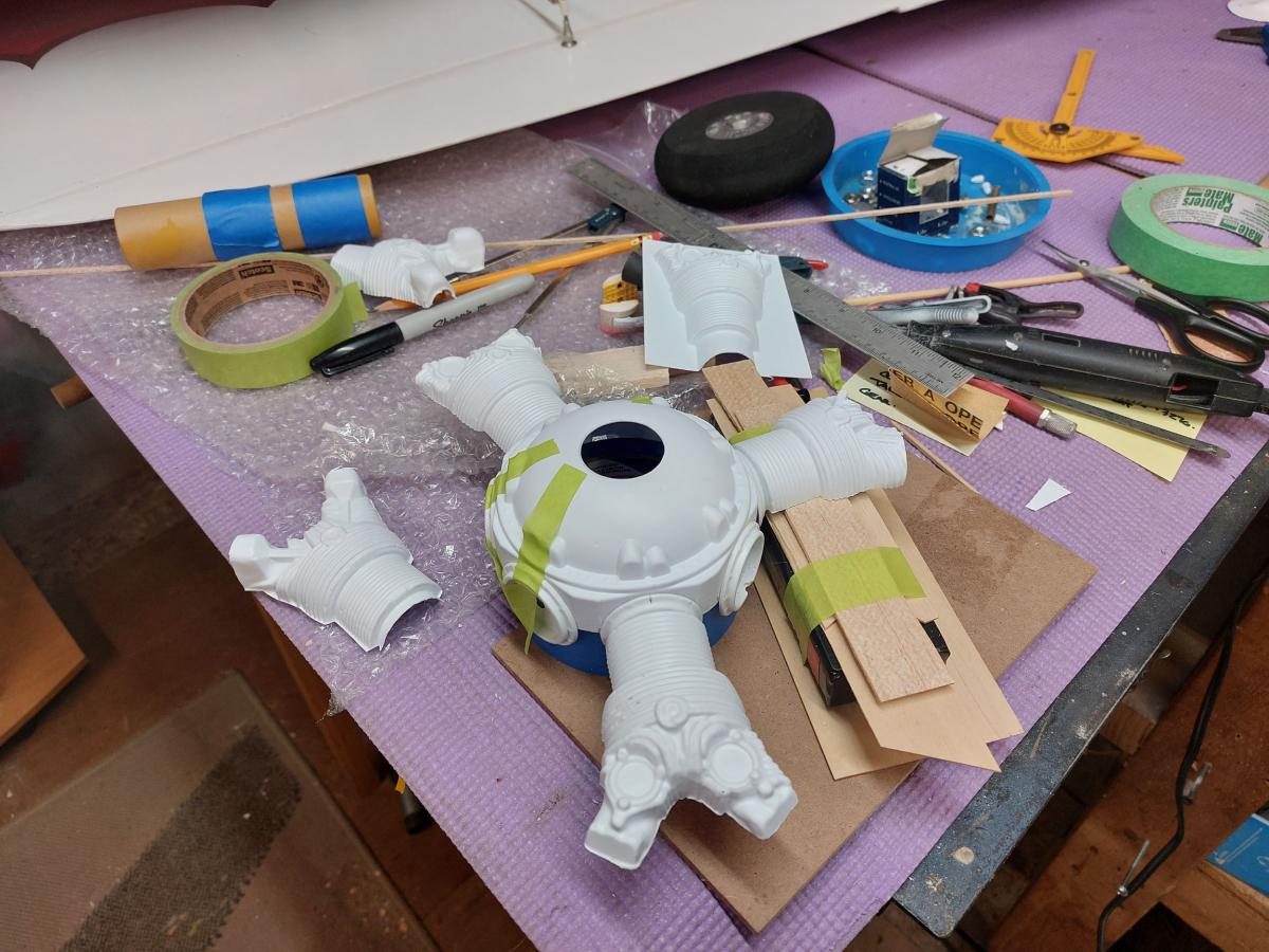

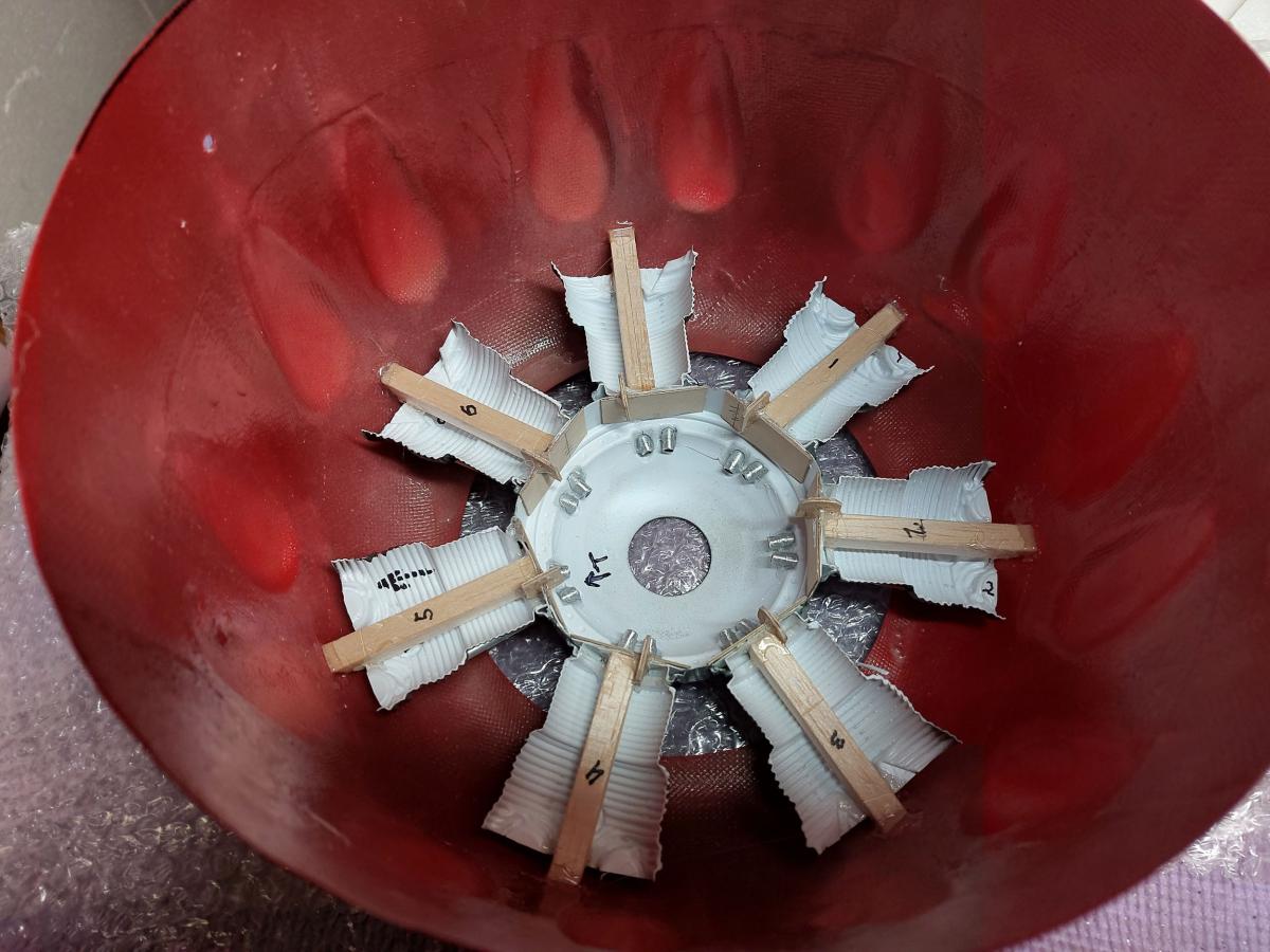

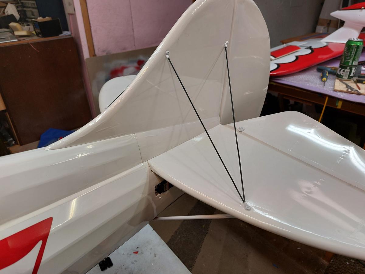

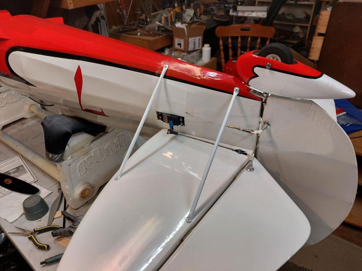

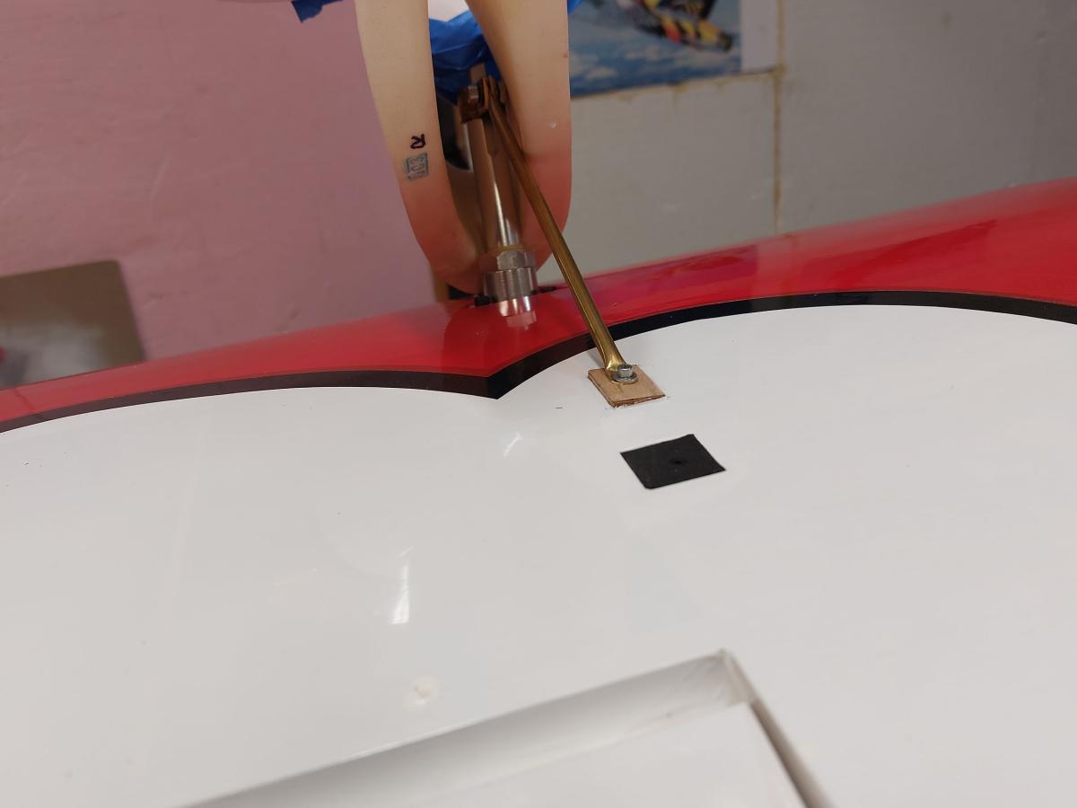

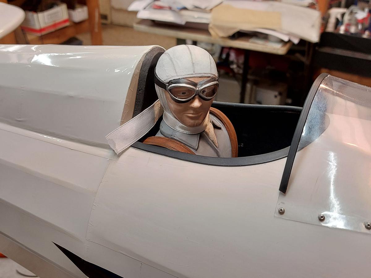

    I reinforced the gear with bracing to the rear as the full-size aircraft had and also added same to the tail planes (which are purely cosmetic). The dummy radial is a 1/4 scale vac-formed kit from parkflyrplastics.com, strengthened with balsa to hopefully prevent the prop blast from blowing it apart. The pilot figure came with the model and I thought he looked pretty good for the period so promptly cut his head off and installed a servo in his chest- his head now swivels with the rudder. A scarf hides the joint and belts and some paint completed the little guy.

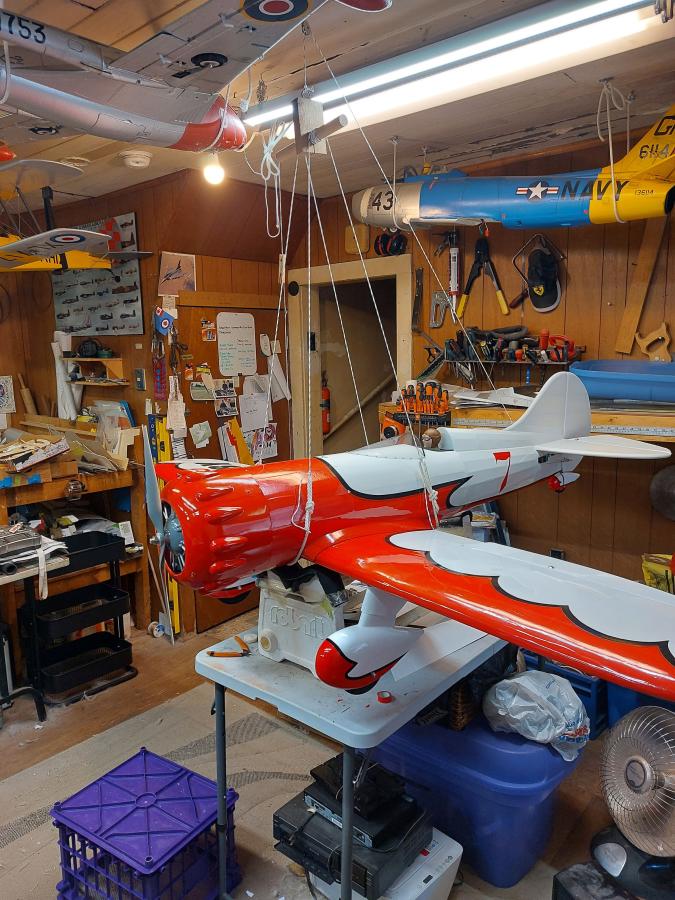

    I made and used a "Vanessa rig" to do an initial balance check and as I've not used this method before was an interesting experience and certainly the way to go with a model this size. I was pleased to find that with the flight batteries against the firewall (as I'd hoped) and the radio system 2200 LiFe battery amidships balance is achieved without additional weight. Sweet! I also used the rig, with a fish scale, to weigh the model and it's a bit over 15 lbs., which seems about right.
    Anyway, I'm really looking forward to flying this thing come spring- I've always loved "Golden Age" airplanes in general and Bee Gees in particular. Happy New Year to all!

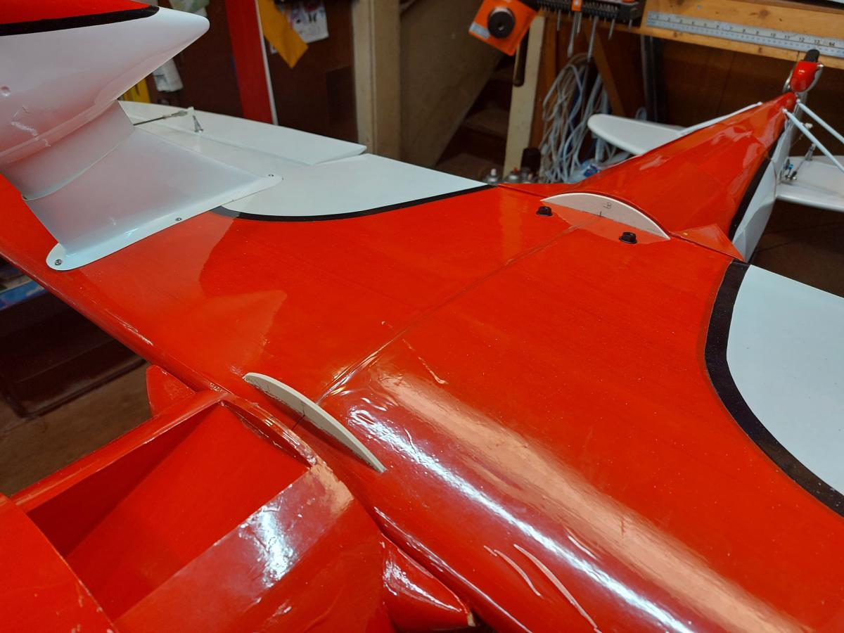

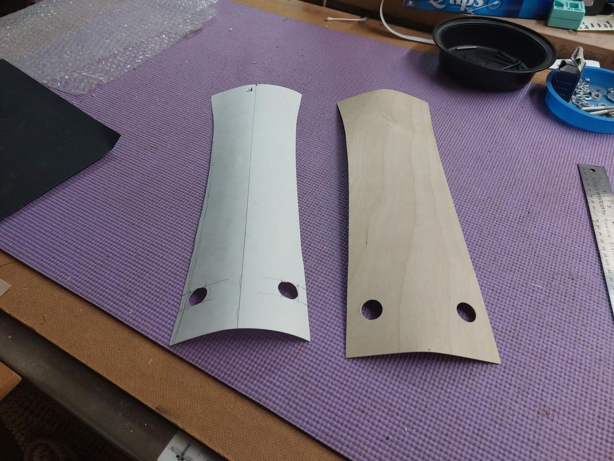

          Finished one of the last little projects this morning. For a belly pan this model used a piece of plastic sheet that was screwed on after fitting the wing- I didn't get this with the model and wouldn't have used it anyway (to avoid extra assembly at the field). I made one from 1/32" ply, permanently attached to the wing.

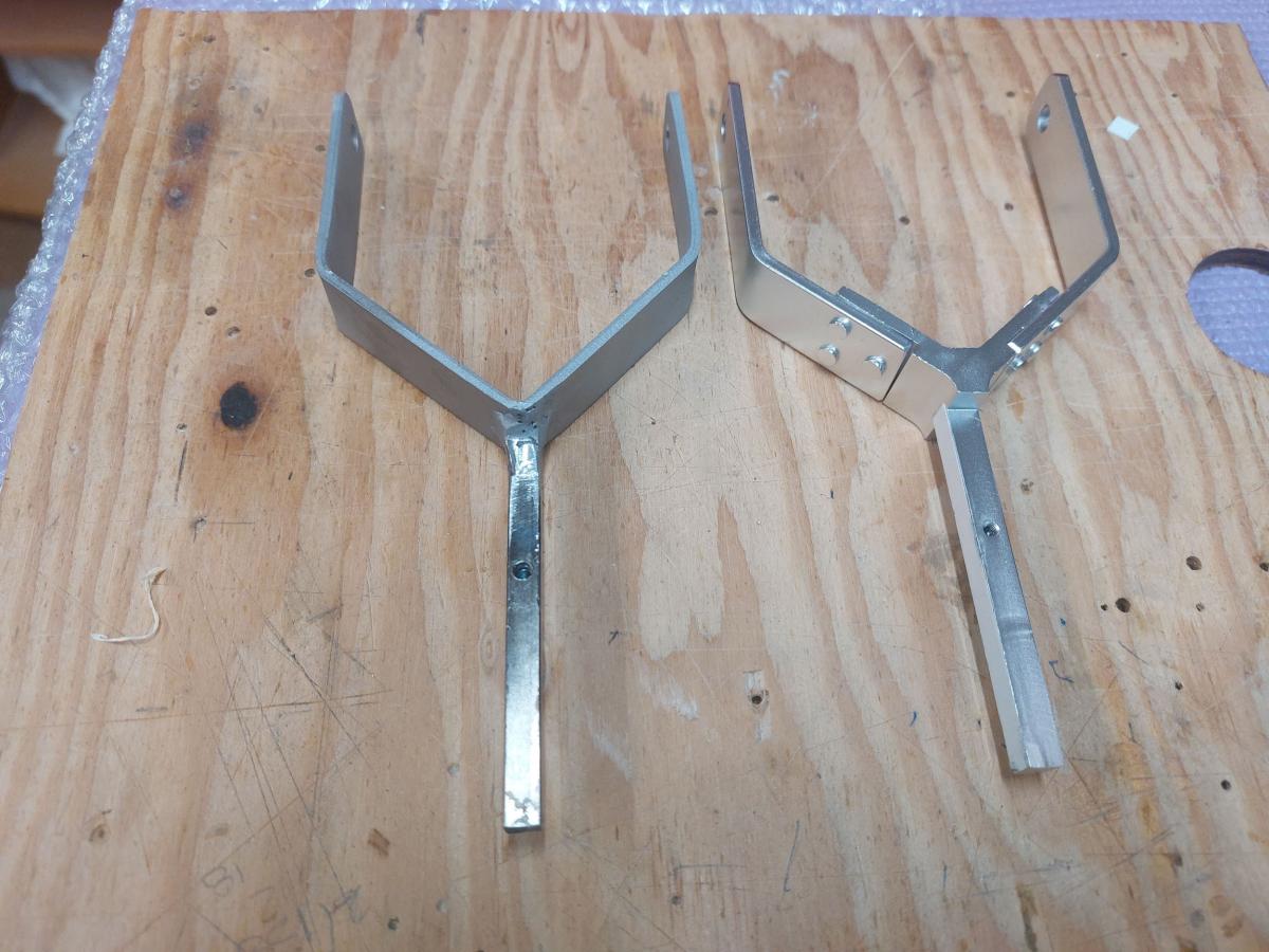

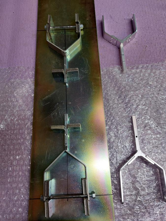

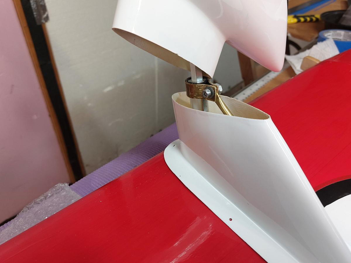

                I finished up the last to-do item on mine a few weeks ago and she's now finished and waiting for this winter to end- the stock struts, while well made, are aluminum and certainly not robust enough for a model this size (what were they thinking ?). Apparently Hobby Lobby realized this error and offered "upgraded" struts but that was many years ago....I made up a new pair from steel flat bar and square stock ( TIG welded) which I hope are up to the task- gear issues make me crazy.

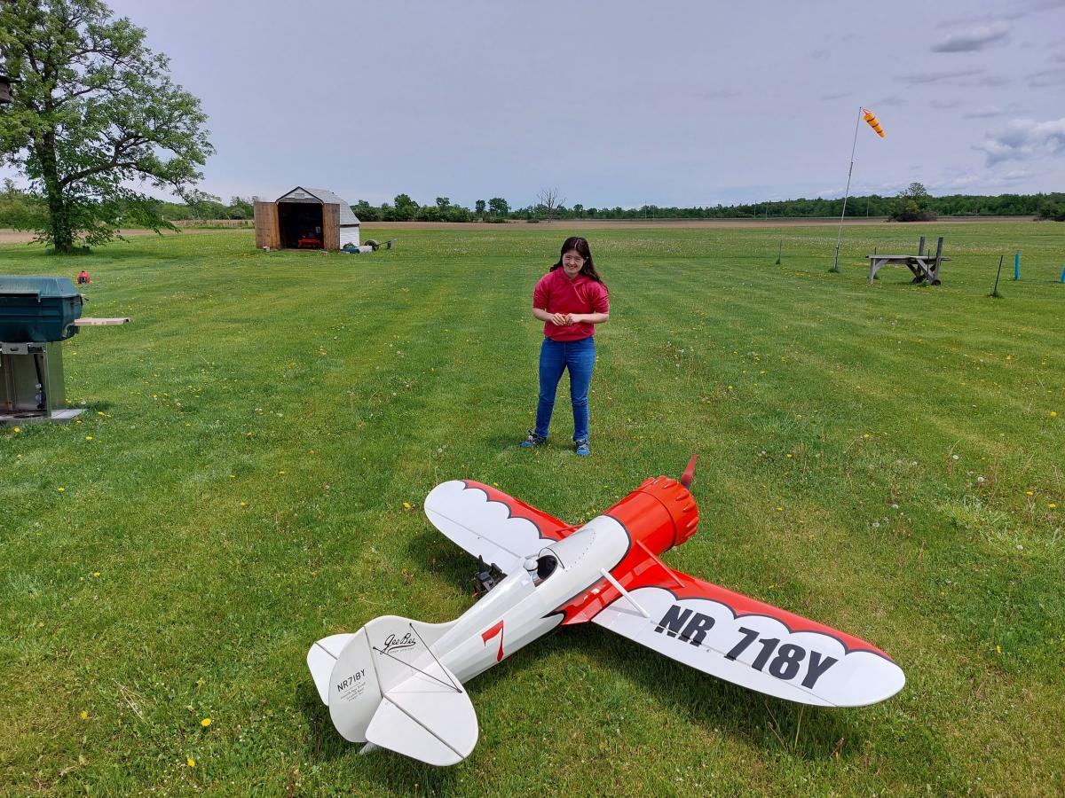

                  Although this springs weather hasn't seemed the greatest I've been able to get out to fly the last 5 consecutive weekends to get my brain/thumbs interface ready for maiden day with the big Senior Sportster after a long winter. Flying a different airplane each weekend, I started with my FW Venom, then the FW F-22, then the FW A-10, and finally my VQ TigerMoth, (to get some prop time). Figuring I was as ready as I'd ever be, off we went to the field with a promising weather forecast.
                  There was more of a crosswind than I'd hoped but after a range check (which I almost forgot) it was time. The Gee Bee was easily controllable as power was applied and the tail lifted and then the mains and we were off. My concerns about the balance point, thrust angles, control throws etc. were quickly dispelled as the model was flying beautifully with only some down trim needed. From my calculations (?) and a ground run I had set the timer for 5 min. and after 3 started practicing approaches and the model did indeed float along down the runway as I had read it would. Turning low to final a fair ways out worked well and the landing was just fine. Man I was happy!
                  The 2nd flight (after my heart-rate recovered) was much the same, with lots of power on tap and very benign flight characteristics. This is the largest model I've flown and it is true that "bigger fly's better" (and is also easier to see). I'm still smiling a week and a half on and will be flying the "Y" often, hopefully getting some video next time out.

                          Originally posted by Pogo
                          Thanks DJ- I've enjoyed your videos and hope you do one of the big Maxford when it becomes available, hopefully sooner than later. Not sure I understand your last sentence re: the General Hobby version?
                          Tom
                          Very nice job
                          I've 2 kits with opriginal landings and it seems it too big to fit in .. and only aluminium
                          do you have dimensions from yours so I could try to redisign some ?
                          also the 2 kits came with no engine cowlings and I would also appreciate if you could give me dimensions ;-)
                          many thanks
                          it's a long terme project as I've stored them for 10+ yrs alreay ;-)
