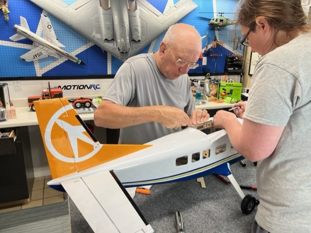

    The build has started Day 1

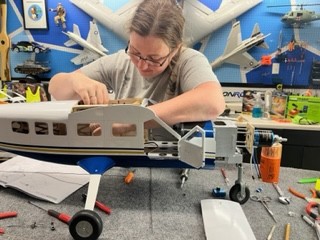

    For this, we will be going over any changes or sticking points in the assembly of the 208.

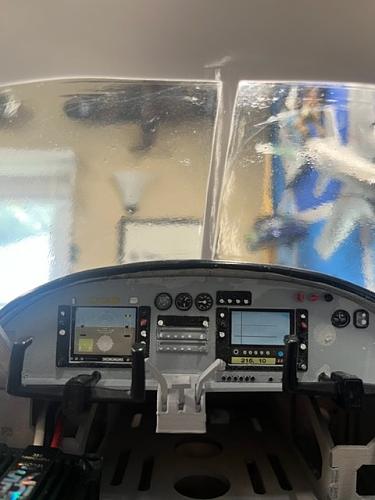

    First impressions of the model. The quality of the covering is spot on with other nexa birds we have assembled. it comes with all the rivets (Papa Dots) already on the model for you. also the balsa on the interior of the airplane is painted out of the box. The instrument panel is very detailed on this model and was a nice surprise.
    we started the assembly with the nose wheel per the manual 4 screws into the mount and a grub to hold the gear on. the top two screws were a little long so I needed to drill out the firewall for them to make it through.

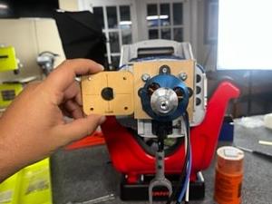

    The next step is mounting the motor. for this build, we are using the recommended Admiral GP10. We did find that the included mount is too small to fit the GP10 on and we needed to make a new hard wood mount that is about 1/2 an inch bigger all the way around. then just mount the nuts and screws per the manual.

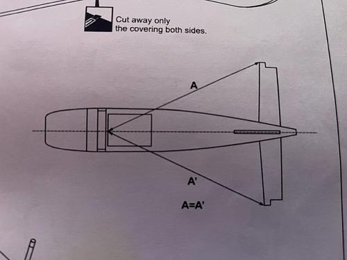

          for day two we pick up on gluing the Horizontal and vertical stabilizer on. make sure you cut away the covering for this part. I used Thin CA and dripped it in from the sides to fix the Horizontal stabilizer on the airplane. I then held a string to a fixed point on the airplane and made sure everything was straight see step 11 in your manual for this.

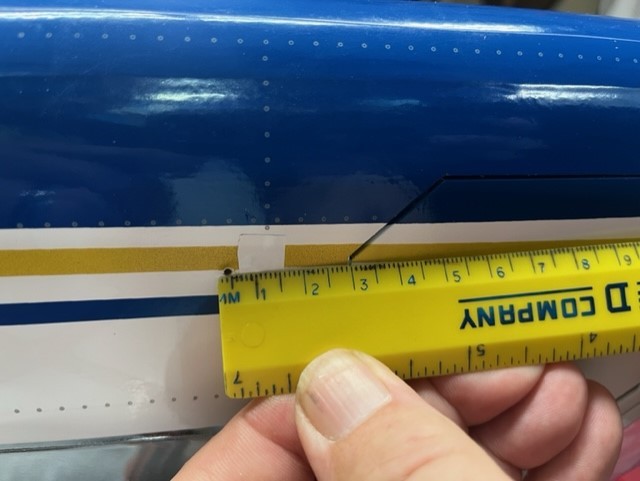

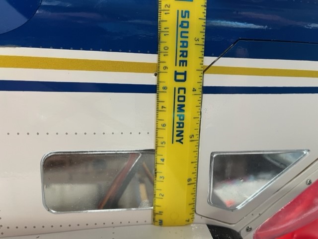

          The instructions are spot on up to step 22 Joining the wings. there isn't a measurement for where to screw the wing attachments to the fuselage but see the below pictures for my measurements.
ID:	346302Click image for larger version

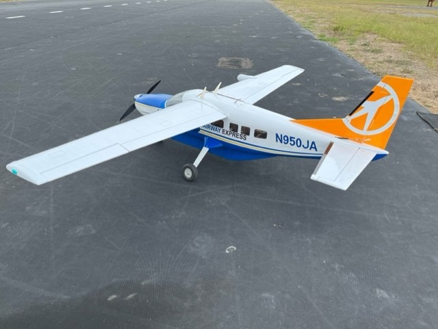

          I had the chance to fly the CE-208 this weekend on a 6s 5000 and i balanced the model by hanging it from my finger on the wing spar. I had it a touch nose heavy and it flew fantastic. I'm amazed how nice this model lands. I always thought a 208 would be a sweet flying airplane and it didn't disappoint. Video to come on Motion RC soon see you guys on the next build.
