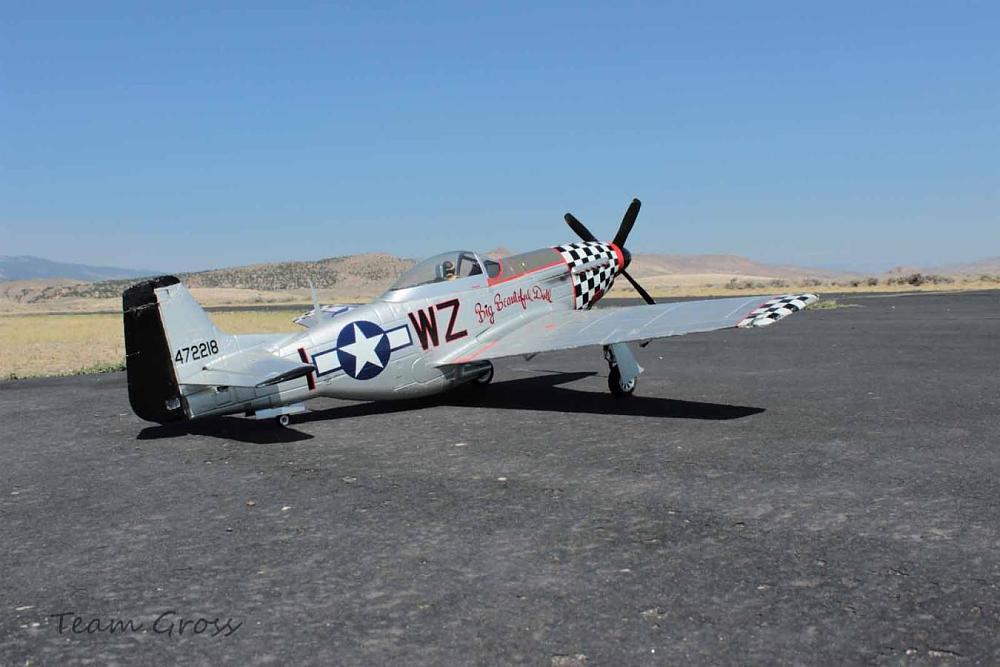

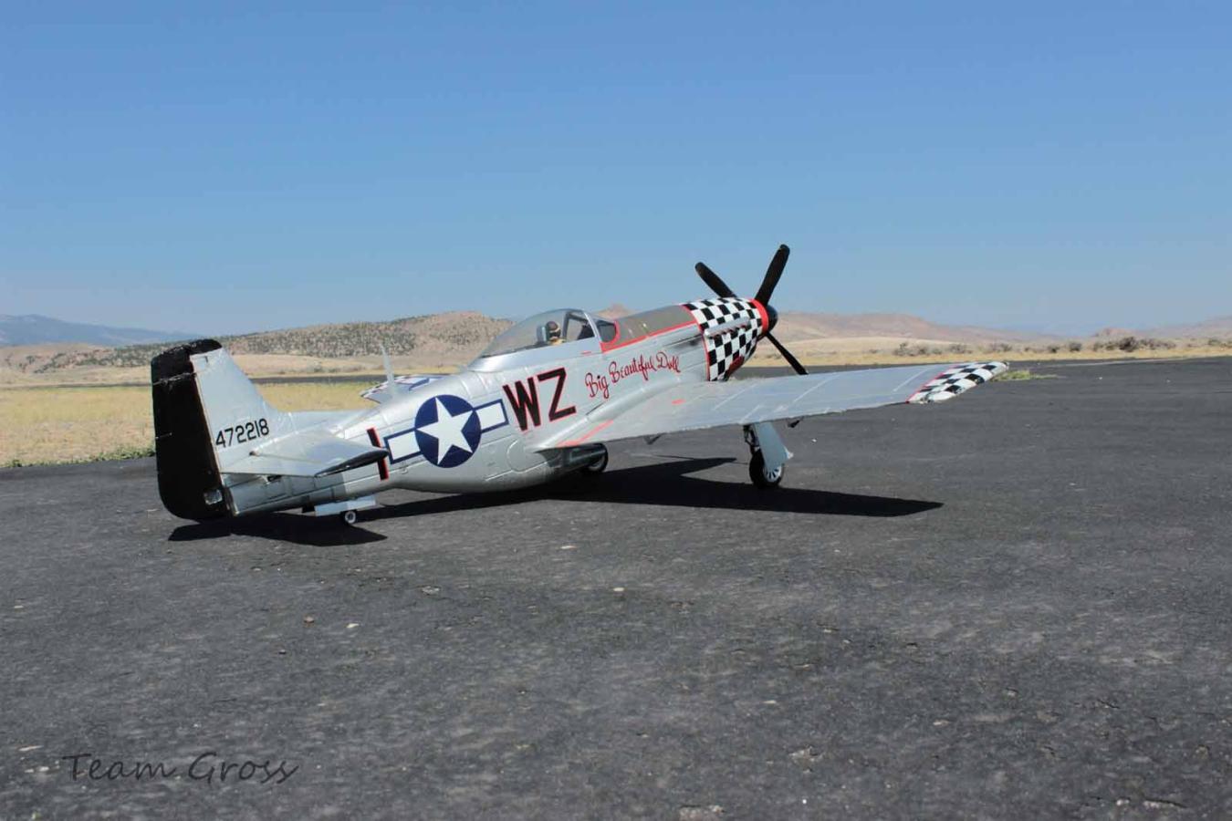

                      Amen brother! I've been in this hobby for 8 years now and my Mustang is still going strong
                      Click image for larger version  Name:	IMG_5392.JPG Views:	0 Size:	108.3 KB ID:	346713

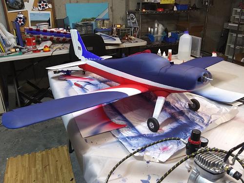

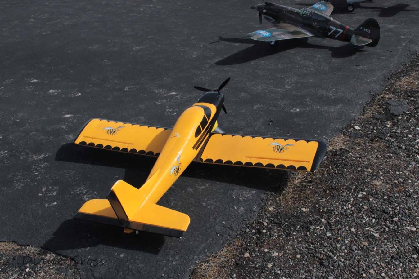

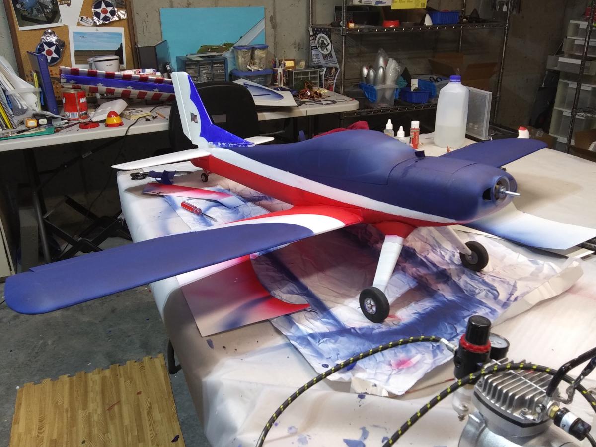

                      And the reason(s) for that are still flying as well!
                      Click image for larger version  Name:	20220408_092339.jpg Views:	0 Size:	145.8 KB ID:	346714Click image for larger version  Name:	IMG_4274.JPG Views:	0 Size:	163.4 KB ID:	346715
                      God knows how many flights are on these two birds, but at least the first two seasons and I still enjoy flying them.

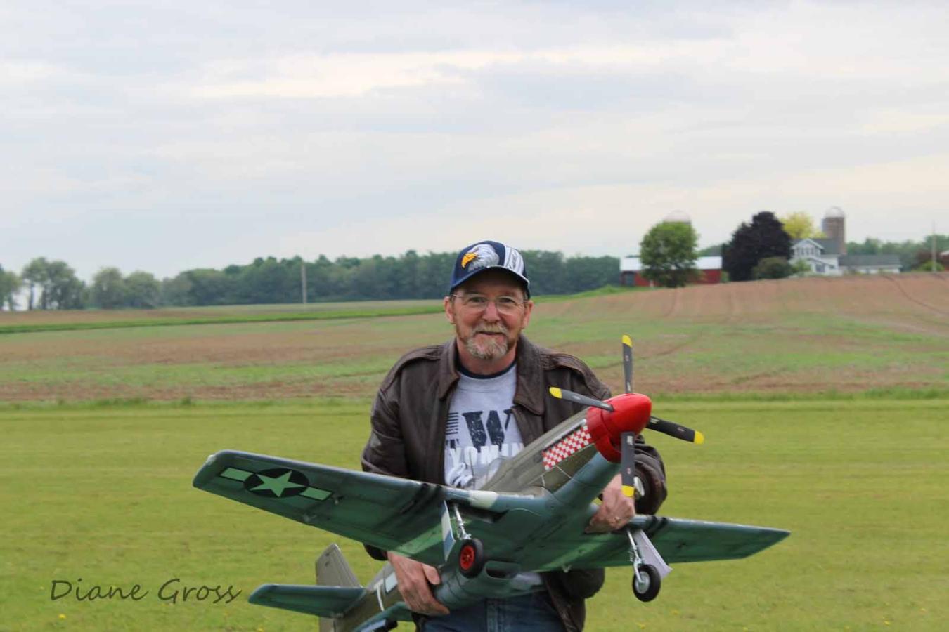

                      Even at that, the Mustangs were intimidating, I took my B model with me to RC Flight School and had Dave Scott buddy box with me on the first ever Mustang flight.
                      Click image for larger version  Name:	IMG_3348.JPG Views:	0 Size:	86.6 KB ID:	346716
                      Never underestimate the value of a good teacher and a buddy box.
