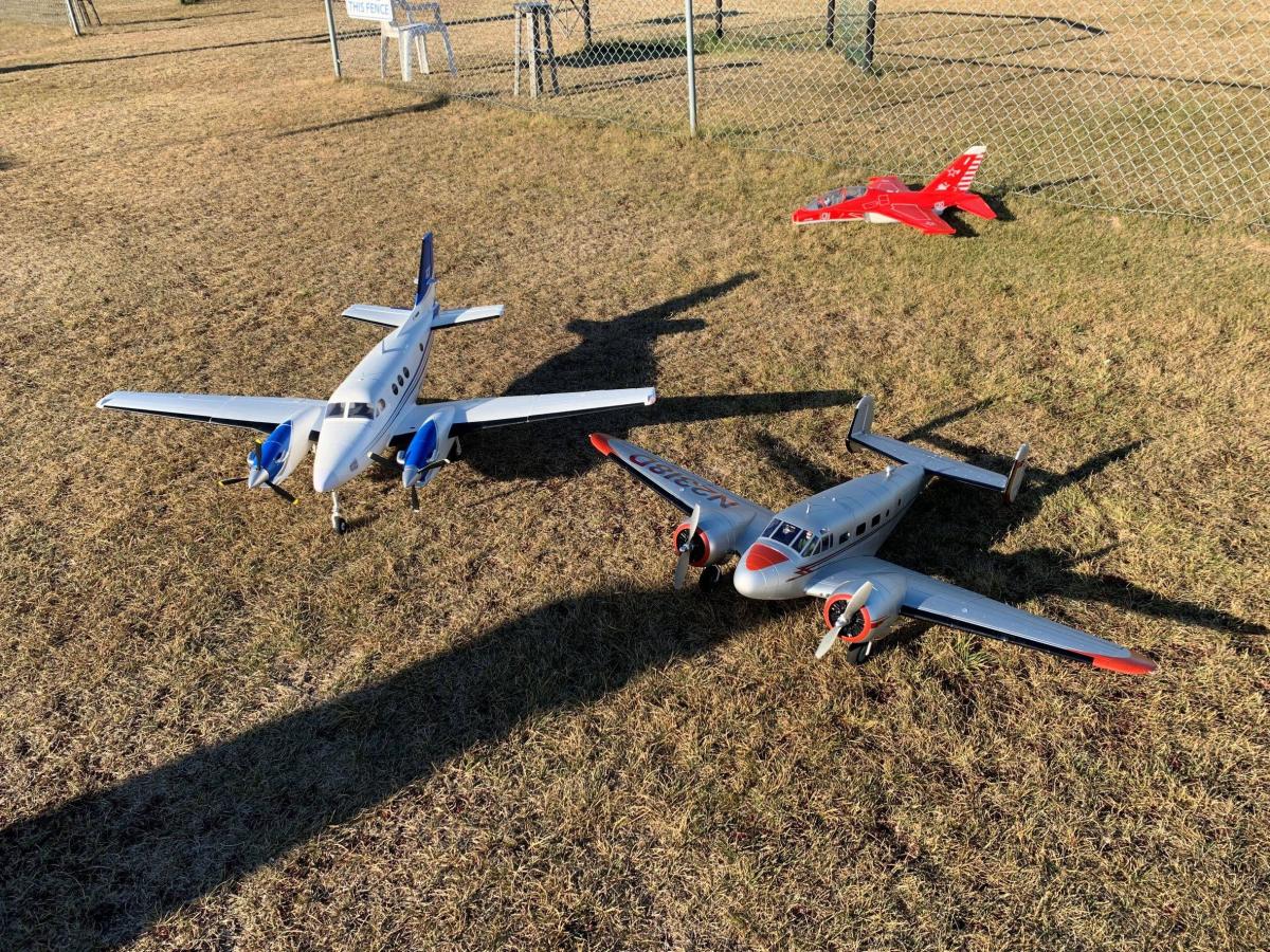

                Here's a comparison of my King Twin and my buddy's Beech D18. Being in the background, the King look smaller but in reality, it's bigger than the Beech.

                  Interesting. If I didn't know better and someone said which is EFlite and which is Hobby King I'd be backwards... What are your flying impressions? Knowing how much some company likes to stress easy flying based on their included AS3X/ SAFE receiver how do you think it would fly without a gyro'ed receiver?

                    My feeling is that it will fly great without the AS3X. Mine flies great with SAFE turned off. HH mentioned that the model handles better at takeoff and landing with the diff thrust/rudder mix built in. They do not reduce the throttle rudder mix at higher RPMs like I do with my twin seaplanes. The rudder is a little sensitive at speed.
                    However, you could certainly do the diff thrust with TX mixing and two ESCs.

                      As I surmised, they appear fairly close in size, even allowing for the King Twin being set back a bit. They have a similar presence.
                      Nice Beech historical shot, there. The old and the newer.

                          I can't say about the Beech. It got real windy this morning and the Beech owner didn't want to risk it. I did fly my King in that wind and it has no gyro. It got tossed around by the wind but not as bad as some of my other planes. On the most part, I don't think the King needs a gyro.
                          My friend will mostly likely fly his Beech on SAFE for some time. He doesn't trust his skill level enough to go non-SAFE just yet. He doesn't even retract landing gear on his plane because he worries that he might lose control when hunting for the gear switch. I know he can do it. He just doesn't think he can.
                          I prefer the looks of the modern plane as opposed to the "oldness" of the vintage plane. Nevertheless, the Beech looks more refined and better built just from the surface looks. My King already has nose retract problems in that it gets stuck in the UP position, even when newish. I had to do a mains only landing this morning and was fortunate not to break any props. I think HobbyKing cheaped out on the retracts and the soft metal they used on the struts. I've never had any issues with any of the retracts on my Eflite planes (yet) but more time will tell.

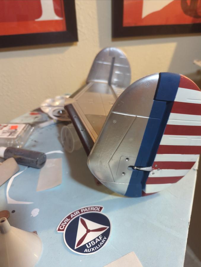

                                Repaint is progressing very nicely. Finished the tail last night.

                                  Looks great! How did you get around the stock decals that are already on the plane? Sand them off, spray primer/paint over them??

                                    I carefully peel them off, trying to prevent as much extra paint from peeling. Then I seal the bare foam to try and restore the patina with Vallejo surface primer.
                                    When dry, sand, trying to feather edges of paint as much as possible. Then usually polyurethane brushed on with a foam bush to level it up to the original paint level. This usually takes several coats with sanding in between. Then when can't feel it, shoot a hit of primer which usually tells me I need to do more layers of poly and sanding until the primer doesn't show the damage.
                                    It sounds like a lot more work than it is.
                                    If the markings are waterslide, usually it doesn't need anything more than a light sanding and paint directly

                                      GT, great technique and tip, Sir. Best, LB

                                    I agree with LB, that sounds like a good technique. The waterslide decals are easier to wet sand off, and then primer and resand to get rid of any evidence of the originals. The "sticker" type decals I have found to be much tougher to fix after carefully pulling them free from the model. There can be some real damage to the underlying foam that they came from I've been able to use a very good automobile bondo type material, but it takes a lot of sanding and re-priming to get the area smooth enough where there is no evidence of the previous decals.
                                    Whatever technique that is used that works, is all good! Very nice work on the Civil Air Patrol repaint that you are doing. Keep up the great work!
