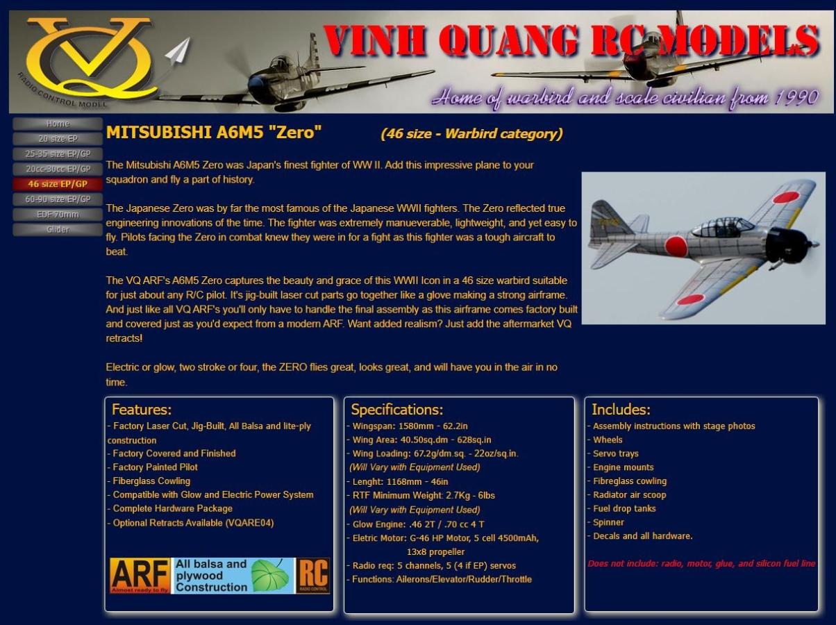

              If you go to the VQ website, the actual manufacturer of this plane, they recommend a 5S battery

              • Joehockey
                • Jul 2019
                • 147
                CJ
                to answer your question , yes that motor will be fine .
                I can only tell you how I have built my fleet of RC warbirds /planes .
                All of my warbirds and sport planes are based on 4s/6s, 12s and all aprox 5000/50c or greater.
                Why ? Out of all the plane I fly and the one I see at my club Warbirds have the greatest tendency to have issues.
                They take skill on take off, things can go wrong , example, retracts, torque roll, slow peed stall. Yes , I know this can happen on any tail dragger however warbirds usually have a heavier wing loading = high skill set needed for takeoffs and landings.
                So when I take a plane ( example ) 6cell Duantless or this zero , I also take my 6cell Kaos . Why ? In the event something goes wrong with one of my 6 cell Warbirds , my trusty reliable Kaos is ready to fly, enjoy and deplete the battery ,,,,, this last part is the most important.
                I really dislike depleting a fully charged lipo or one with 75% or greater capacity left because something went wrong with my warbird.
                Second biggest reason for my power choices is wanting at least 100 watts per pound minimum on a warbird. You can easily fly at 75% power, scale and enjoy longer flying time.
                Third and very important is that the Zero, Corsair, FW190 ect all typically need nose weight.
                My VQ dauntless balanced perfectly on 6s with no weight, I know for a fact guys added weight on the 4s and the difference was virtually the same weight if they has chosen a 6s.
                Why add dead weight on any epowered model ?
                Last winter I converted a 80” Zero that I purchased from a friend , remove the over G62 gas engine along with 4lbs of dead weight into a 50cc motor -12S system and zero added weight.
                The key to this story is functional weight on epowered planes is critical to success !

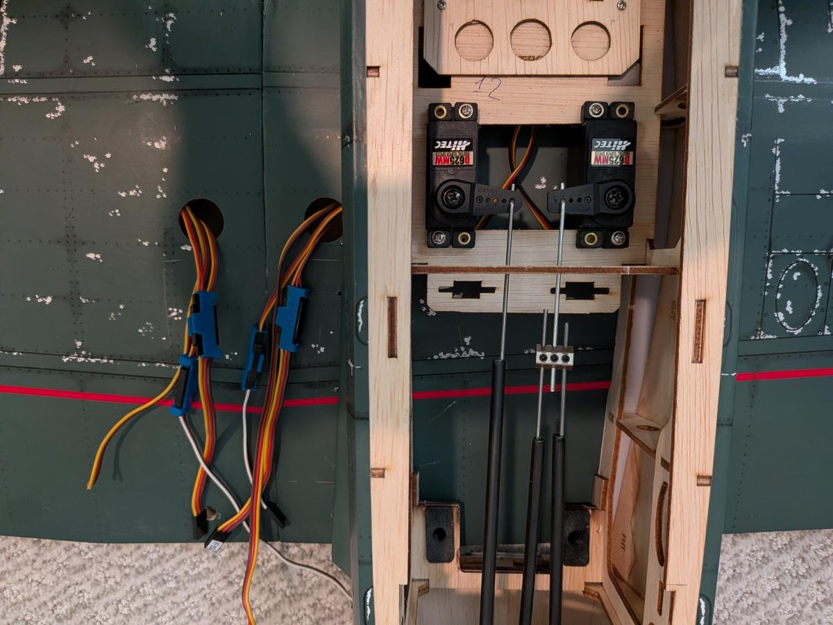

                                  • fredz99
                                    • Jul 2025
                                    • 4
                                    #18
                                    Bought the Nexa/VQ A6M kit in Oct 26, electric power. Thought I would comment on a problem, depending on how you transport the model. The openings for the rud/ele servos are forward, behind the battery platform. Also, the servos are directly over the openings in the wing where the servo leads exit. There is no aft platform for the receiver (or other electronics you may want to install). If you wanted to install an aft platform the rud/ele pushrods are above that space and would interfere with top access. If you transport the model with the wing attached, you could tiewrap the receiver to the inside fuse sides or to the wing under the rud/ele pushrods. I don't have the space in my vehicle, so need to remove the wing, plug/unplug the electrical connections (servos, LGear). Had VQ mounted the rud/ele servos toward the rear there would be room for a receiver platform with top access. I've relocated the servos aft. I wouldn't buy this kit again. Too many mods to make it easy to transport. (Even with the servos in the stock location, with a 4S/4Ah battery and motor, the model is tail heavy.) Photo shows the stock servo locations.
