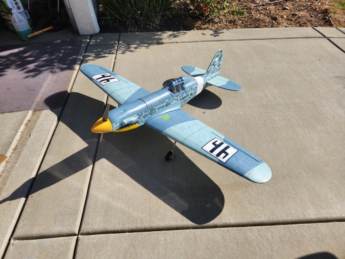

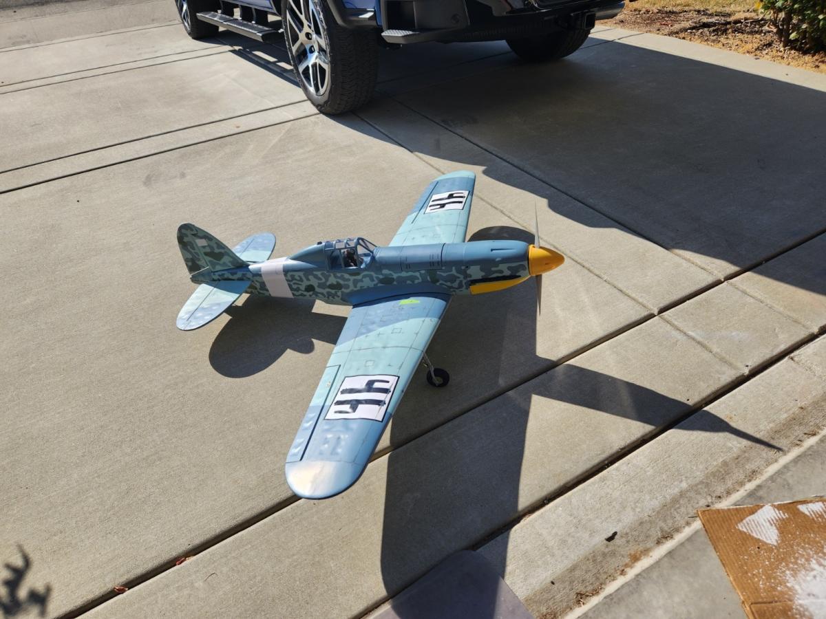

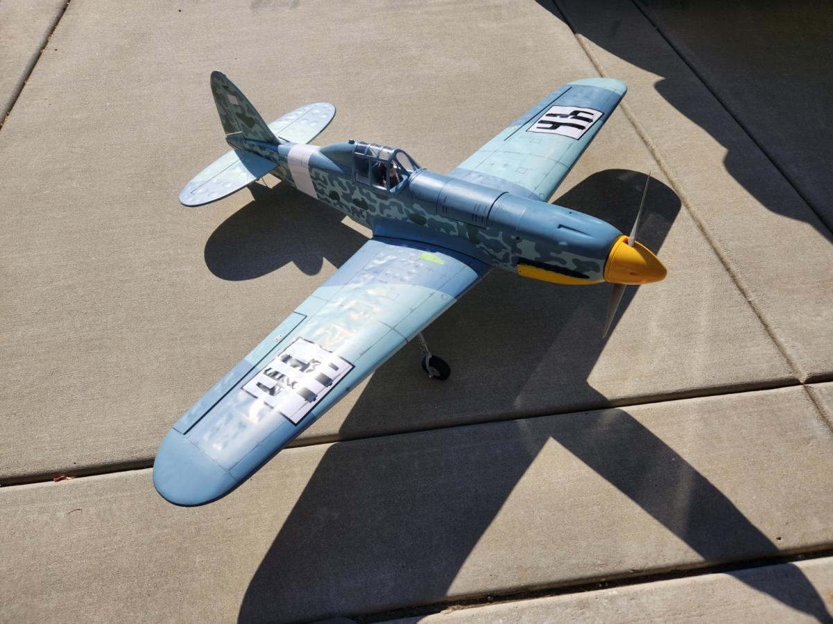

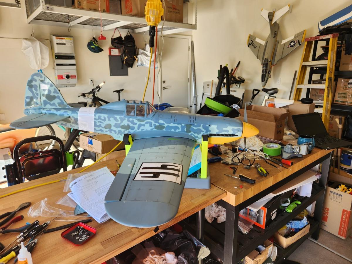

          Finally got around to building this. Went with a badass power system 3530-700 , talon 90amp and a 13x8 prop so i can run 5 cell. static watts are 1185 58amps with this. 6 cell gets 1650 and 78amps Also using eflight retract s and the oleo's in the specs.
          Still need to put the stickers on. my first balsa ARF and it was not to difficult to build although some things are not included in the manual. Looks pretty good but much different from the pictures. The camo is not as dark as shown.
          have not flown it yet, hopefully next weekend.
