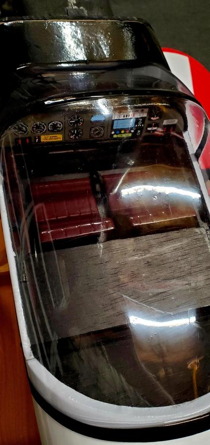

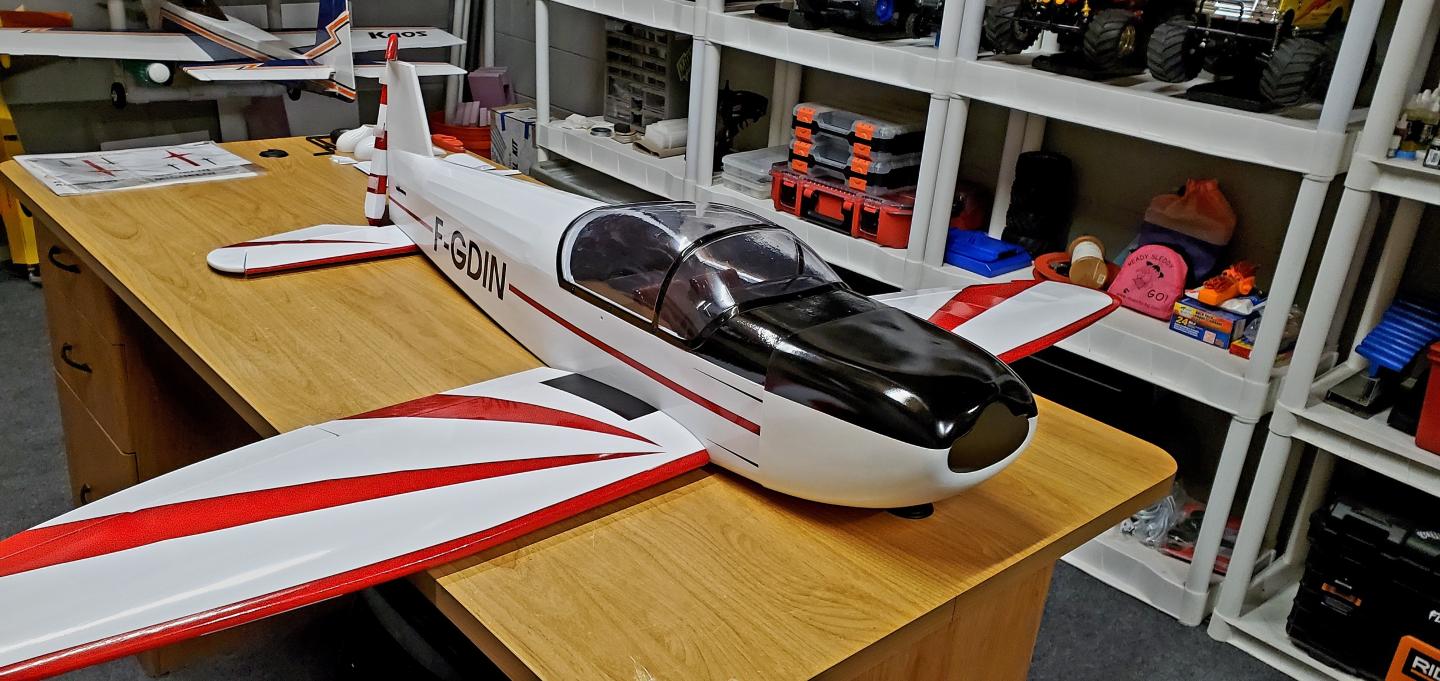

      Mine arrived today. I've assembled several NEXA / VQ models and this one looks as good as the others. All control surfaces use metal pin / plastic hinges, not CA style hinges as listed in description. I will assemble using a 6S power system. No idea why Motion RC recommends two 4S batteries in series...8S would be crazy for this plane, it's not that big. Also, I'm not sure two 4S, 4,000mAh batteries would fit properly. There was no pilot figure in the box, so that is kind of a bummer. Cockpit looks nice though. Click image for larger version  Name:	20230331_172852.jpg Views:	0 Size:	161.7 KB ID:	374958Click image for larger version  Name:	20230331_174950.jpg Views:	0 Size:	61.5 KB ID:	374959

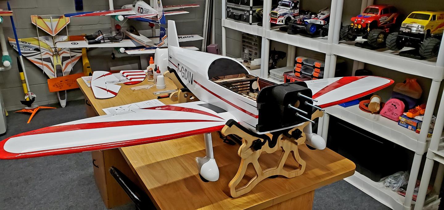

        Wings finished and installed. Pretty straightforward.
        Couple items to note. The manual says a normal and reverse servo are required for flaps. This is not true, as the flap pockets are designed in such a manner that you can use two normal servos. My VQ Agwagon was built the same way. Also, Motion says to use micro servos (HS-82mg size) for flaps. They will work and save some weight. Standard size servos will also fit.
        Next up is motor install. The manual has NO instructions for how to install an electric motor, even though an electric motor is listed as one of the "required items"...🙄
        Fortunately, I've done a few of these before and it's a relatively standard NEXA / VQ process. Still, some instructions would be nice... Click image for larger version

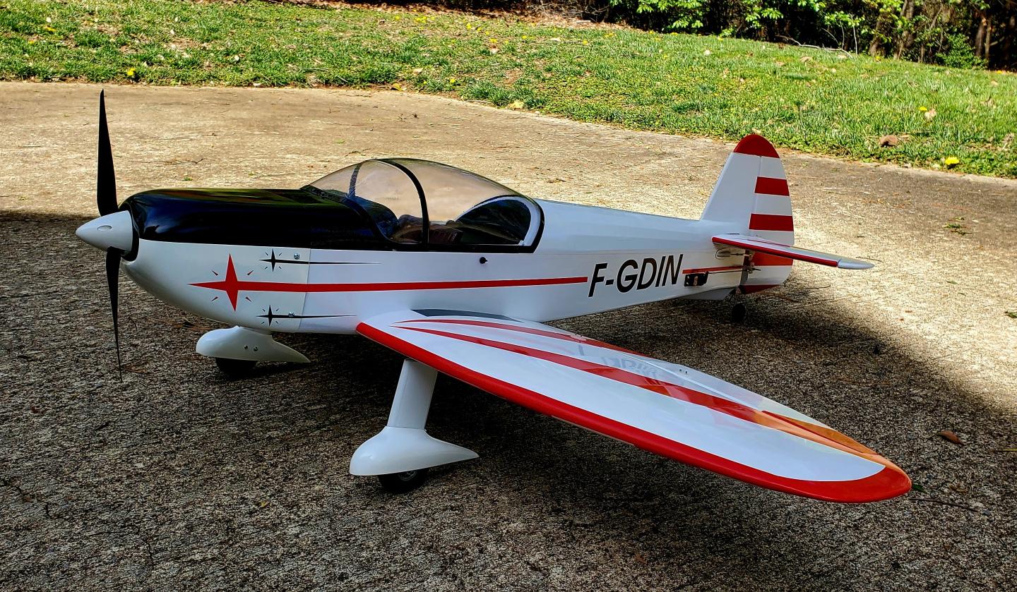

          Ready for maiden! Really like the looks, hoping for a good result. I did need to add some mass to reach an acceptable balance point. I had to do the same for my VQ Agwagon and NEXA L-4 Grasshopper, so not a big surprise with this model. Wheel pants were a major pain in the arse, very fiddly and the design / fit could be improved.
          I'm using a Suppo 4120 / 620kV motor with 80 amp Hobbywing ESC and 6S, 4000mAh battery. Prop is 13 x 8. Watt testing was good, has plenty of power. Click image for larger version
          • #6
            I had an OK maiden flight.
            The forward CG point in the manual is what you want, anything behind that point will result in very sad handling. Some planes you can get by with that a little bit, not this one, at least based on my maiden results.
            I decided to add more mass inside the cowl to move my balance point a little more forward and the handling was much improved. It's a heavy plane, mine is six pounds with a 4,000mAh 6S battery secured fully forward on the tray.
            ​I also changed my prop to a 13 x 6.5...still has very good performance with less stress on motor and battery.
            Did a re-maiden and it flys much better. Rolls are quick, nice big loops, knife-edge is decent. Pretty smooth flyer. Only a few clicks of aileron trim was needed.
            The flaps definitely help with creating extra lift for slowing down to land. Flaps up landings are rather speedy, but manageable.
            ​​​​​​I would not recommend grass landings if you mount the wheel pants, because they will most definitely catch and the gear wires will turn into twisty pretzels. Three-point landings on asphalt are nice.
