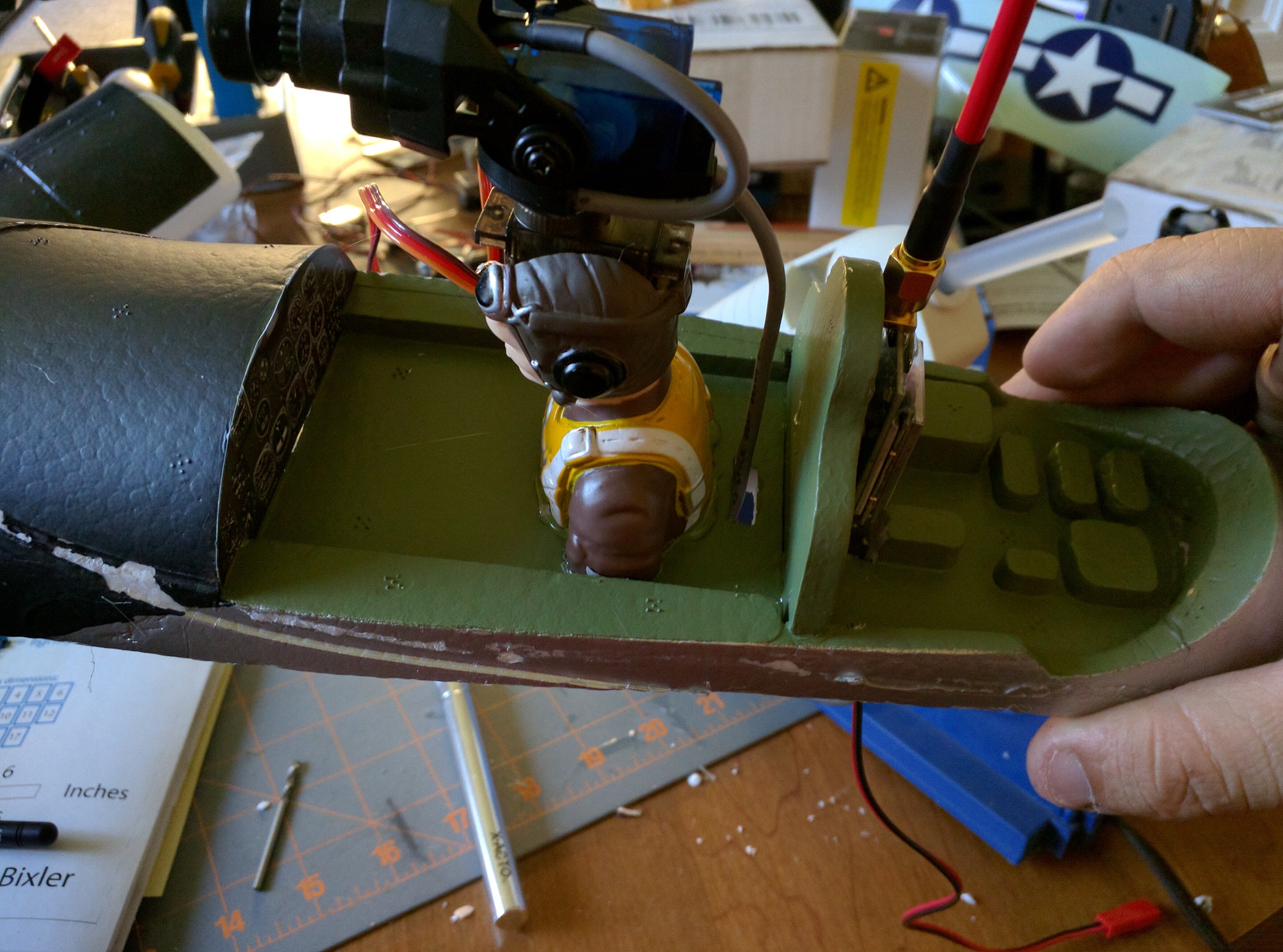

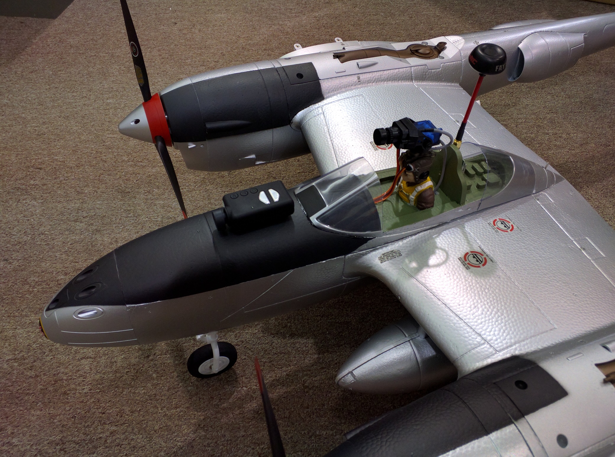

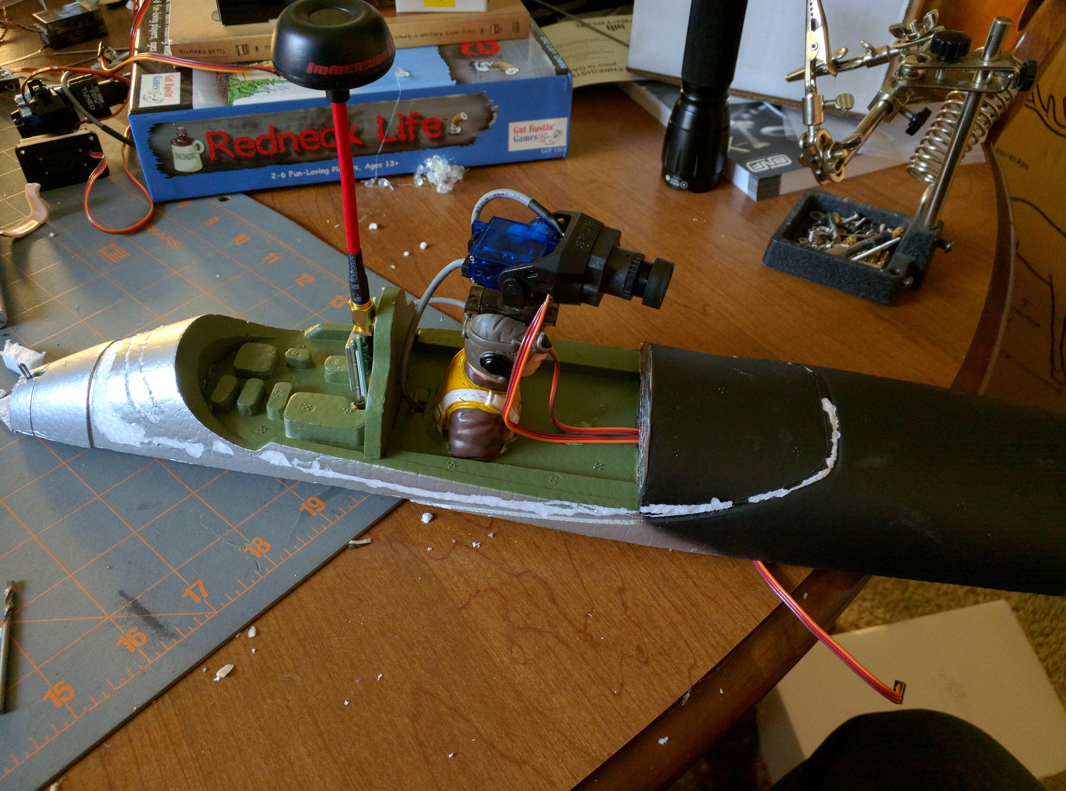

    The pictures attached to this should correspond to the build sequence, so you guys have something to reference if you do this yourself. This is just a quick, down & dirty build.... not going to do anything fancy (yet) Depending on how this setup works out, I'll maybe get more elaborate on details the camera can see ;) (edit: for some reason, the pictures didn't attach in order?!? so, I'll play with this some... try to fix it.)

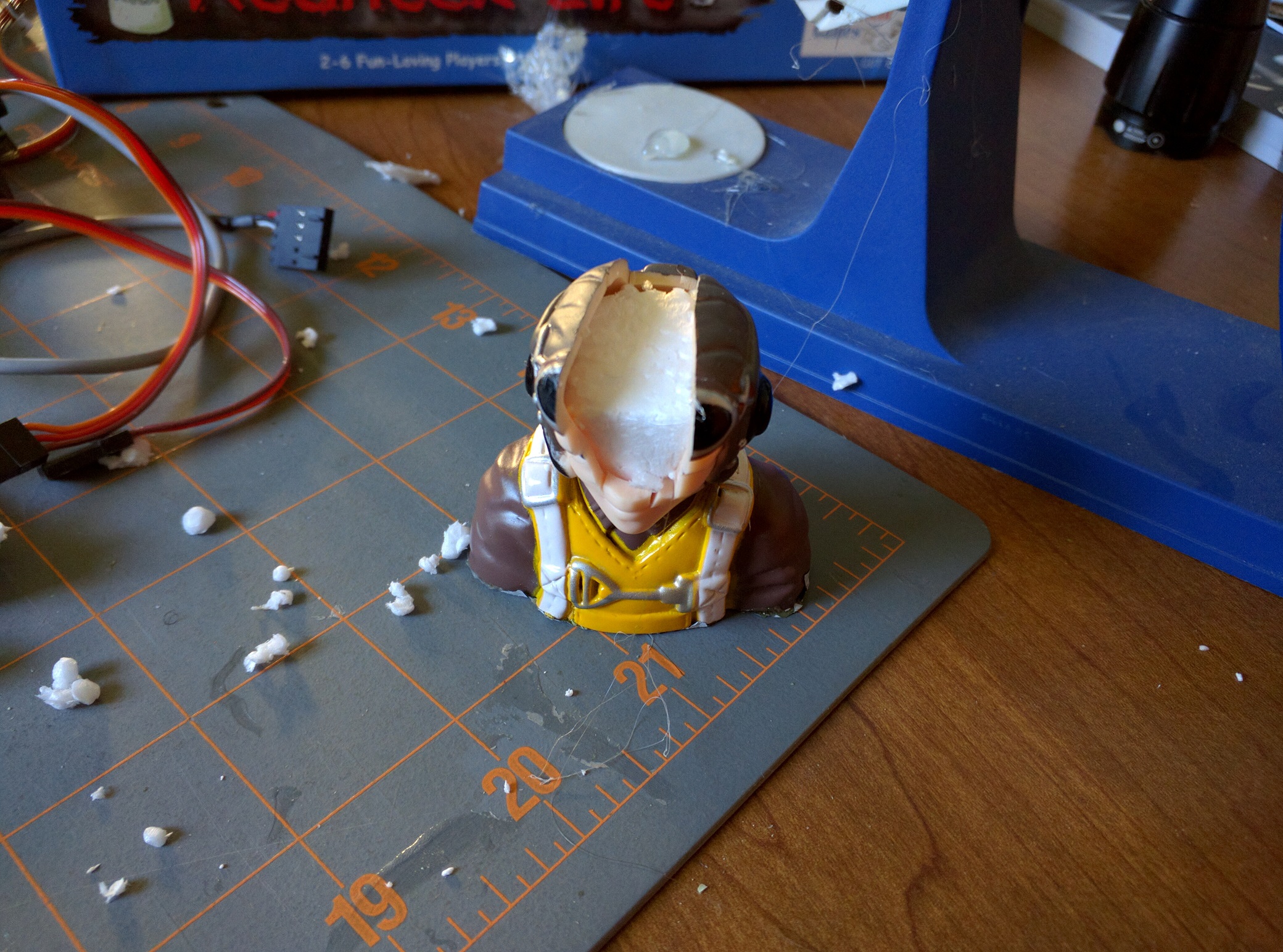

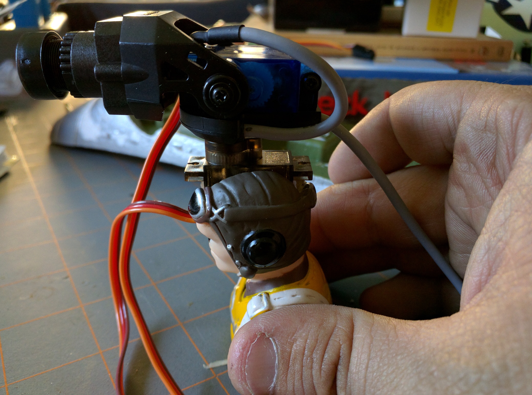

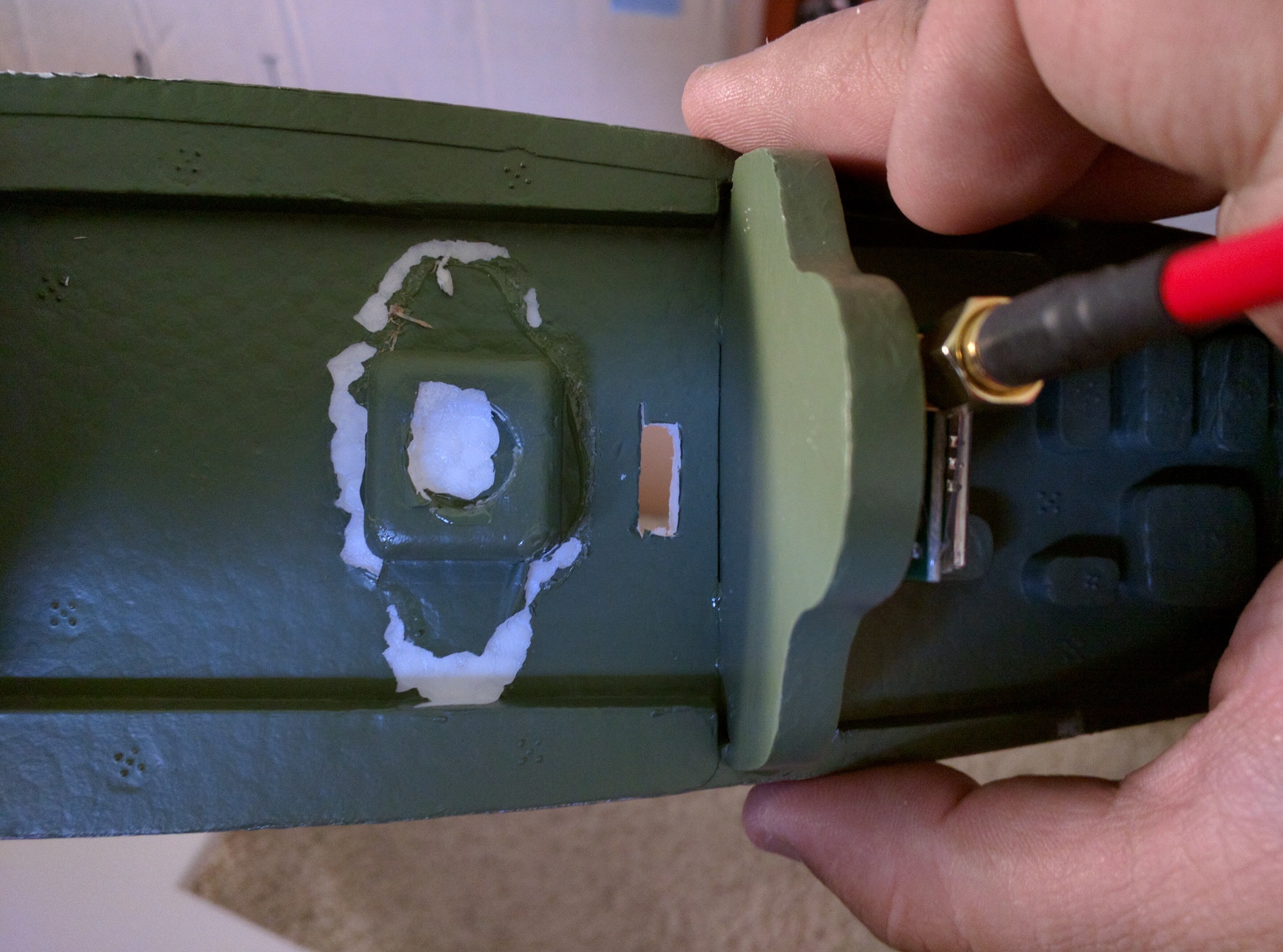

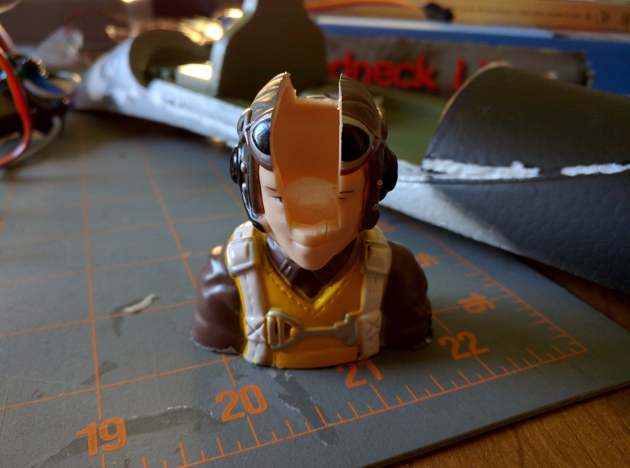

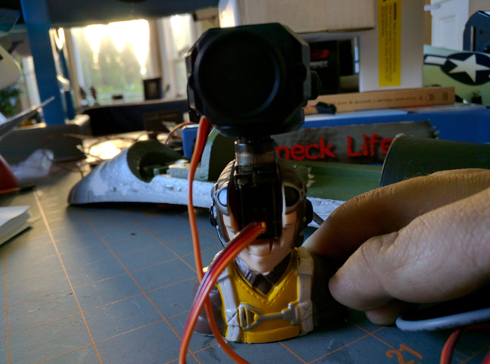

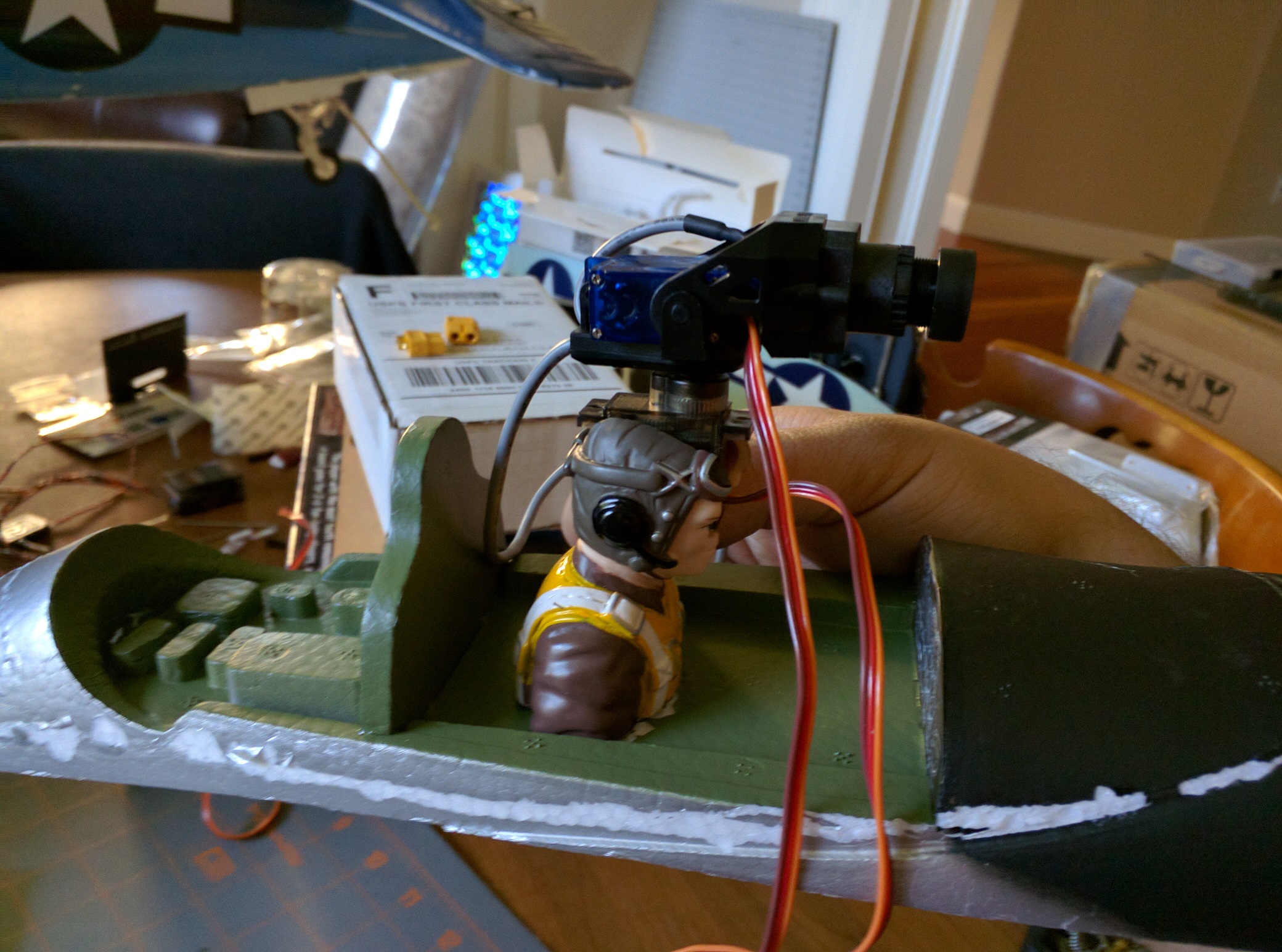

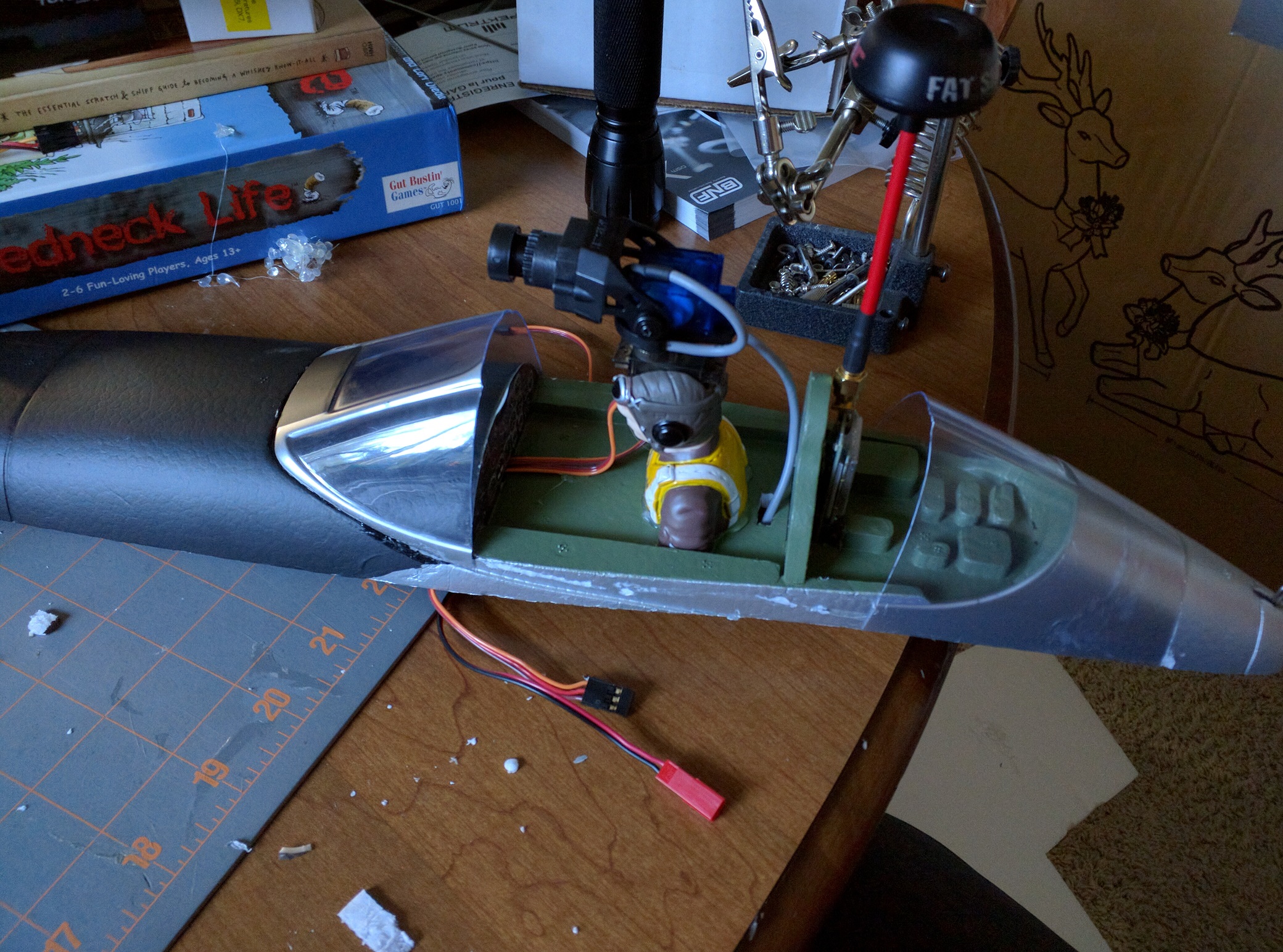

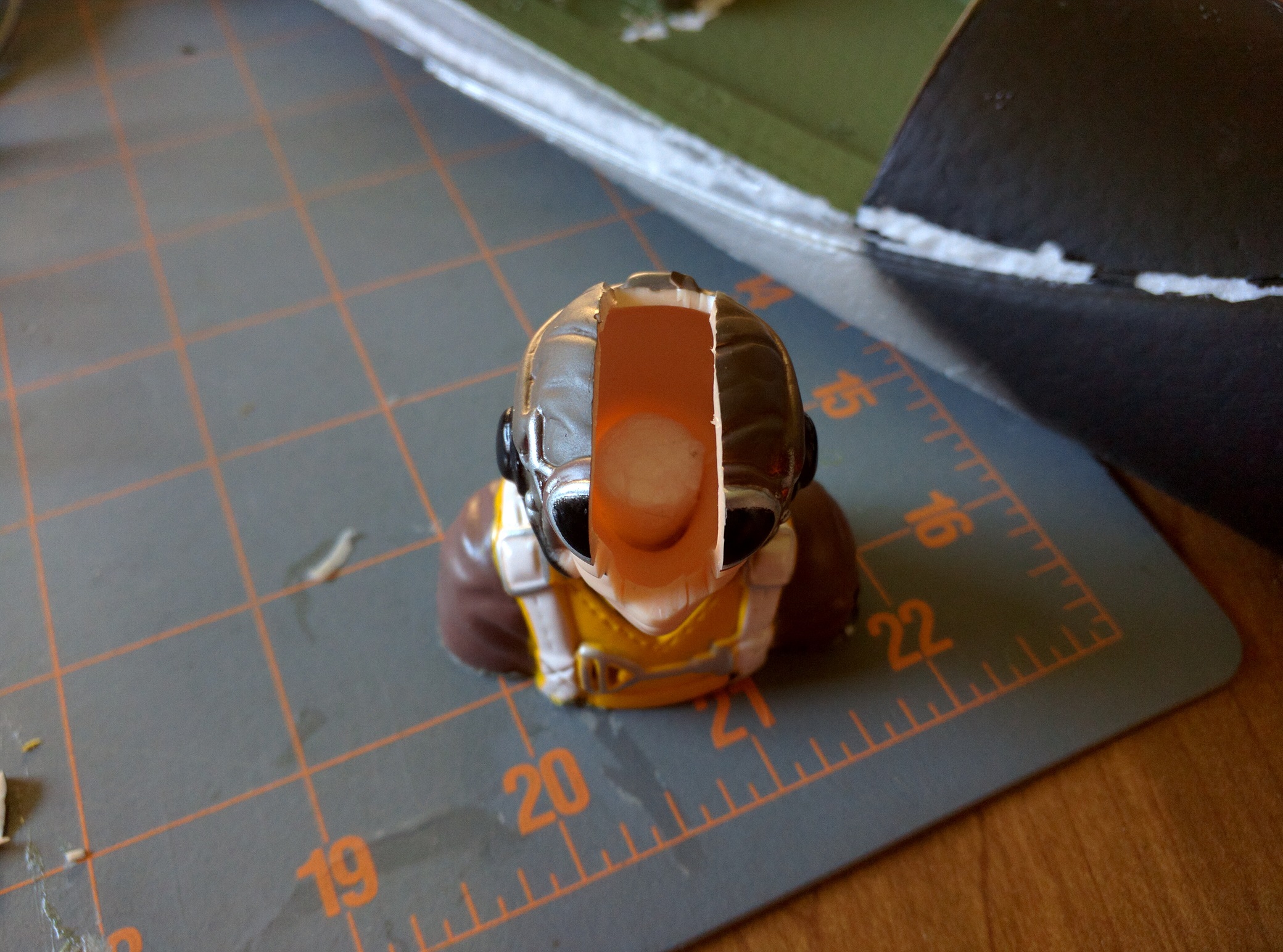

    so... first things first, you got to find a place to mount the camera. Since you want the view to be similar to what the pilot would see, I figured I'd mount the camera in the pilot himself :D If you give him a good pull, the glue will give way and he'll come right off.

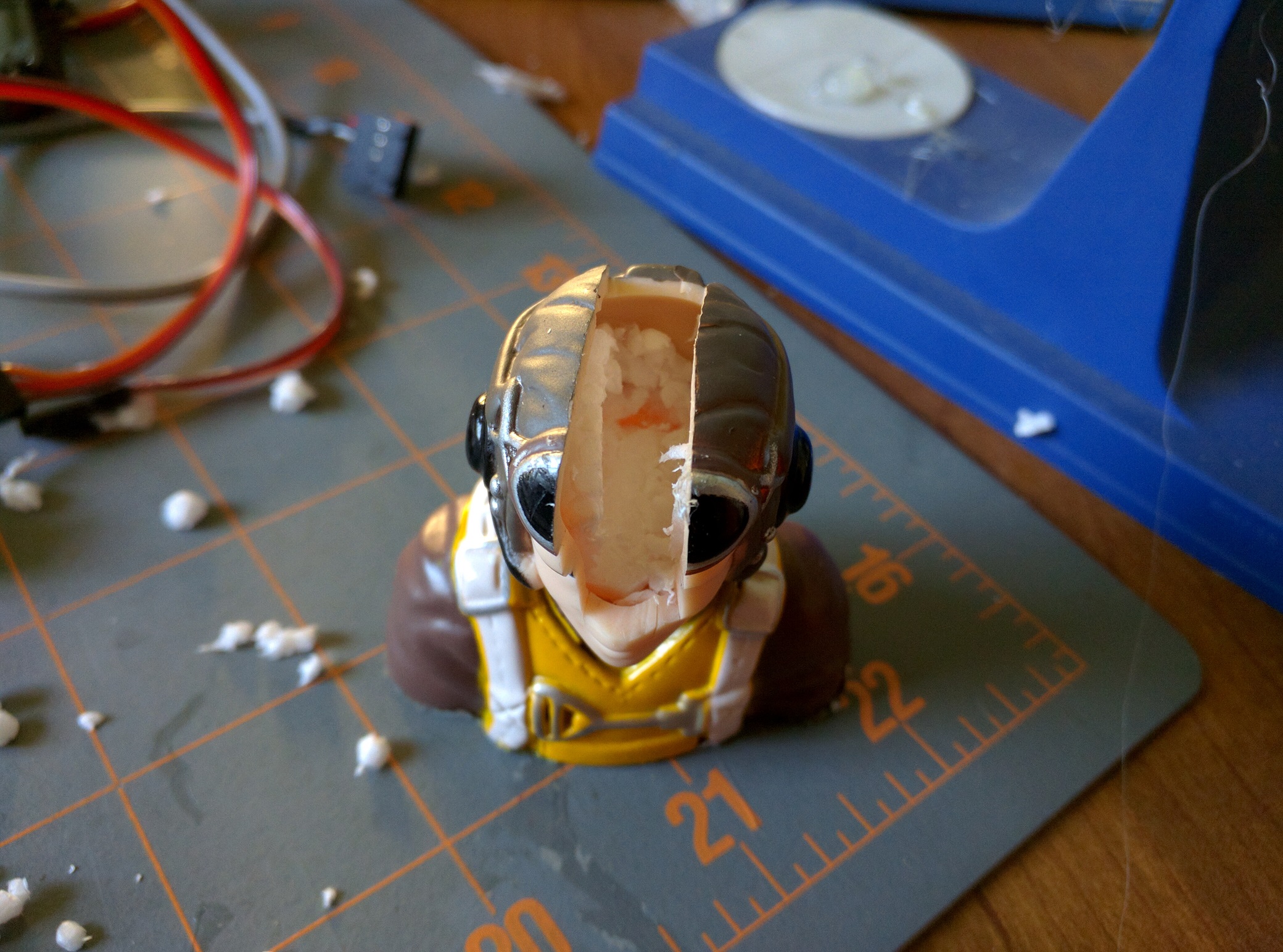

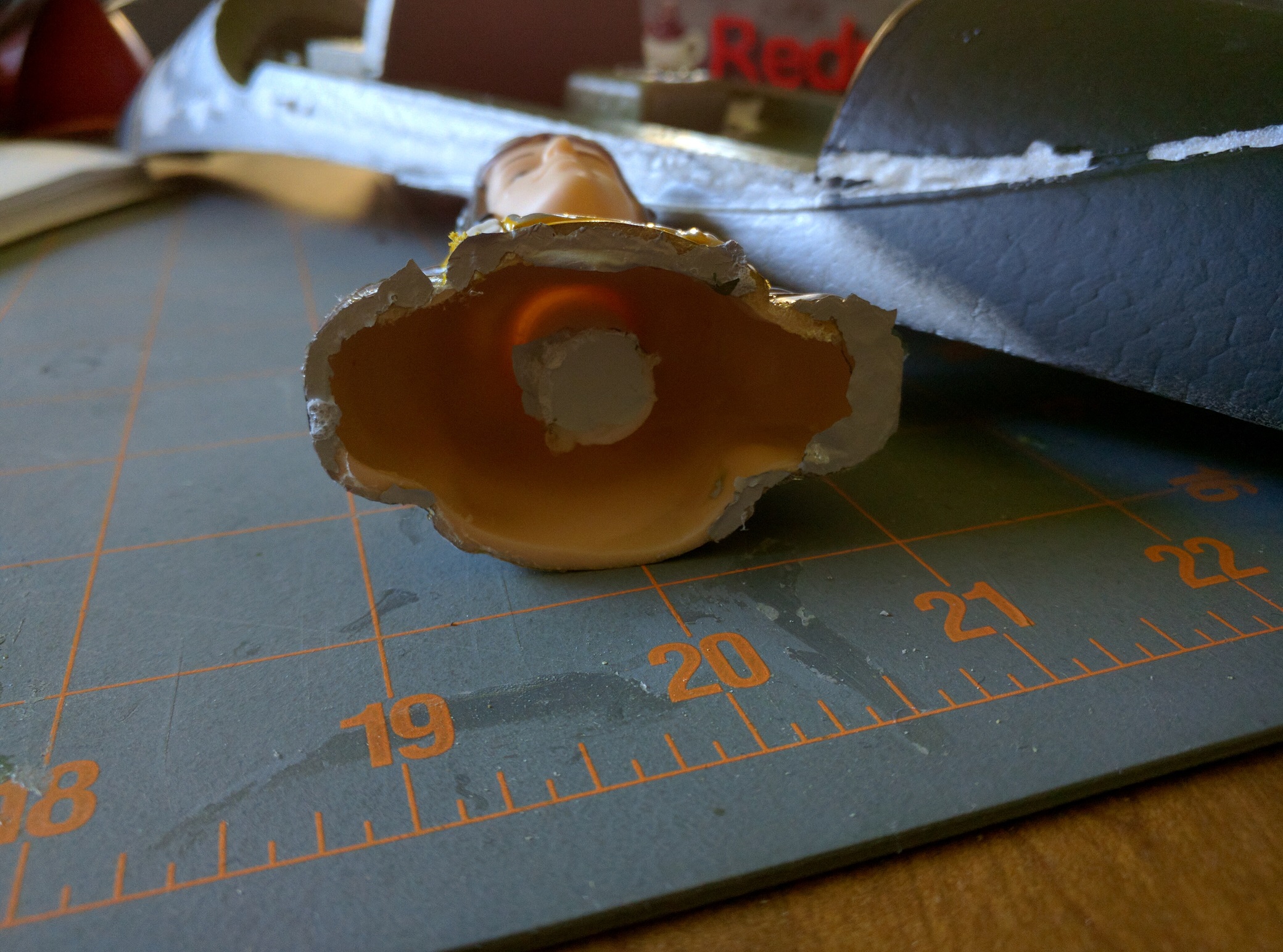

    Eyeballing the servo on the camera gimbal, it looks like it fit nicely in the head. So, I cut out a section in the center that the servo will fit nicely to. Although the pilot is nice and sturdy, cutting into him I found that he was hollow. This actually turned out to be a good thing, as I wanted something within the mount to help with vibration damping. So, I cut a piece of soft styrofoam to fit in the head and used some hot glue to hold it in place. Then I just cut out the cavity again so the servo will fit.
    be sure to check your fit as well as your alignment as you do this. put the pilot back in it's spot and check your angles, make sure the camera is square... otherwise your picture will be cockeyed, which you don't want.

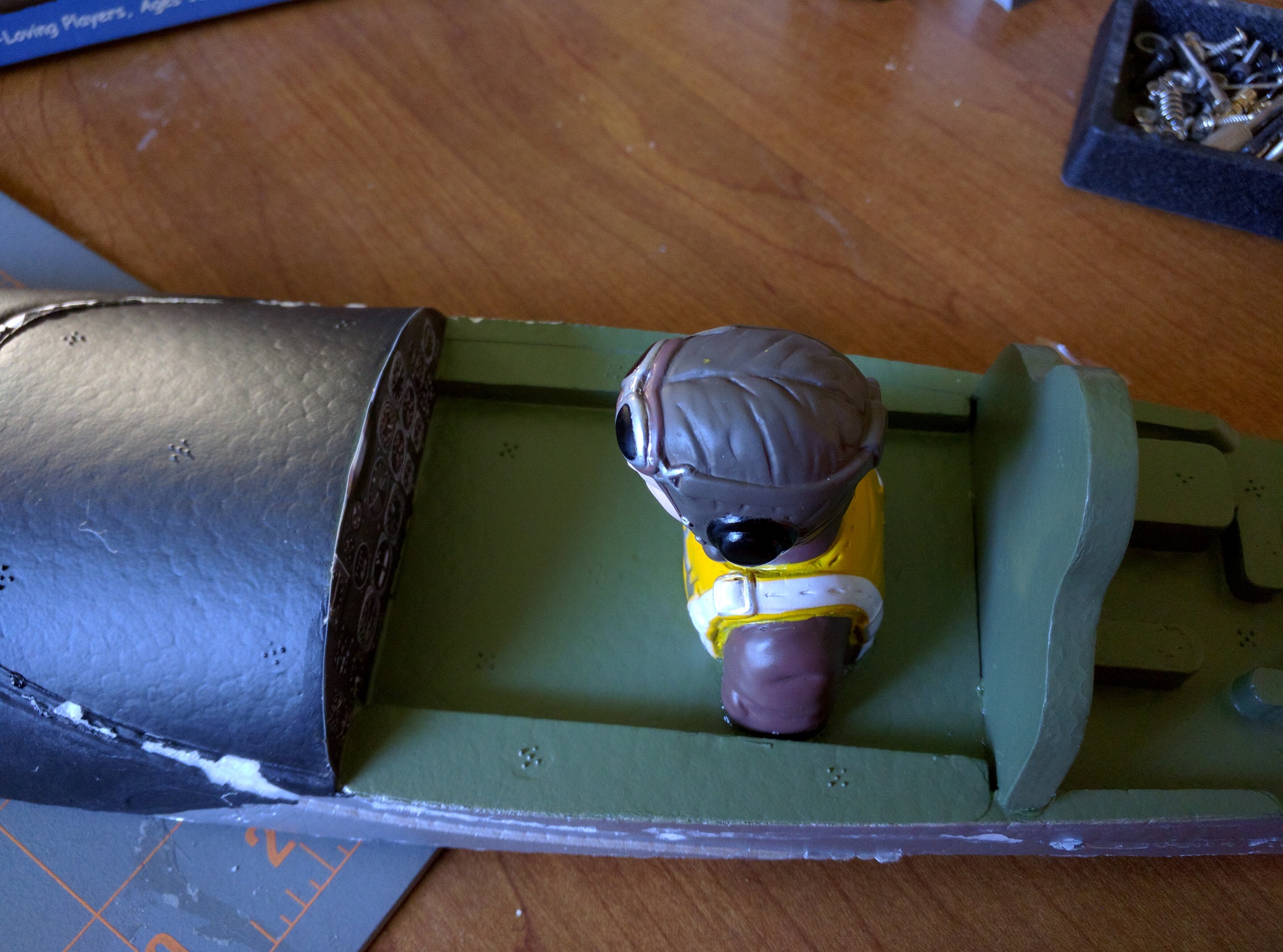

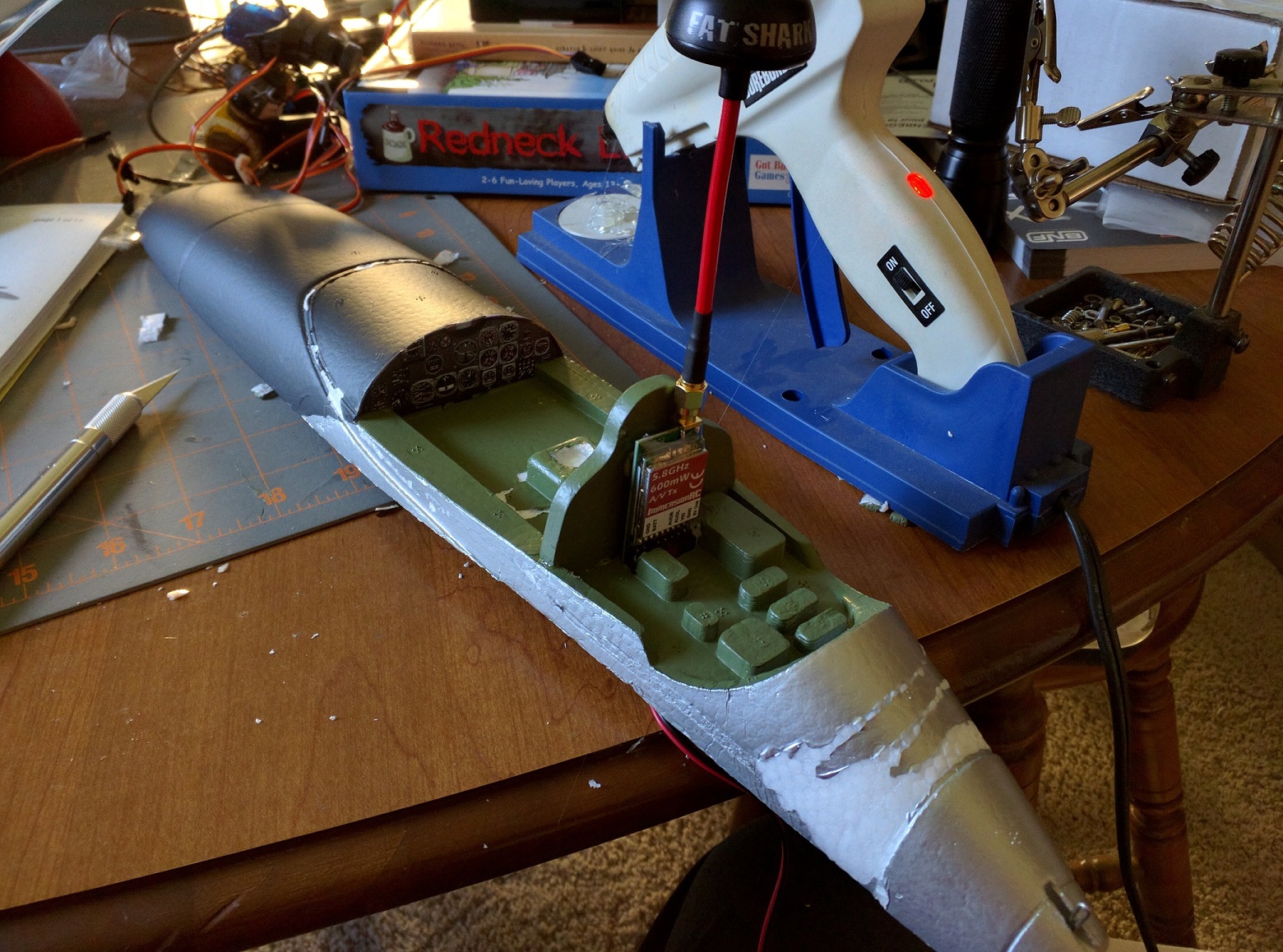

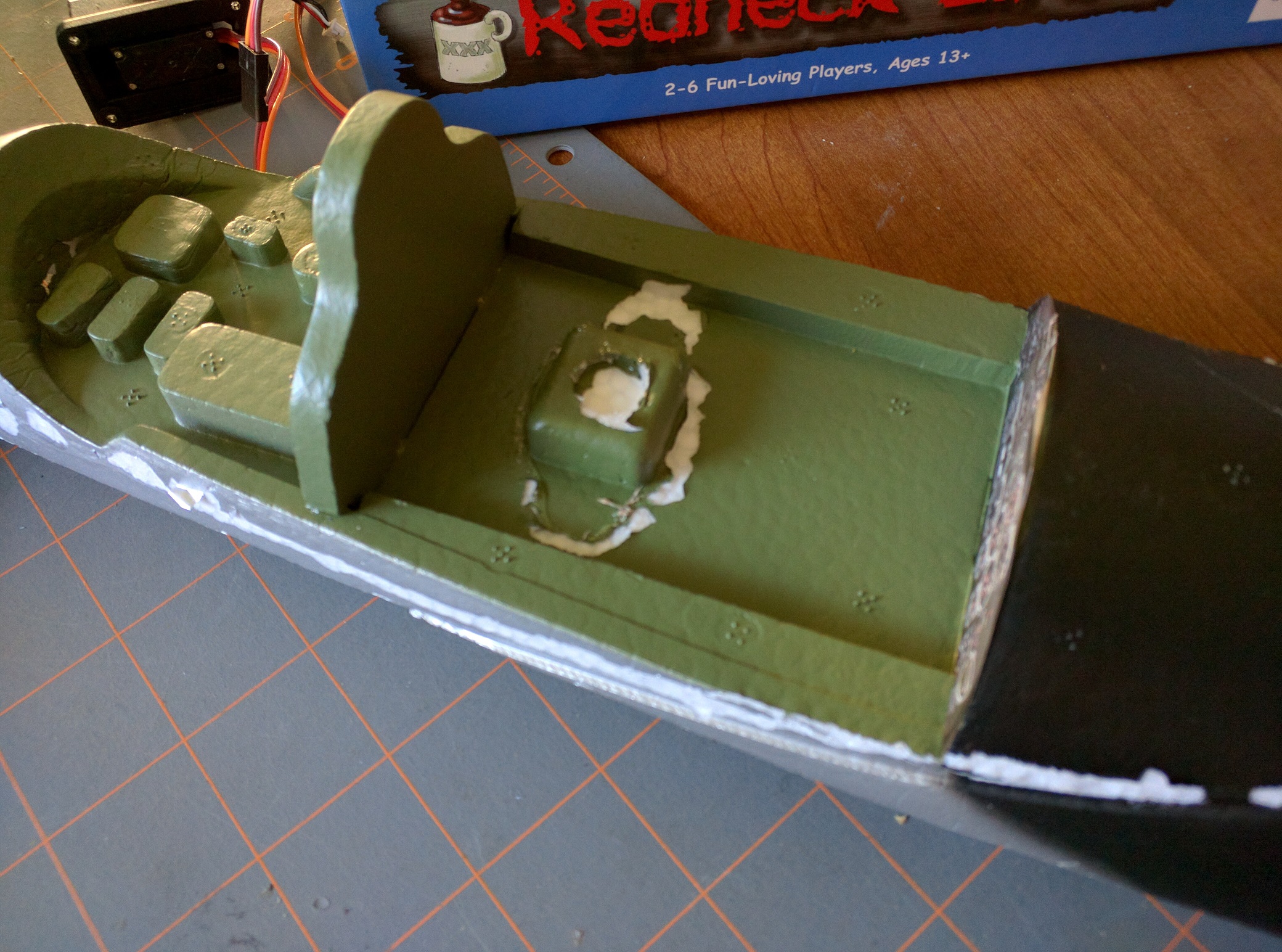

    Once I checked my fit several times, I glued the servo in place in the head; and then proceeded to mount the transmitter. That nice vertical divider between the pilot and the radio area should work nicely! I cut out a section that will expose the connectors, and proceeded to keep cutting small chunks out until I could snugly push the connectors though. Then I used a little dab of hot glue to help hold the transmitter to the divider.

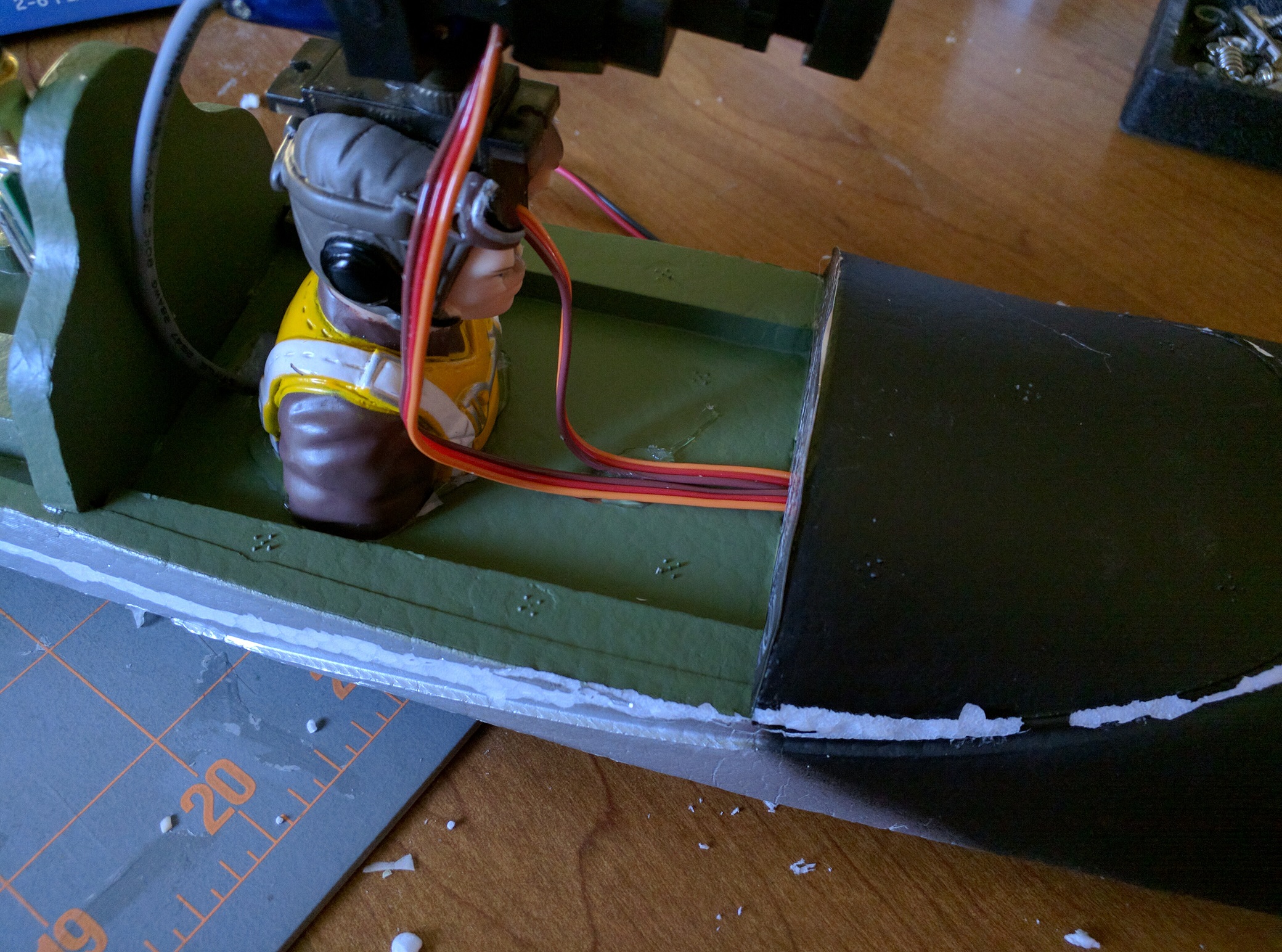

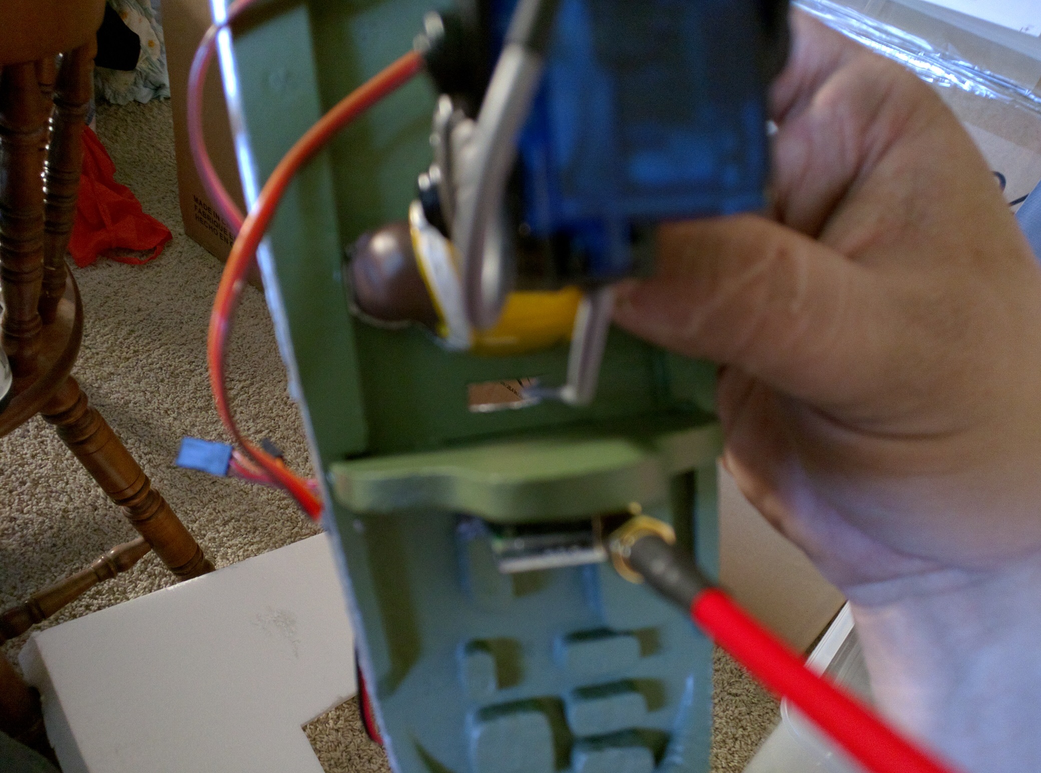

    With the transmitter mounted, I cut a small hole on the pilot side of the divider so I can fish the video feed cable though to the connector on the transmitter. Then I could glue the pilot back into place on his mount.

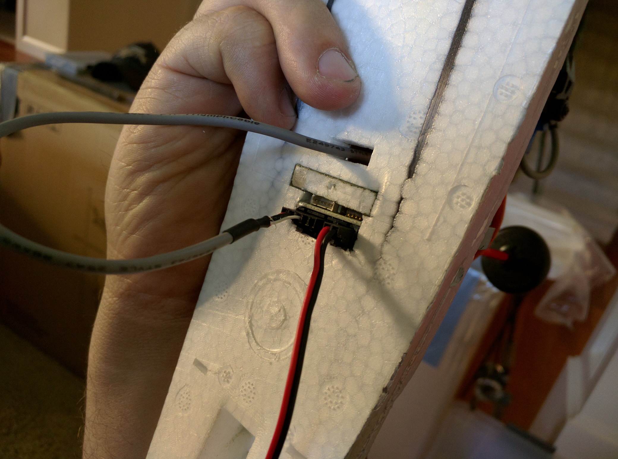

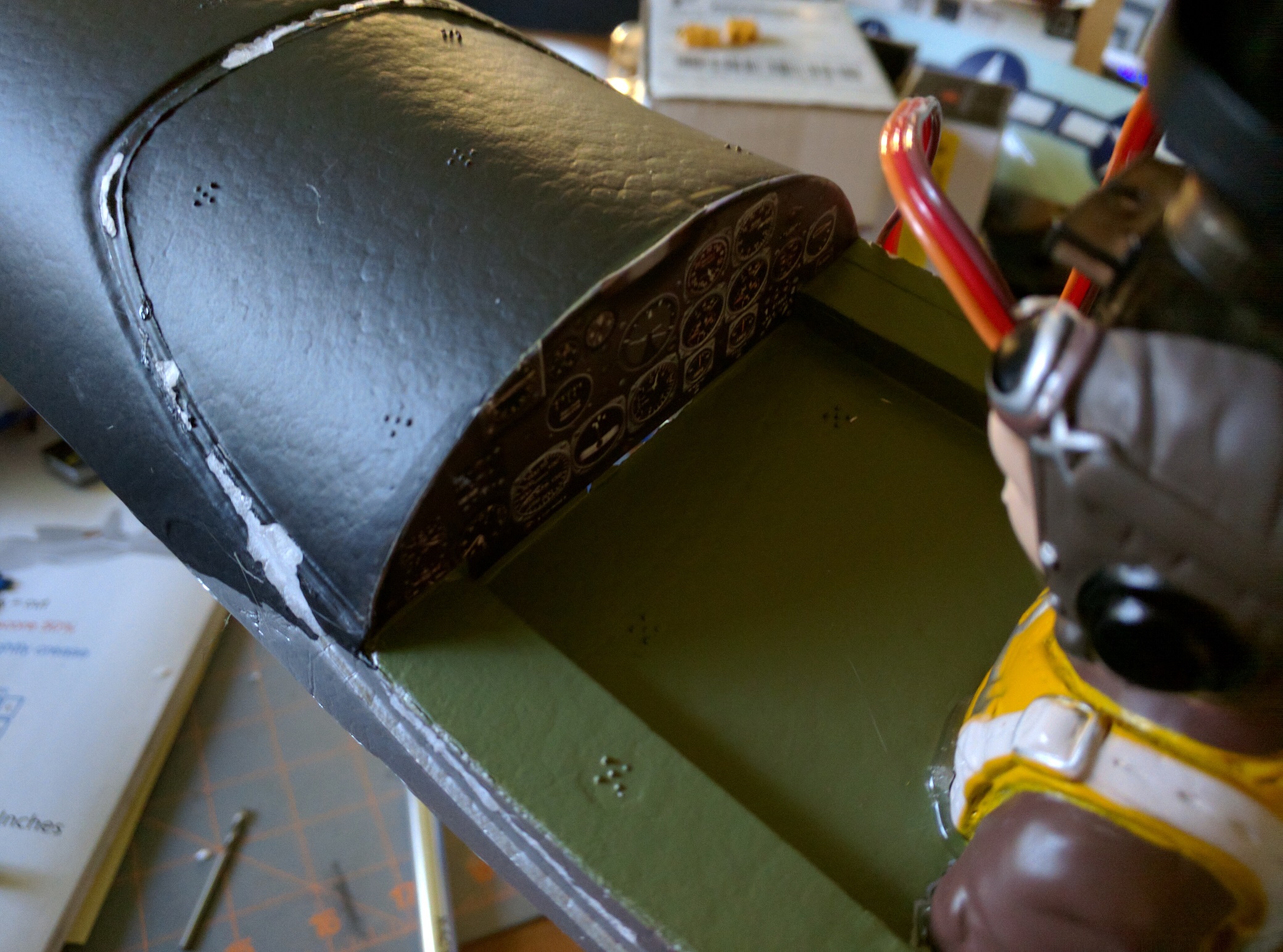

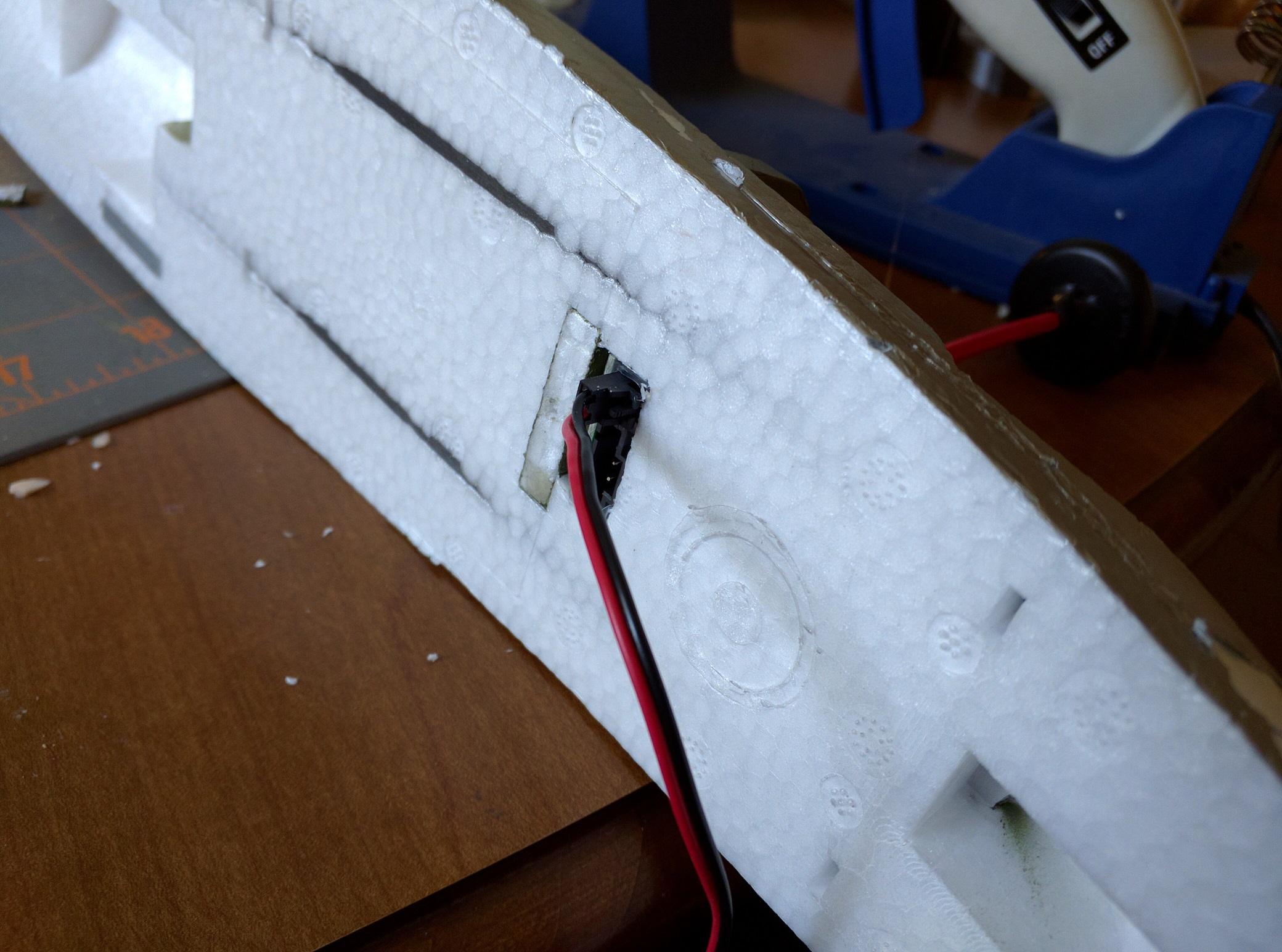

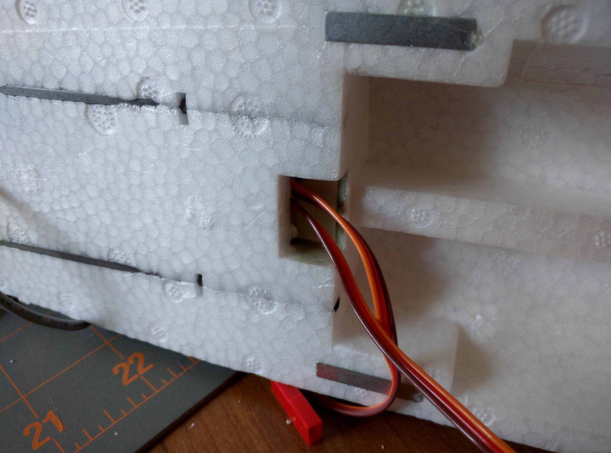

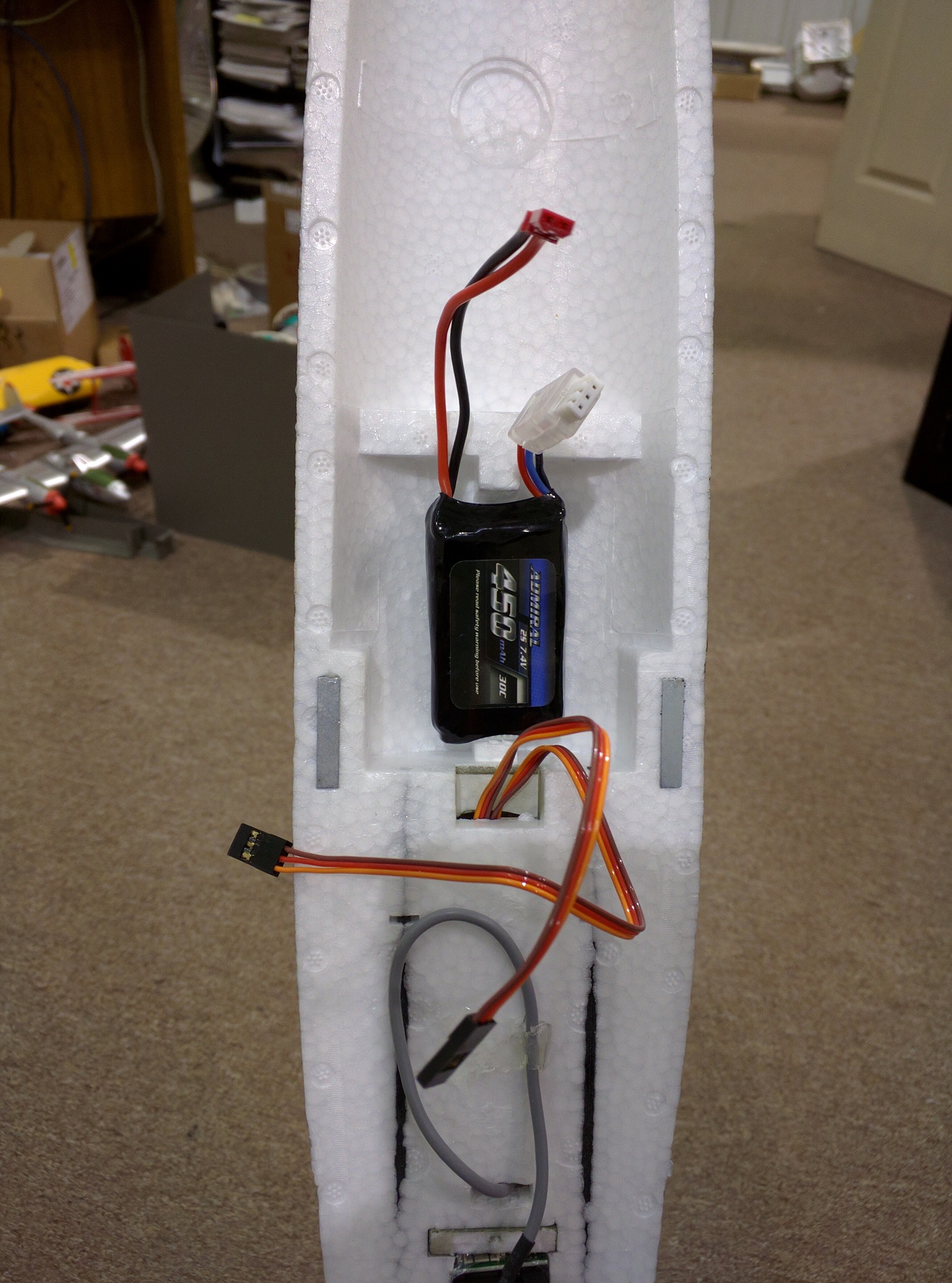

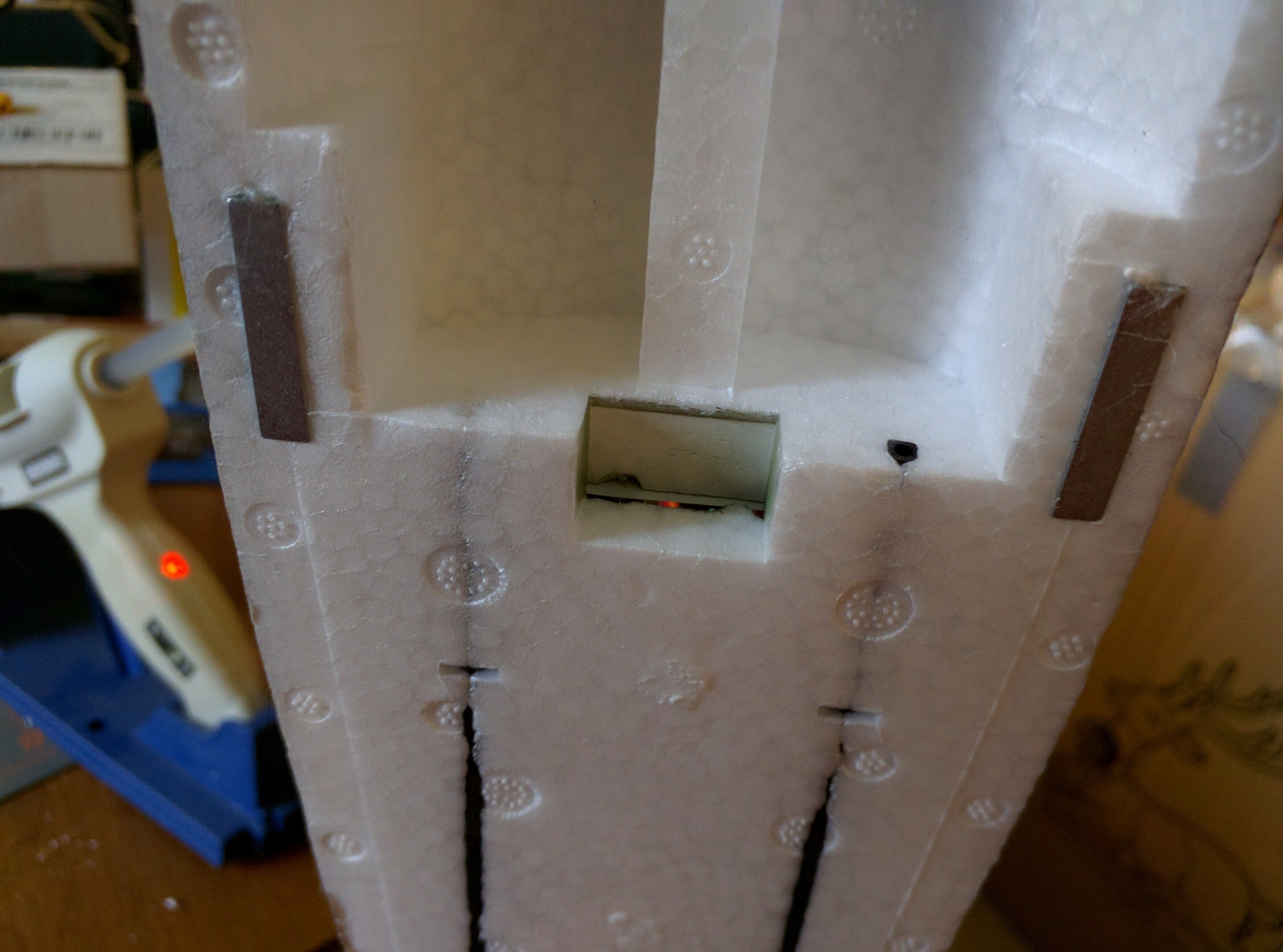

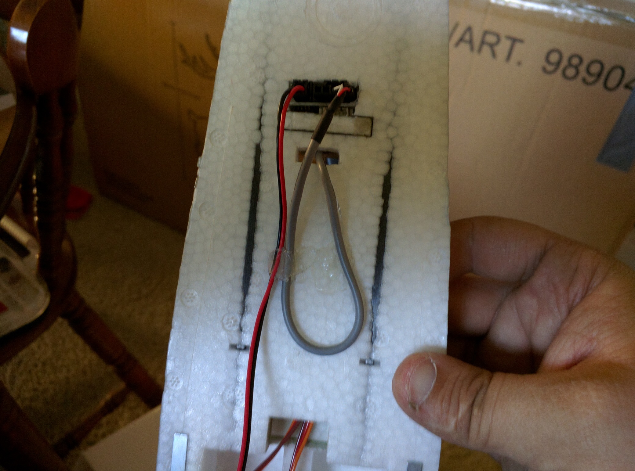

    With the camera/pilot & transmitter back in place, the last bit of wiring to do is to fish the pan & tilt servo leads down into the plane. I found the perfect spot right underneath the dash as there was already a little slot there. Using a small dab of hot glue, I tacked the servo leads down to the base so they will be out of the way. Be sure, if you do this, that you've got plenty of wire available for the gimbals movement. On the underside, I also used a small dab to secure the excess video cable to the underside of the canopy. Again, make sure to leave enough for the camera to move freely.
    Since I don't have the two cell battery just yet, I couldn't mount it. But, I found a nice area just behind the dash that should house it nicely

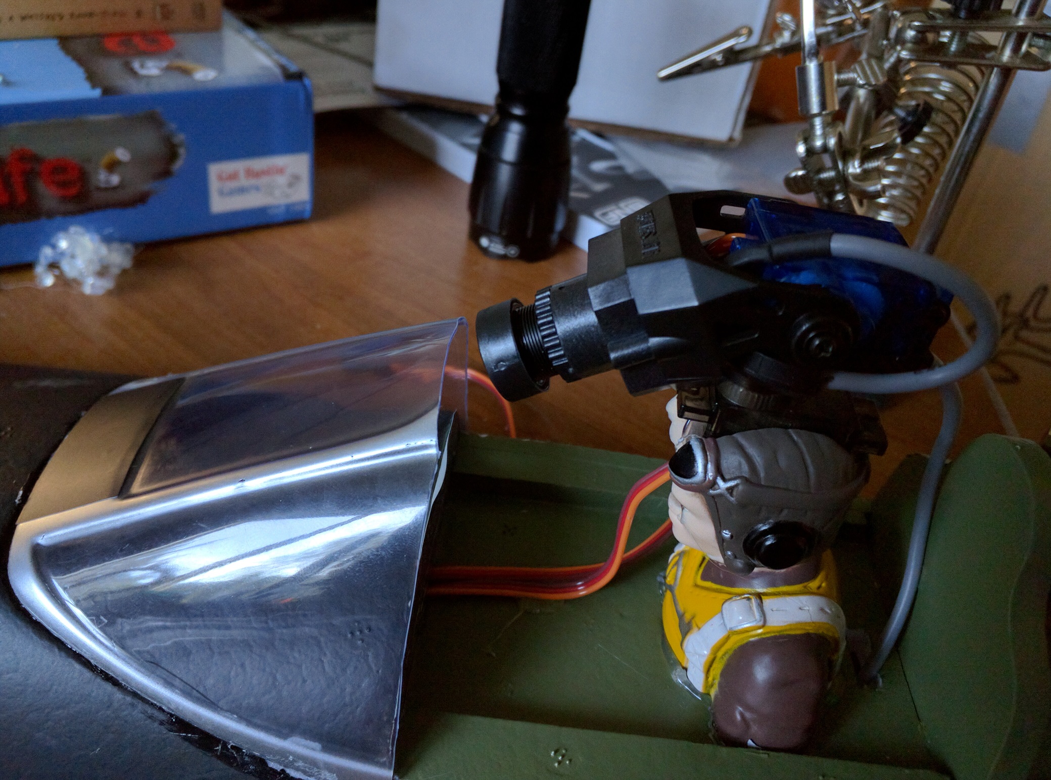

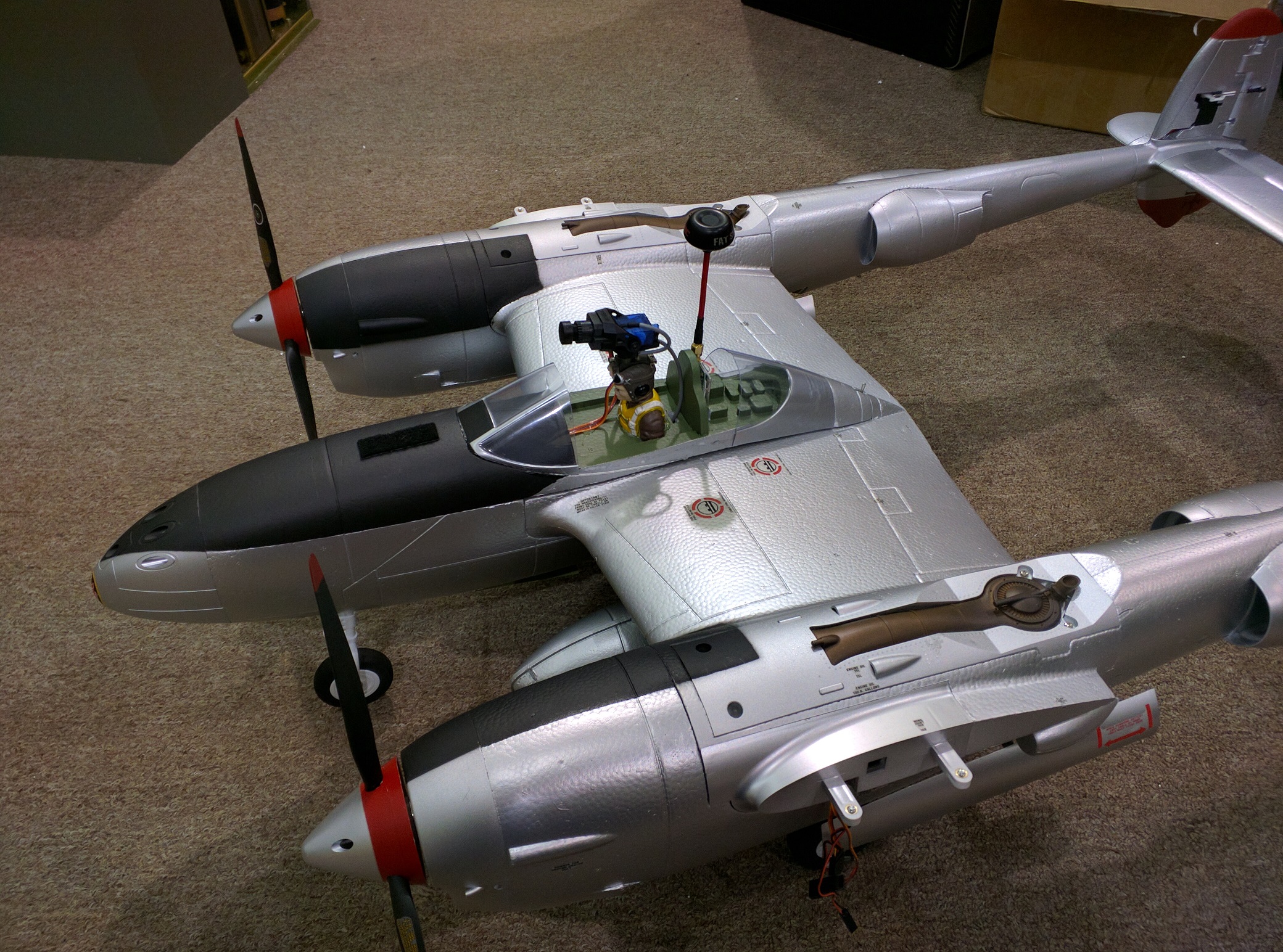

    I also decided to put some of the glass back... mainly because I don't like painting :P but also to try and keep as much of the look as I could. If you do this as well, be sure to check clearances for the camera so it doesn't hit the glass at all.
    That's as far as I can go with the project for now :) When the battery & receiver show up, I'll add onto this and how it looks on the plane.

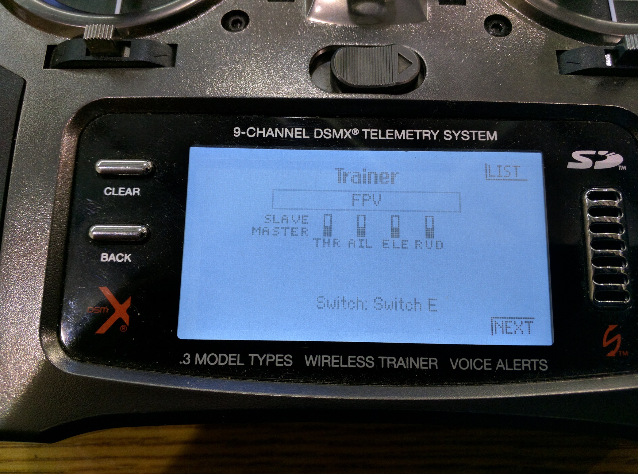

        Radio: Spektrum DX9

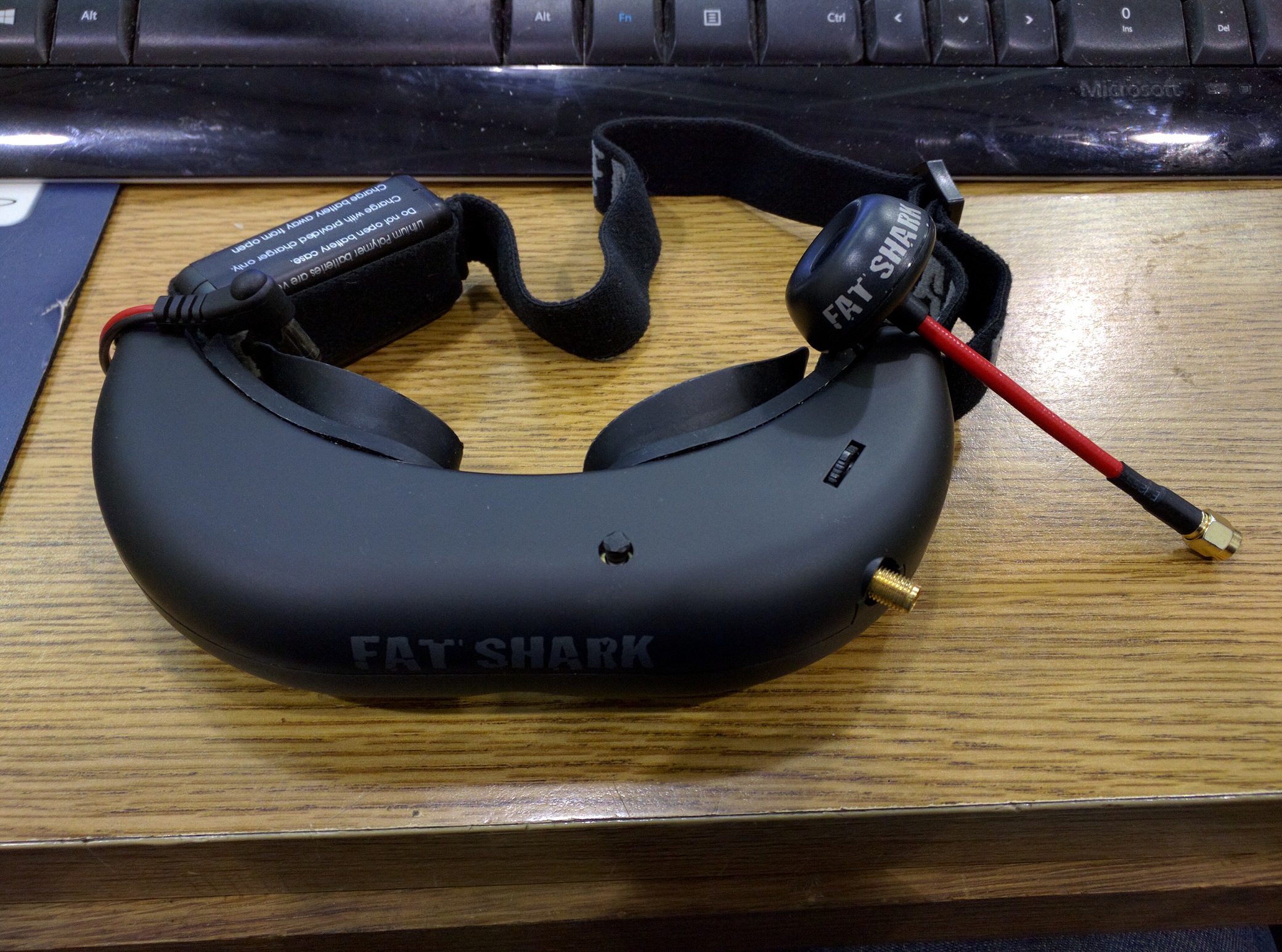

        Headset: Fatshark Attitude V2
        Head tracking cable: <http://www.readymaderc.com/store/ind...th=11_22_489_4 90&products_id=676>

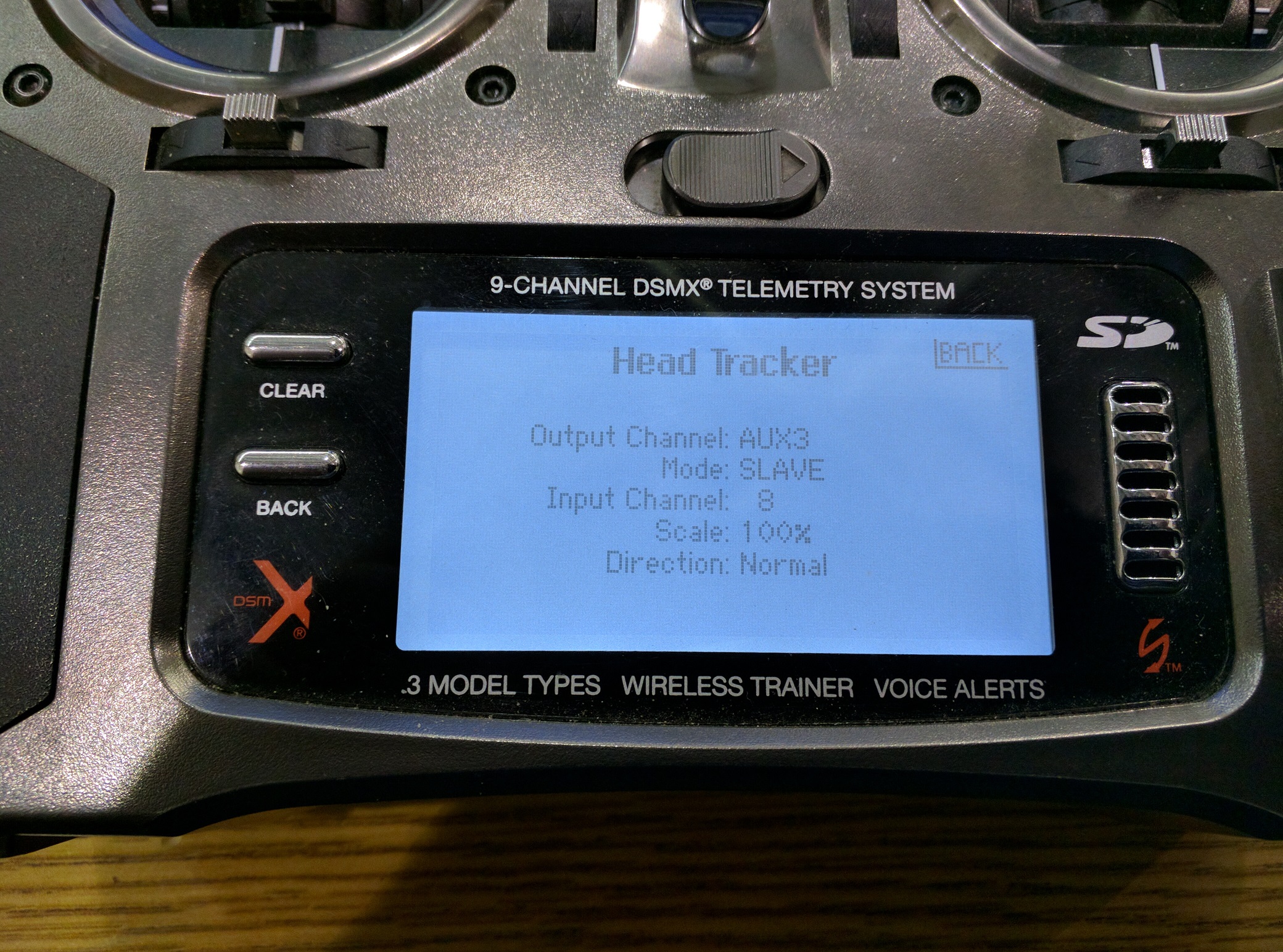

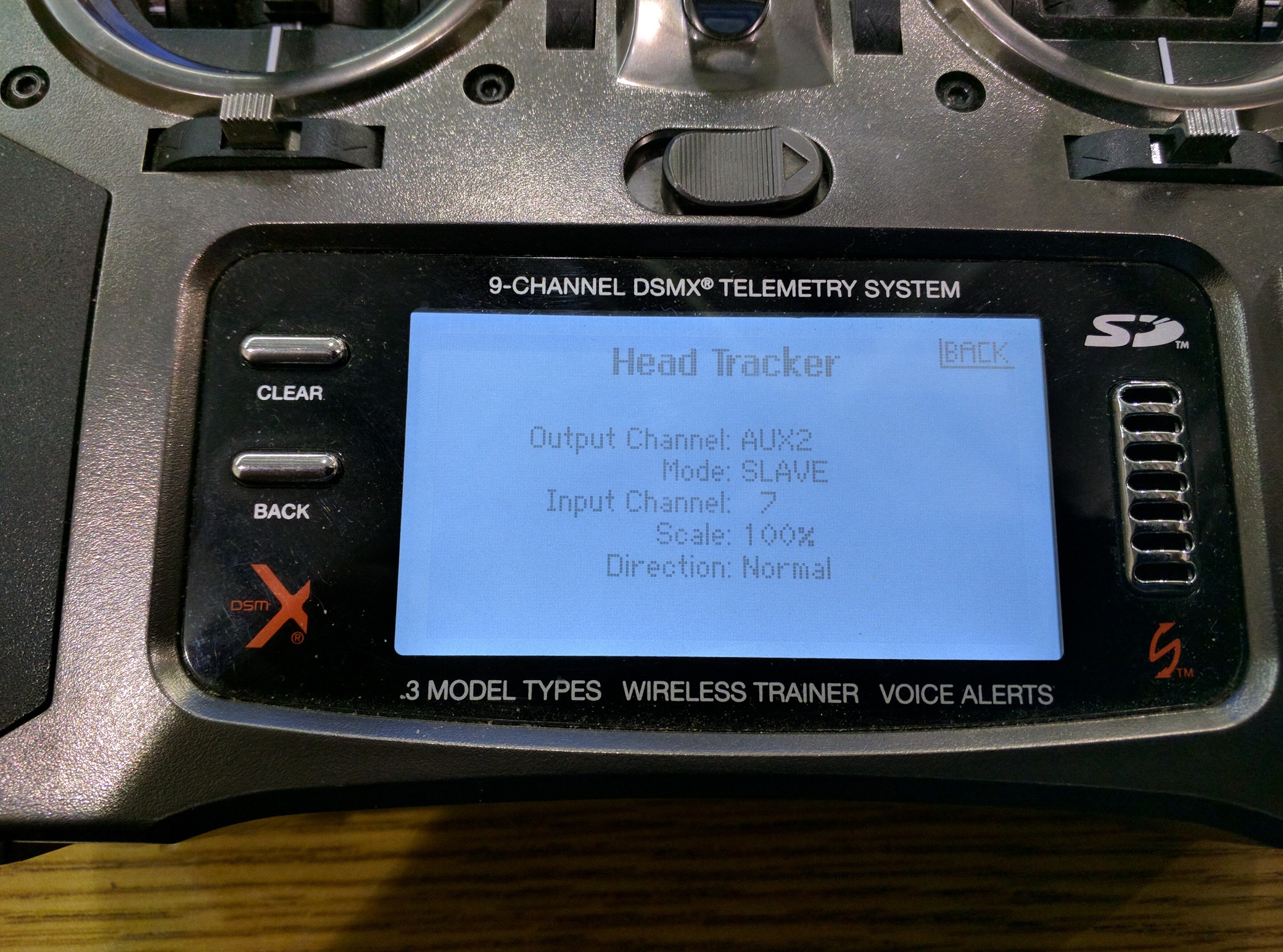

        With the latest firmware update (V1.10A) on the TX radio, Spektrum added head tracking settings. Info regarding these settings can be found here: http://www.spektrumrc.com/ProdInfo/F...Updates-EN.pdf
        Headset manual can be found here: https://s3.amazonaws.com/helpscout.n...anual-RevB.pdf
        Video transmitter manual can be found here: http://www.immersionrc.com/fpv-produ...z-600mw-av-tx/
        Per the headset manual, you will need to follow the instructions to assign what channels the headset will use for head tracking. In my case, if you look at my channel assignment on my diagram I'll be using channels 7 and 8.

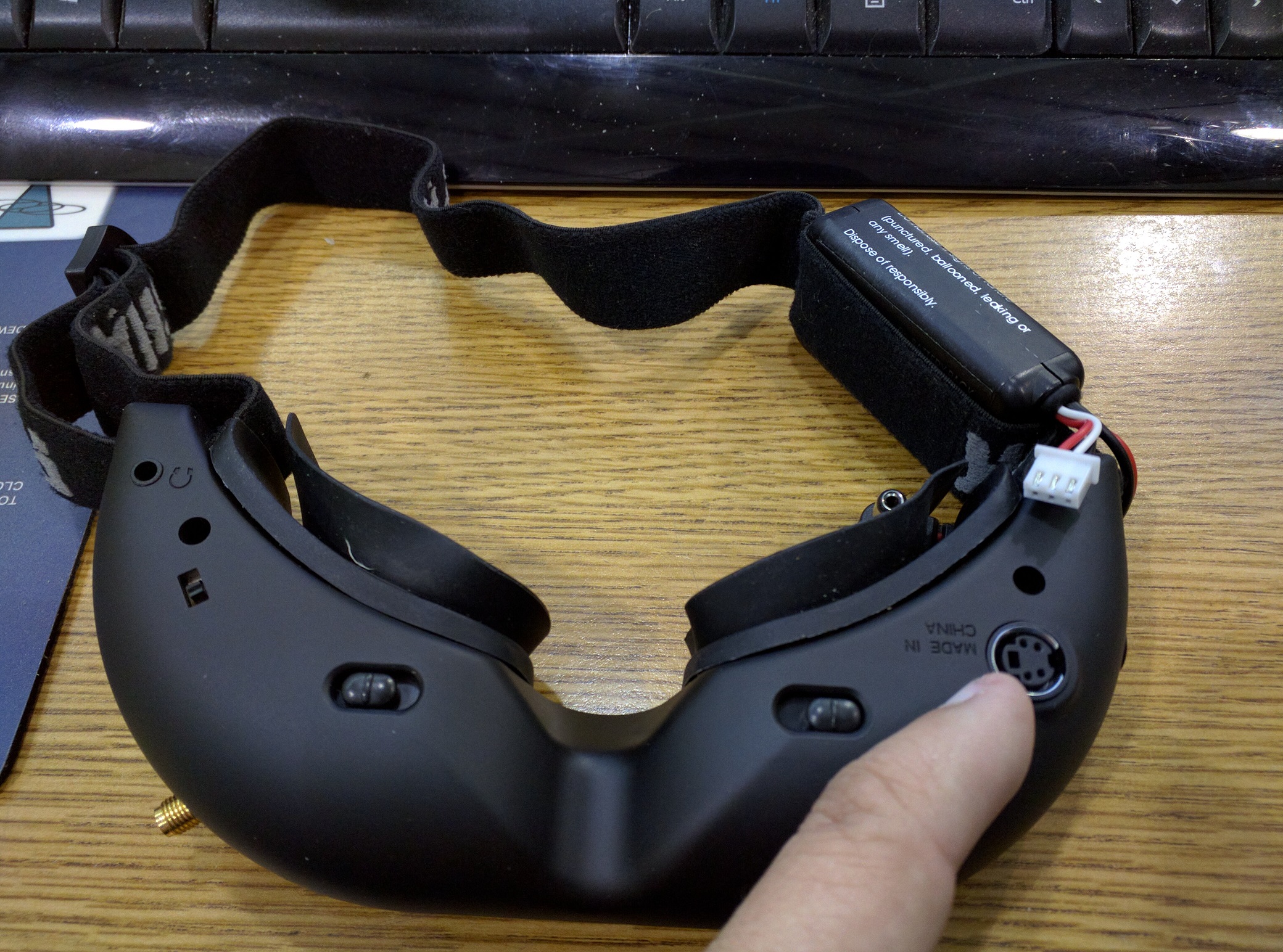

        The cable I listed will connect to the PS2 port on the underside of the headset (see attached picture) to the trainer port on the back of the radio

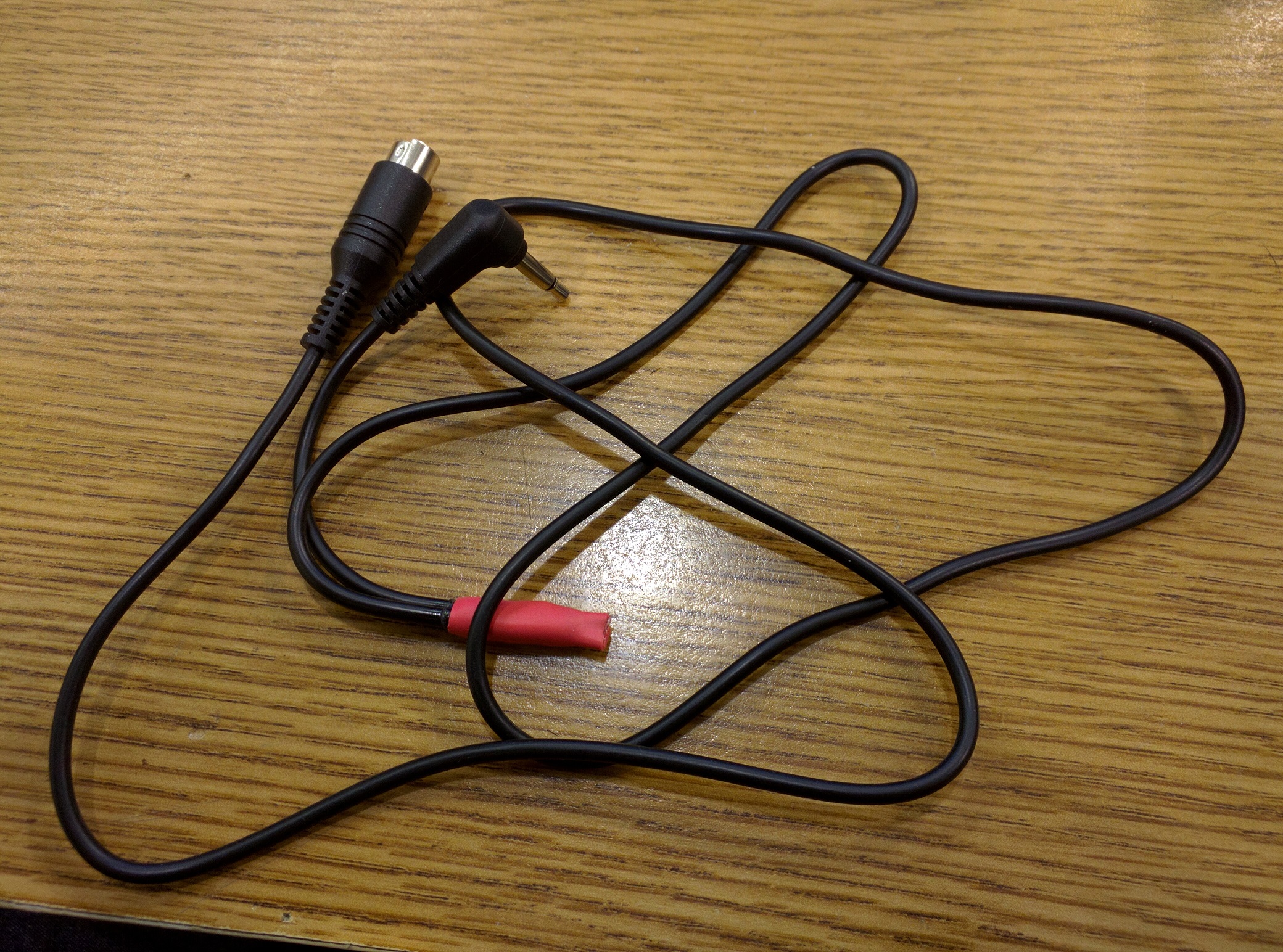

        Even though the cable I got said it would work for spektrum I still had to modify it before it would work. I had an extra trainer cord, so I cut an end off and spliced the wires:
        On the head tracking cable there were 2 wires - Red & Black
        On the mono trainer cord there was one wire (red) and a shield
        To splice, take the shield on the mono cable and twist it up, this will connect to the black wire on the head tracking cable
        The red wire on the mono cable will connect to the red wire on the head tracking cable.
        Once they are connected you will need to isolate them so they do not short, I used a small piece of heat shrink over the red wire connection then I used a larger adhesive backed piece of heat shrink to cover the entire splice.

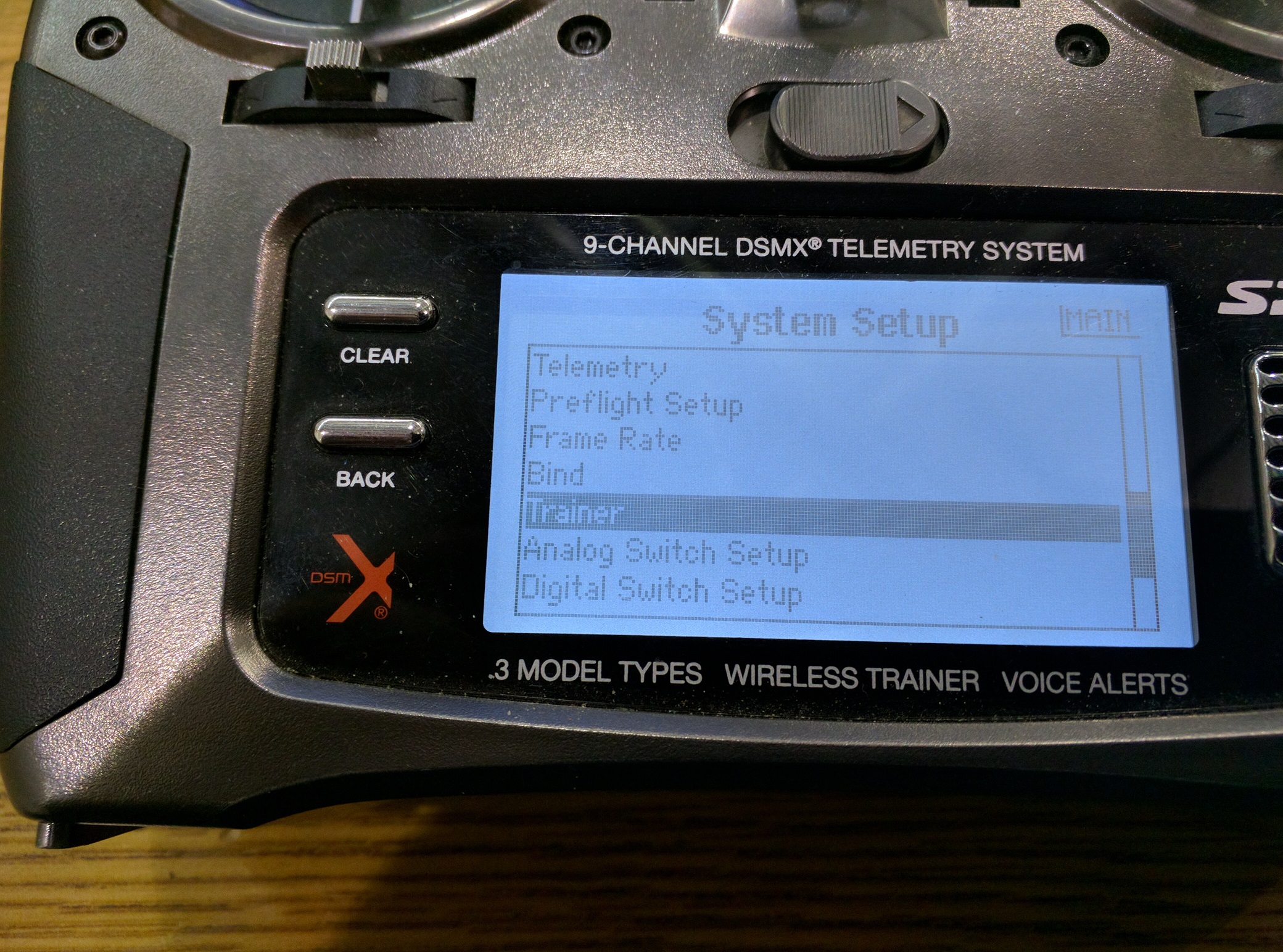

        Then, per the instructions on the firmware (see link above) I'll setup the trainer port to use channels 7 and 8.
